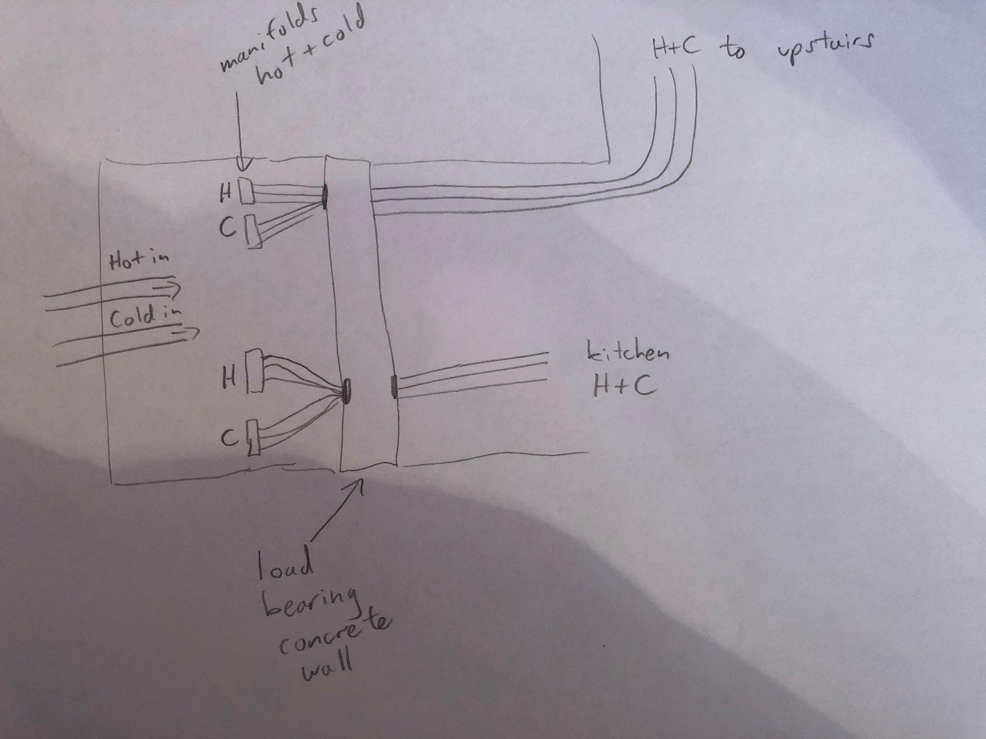

The ASHP cylinder will also be in the utility room hence the cylinder - only place for it . Runs to taps etc. none are excessively far . I *suppose* I could drill 4 large holes so at least cold & hot each have a hole per ‘circuit’ I.e upstairs and downstairs.
Hey all, Looking a bit ahead here, but thought it was worth asking now! My water in are below ground at the front of the build in a utility cupboard (Hot via ASHP ; doesn't exist yet!) But! I have a concrete block load bearing wall in the way. I want to try and keep it all neat. As I have below ground (kitchen) and above ground (bedrooms & bathrooms) I thought it made sense to split and have 2 manifolds for each (1 hot, 1 cold). I want no joints. So every run will be per item. So!; do I drill out 2 big holes in my concrete wall and pass the entire pipework through each one? - problem is it won't be particularly neat at this point. i.e. jumble of pipe going through a hole. Not really ideal. I could ( I suppose ) drill a hole per pipe. But on the upstairs for example off the top of my head there would be ( bathroom h+c, sink h+c, shower h+c, toilet h etc.etc. ); could be many pipes. I did think about doing the manifolds on the otherwise of the wall but that's the kitchen - so not really practical for access to them. Any suggestions appreciated - crap drawing attached
