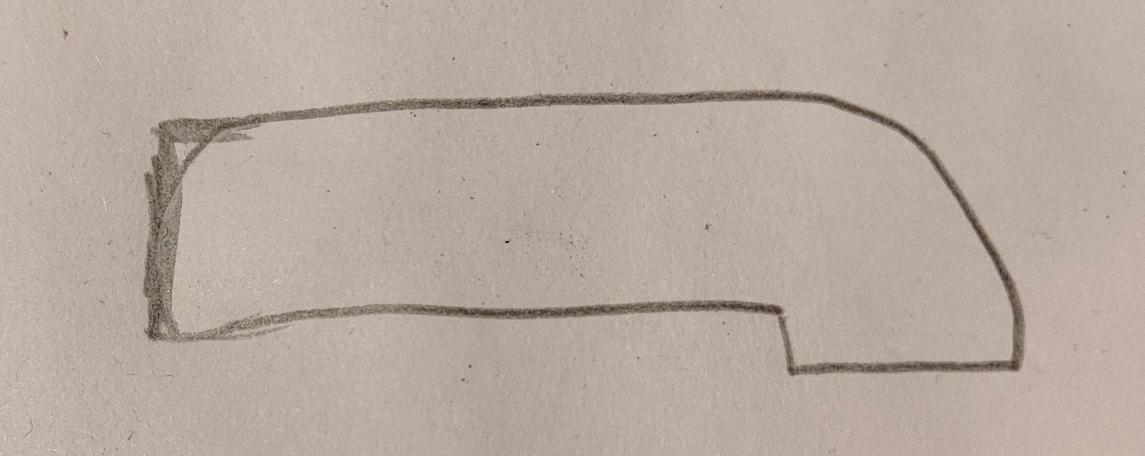

  11. How deep would you notch be at its deepest? Your image suggests about 25mm
  12. https://www.labc.co.uk/news/how-get-it-right-notches-holes-solid-timber-joists Lots of US guidance has notches in bottom as well and there the rule is maximum depth D/6 and maximum width D/3 and avoid square edges (where D is the depth of the joist). On that basis a 1" deep notch wouldn't be a problem. Not in the middle third of the joist span though. I know US code is irrelevant to the UK, but it sometime provides me with some comfort. Your image makes it look like you'd only be shaving a small amount off. Perhaps a triangle that is 1" x 1". That means that you are leaving 75% of the material that would be cut out by a full width 1" deep notch. Should be fine, especially given it is so close to the wall and therefore not supporting as much floor above as an ordinary joist.
