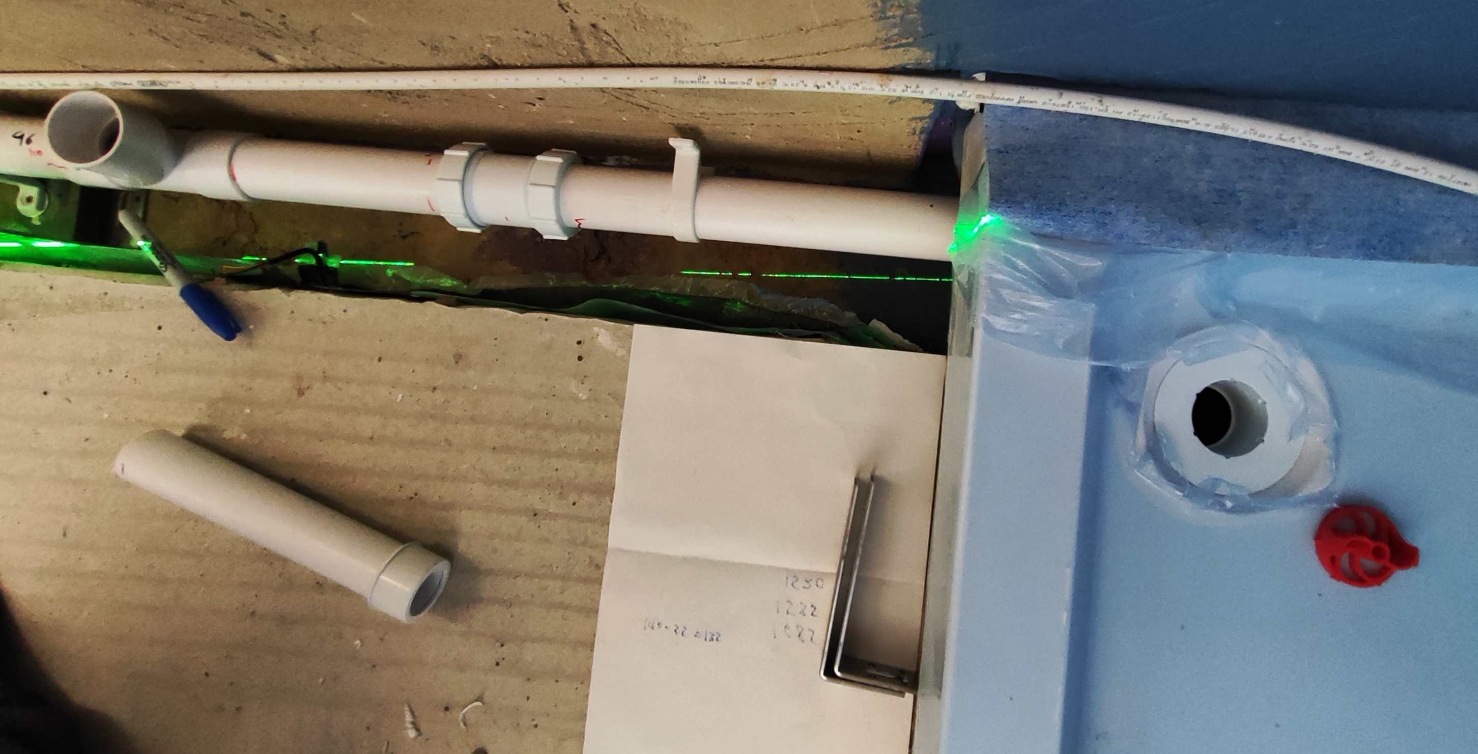

I've got too many branches etc to do an air test I think. What I'd like to do is block the 40mm with something and do a water test as that would test the trap too. Is there something I can use to block the 40mm having been inserted through the tee?
I've got a bit of 40mm waste before the stack that includes a straight coupler (compression), tee, elbow and shower trap. I want to test all of this is ok, but not sure how to. I could easily check similar in another bathroom where the stack wasn't installed fully and I used a stop end in the partial stack. Here the stack is installed all the way to underground. The pressure will be too much to block of the stack at the bottom. Is there a sensible way to test it just in the 40mm pipework? Photo attached
