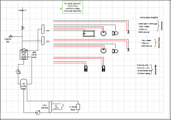

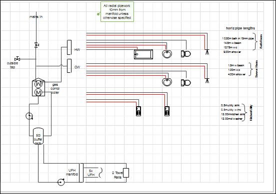

Well my build has actually started and going up - see http://auchlossen.blogspot.co.uk/ tho the focus at the moment is on the garage and 'studio/office', for construction strategy reasons. Here is my first take on heating and plumbing design, and I am looking forward to some expert critique to update the useful info on Ebuild which has guided the strategy. The general principle is Keep It Simple. House is PH 96m2 single storey 2BR. There is also a separate studio 36m2 with autonomous electric based supplies for heating and HW, with shower/wc/basin and sink. There will also be PV in the garage/studio roof - 12 panels 3kW - and I am considering a Sunamp for HW for the house, so need to get my head around the economics of this. Space Heating is by [sun sometimes!] combi gas boiler, UFH with small 50l buffer tank; I have rejected a wood burning stove; also no thermal store for HW. [Thanks JSH] Cooling by UFH and MVHR. HW by mains gas combi. I propose 10mm radial pipework from HW/CW manifolds in the Utility Room where boiler etc is based for most items, 15mm for bath. Maybe some of them will need to be co-supplied? I am looking forward to some cutting comments, thanks in advance. PS I found this Edraw freeware a bit of a pain to use.
Image ^^^^^^ looks like Hep2O '4-port valved manifold plated brass' 3/4BSP x 15mm, part no HX94T/15W. @ £58.34 list. There also appear to be cheaper non-valved manifolds for 22 x 10mm. Both types also available in 2/3/4 port versions. HTH
