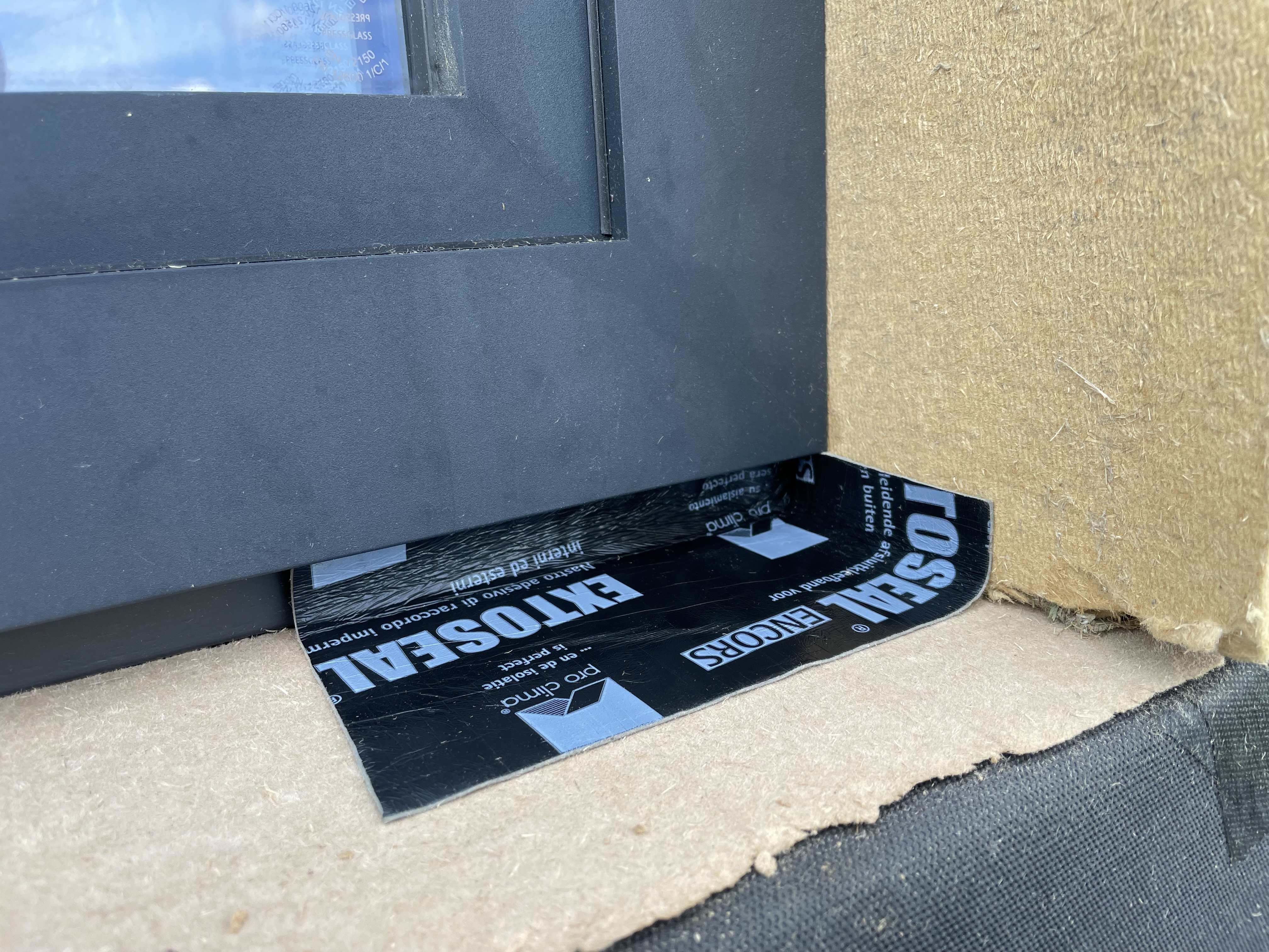

  1. Anyone else have a similar wall build up to me and how did you weather proof your windows before cladding. Here is a mock up of one of my windows. I have insulation pushed into the reveals, the outer aluminium face is cut back to allow 35mm of external wood fibre to fit in there against the wood portion of the window. On the sill I have made a tapered wood fibre fillet. This will be primed so I can cover the still with flashing tape and also stick to the bottom edge of the window creating a pan in front of the window to shed water. The metal sill is meant to then fit into a grove under the window. All wood fibre will covered in membrane of some sort my walls are made from 45x245 timbers and I have 60mm external wood fibre. There is a black membrane on the outside and then I have 50mm battens to which I will clad with an open rain screen.

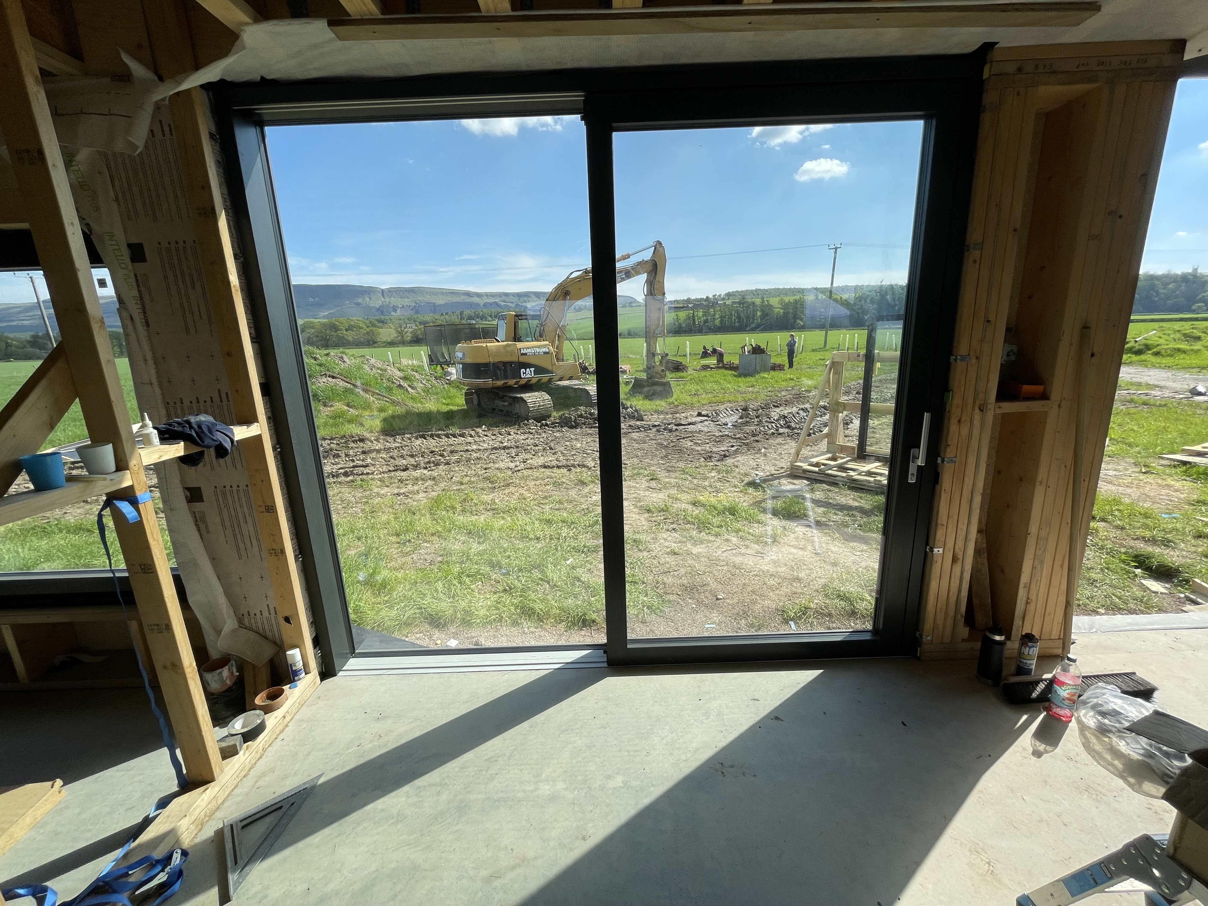

  2. Got the big ones in a few weeks ago. 3 guys and a robot for £1k plus me. The glazing robot was great. A reckon the big unit was 500kg.

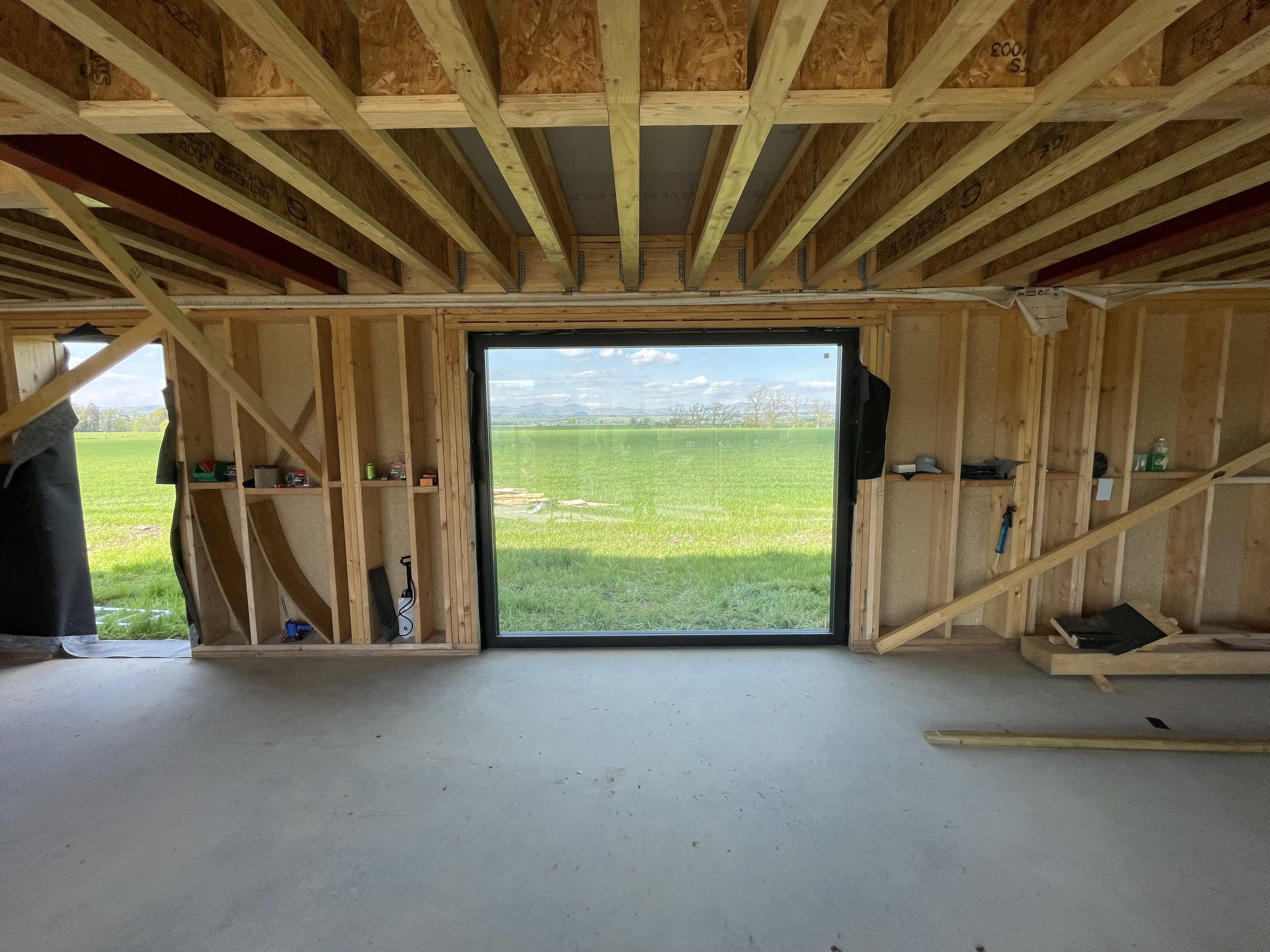

  4. Il don’t know off hand but my slider is smaller than yours Russel. Prob closer to 3m but it is quite tall at about 2.6m which makes it more intimidating from a tipping over perspective. I also think 5 people could lift all my windows in. I have an insulated raft base which makes the finished floor 500mm higher than the current outside ground level. I think it might be worth my time trying to prep the site to take the robot in any weather. I was trying to avoid putting any sub base down that will need to be dug out again to fit the drains. If I put the drains in first it will delay getting the windows in.
  5. Hi I have some large triple glazed units to fit. The biggest is around 2.6 by 3m. The company that sold the units have a glazing robot which they can supply with labour at £1000 per day. This could work well if the ground around the house is hard, it was last week but the rain this week has turned it soft again. Another option is renting or buying from AliExpress a glazing cup vacuum pad that I can sling from our digger or forklift. These can lift over 500kg which is well within the weight. The biggest problem I can see with these is drawing the window into the rough opening. The rope it is dangling from can only get so close to the house so it’s not as handy as moving it into place with a glazing robot. The robot has a much more positive placement. How are large units normally fitted without the use of loads of people . Even people might be tricky as only so many hand can get a good position to lift. If I had to do it myself. I think I would prob use the forklift or digger with a vacuum pad. Maybe a chain hoist between the digger and pad to give some height adjustment. I would hold the window away from the house to avoid damage from the digger getting too close. Prob put a hand sucker pad to each bottom corner of the window and attach a ratchet strap to each hand sucker pad to draw the window inside the house. As the window swings in lower it down with the chain hoist. ??

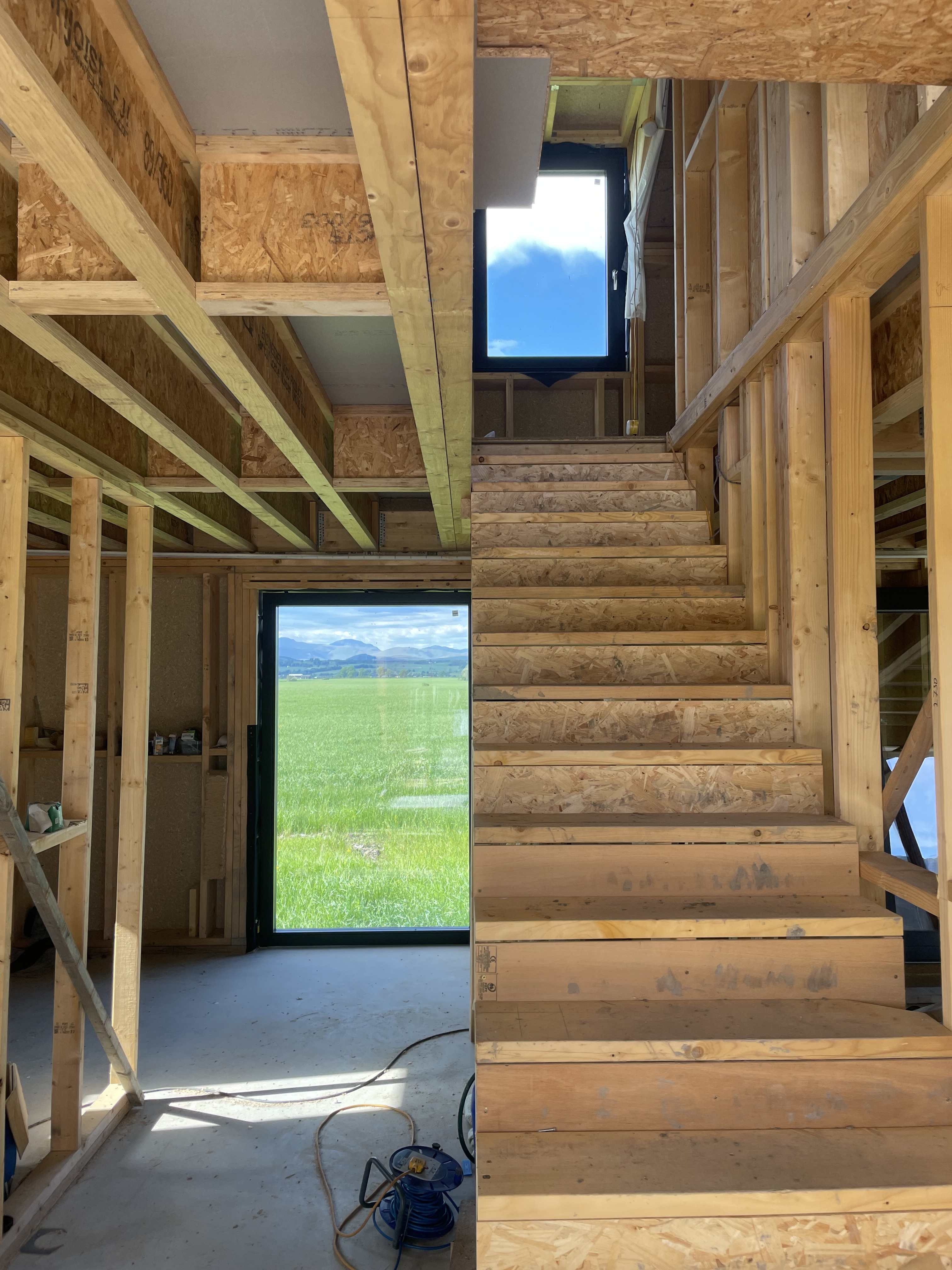

  9. Built a rough staircase today. I needed a better way of getting materials upstairs. Next step is to take the windows upstairs ready for fitting.
