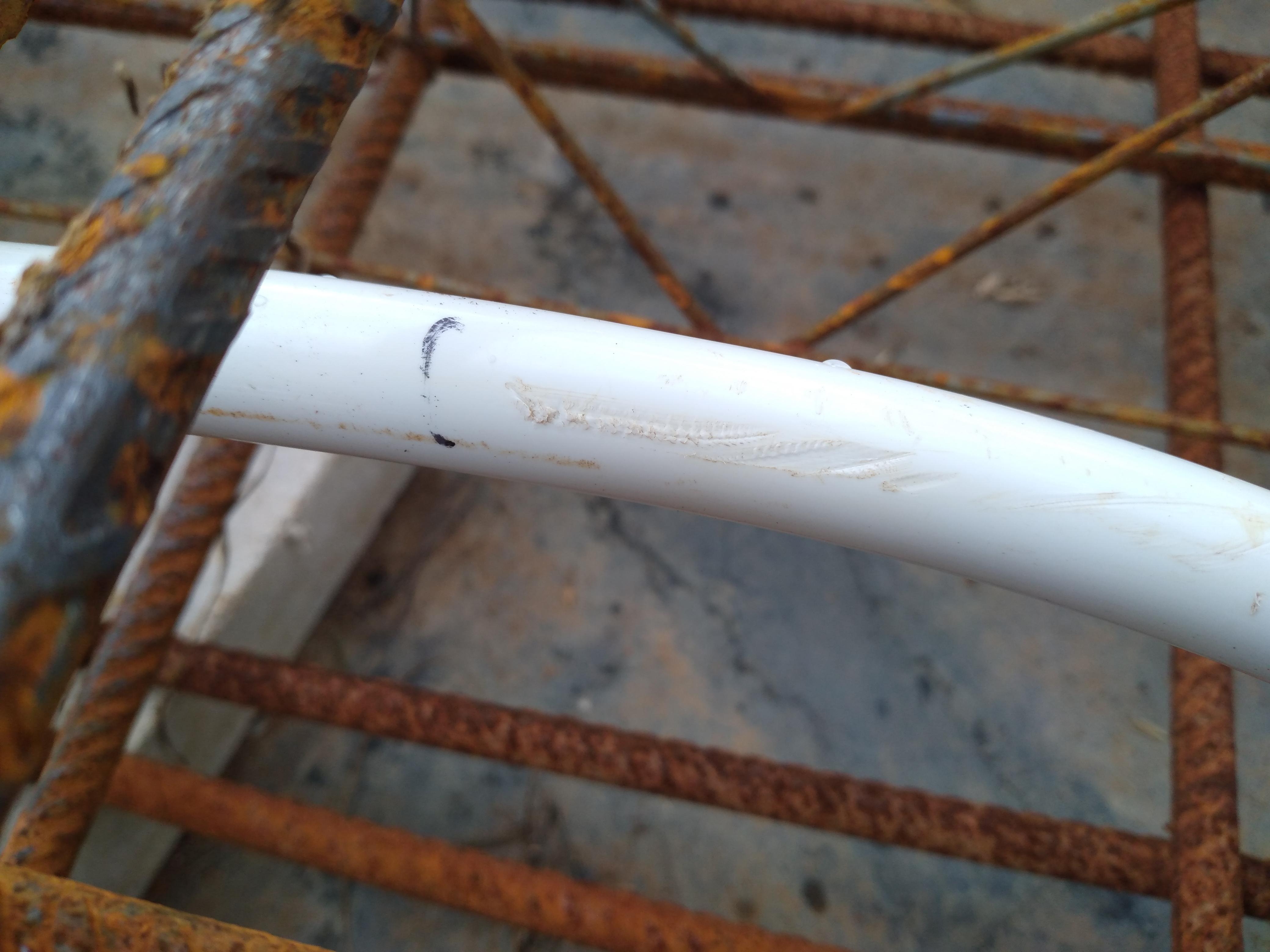

what do you think about my damage pipe
gavztheouch replied to gavztheouch's topic in Underfloor Heating
I pressure tested it last week before the damage and will do it again tomorrow. Im fairly certain it will hold pressure. I guess I was worried about future leakage but I'm not sure how that would happen incased in concrete. -
I have damaged a pert-al-pert pipe in my foundation. For context it is under two layers of A393 mesh which will make it hard/take time to fix. Feeling gutted as I was almost ready for pouring concrete and this will set me back if I need to fix. I damaged it by swinging a metal pole to hit the rebar mesh to move it and I also hit the pipe. Do you think it is too badly damaged? I would say it's prob ok but it feels border line which is annoying. Im so tired with work and this foundation that my judgement may be impaired a little. I hasn't exposed the Alu core. Options. 1. leave as is, maybe wrap with some tape just incase the concrete does manage to somehow effect the aluminium core 2. repair with a coupler Cheers Gavin
