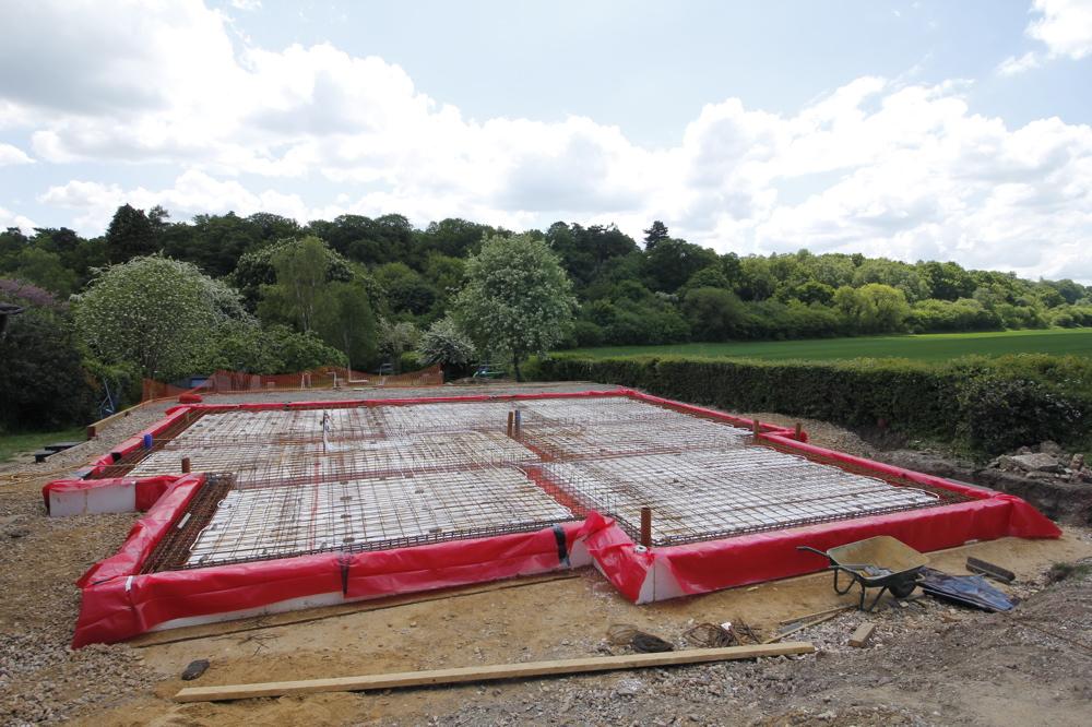

  4. My BC/warranty assessor wasn't fussed at all, he said he had seen plently of insulated slabs. All he wanted to see was that the steel was fixed properly and would have adequate concrete cover.

  8. Passive slab all ready for the pour. Just finished pressure testing the ufh pipes

  10. Hello I came across the ebuild forum whilst researching lending and warranties for timber frame timber clad builds. I had already met the MBC guys at a trade show and had them price my frame and slab, so was pleased to hear good reports about them on the forum. I knocked my existing house down in March and MBC started the slab 2 weeks ago just as the other site stopped. With no where to post any longer I set up my own blog at http://www.passivehouseselfbuild.co.uk/ which I will try and keep up to date with progress and my thoughts along the way. I spent the morning today connecting the ufh pipes to pressure test tomorrow for the pour on Tuesday. Exciting times.
