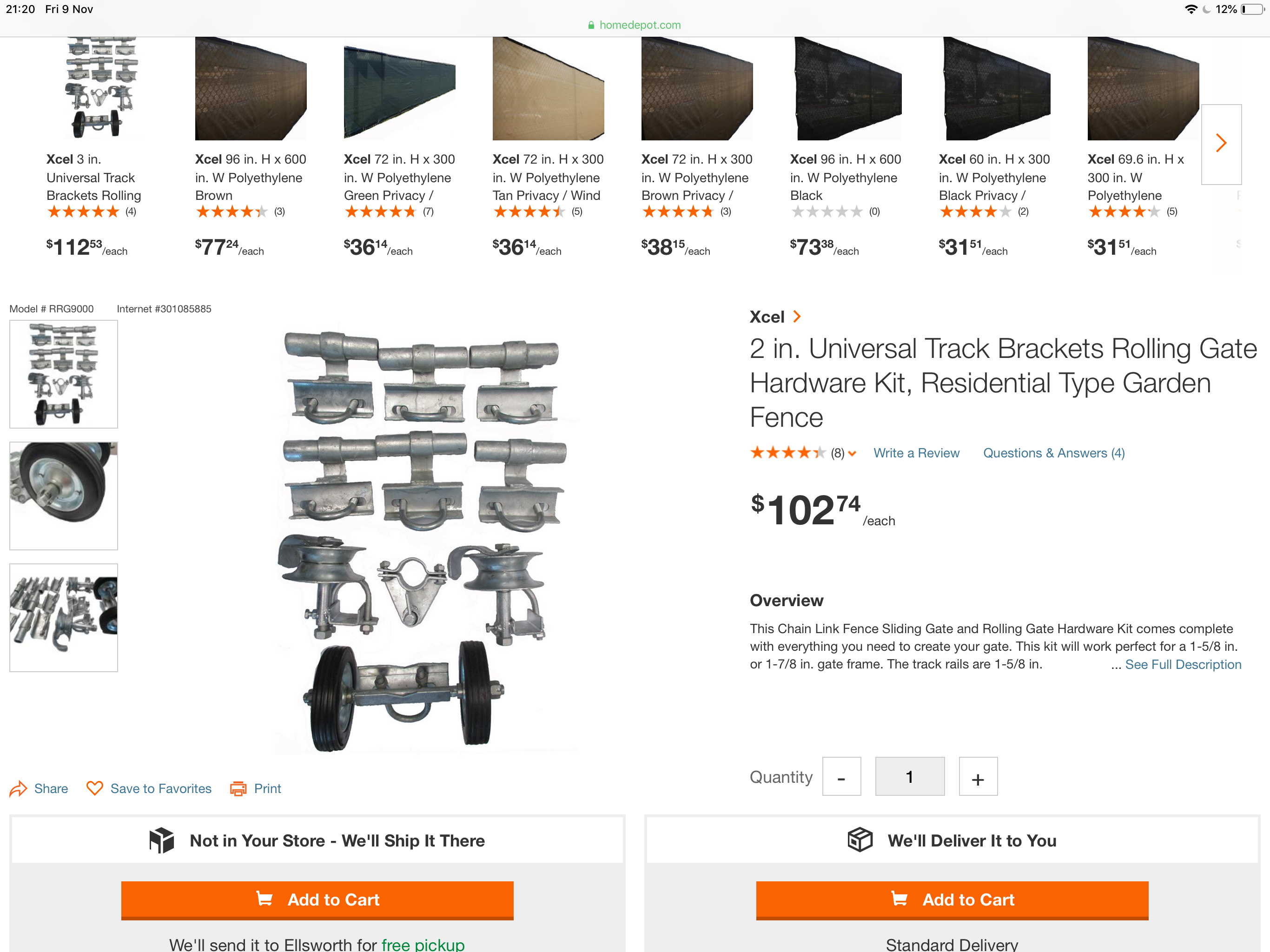

Can’t find a set like this from and uk/Eu seller. Can anyone point me in the in the right direction? Thanks
