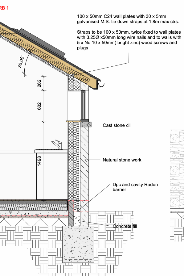

It was mainly a necessity in the main building so as the extension is new with a modern build method, it felt like an overly expensive option plus, it's mainly for a kitchen and didn't fancy trying to attach wall mounted units to WF This is what I've been leaning towards. Our builder said he's had no issues with board insulation or lighter blocks on the inner leaf but not sure I fancy the risk. Feels like we could go to 200mm cavity with EPS beads and medium blocks for both leaves and hit a better U value.
Hi, My architect has spec’d 100mm dense block for outer leaf and Celcon 2.9 n/mm2 for the inner leaf with a cement mortar (3:1) for an extension we’re building on an old, solid stone home. For the rest of the main house, we’re going breathable with IWI wood fibre and lime throughout with a MVHR system. The extension currently has a 125mm cavity designed to have 100mm ecotherm insulation and surecav 25. I spoke to the architect about reservations of aircrete blocks having issues with cracking but he didn’t think it was an issue. I don’t want dot dab inside and planning parge coating and wet plastering but again, a bit concerned the light weight blocks will suck too much moisture out with that approach. I probably can’t swap to a denser block without needing to change cavity size as current spec only just hits 0.17 u value so a bit torn. Any suggestions would be massively appreciated as feel I’m going in circles but really don’t want to regret a choice down the line!

extension Construction Method in Old Stone Property Extension + Renovation
Lears replied to Lears's topic in Brick & Block
JFB, sorry to bother again with what might be a stupid question but was your extension block work done with standard modern mortar or did you use a lime? If standard, does that mitigate the value of the wet lime render insider?- 10 replies

This is really helpful so thank you. Does make me think widening the cavity is the easiest route here. A few questions if you don’t mind. I’ve seen some places use diathonite as the leveling layer, then adhesive onto that with the WF, others I’ve seen just use a stickier mix of lime after getting the mortar relatively level. Interest what your approach was? I’m still learning on the cavity wall side so was your partial fill or full fill and any info on the specific insulation you used? and then was it just a wet like mix straight onto the blockwork internally with a mesh for extra support or was there a membrane etc? Very interesting on the limecrete. If we didn’t know someone that did it I feel we’d just go concrete given some of the posts I’ve read. Out of interest, did you use a lime stone floor finish on that one or any thoughts on the damp issue? We’re going MVHR so I’d hope that wouldn’t be an issue… Thanks, will look at the segal method a bit more. My only worry with TF is having two parts of the house with very different thermal properties at this point but will do a bit more research.- 10 replies

Hi all, I'm in the middle of a renovation of an old stone cottage near Wales (2km from the Severn but not massively exposed) which I going to be a long term home for my family so really trying to ensure I make the best possible decisions. Hoping I can leverage the collective wisdom of this forum as I've read a lot of posts but still not 100% sure. The fundamentals The part of the property is 450mm solid stone (rubble infil) walls and a thin concrete pad of questionable quality. The plan is to put 60-80mm woodfibre IWI around the external walls, remortar in lime, limewash finish etc. Additionally, we're going to lift the existing floor by 500mm or so depending on state of foundations, put in an insulation layer and limecrete with wet underfloor (I have a connection so can get done for a good rate) We're then putting an extension on the east side of the house, replacing a pretty horrible lean to conservatory The plan is to retrofit MVHR and heat with airsource heat pump, reroof with in roof solar. I think this will be good enough to heat the entire home if I hit decent U values and air tightness with some towel rails upstairs but am leaving a service run as an option to fit a mini split system upstairs for AC in the summer but could be supplementary heating too if needed We've has some designs back from our architect on the construction of the extension however, we didn't really ever have a chat about the wall build up itself. He's come back with the below: 160mm stonework finish (we will have lots on site so won't have to buy in but understand labour unlikely to be cheap) 125mm cavity with 100mm ecotherm insulation 100mm toplite block with dot dab finish plasterboard on the inside all of which targeting a u value of 0.18. At first glance, this didn't feel like it was particularly ambitious from an energy efficiency point of view and although I knew it was going to be a more modern construction and therefore, we won't need the full lime treatment, dot dab just doesn't feel right or in keeping with the rest of the home. I've looked a bit into ICF and timber frame but wasn't too sure on how well they would join to the existing property, both at the intersections and in terms of having very different thermal performance properties. On the ICF side, because it's a single story and one section will be sliding doors, I wasn't sure if it was worth while. I'm relatively hands on and will be doing a lot of the lime and wood fibre work so happy to get my hands dirty to save on costs. My initial thought is to just widen the cavity and stick to blockwork but any suggestions or comments would be greatly appreciated. (Section highlighted in blue is the new extension, grey walls are solid stone
