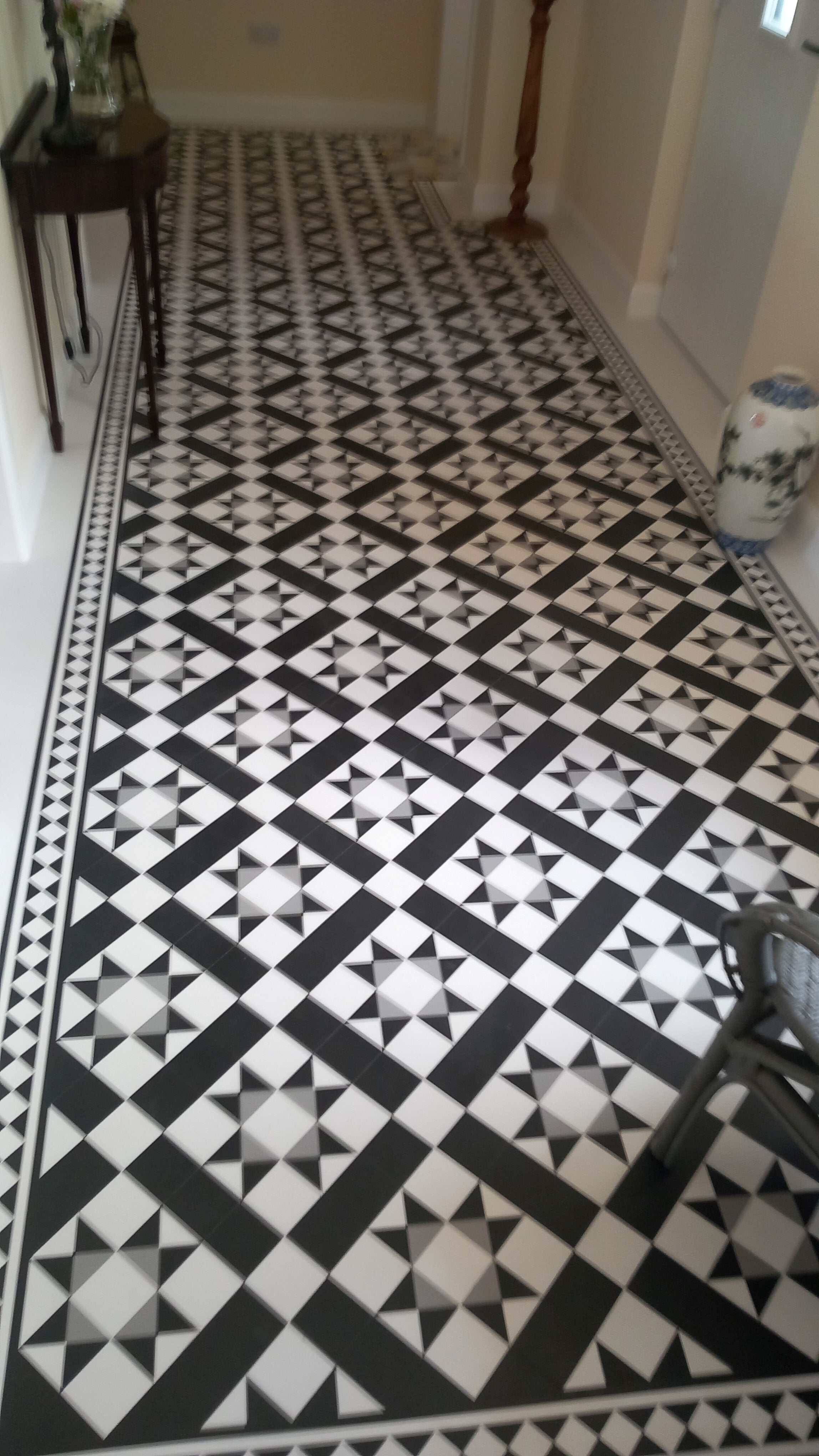

there is another thread on moisture content in new floor bottom line is if you want a super job -first you need to make sure its totally flat if any doubt hire a grinder and flatten it then you need to use a moisture gauge if its an old floor there should no moisture in it if there is you have to start thinking about rising damp through it only then do start asking about adhesives when i had my new floor laid they wanted it down to 3.5% -- If i wanted not to wait and do it at 4,55% then the adhesive was twice the price even if you go for self levelling -- it is unlikley to be flat enough to just lay directly without grinding for a perfect job and again you need to do the moisture checks -- it will not be a moisture proof barrier theres a perfect floor all made from little bits
get three quoted and treat sales spiel with some caution but by the time you have 3 quotes you should have an idea of what you want and price range triple glazing is only really to deaden outside noise difference in heat loss is minimal
