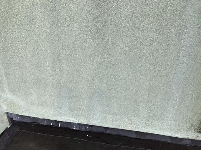

Hi. I have a flat roof connected to the main house. The walls are icy with thin render - the final coat being a 2mm acrylic render. There is drop of water coming into the room below when raining for a while. I have come to the conclusion that the water is entering through the render and down the back of the lead which eventually means drops into the wardrobe . I want to paint on a sealer to the external surface to test this theory . The sealer would need to be transparent and I would need be able to paint over it as we want to repaint the house next year. can I ask you to suggest some products please. I live in the west of Ireland(Not coastal) , rain is something that is common on a daily basis. Thanks

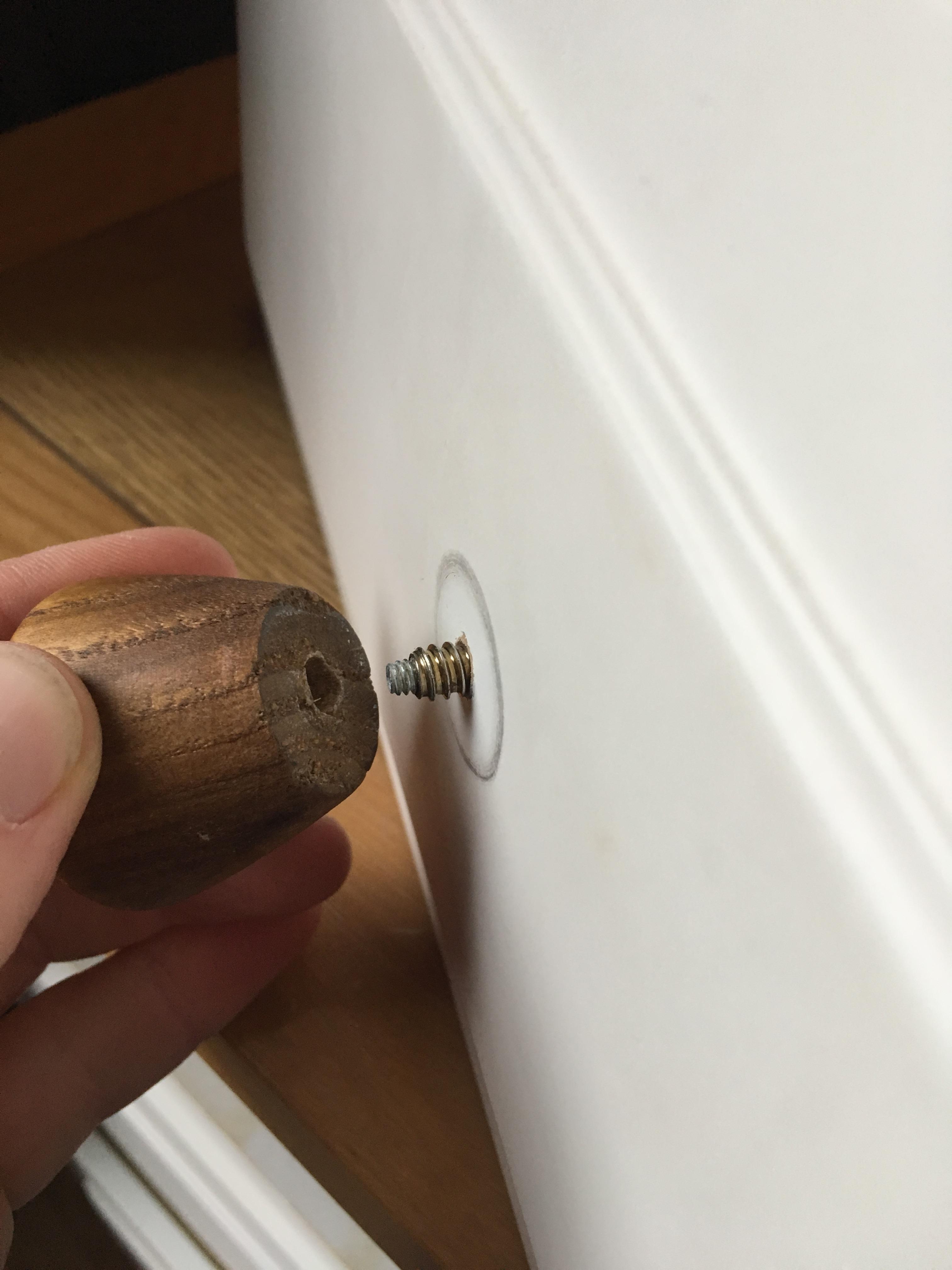

Hi. Locker knob has come off. It just twists endlessly on the screw sticking out. Any of ye knowledgeable folks know an easy fix pls. Thanks

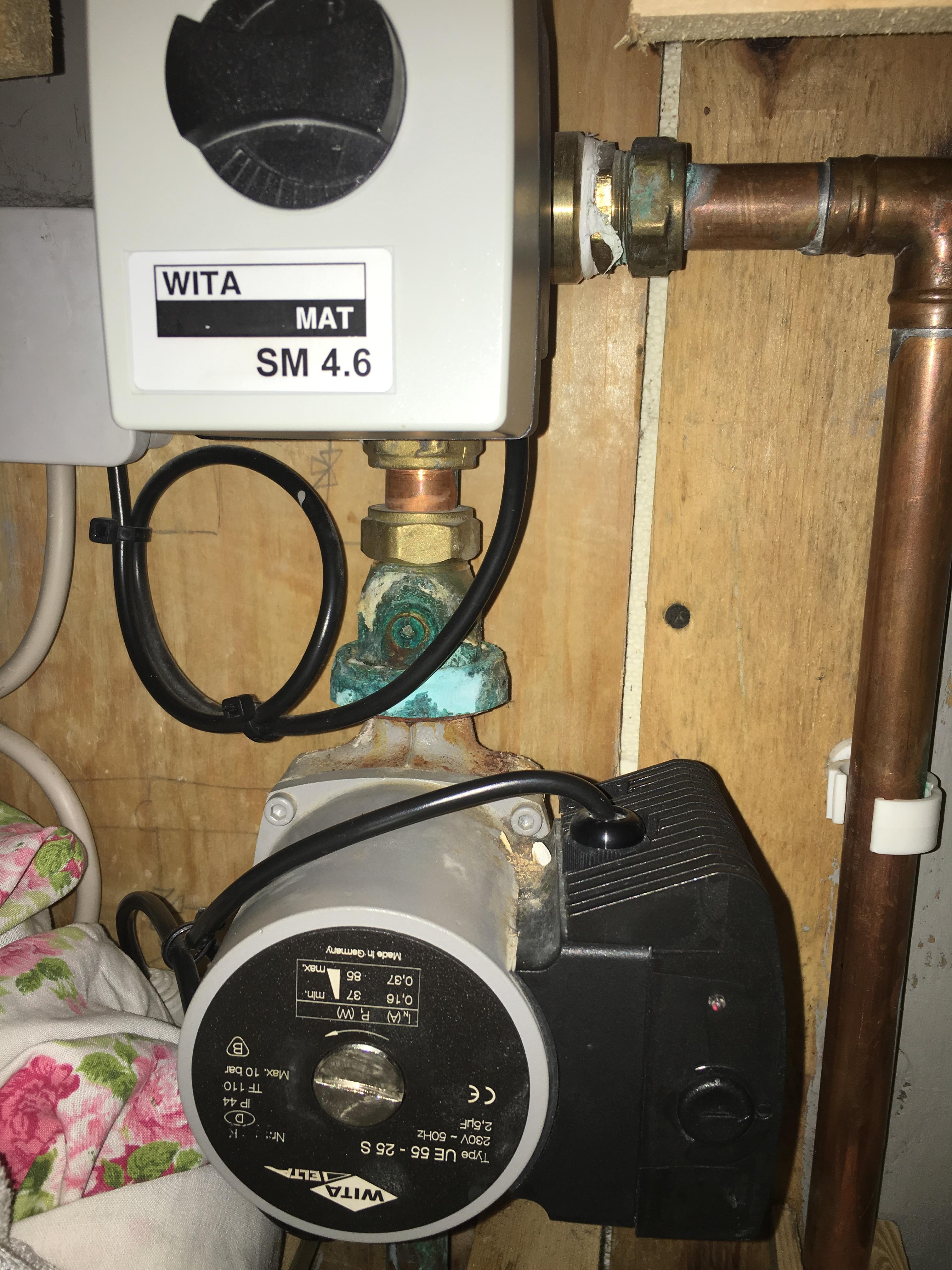

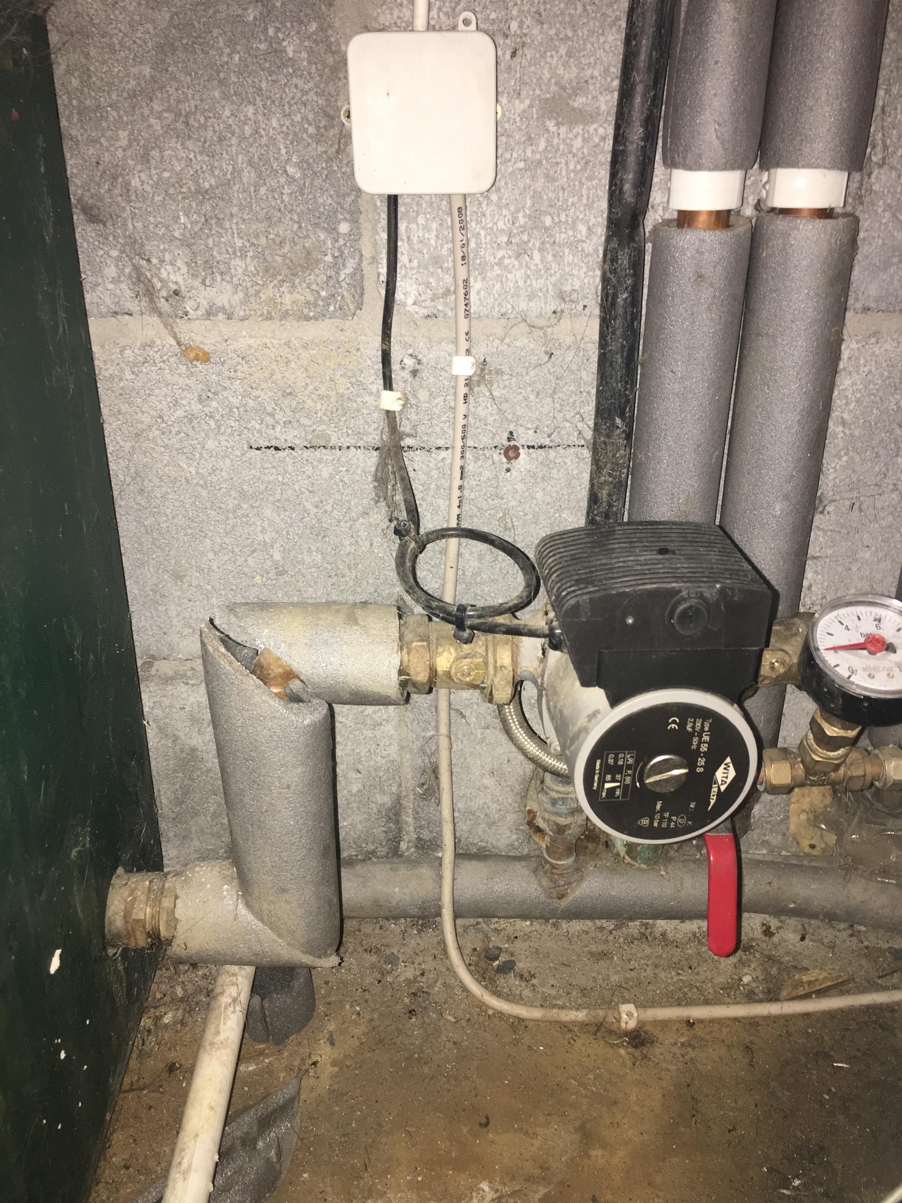

I just googled seized pumps and saw that if u take off the bleed screw and stick in a screwdriver and manually turn the pump it may unseize it...( when the heating is off)...yes the boiler is firing and we have had no problem with showers.. only turned heating in today after 4 months... pump beside boiler was hot
There is a circulation pump in the garage that is hot ... see second picture. If I undo the screw in that pump and move the propeller with a screw , will a lot of water come out? thanks
Hi. I turned on central heating . Boiler is on, pressure is in system but rads not turning on. See pic ..pump light on...making a lot of noise.... any advice thanks
