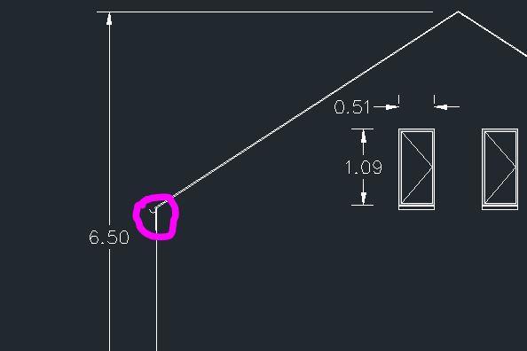

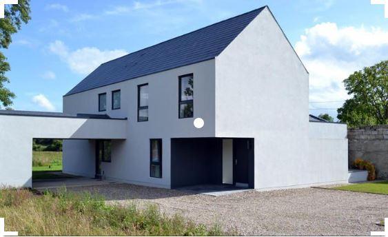

Hi. I am designing a self build at the moment and I have a few questions which you guys might be able to assist with. My design is a rectangular house with a raised wallplate to allow living space upstairs with rooflights and gable windows for light. I want to build a standard cavity masonry wall with an increased cavity to be filled with a yet to be determined pumped insulation. I also want that eaves less look that has become popular My questions are At what stage does a cavity call for specialised ties. I am looking at a 150mm Cavity..Do I need to over engineer this or will longer ties do?. The house is 13m long by 9 metres wide and its 3.5m to the wallplate with a standard A roof at 30 degrees I am struggling to find a detail for the eaveless roofs. A guy told me today that by right the gable of the building should be plastered before the roof is put on for that detail. FiIor a normal projected out eaves , I get that the rafter sticks out beyond the outer leaf of block and is notched into the inner leaf but with my detail the rafter can be notched on the inner leaf wallplate buudt cannot extend out beyond the outer leaf to avoid conflicting with the plasterboard. Is there a cement board skirt detail that goes in there? This is my first post and appreciate your help I have attached an example of the detail I am going for. Thanks Moggaman.
