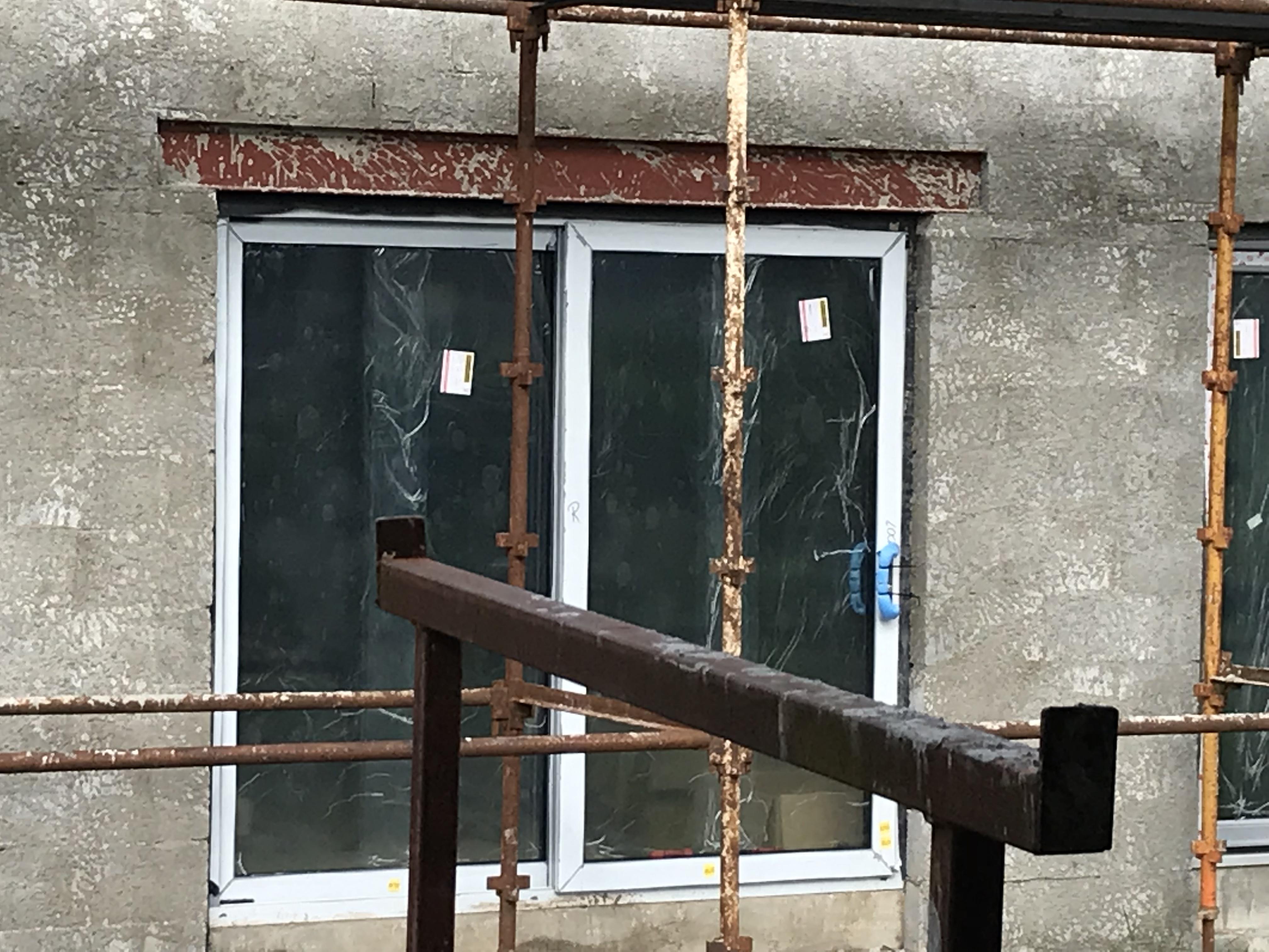

  11. Hi. How does a plasterer sand cement render the beam section here please? thanks

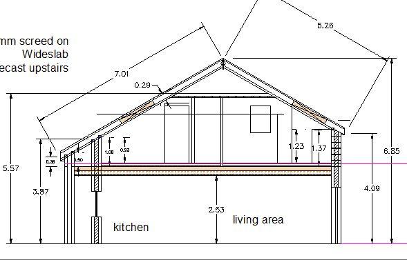

  14. Hi I have alot of pitched roof insulation to put in as I have a room in roof design. I have 135mm rafters. The detail i have been given is 180mm knauf omni fit roll with insulated plasterboard fronting the rafters. Clearly that cannot work. I propose to use a 110mm PIR board (kingspan or similar) leaving a 25mm airgap behind and insulated plasterboard fronting the rafter also. I will have insulation detailed above the flat part of the ceiling also which will be rolls. Do you think my rafter plan is ok? .Shouldnt affect U value too much? Thanks

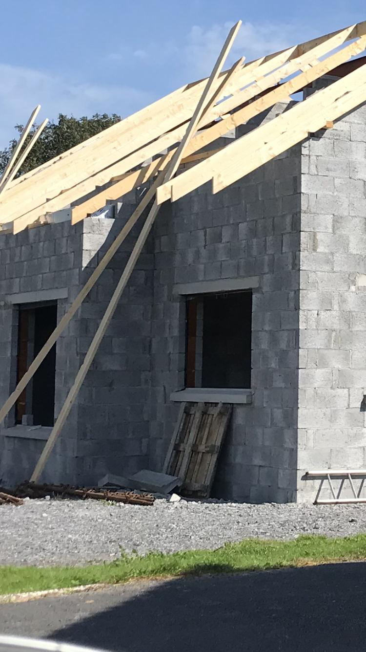

    Hi all see photo of roof going on in my house. U will see I have an overhang on my roof. On my drawings it shows a column at the outside to support the rafters and roof. It’s not structural , just there to prevent sag on the rafters. Column would need to be about 3.7m long. Have you any suggestions on what I would do?.. A galvanised steel Column classed or perhaps a steel circular column? thanks
  17. Thanks all. Got them up using a JCB telehandler and some slings but it was precarious!.

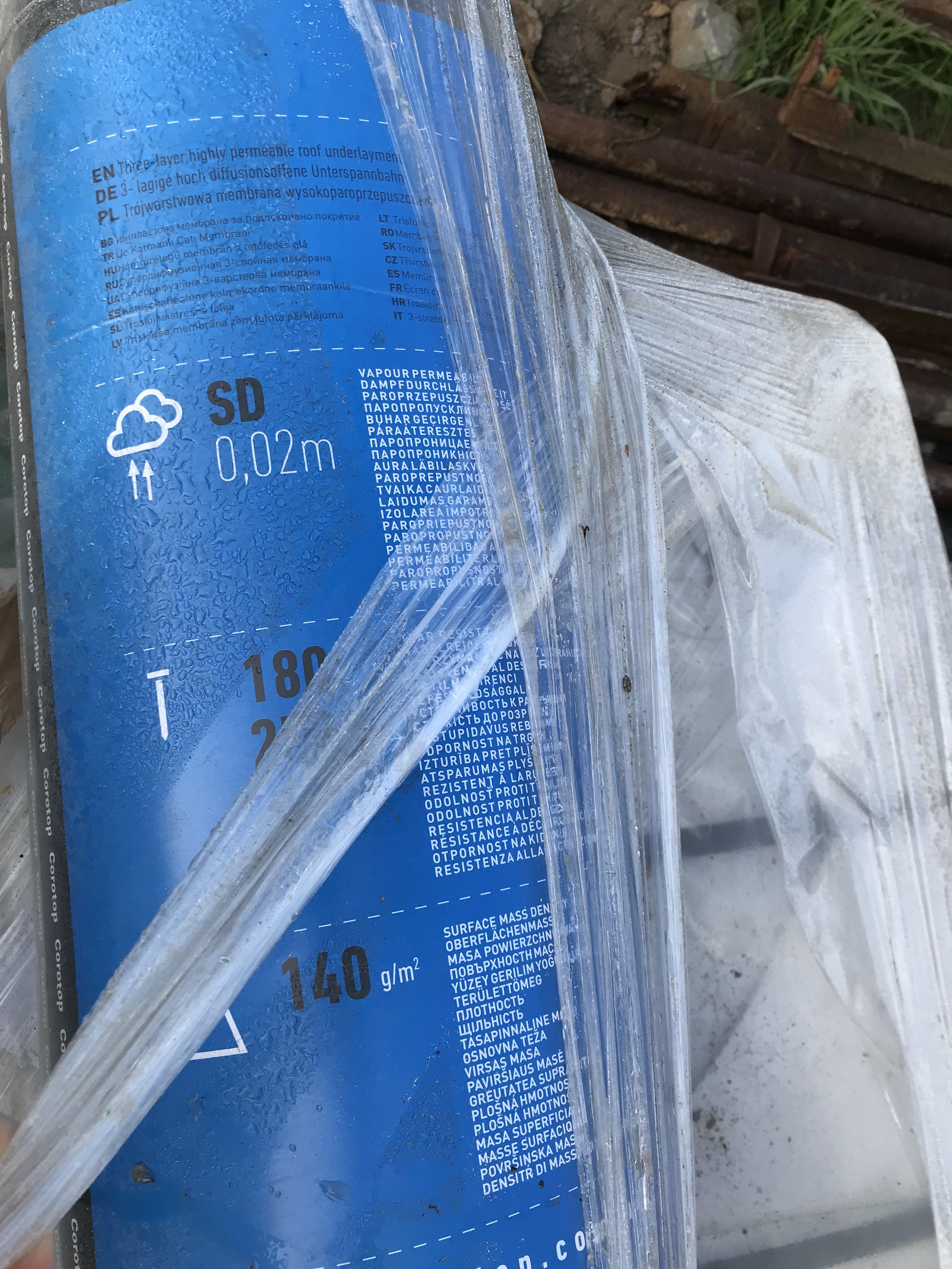

  18. An alternative quoted was Fakkro N35 135g… is that stronger?
  19. Hi all Starting to roof my house. Builders brought out Corotop blue roofing membrane 140g/m2. see photo. Is it decent stuff anyone know.. what specs should I be looking for. My rafters will be insulated with a 50mm gap to the felt. thanks

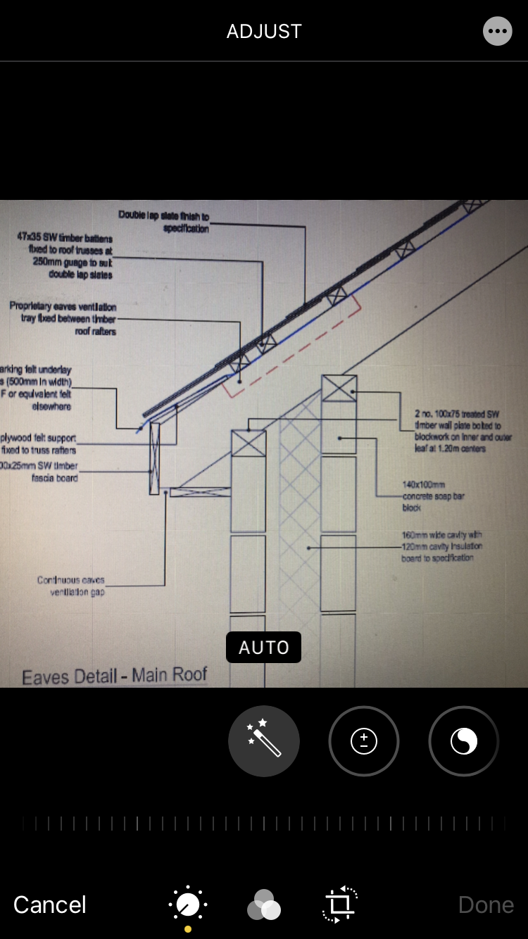

  22. Is fire safety the only reasoning?. For those of you that didn’t close the cavity at wallplate level, do u increase wall ties at wallplate level
  23. Hi. Please see detail provided to me regarding area around eaves. My design does not have a cavity closer. The insulation will run up to meet the rafter insulation. Just wondering if the cavity closer has any structural properties or is it just there to ensure nothing gets down into cavity. If so, would a few more wall ties on the last course be warranted?. My question is not around whether is complies but around the reasoning for having one… thanks .
