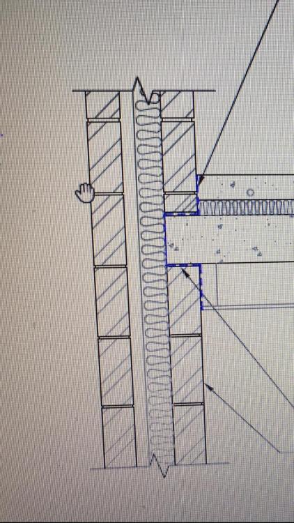

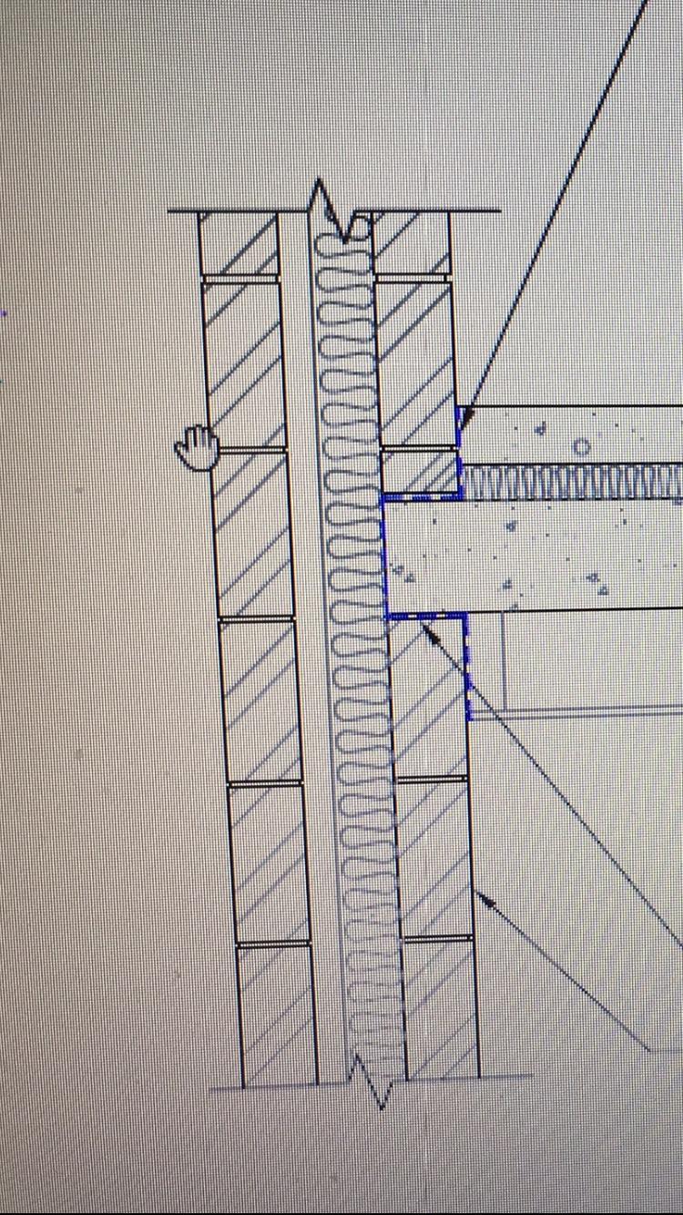

Hi. I am about to put wideslab precast flooring onto my block walls. The detail shows the wideslab being wrapped by a Siga Majpell type material. The wideslab will ultimately have a 150mm suspended ceiling housing the MVHR and services. The majpell will ultimately come down the block to 20mm below the ceiling.. the sand and cement render will then lap the majpell.. do I need to tape the majpell to the block first before plastering or just keep it in place and lap the plaster over it. the other option is to bed the slabs in mortar creating a seal horizontally. Then airtight paint the block below the slab to 20mm below the finished ceiling level and plaster over this. Where the slabs run parallel to the inner leaf , I can either paint that before slab goes in or fill the gap with a wet mortar seal to create a seal on the block . Appreciate any comments.

Hi. I have read a few threads on the wrapping of the precast slab sitting on the inner leaf .A lot of the time it refers to hollowcore.. I will be using wideslab slabs and as a self builder , I am looking for input on the detail. I believe the wide slab doesn’t have the same air issues as HC... generally I have been told that builders in my area bed the slab in mortar and don’t use membrane. For me it seems, bedding the slabs, then taping the underside of slab to external wall and airtight painting the extent of the wall down to just below the suspended ceiling might be the plan?. Upstairs , probably tape joint as well although I will be pouring a screed . I presume u cannot bed and use membrane at the same time, logistically it would not work with the slabs on-site? Thanks

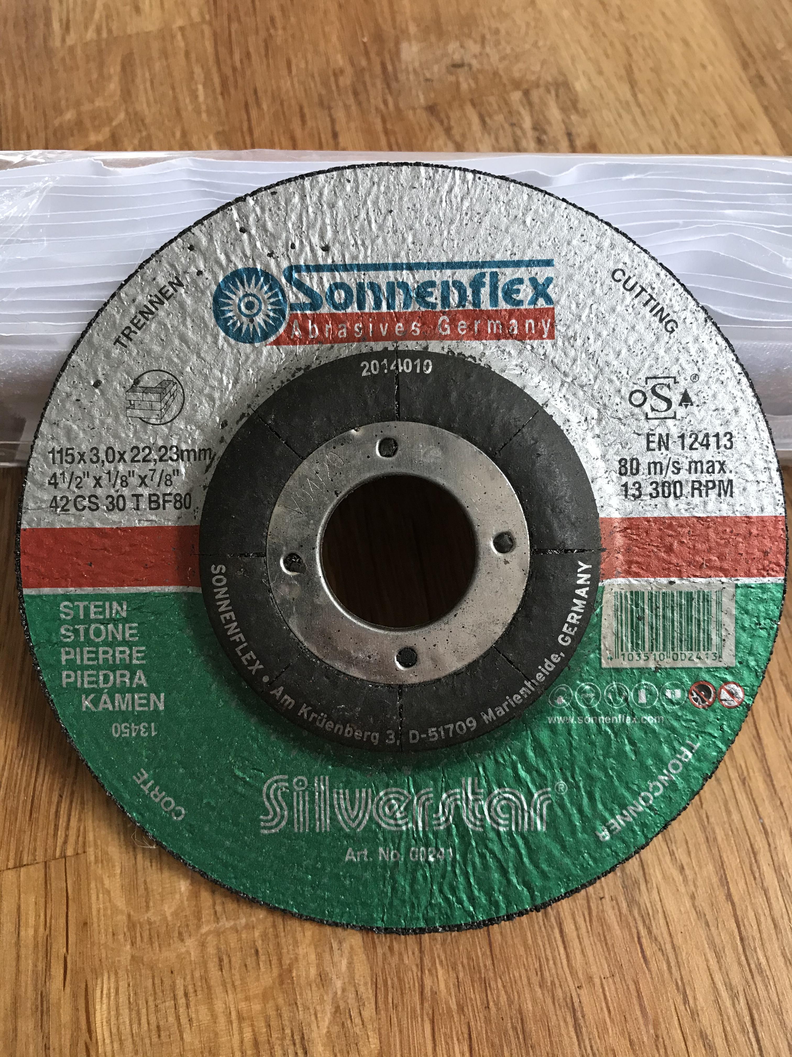

Are they labelled ‘for steel cutting’ etc...
Hi. Can you suggest a general good cutting disc for my mini grinder. A bit confused by the types. I will be cutting light steel, like mesh , drainage pipes pvc etc.. I have the disc shown... it says stone on it... am I correct in saying that is a general one? i know a diamonds needed for concrete etc. thanks
Hi. I am building an airtight house with masonry. There will be hollowcore slab which will have membrane at the external wall for sealing . My question is relating to the air transfer between ground and first floor. My intention is to have a suspended ceiling off the hollowcore, 150mm hollowcore and a structural screed. Does the screed act as an airtight barrier between ground and first . I ask because I will have underfloor downstairs but havent decided if we are going with any heating upstairs ... so one floor may be 21 degree and the other 18? thanks
