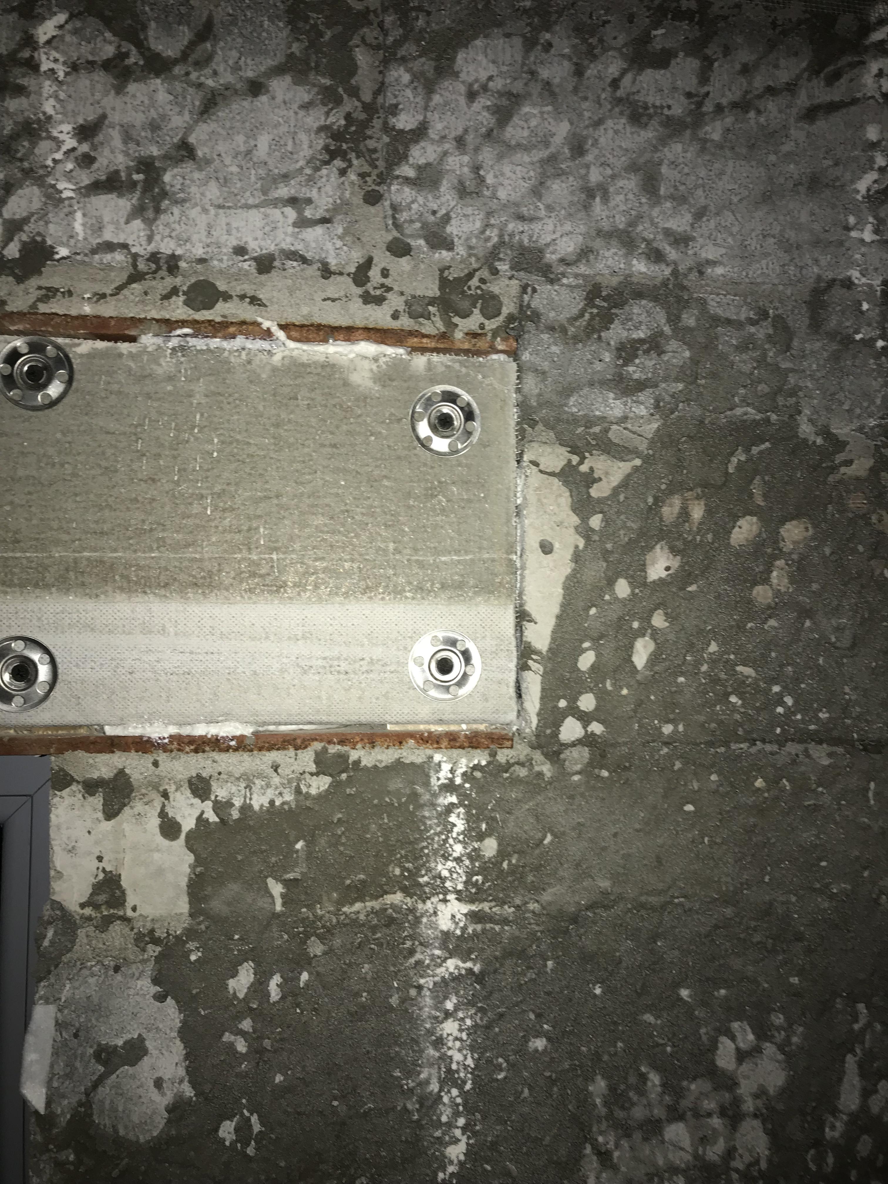

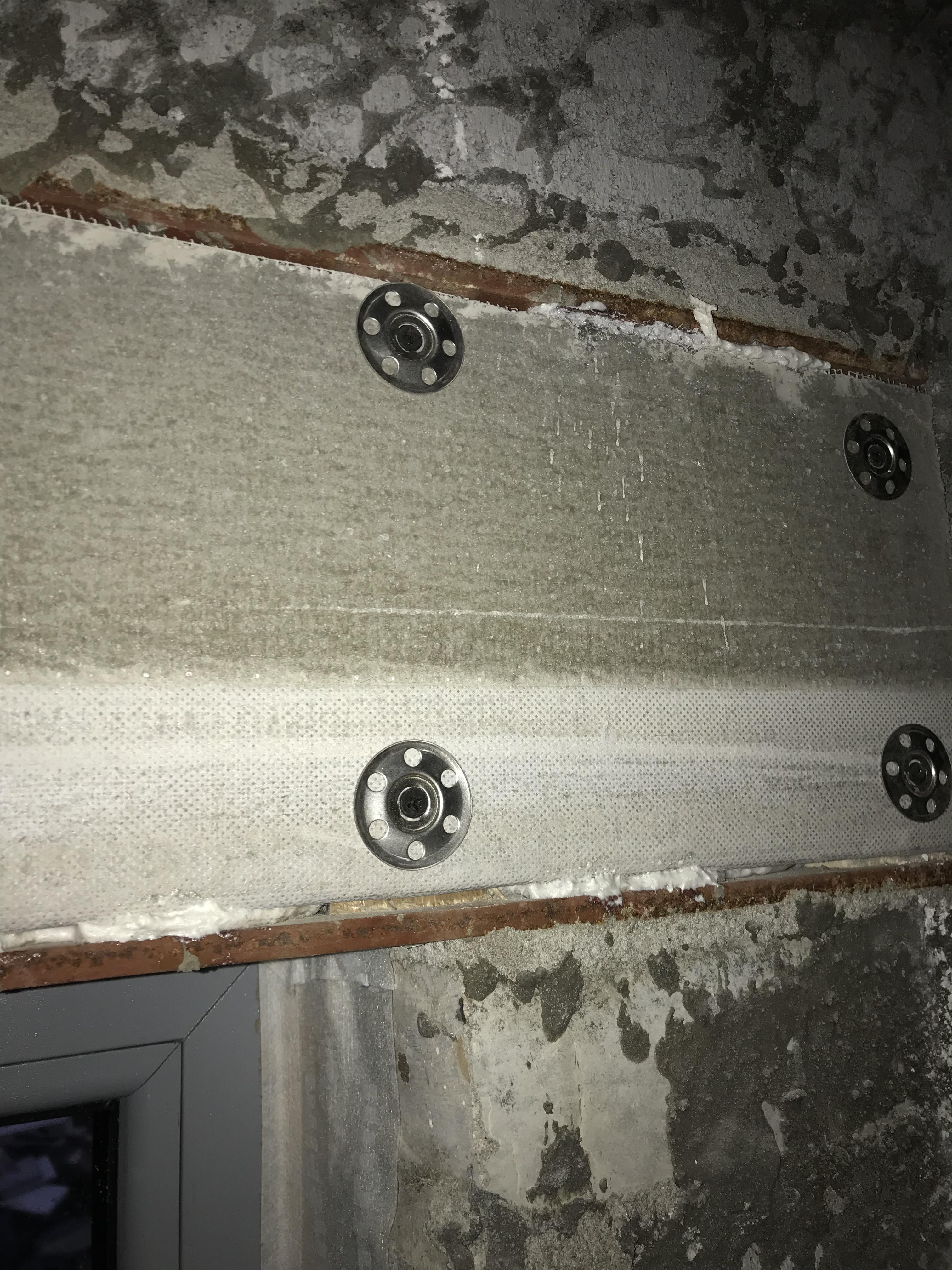

  1. Hi. Looking for advice. Sorry for long post. 13 years ago I built an icf house. At the time I put on a Weber material with mesh worked into it, then more Weber material, a primer and then an acrylic finish. I wasn’t around much when it was being applied. It was meant to be about 10mm thick . I have had many issues over the years with this render. The ICF has plastic webs, beams running through the wall from one face to the other and the render on the south and west side Is cracking vertically and horizontally along these . I investigated many times and it appear that there is only 5mm of render in total on some of these walls. I would say that the polystyrene bulged a little when the walls were being poured and that the walls were not rasped back before applying the render. Anyway , that’s the background. The result is that I have a fair amount of water infiltration in bad weather. I am planning to sell the house as I am moving to another (non ICF) house. I want to deal with this problem . I need to sort the west and south elevations. I had some plasterers and a contractor look at it and the solution we came up with was - leave existing render in place -fix galvanised metal mesh to the walls using the plastic webs as anchors. - scud , scratch and finish wall with sand , cement render …. I know that people say that sand cement render is not suitable for ICF.. I assume that is mainly because it is too heavy to bond to the polystyrene. if I have the metal mesh in place , that would guard against that issue? thanks for reading and looking forward to your response .

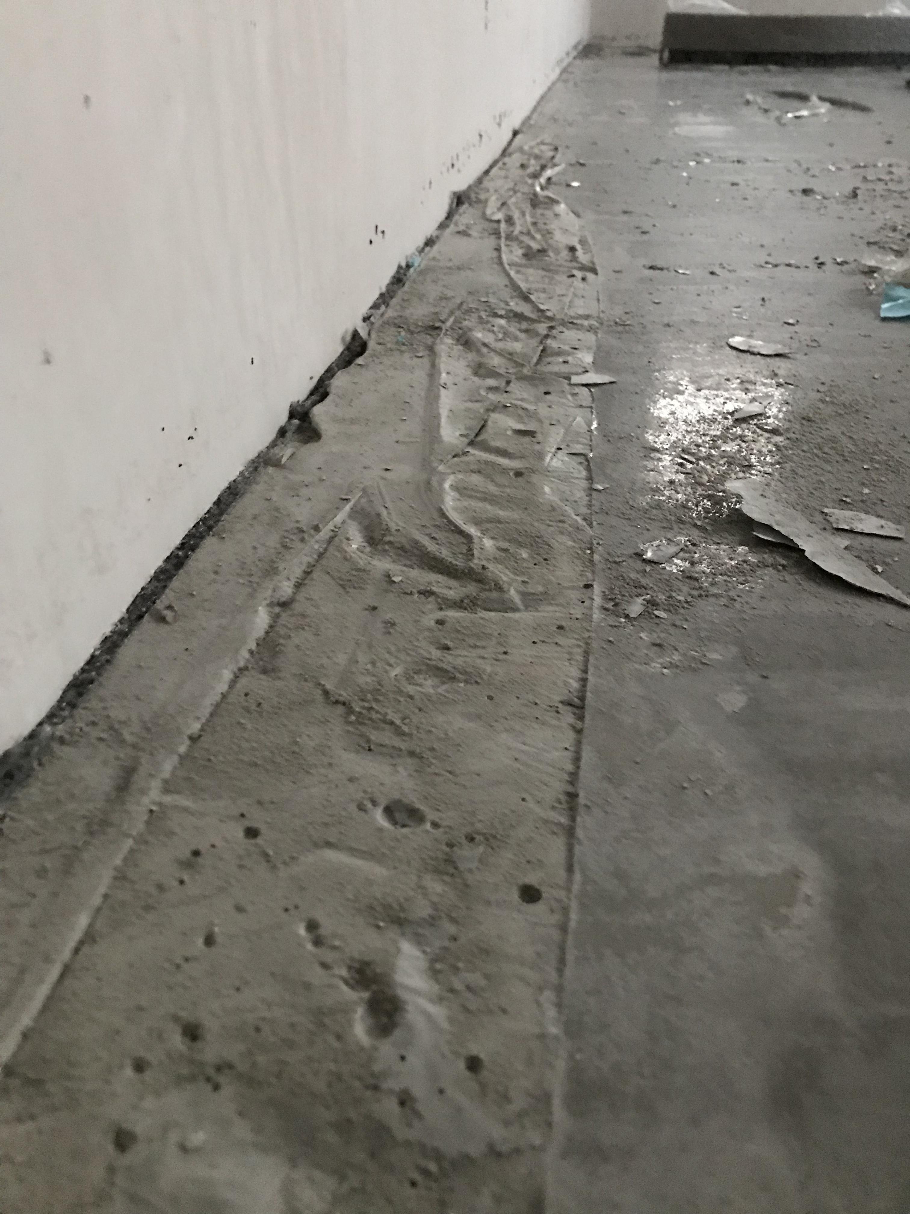

  2. Hi. I got my upstairs flowable screed done 2 days ago. I had to put plastic down on insulation and turn it up the walls. However , the plastic in some places fell down into the screed.. it was never taped up in some places. So when I cut back my expansion rolls and plastic today some of edge of the flowable screed is very rough. I’m only 2 days into the curing process so I am wondering can I deal with it now with a grinder with a specific attachment to level it.that’s not plastic u see in the photo , it’s just the shapes left by the plastic. Appreciate your input as always. Thanks

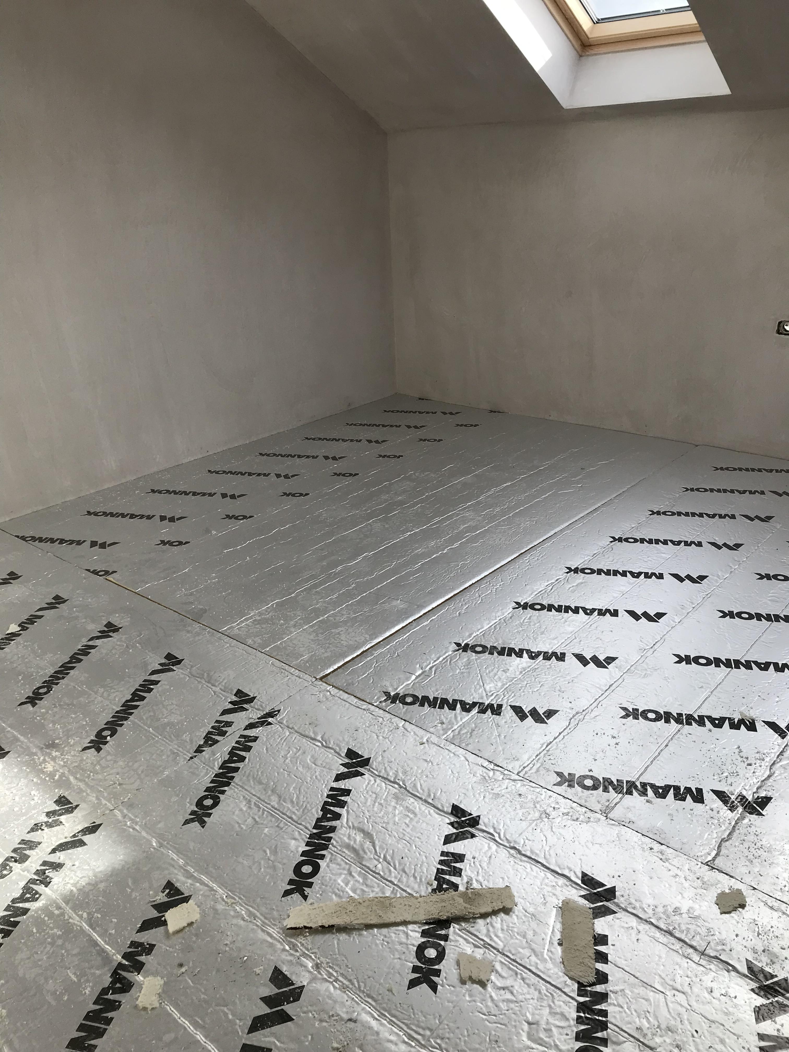

  4. Hi. I am getting ready to pour my upstairs floor. It will be a self levelling screed about 60mm think. I will be placing an 8mm expansion/insulation piece at every wall external and internal prior to pouring . The plumber asked that I run a sheet of plastic on the insulation and up the wall prior to him fitting his UFH pipes . What is the best way to do this…stick the insulation to wall first? and let the plastic run up outside that? I have walls plastered already . thanks

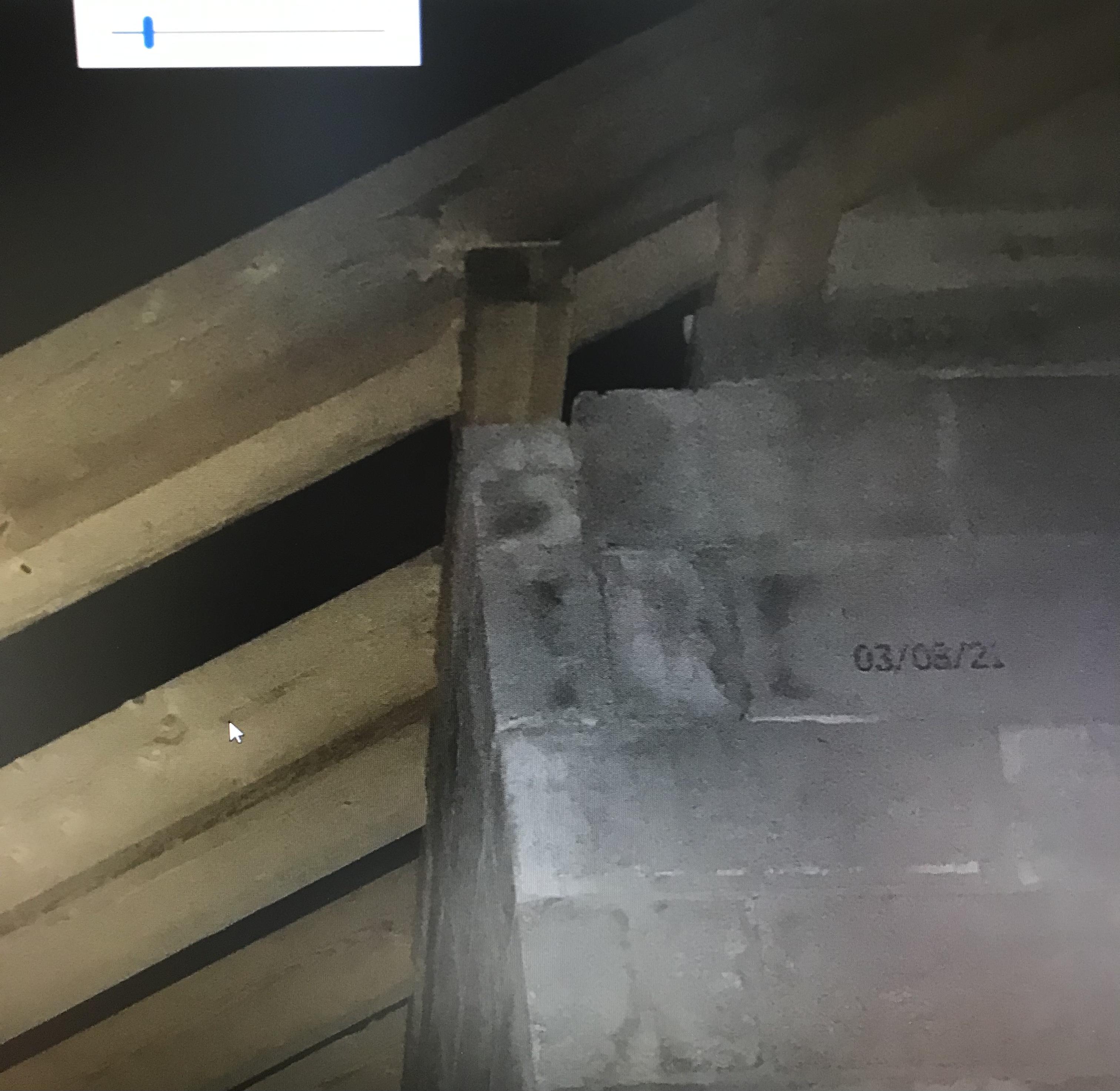

  11. Looks like not too far Into a 7x2 rafter. It’s a 4x3 wall plate

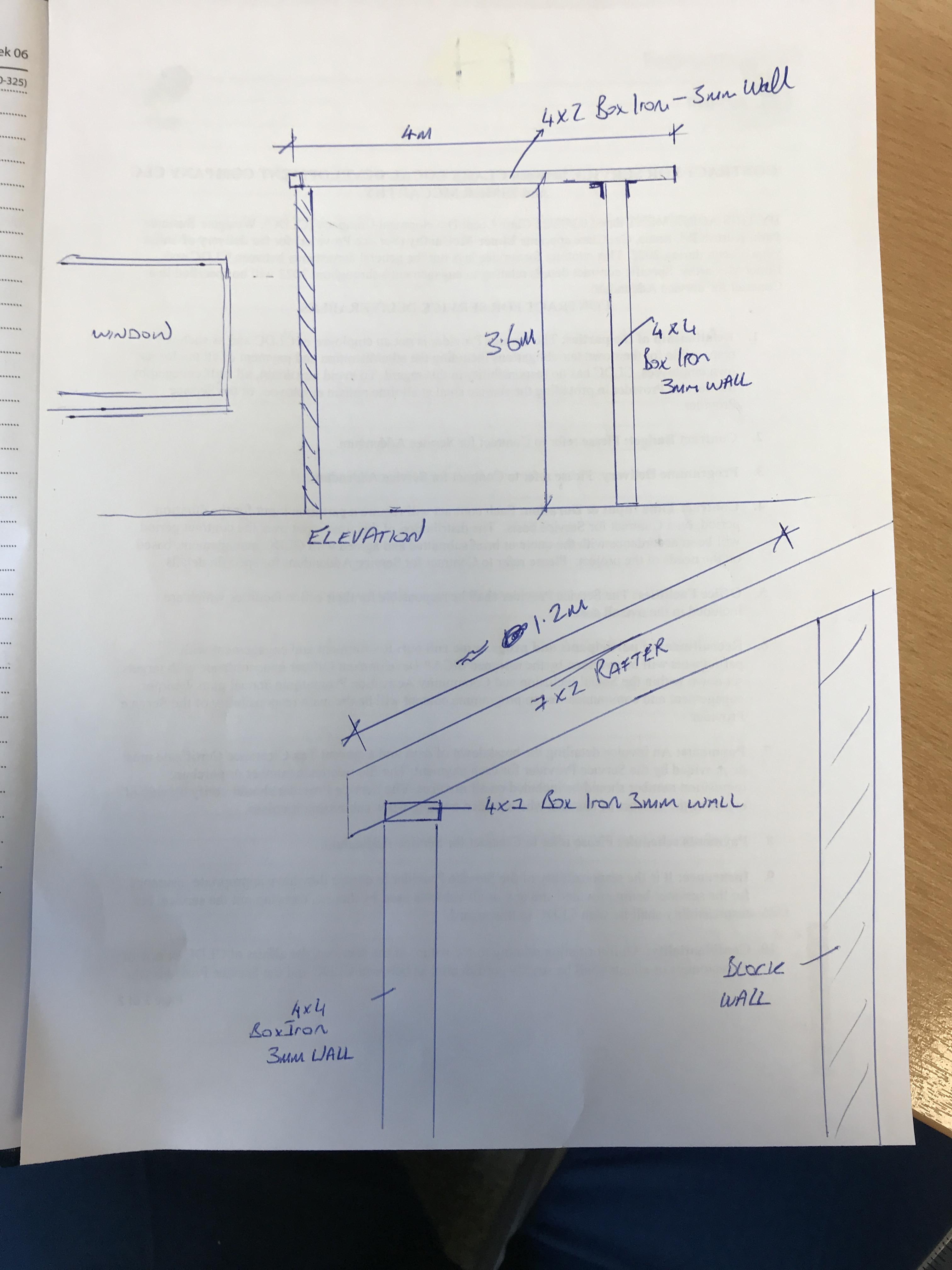

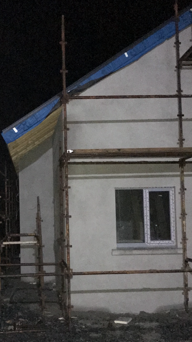

  12. Hi. U would like some advice please. I have a canopy section on the front of my house. It overhangs but about 1.2m. See photo. It is not supported at the moment because in all likelihood it doesn’t need it. It is a 7m long 7x2 rafter supported at wall plate level and further up by steel beams. So I am looking at putting in a column for the look and to prevent any possible sagging in that area over time . I am looking at bringing up a 4x4 galvanised box iron(3mm thinkness) and across that a 4x2 box iron birds mouthed into the rafter, mortared into the wall on on side and bolted to the Column on the other. The span will be around 3.7m. I am wondering will a box irons section 3mm wall thinkness sag over 3.7m ? And are the wall thickness of both ok. Like I said , the roof is build, these will slot in under it.. thanks
