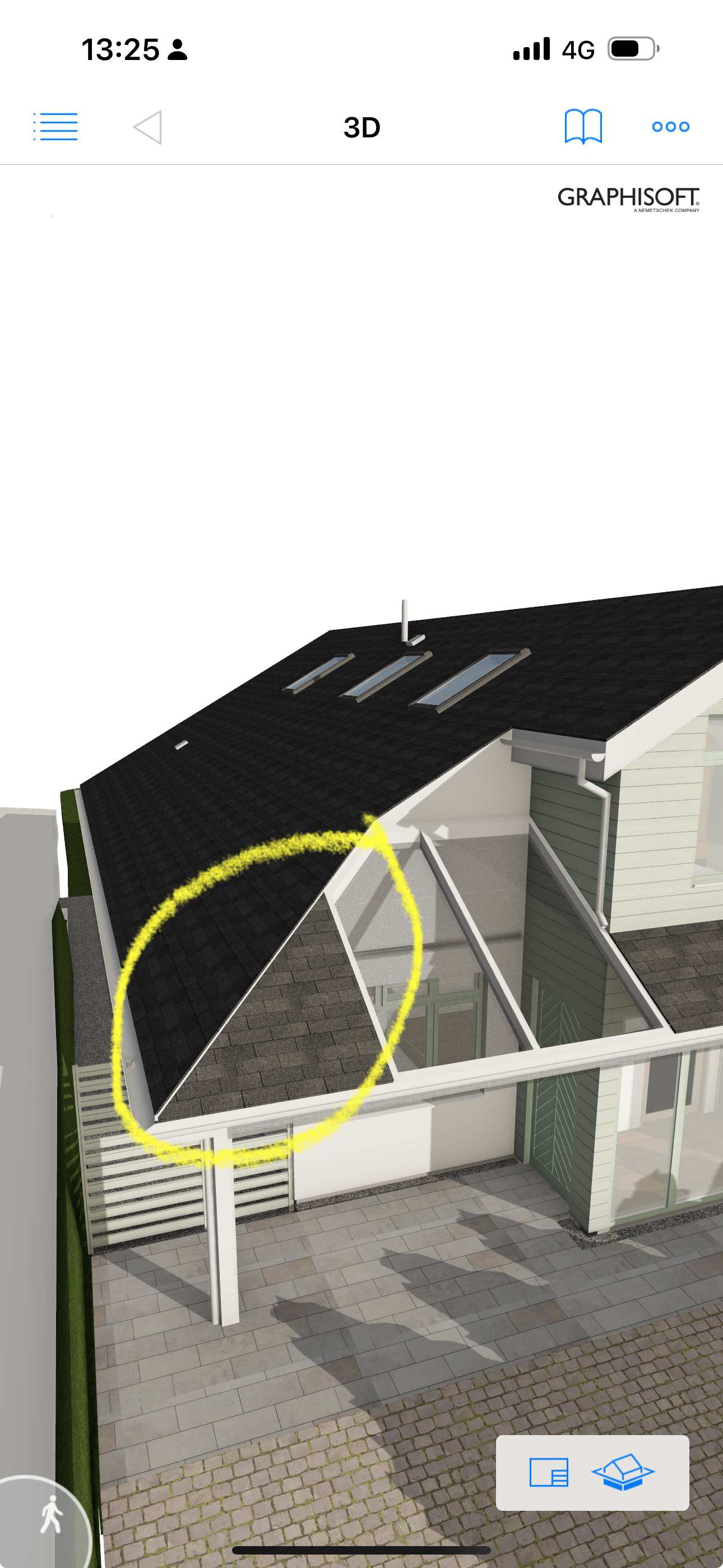

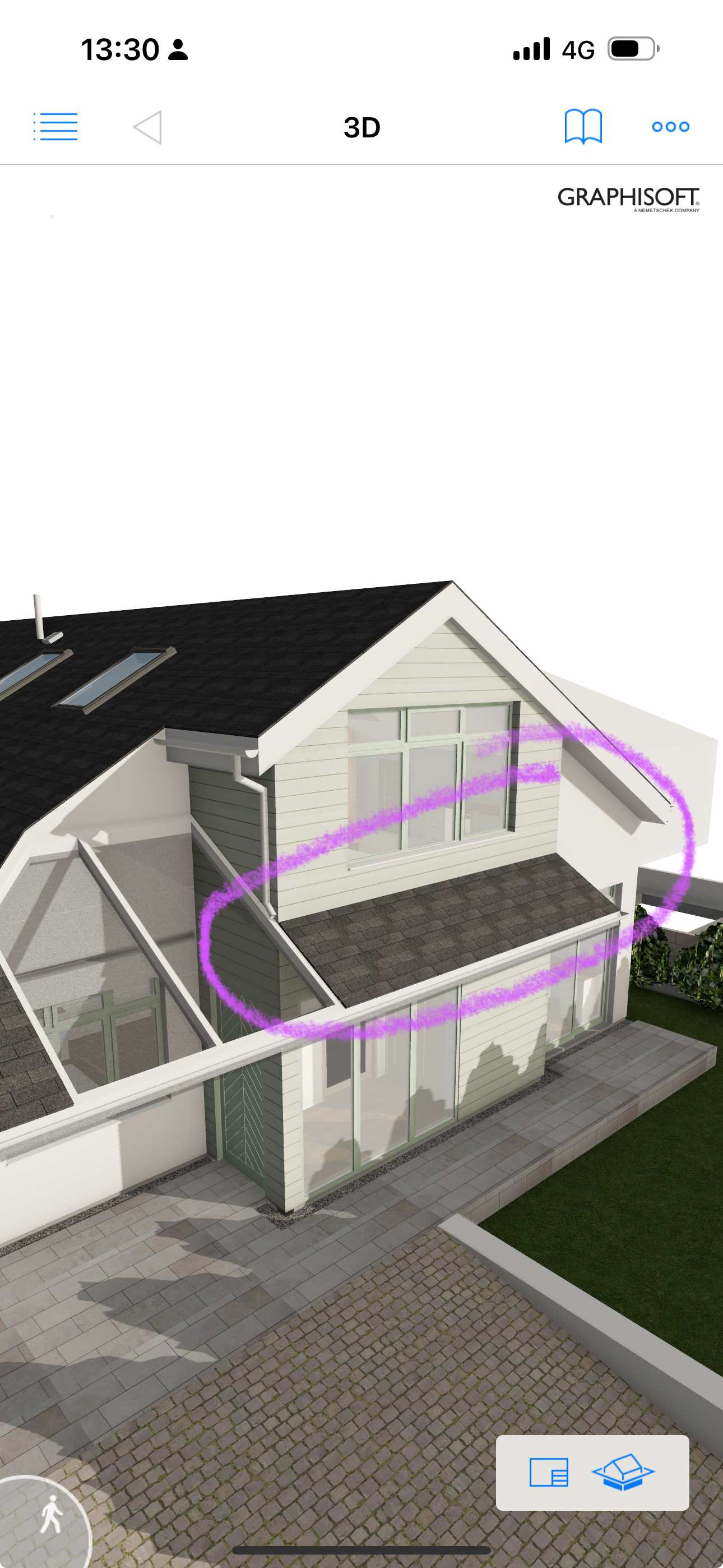

I’m doing my own roof and ok so far with all the straight edges but the detail on this end is a bit more technical so I’m looking for advice on how to do this. The roof will be osb solid deck with membrane, counter battens and battens. I’m wondering how best to create the hip and match it in to the roof and also any tips on joining the front porch overhang to timber frame? Thank you in advance for any advice.
