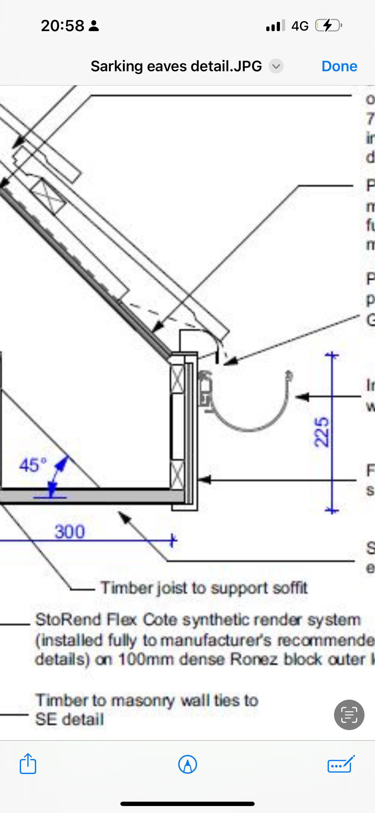

  1. I’m hoping someone can offer some advice. I’m a bit confused about the fascia detail and order of layers on a cassette roof. my layers are: osb cassette - breather membrane - counter batten - batten at the eaves I have rafter ends - battens - fascia with a fascia vent above and a drip tray tucked under the membrane. I’m trying to work out how to ensure any water has a smooth run over the fascia. 1. Should counter battens go all the way to the edge of the cassette? 2. Does the drip tray go on top of the over fascia vent or underneath? 3. Usually the fascia would be pushed up to the underside of the tiles but I would have thought doing that in this instance would force the membrane uphill. The only way I can think to negate this is to finish counter battens early. I feel like I going down a rabbit hole and there must be an easy solution. Hopefully someone can help. Many thanks
  2. Trying to find out the optimum nail spacing for vertical counter battens fixed to rafters. I’m thinking 400mm ish?
  3. Ps. In this diagram the fascia is flush to the roof sheathing… this would seem to make sense as the breather membrane is below the counter battens so wouldn’t want to create a lip that could trap water. Am I right with that?

  14. Many thanks… most people I have asked have suggested doing fascia/soffit first but I’m not sure why. Here’s a drawing that is more similar to what we will need. It looks like the eaves ventilation strip is doing the job of supporting the lower tiles… is that correct?

  20. In trying to work out eaves tray and fascia details. Here’s the drawing from my architect but seems to be missing the counter battens. Presumably the eaves tray will need to lay under the counter battens which means it’s the first thing I need to install, even prior to membrane. Am I right in thinking this? Also wondering if the fascia backer board should fix directly to rafter ends but in this picture it appears there are battens attached to rafter ends and then the fascia board. Any thoughts/advice very welcome. Thank you
