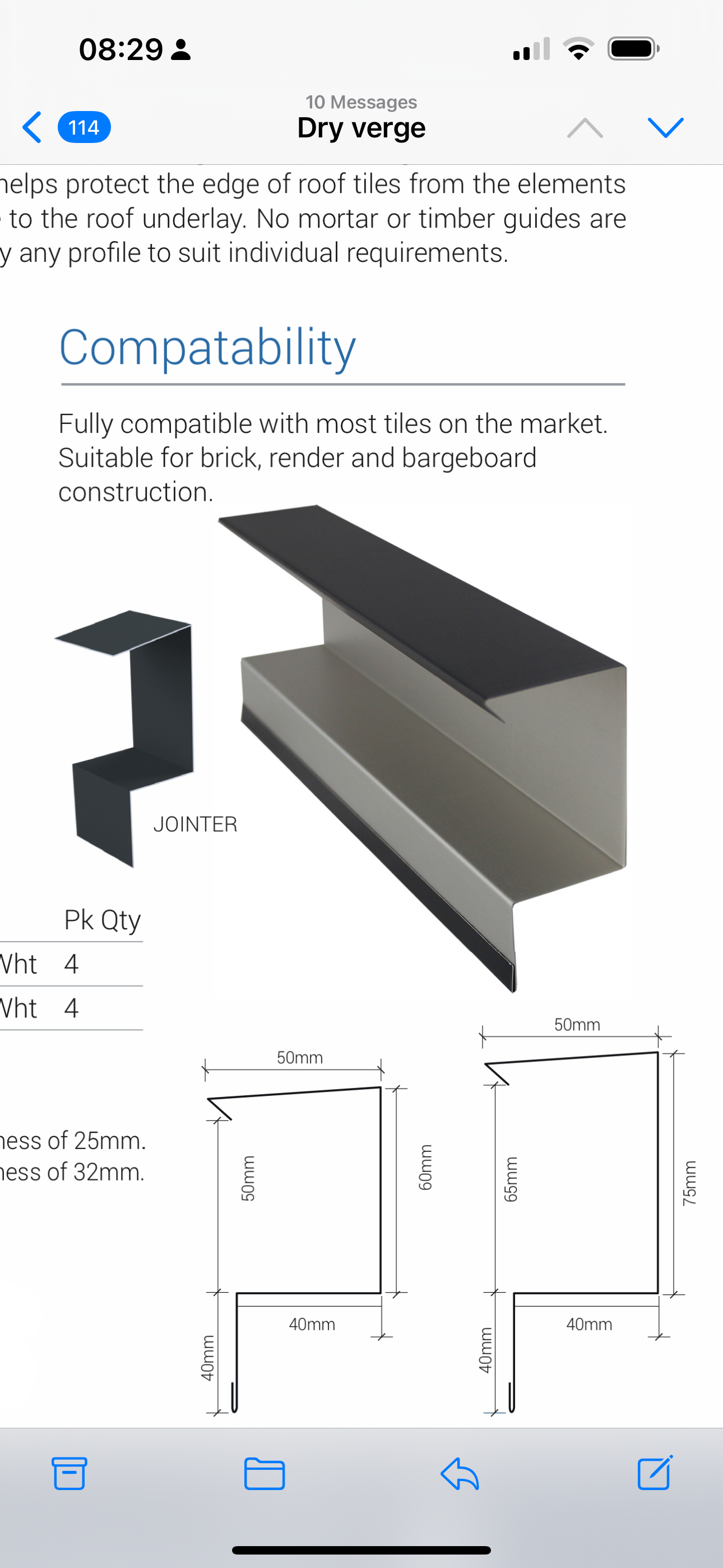

I’m looking at this dry verge by Kytun for tiles. I can see this working for thin slates but for l tiles (flat profile) there will essentially be a step where each tile overlaps the one beneath which means there would be a large gap into the dry verge where water could easily get in… am in missing something?

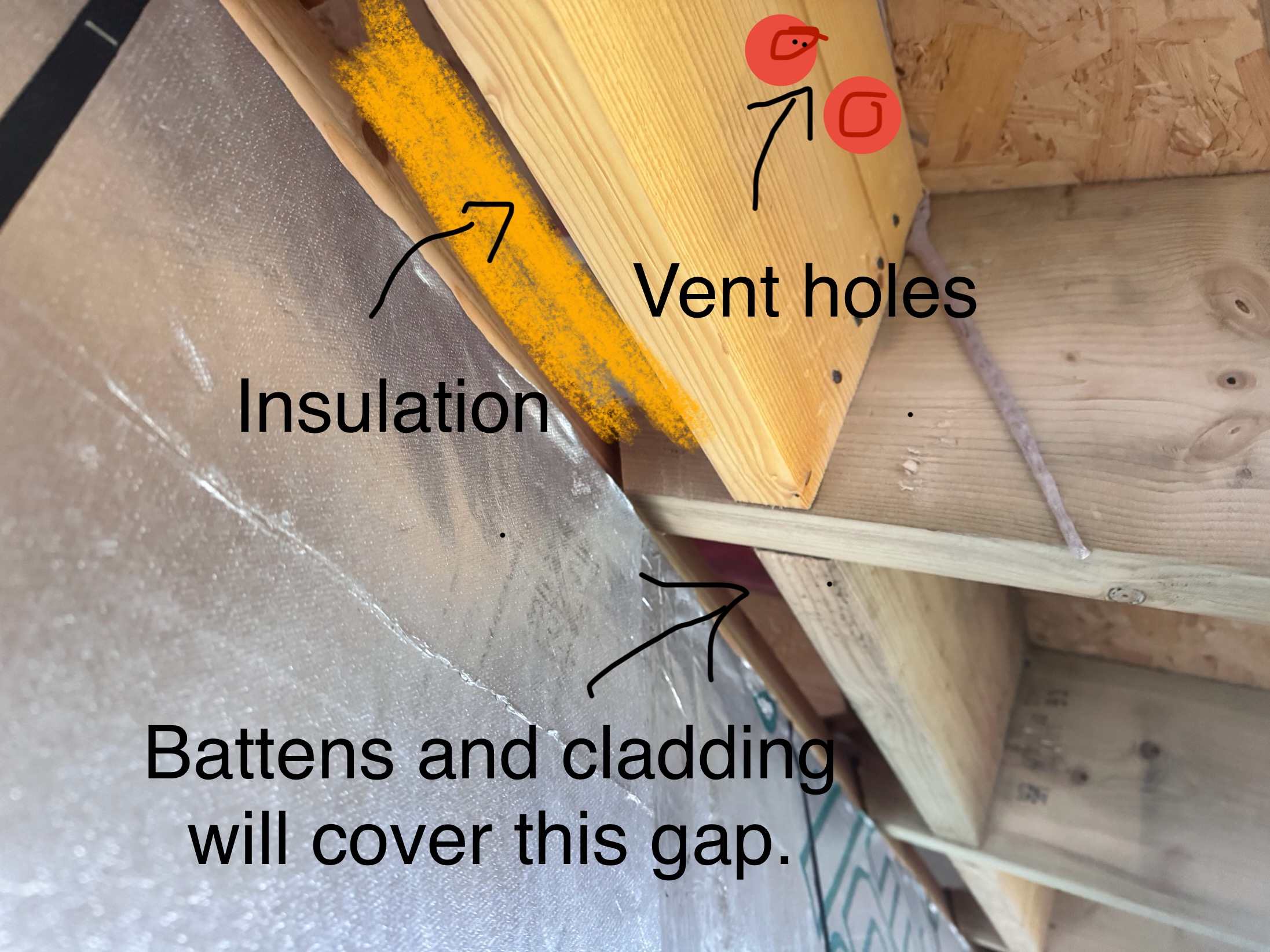

thanks @scottishjohn sorry I’m not being very clear basically a normal roof but sections made in the factory and then assembled on site. It’s a cold roof. yes vaulted ceilings. The roof layup from inside to out is: plasterboard - batten - ybs insulation - osb - insulation between rafters - air gap - osb - breather membrane - counter batten - batten - tiles Guidance from lots of sources is that airflow is needed between insulation and top osb. I’m just not sure whether I also need to cut the top membrane or because there isn’t a ridge which means air can flow across, whether I can get away without cutting. thanks for all your thoughts.
Factory made in sections built around rafters; osb - air gap - insulation - osb

Thanks yes I have a vented dry ridge and airflow between tiles and breathable membrane. The question is about airflow beneath the osb as it’s a cassette roof. I have 50mm air gap that runs from eaves on one side between rafters and to eaves on the other. Not sure if I should also be cutting the membrane at the top as well but would rather not if it’s not necessary.

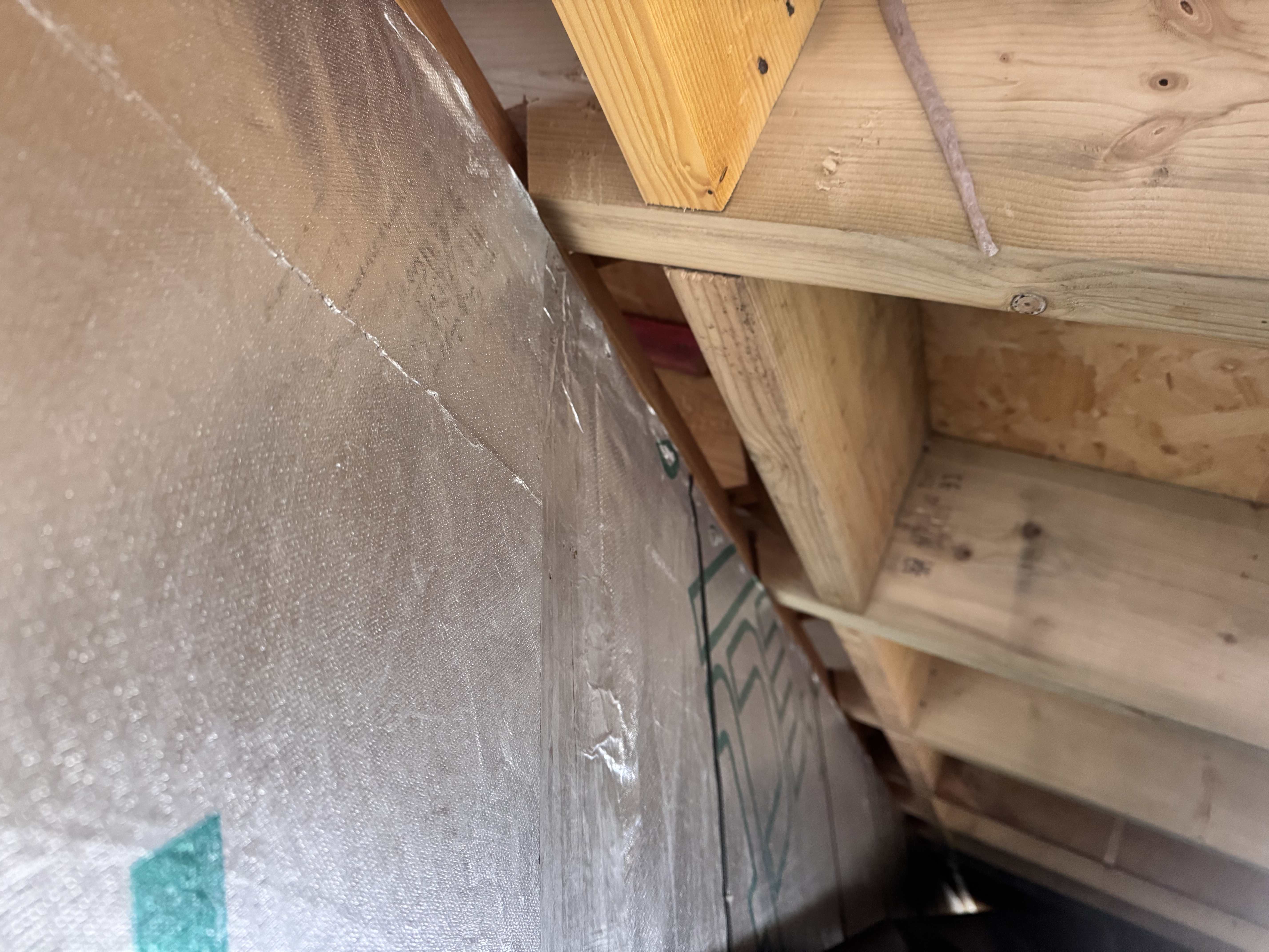

It’s time to make the cut across the ridge of the breather membrane… cassette roof construction. However it just doesn’t quite feel right after working so hard to protect the building and keep water out. I realise that I need airflow from the eaves and above the insulation to the top of the roof but with this design there isn’t av ridge beam so air can actually flow from eaves, over insulation upwards and back down to eaves on the other side… I’m wondering if this is sufficient to avoid the bed to cut the membrane and help me sleep easy knowing that the roof is watertight…. I’m sure this is a can of worms but any advice welcome. Thank you 👍
