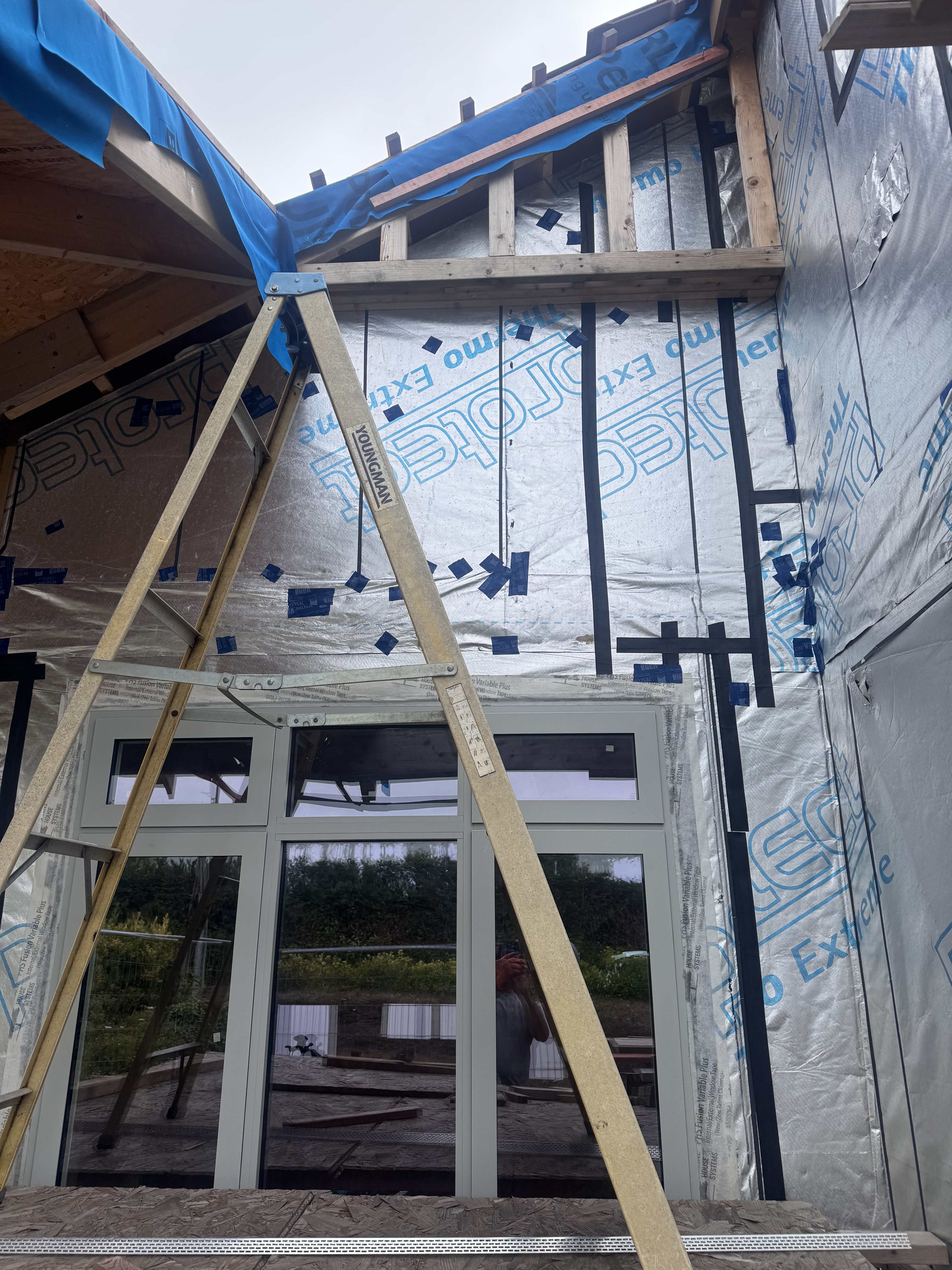

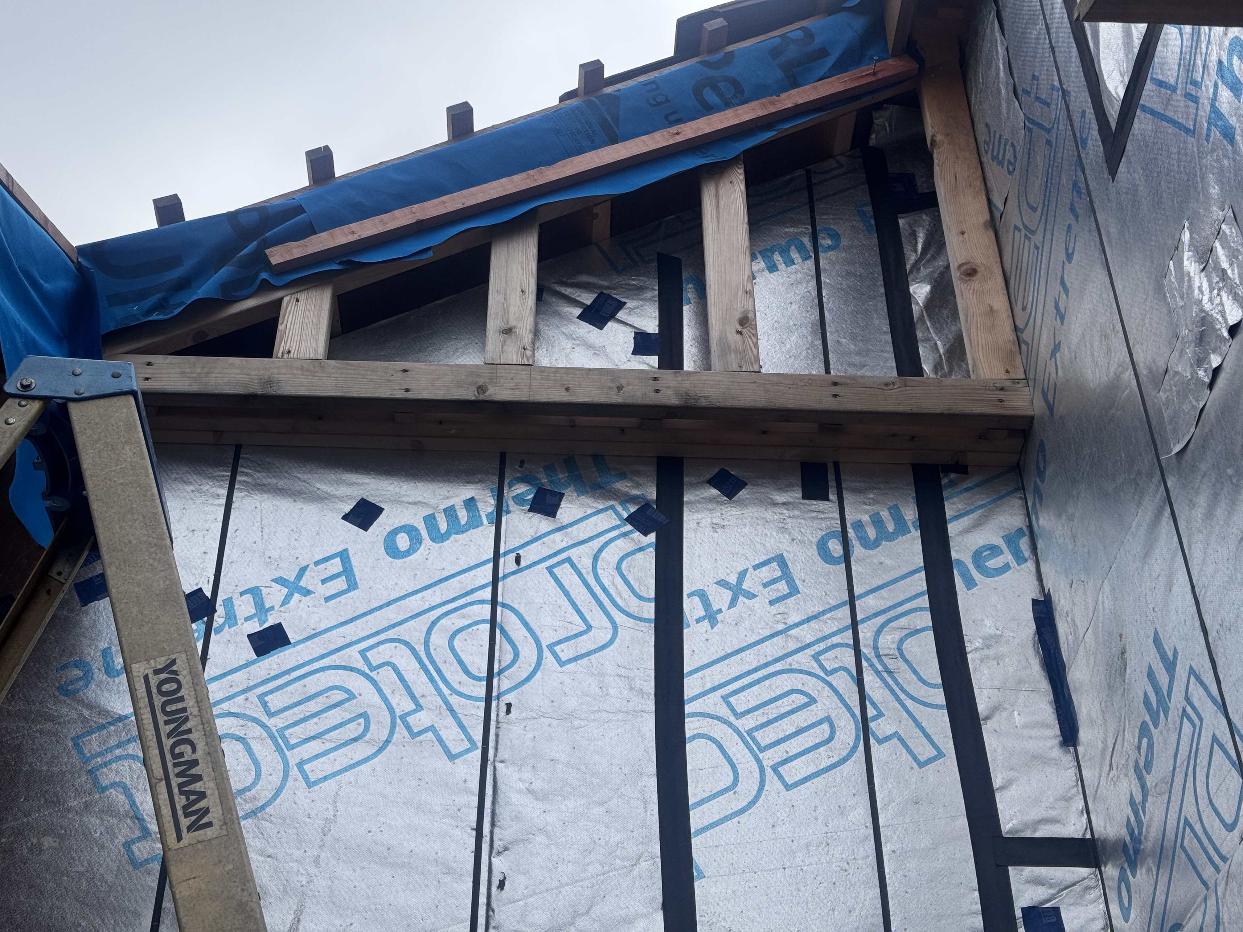

  2. Hi. Hoping someone can offer some advice on this. I’m going to be glazing an overhang section adjoining the external of a timber frame. I’m trying to work out detail above the glass. Beneath the glass will be straightforward; battens, render board, render bit above the glazing the render board will fix directly to the timber studs added for reinforcement. This will need to run right up to the roof edge as there’s not enough thickness for render + barge board but don’t see this being a problem as I will have verge flashing. My main problem is working out the junction between render and glass. Presumably need to add a lead flashing horizontally on top of the timber . Render board to overlap lead flashing with bell drip. The flashing can then overlap the top of the glazing. Any advice or thoughts on this. Ideally I’d like the extra timber stud not to come out as far but carpenters did this to provide better support for the glass… there is a central rafter still to be fitted to split the gap ie; for 2 panes of glass. grateful for any advice on this. Thanks

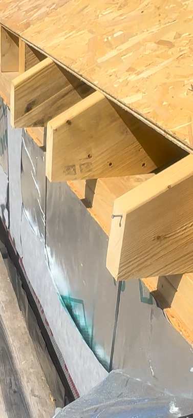

  3. I’m running into difficulty framing the corner between barge board and fascia. Here’s an old photo (we’re a lot further on now) but I think it illustrates what I think may be a problem. Rather than birds mouth with the bottom of the rafter extending beyond and below the wall the rafter is cut flat to the wall plate which leaves no overhang of the wall. If planned on fixing the soffit to the bottom of the rafter bit it leaves little overlap between the top of the wall and soffit. I didn’t think it was a problem but I think makes it more difficult to create a box corner. For example the barge board on the verge ideally needs to come down lower than the fascia. When I’m on site next I’ll takes some photos of where I’m at but wondering if anyone has any thoughts? Thanks

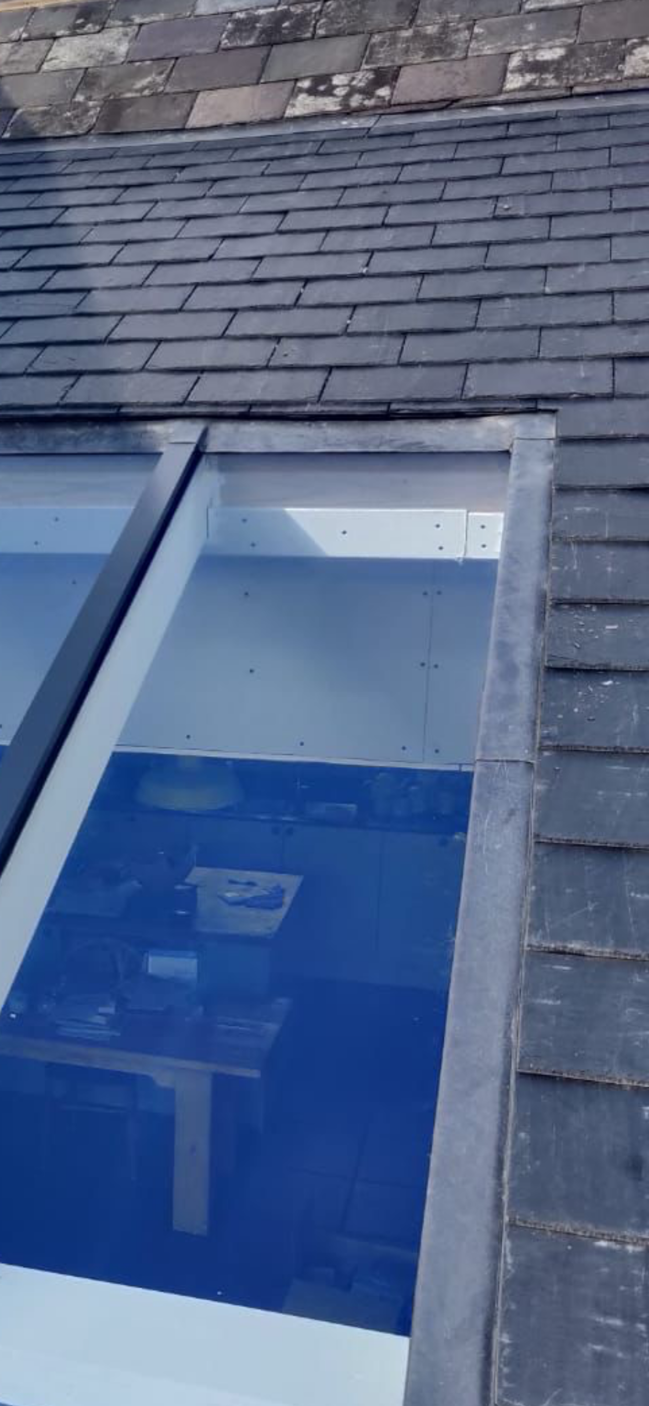

  12. I’m trying to work out the detail of a skylight on an outdoor lean to. I think a rafter glazing bar with laminated glass would be good. One edge is along tiles and I think it probably needs to be flush to the tiles so that the gutter line is correct. I’m looking for suggestions on what I would need to make the tile - glazing junction? Many thanks

  20. We’ve just had joiners framing out for our porch overhang. We wanted to include a glazed section to let light into the window below so they’ve left a gap and also reinforced above with timber framing. I’m looking for suggestions on how we could glaze this… I’m thinking of a couple of rafters to create 2 rectangular sections and glaze in there (slightly different from architects impression) but I’m unsure about how to go about framing and flashing a glazing unit. Also whether the framing above is necessary as we were going to batten, board and render that section but it’s now protruding and would seem to complicate the airflow too… any ideas and advice welcome as always. Thank you
