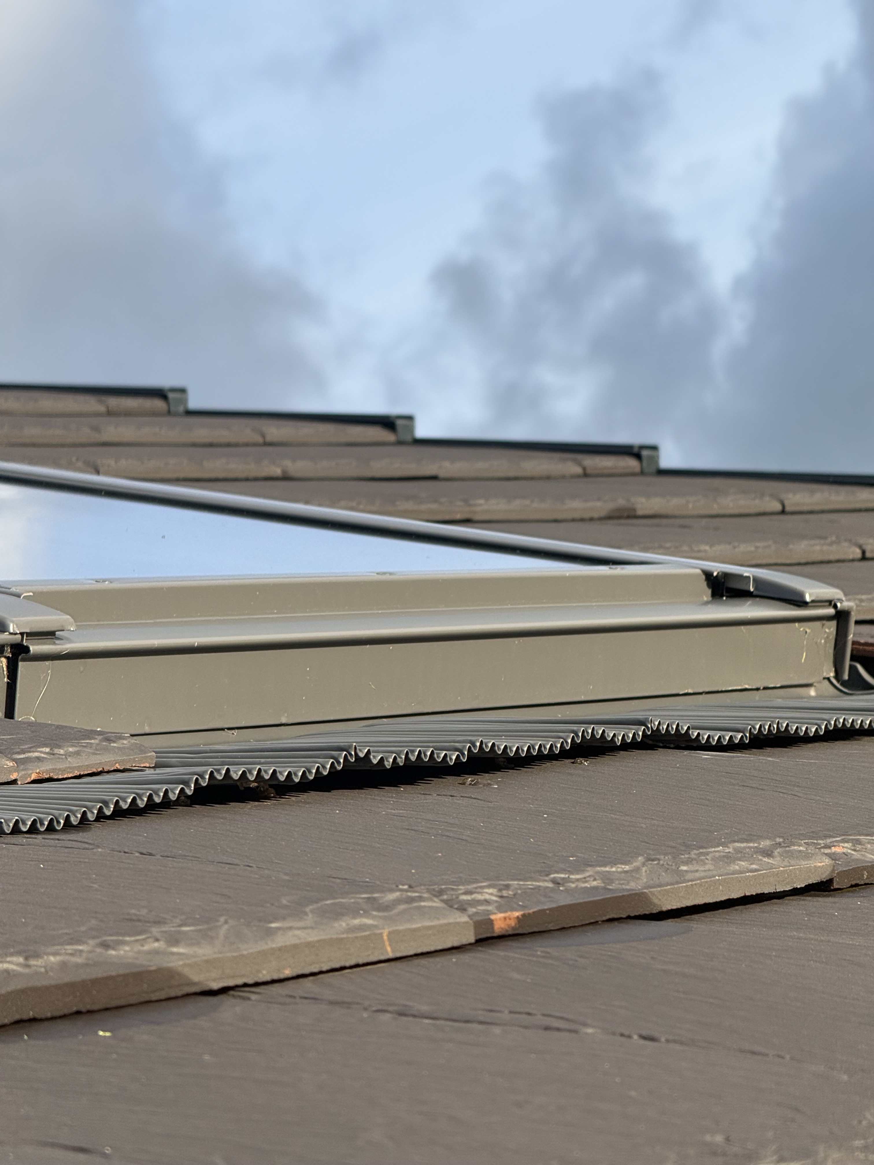

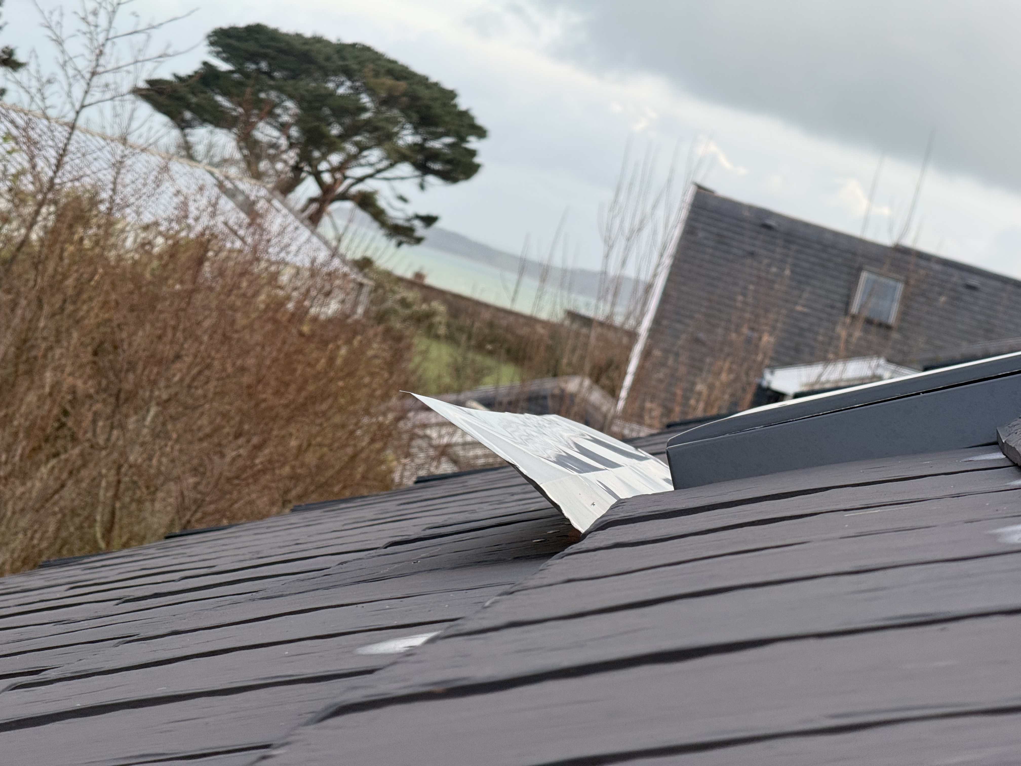

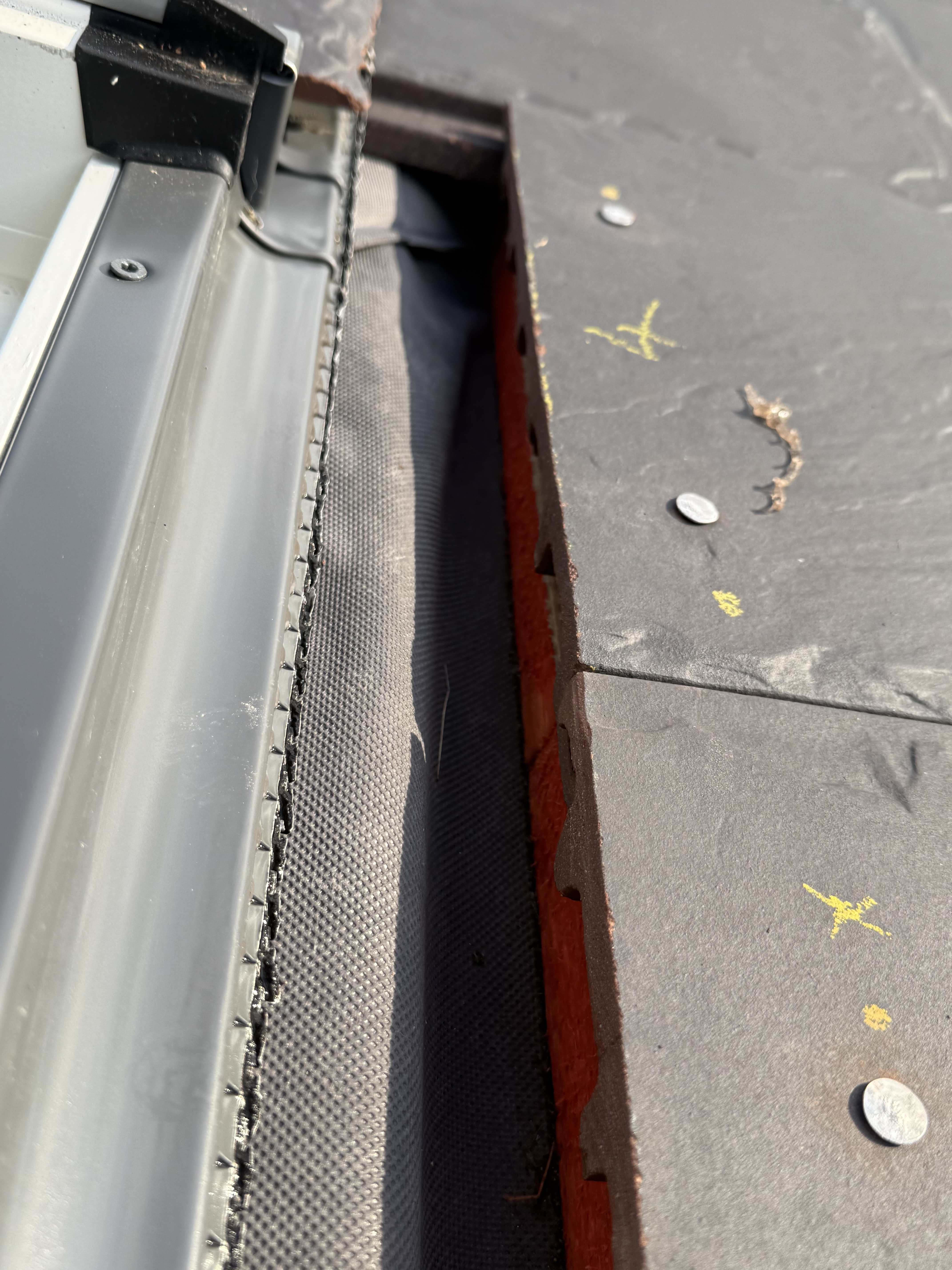

Thanks that’s helpful. Hoping I can switch the apron out without taking out all of the tiles around the window. Keeping fingers crossed that just the lower ones will be ok. struggling to bend the edt back into position so may need to replace those too but would rather not if possible so any suggestions would be welcome. Also wondering if there’s any way to improve the overlap at the edges. moving the tiles across the whole roof isn’t an option but maybe some kind of metal strap screwed into the batten and extending over the apron. Thank you for all the advice. Racking my brain here trying to figure out solutions so any experience/advice very welcome 👍
Advice from VELUX is that I need more overlap with tiles at the ends to hold it down. With these interlocking tiles (Sandtoft new rivius antique) and the wide gauge in not sure how to achieve this or whether there is any kind of workaround. Any advice greatly appreciated. Thank you
All of our velux aprons have damaged in the storm. One has sheared off completely (the malleable type for tiles EDW). We have some others that are flat which I thought would be better but are bent upwards and won’t reshape into position. Any ideas and best way to fix and long term solutions? ta
