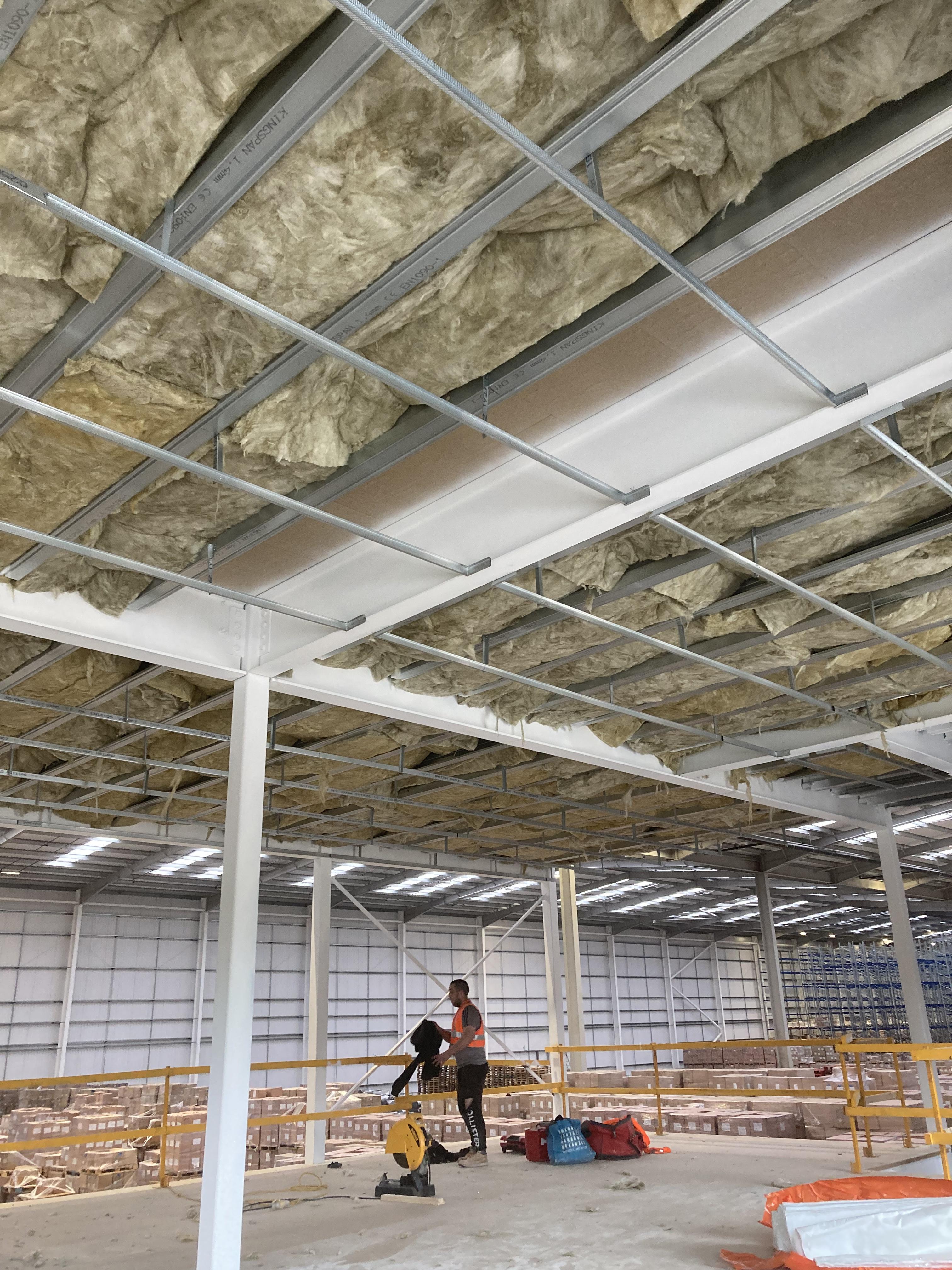

  12. Below is one we are doing today Steel joists 140 acoustic insulation 100 mill slab Dropped MF ceiling Two layer of 15 mil sound block The regs are so tight compared to even five years ago

  17. I’ve just taken delivery of Rockwool acoustic slabs for some offices that we are doing 140 acoustic roll then 100 mil slabs Around £25 per pack of slabs Rarely get asked for any other brand
