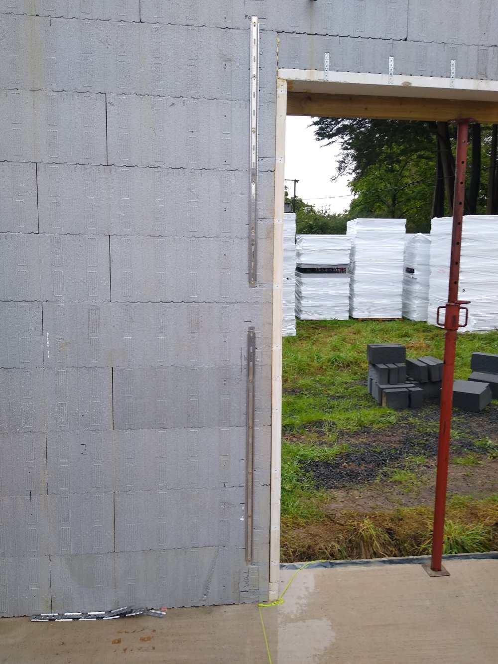

Internal wall connection to ICF
LaChab replied to metalgear2k2's topic in Insulated Concrete Formwork (ICF)
FWIW, our SE approved using starter bars (frame) screwed through to the core. Wouldn't dream of cutting back the inner insulation! -
