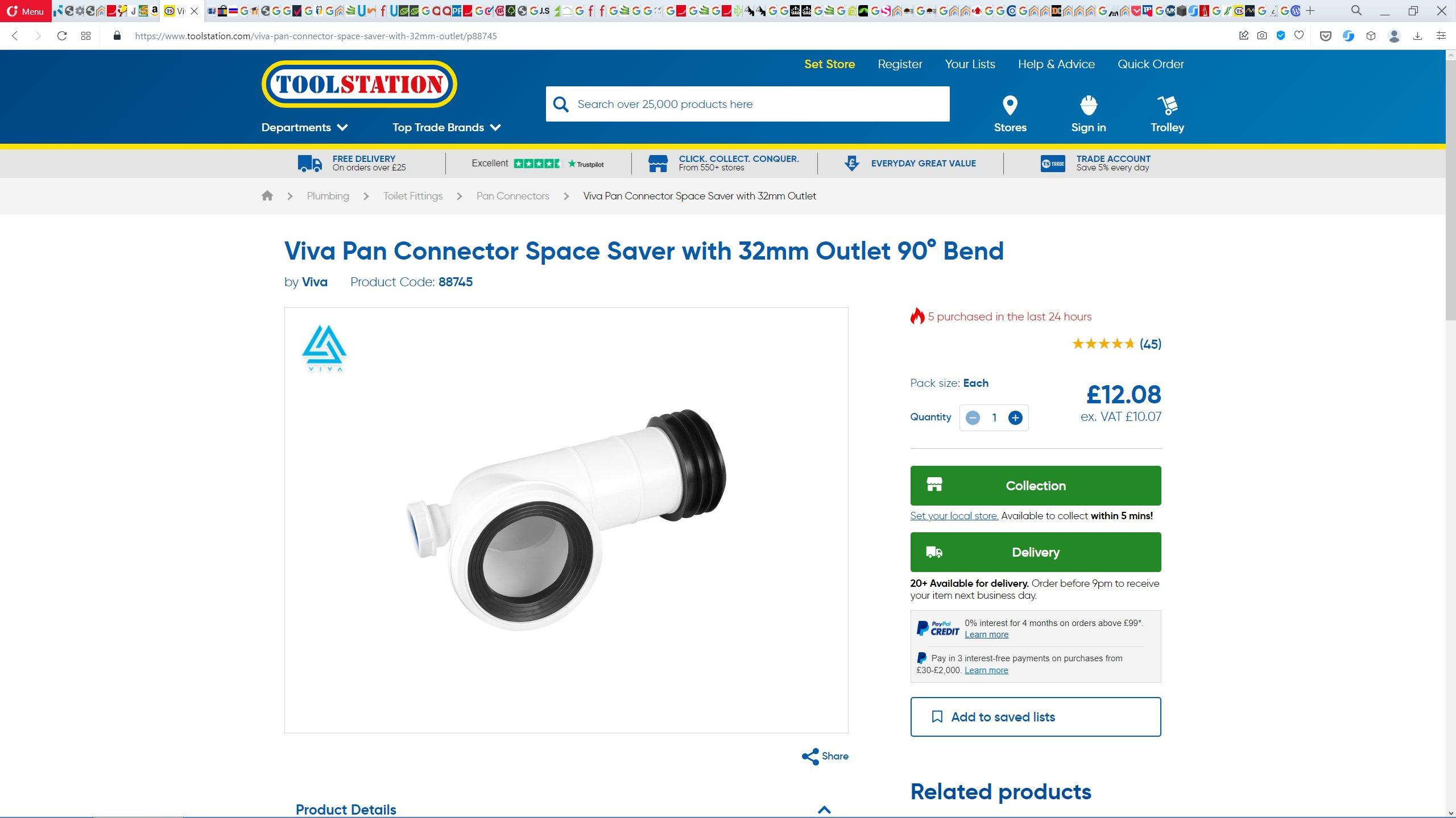

@Gone West Thanks for looking out the photo, that's super helpful. I hadn't thought about using a 50mm AAV. That makes it much easier. Those "dual" pan connectors are rather brilliant. So much to find out about!
@Gone WestThanks for the response and photo. That toilet's very neat! Did you have 1 or 2 soil pipes coming up through the slab? I my ramblings I've come acros this, which looks made for the situation....

Hi, All suggestions gratefully received.... I've looked through loads of posts but can't find an answer! I'm sure this should be really simple, but I can't think where I should bring the soil pipe up through the slab for the downstairs cloakroom. Should I place it directly below where the WC will go, or to the side, perhaps 500mm? If it goes directly under the WC, which seems easy, then I don't see where I connect the wash basin. If to the side, then how far, and is there room for a "Y" above the floor. And are pan connectors allowed to go sideways. And where does the stub stack with AAV go? I'm having a floating chipboard floor with 300mm of insulation under it, so a bit of "wiggle" room perhaps..... I'm just keen to have the right solution so there's no problems actually plumbing things in. Thanks
