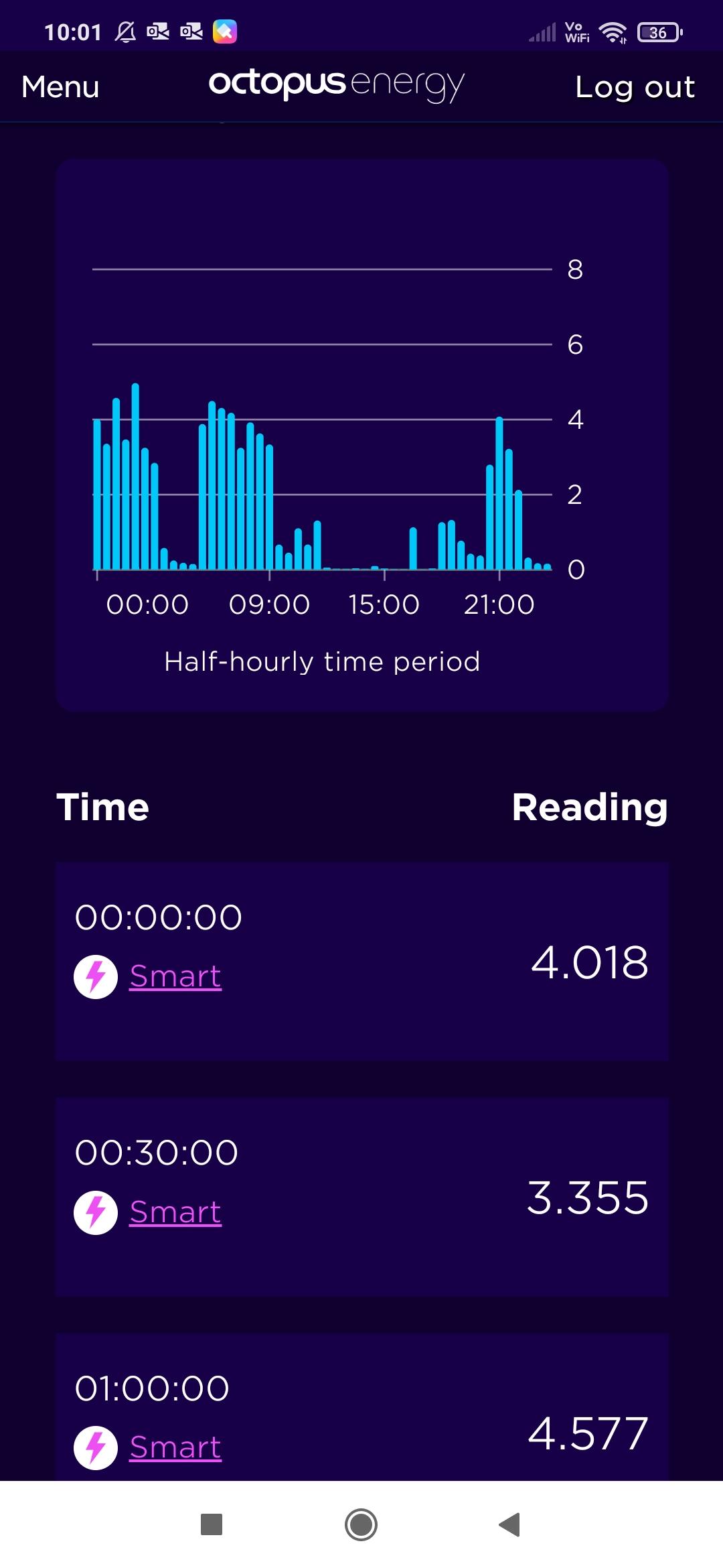

  1. ? Because of the ongoing saga with the heating and electric use I know exactly what our usage is but then when I saw the app I thought great, half our meter readings easier to monitor usage.... One particular day they had our total energy use for a 24 hour period as 82 units. Our HP use during the same 24 hour period was only 26 units so they are saying we used over 50 units of 'other' use during this time period. This is at a day when we had a really good solar use and charged everything up, did washing etc and we also have hot water heated with the ASHP when the 830pm Octopus cheap rates come on but this has been minimal as the solar has been doing particularly well in March.
  2. Sorry I posted it in the wrong place the first time. Now I'm sure you're all sick of my saga with energy use but it now gets even more complicated. You will recall I was monitoring my energy use for part of January, all of February and part of March. Once I'd managed to get the heat pump settings a bit more consistent we were using between 20-40 units of heat pump use a day and no more than 8-10 units of other use. We moved to Octopus and I've been getting myself completely tied up with their app and our half hour smart use data because it's being recording some absolutely horrific figures - at it's lowest around 45 units of electricity a day and at its highest 123 units a day which I absolutely couldn't get my head around for a 24 hour period with major use between 2-5am when we ended up programming the heating off during those period and setting programmes for each room (thanks @Ultima357) I've been checking out heat pump meter reading and that was only between 17-39 units a day (even with the recent cold snap) and I've been monitoring our other use. Finally I've gone to taking good old fashioned meter readings from the box and checking every day. Luckily I had a photo of a meter reading the day we moved 12271 and a photo this morning gives 13811 so the past 41 days totals 1540 units which is pretty much in line with what I'd expect given we have had some cold days but also good sunny days when we have had minimal other electricity use as we have been using solar. The app for Octopus, adding up every days units gives a total of 3052 for 41 days - over double!!! I've just rung them to be told the smart meter readings are normally accurate (really)! Explained I'd got pictures of the electricity meter pretty much every day and as I'd been monitoring our electric use for 3 months I know the app can't be right. All went very quiet when I asked them to tell me what the meter reading was they have when they realised the app cannot be accurate at all given the opening meter reading and what they have now. They are looking into it..... I'm not going mad. I'm not going mad. I'm not going mad.
  3. Now I'm sure you're all sick of my saga with energy use but it now gets even more complicated. You will recall I was monitoring my energy use for part of January, all of February and part of March. Once I'd managed to get the heat pump settings a bit more consistent we were using between 20-40 units of heat pump use a day and no more than 8-10 units of other use. We moved to Octopus and I've been getting myself completely tied up with their app and our half hour smart use data because it's being recording some absolutely horrific figures - at it's lowest around 45 units of electricity a day and at its highest 123 units a day which I absolutely couldn't get my head around for a 24 hour period with major use between 2-5am when we ended up programming the heating off during those period and setting programmes for each room (thanks @Ultima357) I've been checking out heat pump meter reading and that was only between 17-39 units a day (even with the recent cold snap) and I've been monitoring our other use. Finally I've gone to taking good old fashioned meter readings from the box and checking every day. Luckily I had a photo of a meter reading the day we moved 12271 and a photo this morning gives 13811 so the past 41 days totals 1540 units which is pretty much in line with what I'd expect given we have had some cold days but also good sunny days when we have had minimal other electricity use as we have been using solar. The app for Octopus, adding up every days units gives a total of 3052 for 41 days - over double!!! I've just rung them to be told the smart meter readings are normally accurate (really)! Explained I'd got pictures of the electricity meter pretty much every day and as I'd been monitoring our electric use for 3 months I know the app can't be right. All went very quiet when I asked them to tell me what the meter reading was they have when they realised the app cannot be accurate at all given the opening meter reading and what they have now. They are looking into it..... I'm not going mad. I'm not going mad. I'm not going mad.

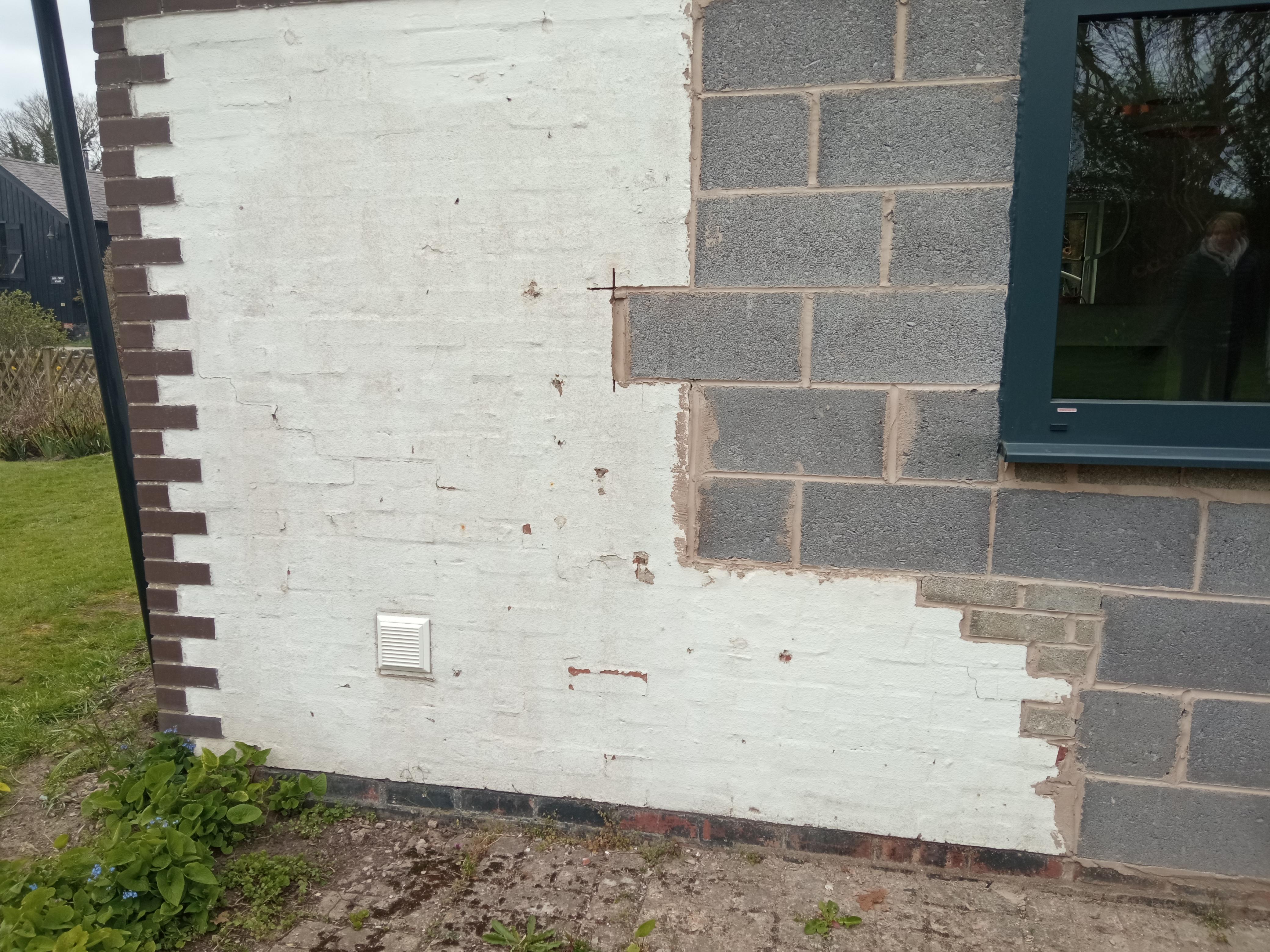

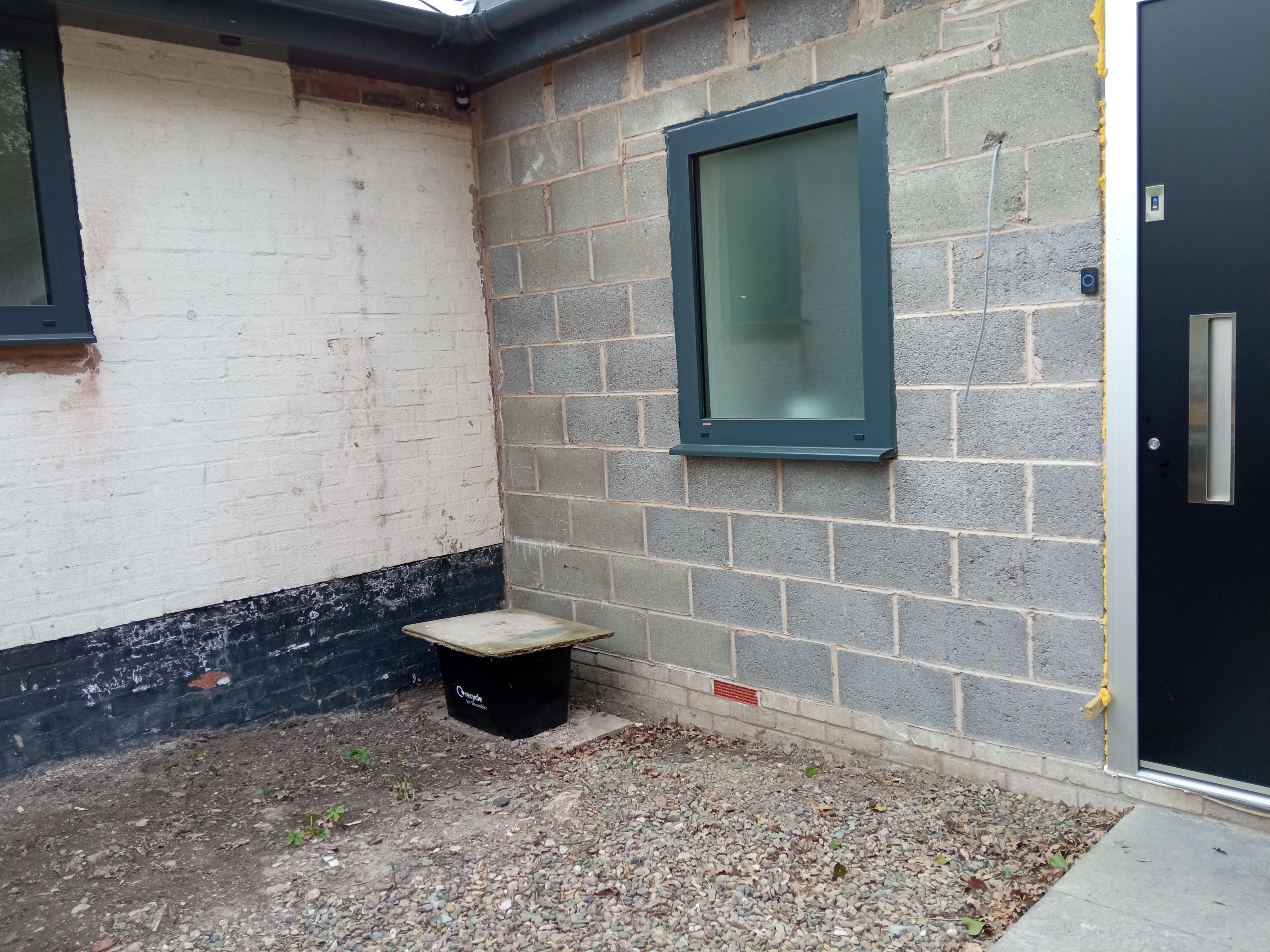

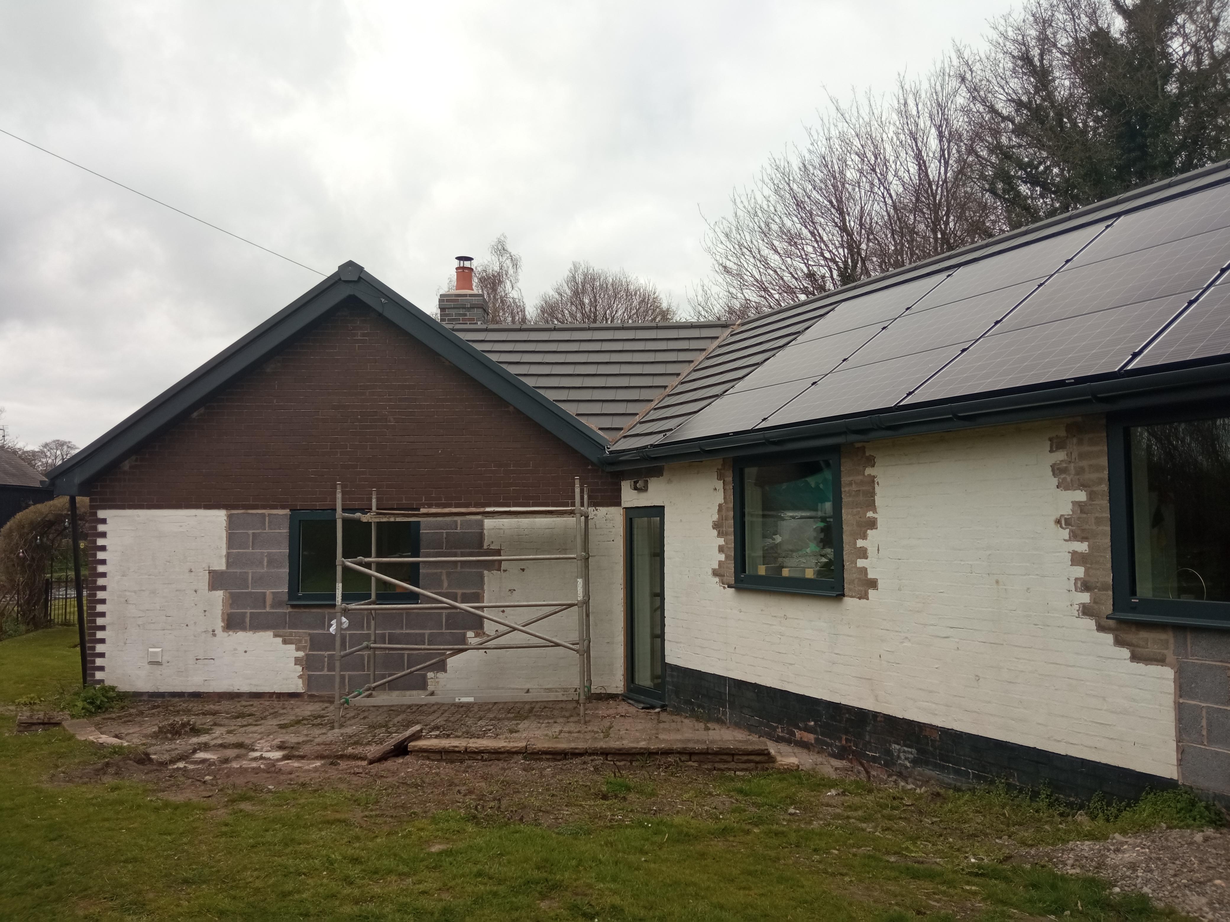

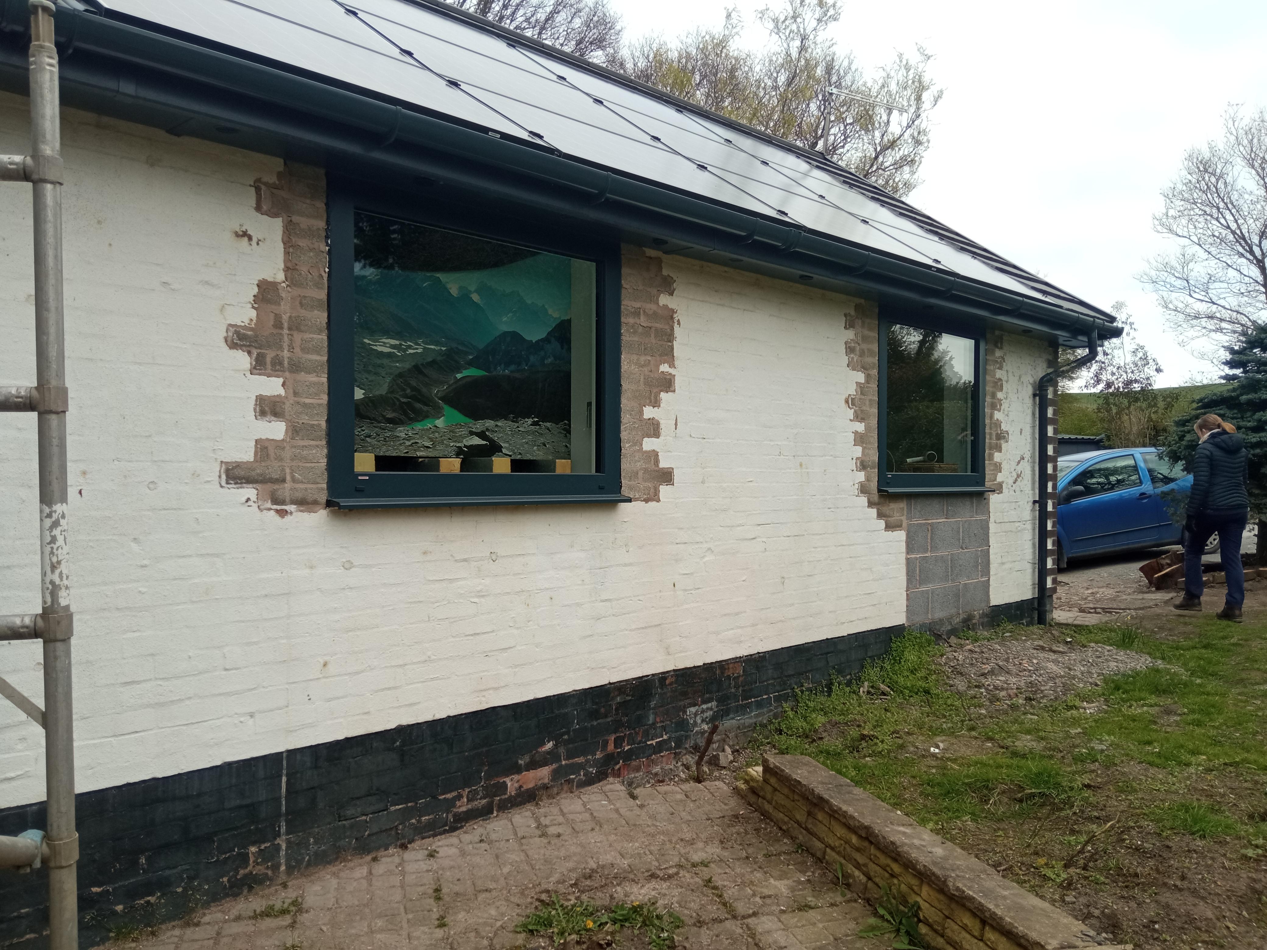

  4. I need to check our info and confirm exactly which spec of insulation it is. I now know it needs to be the grey/graphite version of EPS. We do have cavity wall insulation on the existing as when they took the old windows out it was inside like white fluffy stuff and we found some paperwork when we bought the house confirming cavity wall insulation. The window sills and eaves/overhand definitely won't be big enough for anything over 50mm unfortunately, we have checked. Very frustrating and an oversight really I should have picked up on. Our soffits etc have gone in but I'll ask the builder when I see him tomorrow. Below DPC is happening the same time. I thought the below DPC should be else than the main EWI so 30mm?
  5. Hi I'd posted a thread on the rendering forum but wondered if someone had any views on Jablite for EWI. Grateful for any comments on this thread and particularly around the issue of our DPC being higher in some parts and possible options such as plinth insulation allowing us to render over DPC (I think)!
  6. We should hopefully getting our EWI and render in the next couple of weeks thank the bl00dy heating gods because we are hoping this will improve the bills! You'll know from the original layout of our bungalow that part of the bungalow is stepped inside (to the bedroom/dressing room) as it is higher. This means the DPC is at a different level. This is going to look really odd as we have our DPC at different levels. The builder was speaking to the different reps about the render and if there was any solution because it's going to look a bit messy with the render coming lower on some parts and higher on others. It's days like today when I wish we would have knocked the whole thing down...... Pic below is our bedroom and dressing room and the bungalow is higher here as we step up two steps to access this part of the bungalow. This pic below probably demonstrates it better and you can see how it steps up. The scaffolding is in front of the living room/snug and the wall window is the middle hall. Ignore the garden walls and any paving etc... And then this is close to our front door where we have the existing part on the left which is pretty much where it is stepped inside and then our extension. We had picked Krend pure white but I've just had an email from the builder with the spec for the EWl and render and it's something called Ecorend and Jablite. Is Ecorend similar to Krend? And Jablite - is this a suitable EWI? Feeling slightly overwhelmed again! EcoRend_Spec.pdf Jablite Spec.pdf
