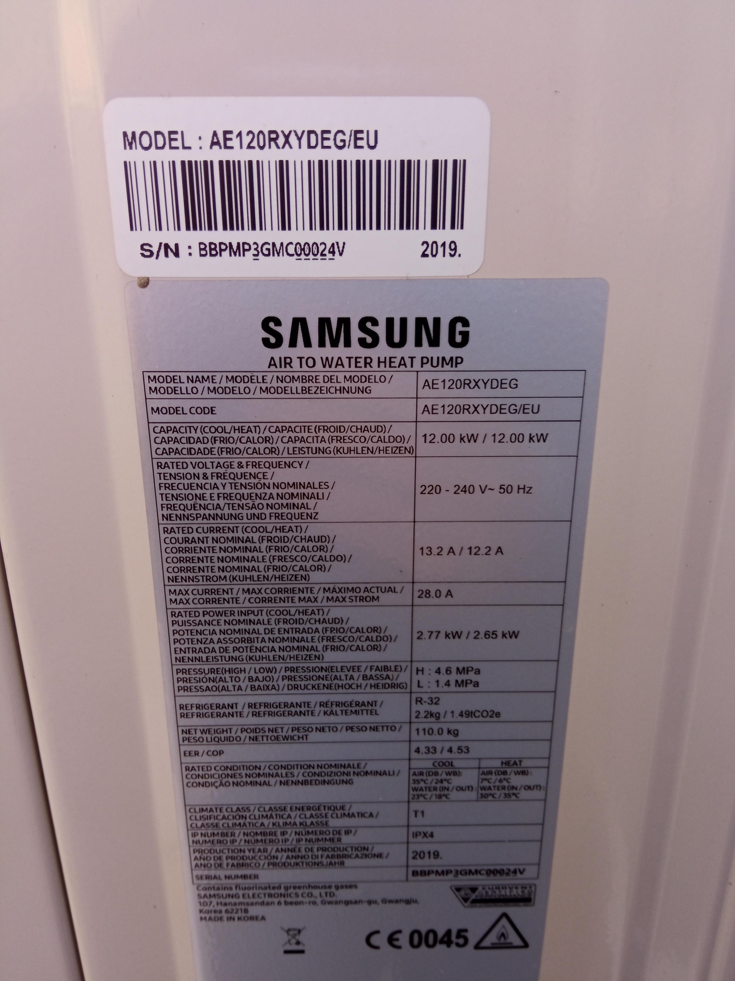

I can't seem to find a fuse labelled for this but the ASHP was working. This is driving me insane! 4.73kWh??? Only for a couple of seconds then dropped back to just over 2kWh. -

Ovens/coffee machine are off are on standby, where the clock is on but nothing else. Then there is just the fridge and freezer and router and sewage treatment plant but they are all things that are normally on. No lights on. The only thing we don't normally have on is the slow cooker for tea. We turn everything else off at the plugs like TVs, microwave etc. We currently have nothing charging. There is nothing else I can think of! I just caught a spike. Turned off heat pump. -

It's the heat pump. The cost current shot up to 3.23 turned off the HP at the fuse and it dropped to 420w. When the reading on the cost current was 580w I turned off the HP and the meter dropped to 450w so when the HP calls for heat that seems to account for the increase. I will over the course of the week be able to see what happens when we use larger appliances. -
