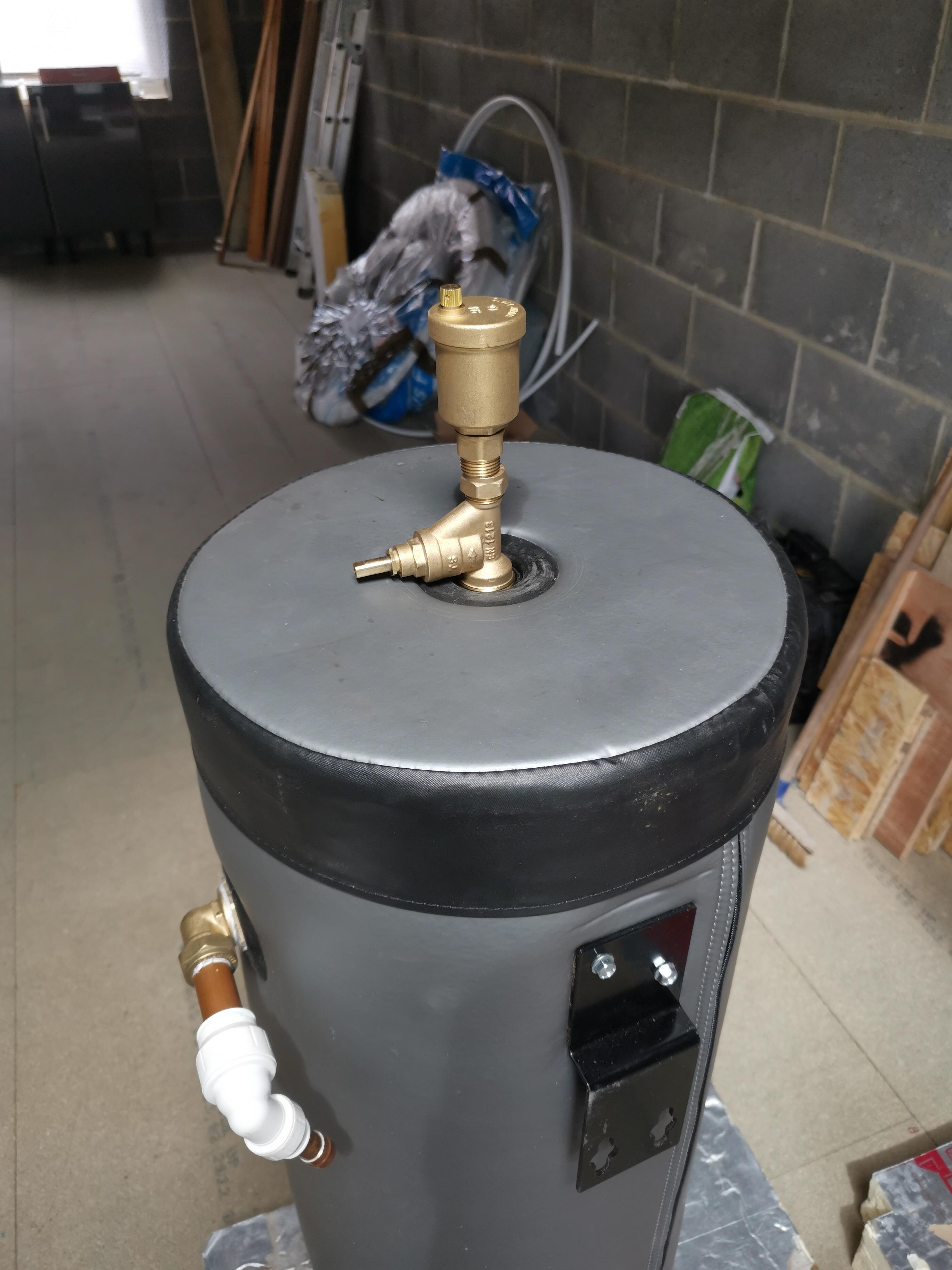

  • Days Won

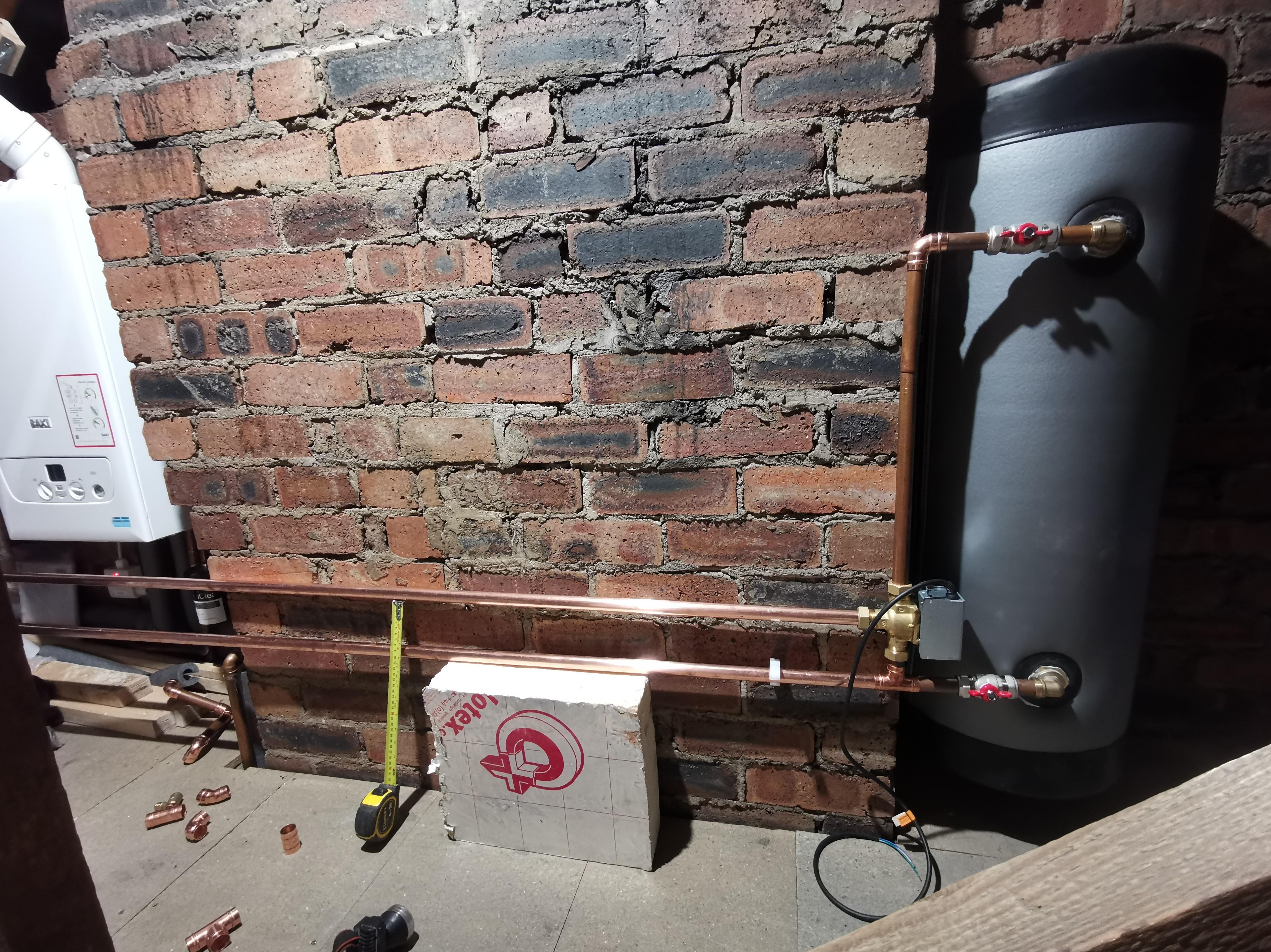

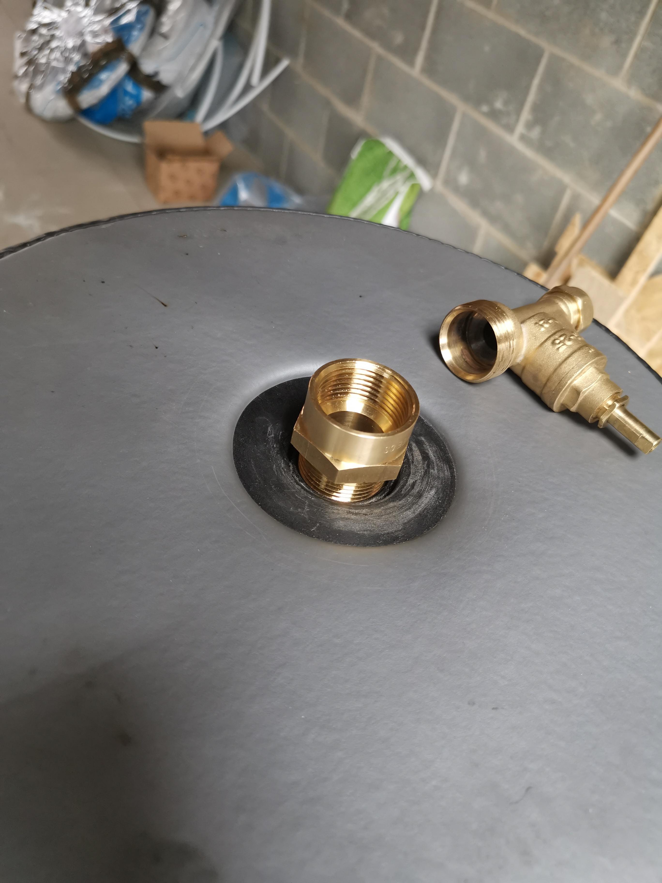

  1. Hell of an idea that @Nickfromwales Any suggestions on which diverter? Most I can see are mid way valves, please don't say it's another Honeywell as my wallet is getting very light! Over the weekend I got everything piped up and the tank mounted on the wall/chimney breast, just needs It's connections to the return. It's 100mm off the loft floor so jammed some celotex underneath it to ease my worries of it falling off, which it won't as it's well on there.

  3. yeah ive been looking at your drawing and ordering up the gear i need for the weekend. 1.1/4 bushes down to 1" then compression elbows. I assume i need a bottle vent or similar for the top of this thing and a drain at the bottom?

  11. ok, I think this is how i will do it, would someone be able to sanity check it for me please, thanks in advance! Am i ok to run full-bore butterfly valves under these 2-ports, dont have much room (im aware the 2-ports are upside down in the photo, was just to keep the cable out of the way) Id assume a wise man would also have another couple of butterfly isolation valves on the return just before and after the buffer tank, seeing as its the highest point in the system?

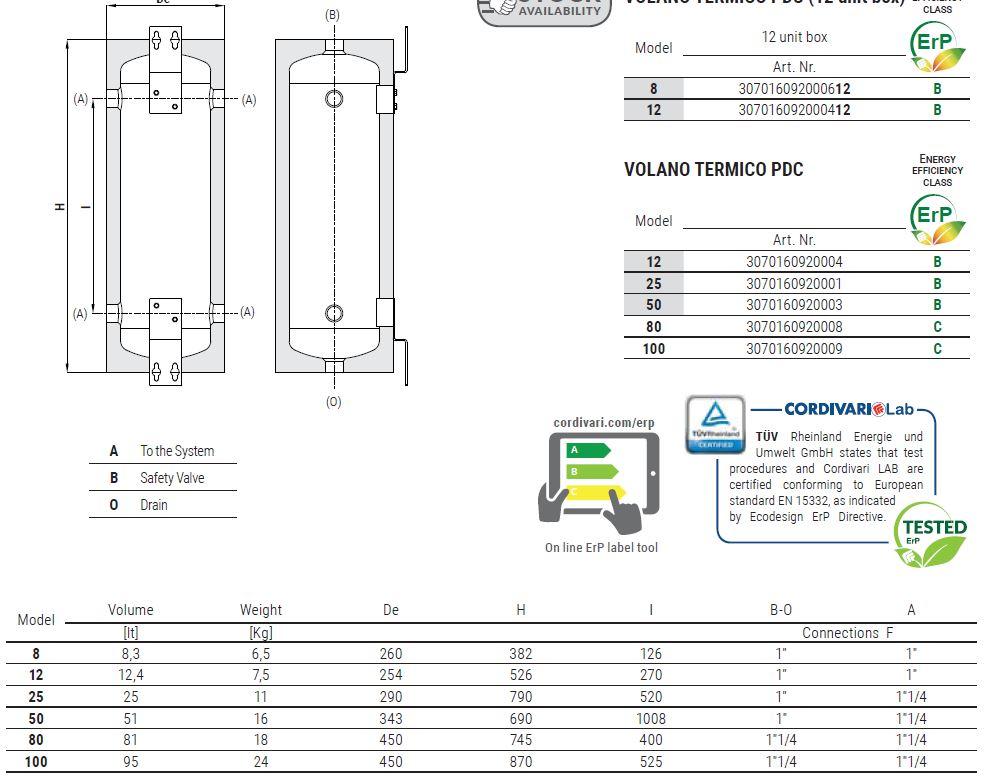

  13. Scrub that, the room I have available is ideal for that Cordivari... That's the one I think I'm going to go for, although it seems sold out everywhere for some reason other than a private sale on eBay.

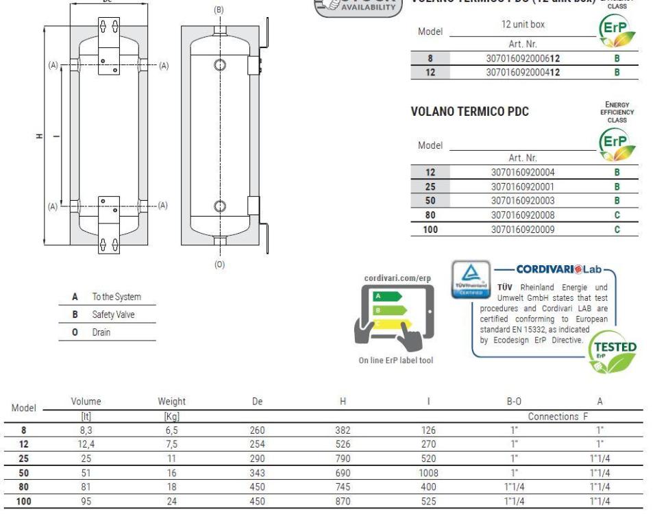

  14. this tank seems more readily available, any experience with this one? its floor mounted but they have a wall mounted one available as well, just need to check my available space.

  17. Been looking at the 4 port tanks, especially the one Nick suggested there, the volano termico. As well as sounding like a hell of a drink it looks pretty nice as well and I have the room for it. Looking at it and working out how to connect it, does it simply sit within the flow and returns (before the zone valves) or is it specifically on the flow and return for the UFH? also it seems to have no electrics at all, so my wiring center would still connect to the boiler "call for heat" as before? This sounds ideal as it's getting more complicated than I initially had hoped.
