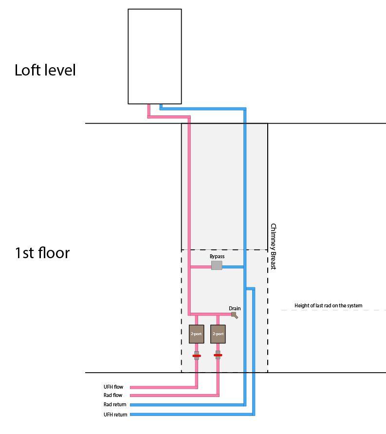

Nick, thanks a bunch. Sorry for calling you out, but you seem to be the guru on here and its to your credit, cant thank you enough for the time. I plan on installing the 2-ports in the void/cupboard within the old chimney breast, the existing pipes run up to the boiler on the side of the breast. Would you agree to the (simplified for clarity) diagram attached? 2 full-bore butterflies (levers?) just below the ports for the possible exchanges of the valves? This forum and people like yourself have really spurred me on in what is my first big renovation. (UFH and inevitable short-cycling still to come...)

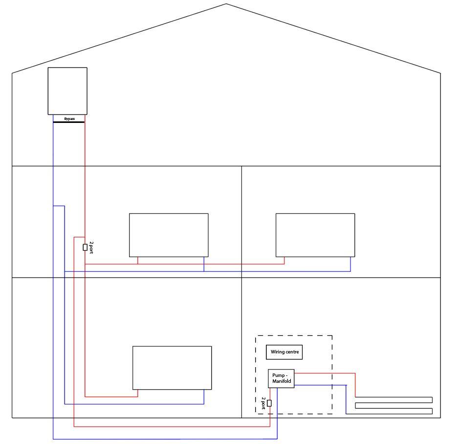

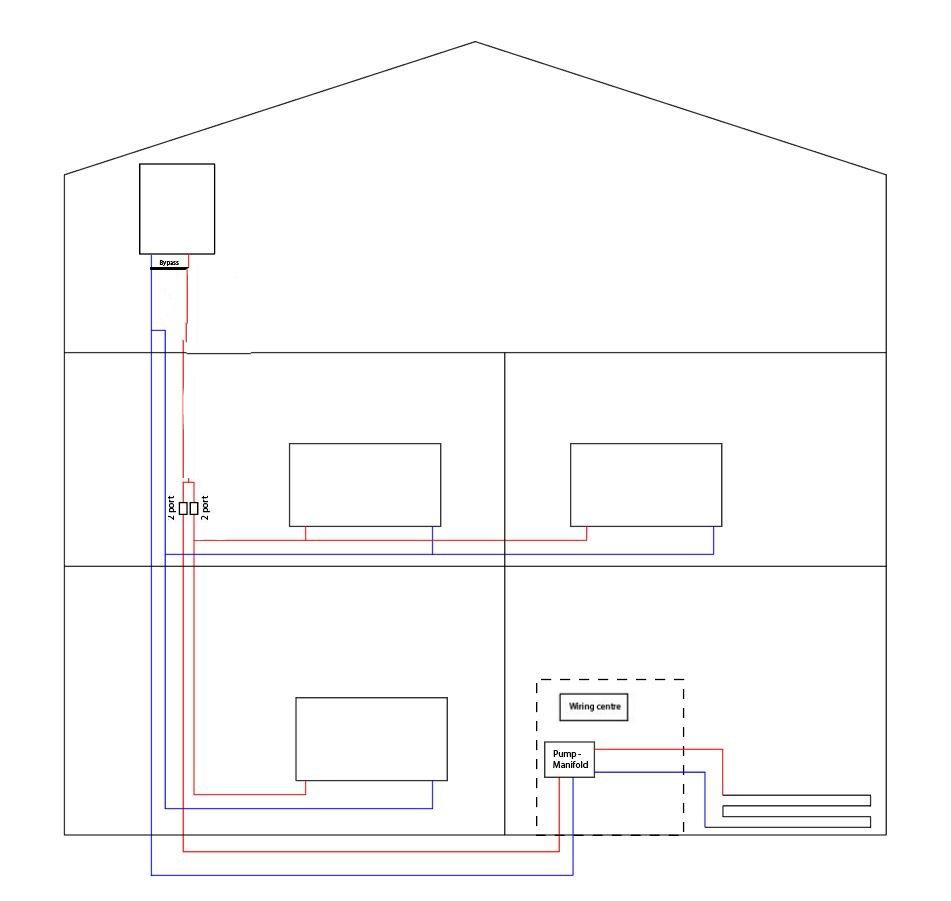

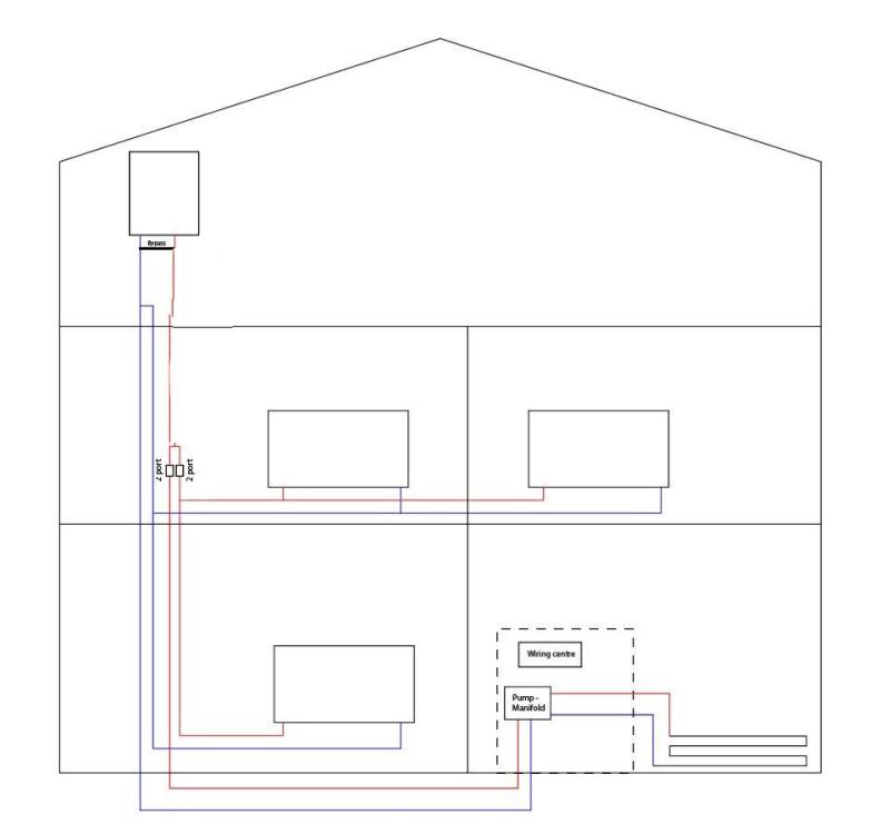

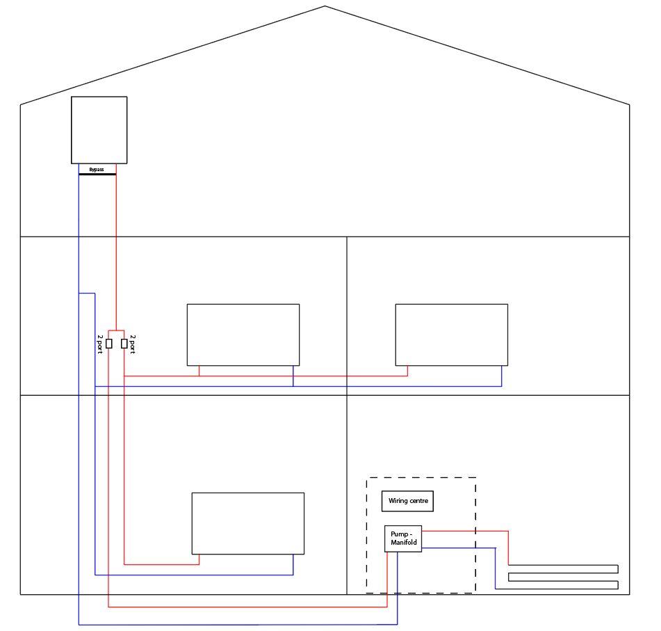

hi guys, is there any reason why i cant do the following: Both 2 port valves side by side on the first floor. It would streamline my plumbing to do so as my manifold area is getting quite bogged down with things, so looking at any positive/negatives for that. I can have a valve down at the manifold if i really to, so i guess its either or. My preference is both up there to keep them together. Any reason i shouldn't do this, @Nickfromwales, you are the fountain of knowledge on here so i take what you say as gospel, but im open to any advice from all you fine gentlemen/women/others. Size is not to scale, obviously i need to run the cables to the wiring center and UFH is for the entire ground floor also.
Yeah designed by a few companies but most came back the same. No one mentioned short cycling but I guess they probably wouldn't... I'll get my lines in and then get back to the research, cheers John.
Sorry, loop. 4 (or 5, I forget) loops split between 3 thermostats. It's all been designed, I don't know the ins and outs at the moment as I don't have the documents handy. Any thoughts on the reverse circulation, that's where I'm at today. Cheers
4 zones, around 90m each is currently designed so hopefully that is ok for the combi. Just the reverse circulation I was hoping someone could clarify for me. Cheers for the response John 👍

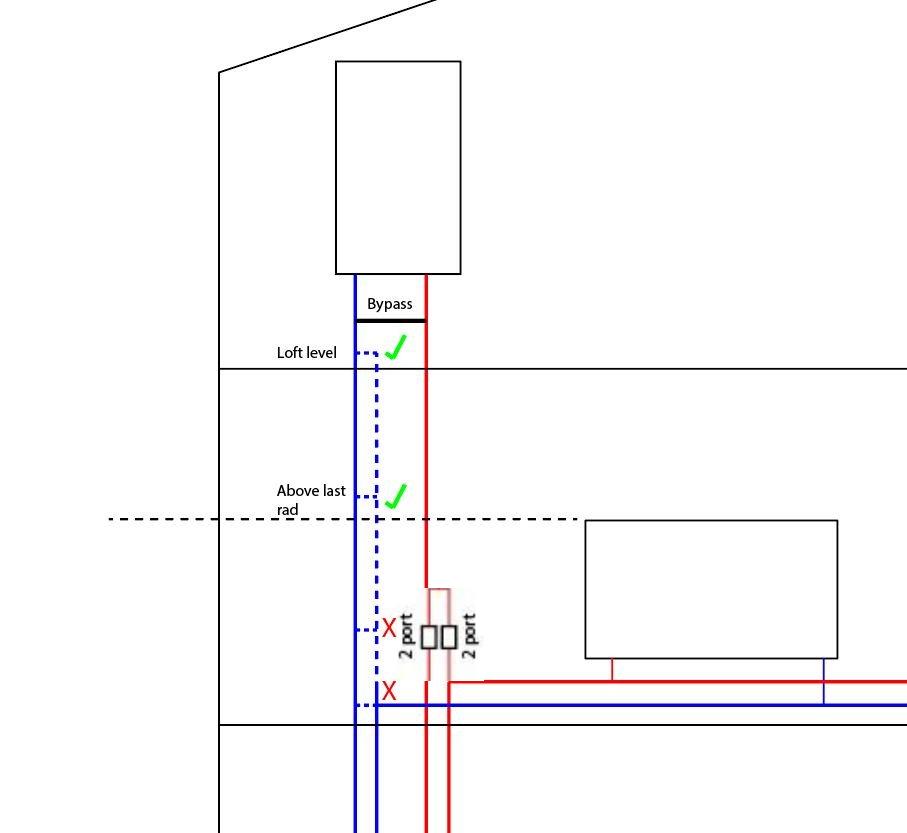

Gentlemen. Got a few days to hammer out some plumbing, so I'm going to lay the flow and returns for my ufh. For context, combi is in the loft, ufh (manifold, pump, wiring center etc) is ground floor. 2 port valves can live in the void/cupboard within the defunct chimney breast just below the boiler on the first floor. So I've designed a dedicated flow and return, but my question is at what point can I join the return to the primary heating return? Does it have to be higher than the last radiator so as to avoid return circulation? If so, how high is high enough, is it physically above the last radiator or can it come from the same/last tee. Cheers gents. Pictures a bit of a bodge, best I can do on my phone!

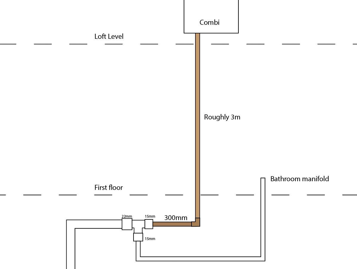

its maybe 3m from the joint to the boiler, boiler just above loft floor level so the pipe run up the side of the chimney breast in the copper. So a 22-15-15 would surfice, be pretty easy to be fair as i already have all my copper in until the new joint so i can just plug into it. Alteratively i could break into the copper higher up and convert from 22 to 15 there, but not sure it would make much of a difference? -

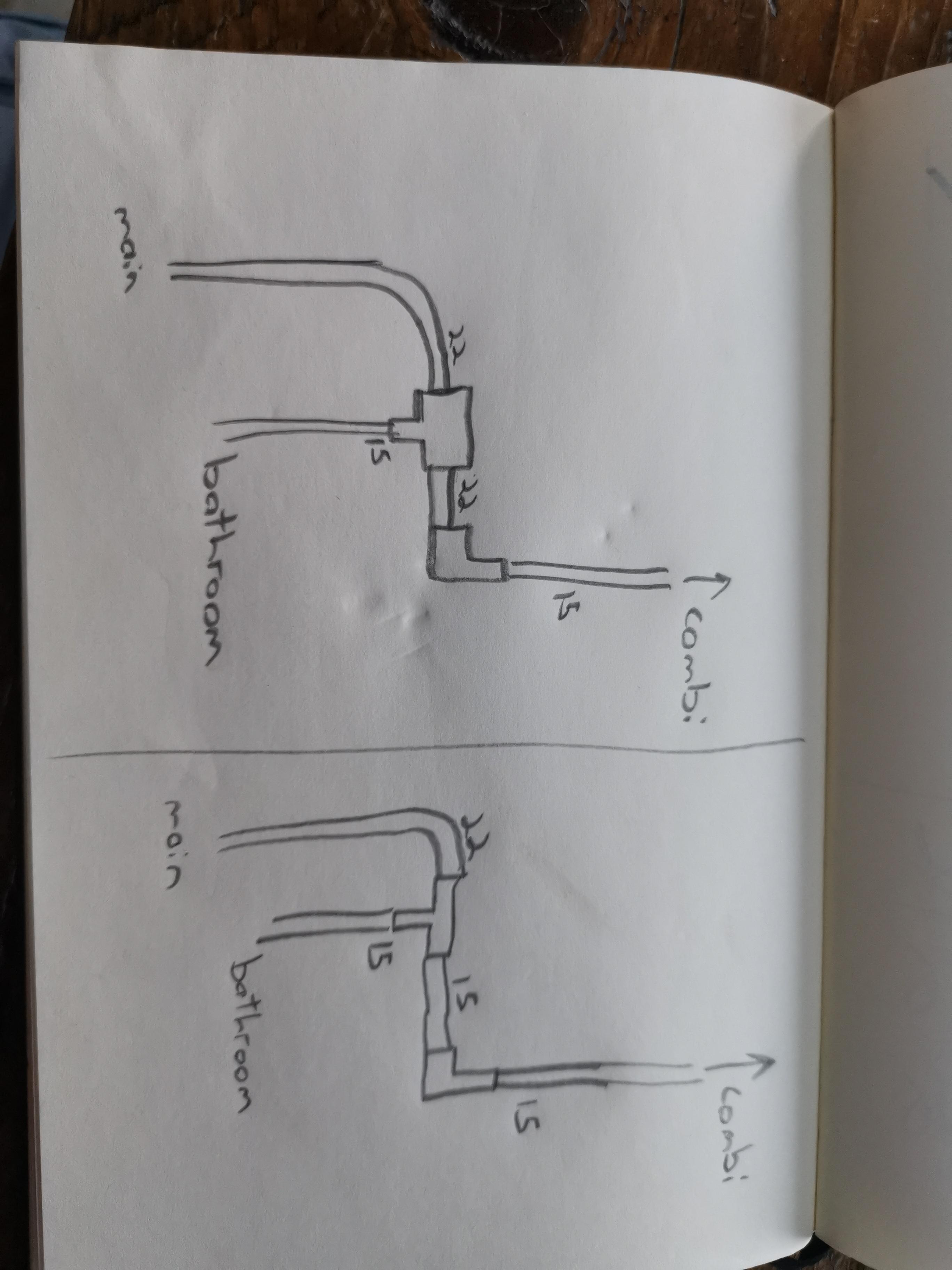

Just about to put this into action @Nickfromwales, just a thought, which joint is preferable out of the 2 extremely crudely drawn images? Basically 2 different tees, or are both much a muchness? cheers! -

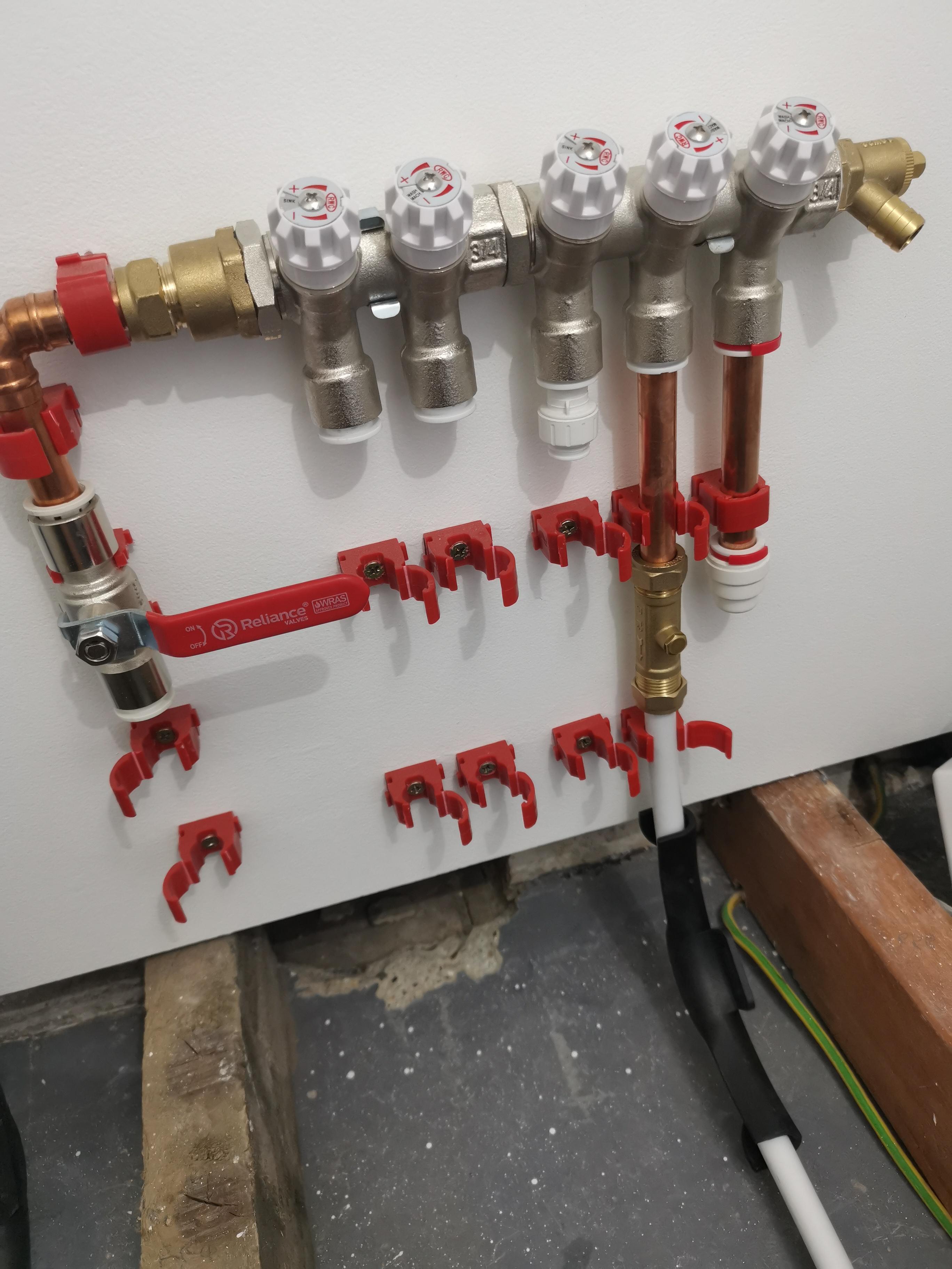

DCV compression on plastic? I'm not sure...
Super_Paulie replied to Super_Paulie's topic in General Plumbing
Yeah I was debating it back and forth, everyone was busy today it seemed so I just went ahead and did what I thought best as I needed it done. The bend on the layflat comes in pretty steep so I wasn't 100% on the compression fitting to plastic. Read somewhere that @Nickfromwales suggests compression on copper stubbies, so went with that. Either way, totally suitable I'd imagine. -
Well looks like everyone is out enjoying the sun, so for info I went with a joint under the floor. It'll be fine, what can ya do eh. -

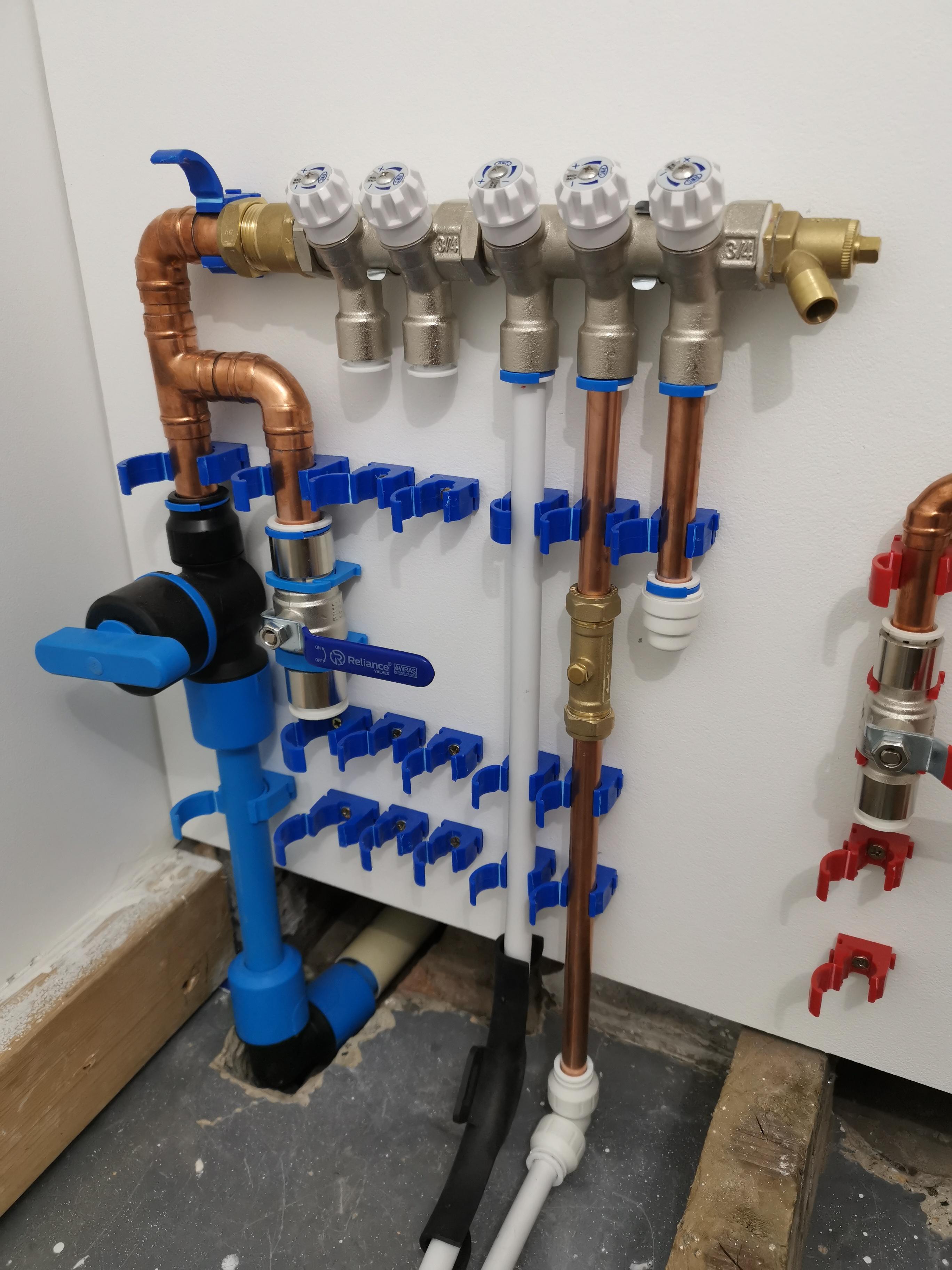

Question for a Sunday morning! I need to a DCV here, I can't access it at the other end as it's a wall chase to an external tap. Question is, should I just sack off the compression-to-plastic joint and have a copper stubby from below the DCV and then a 90° elbow at the bottom of this to connect back to my plastic? Downside is that the elbow would be below floor level... Cheers gents.
Makes sense. But this is in my extension and it's a concrete subfloor, void then joists. I've enough room to get my impact in so I'll clip to the underside, seems fair.
Good man. When you say cable everything, what do you mean exactly? I could all use round band instead of clips, need to see how much room I have to swing a hammer.
Best practice, just lay water pipes on the soil from A-B or clip them to the underside of the joists? Seems a lot of effort for long runs...
