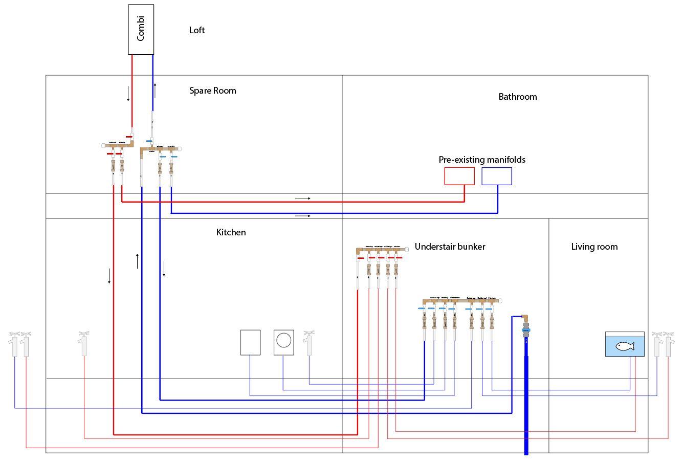

  1. yeah, the 2 hots (and colds) going that way are 1xh&c for the fish tank and the other 2 are outside of the building for car/dog washing. Obviously i can "tee" these nearer the source but i was hoping to avoid any of that stuff. There seems to be a lot of ways to do business but it always ends up with "tees" here and there or hot manifolds at one place and cold the other which makes me think that the whole manifold and jointless pipe runs is just a bit silly in my situation. What you have above is close to what i had originally designed with a hot manifold in the kitchen and the cold in the bunker. If i need to add branches in here and there then its not far off that already so i might be chasing a solution to a problem that doesnt really exist. its annoying as the bathroom manifolds are like 2m away from the bunker but you cant get through the staircase to join the 2. Im thinking that the wait time for hot water in the kitchen might not be a huge burden as i barely use it anyways, its the hot in the bathroom that needs the quick response so maybe im over-thinking this... seen too many pictures online of nice manifolds and wanted a piece of the action.

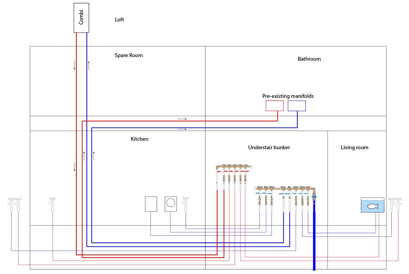

  2. i could, but i was under the impression that it is better without any joints outside of the manifolds Open to all suggestions though, so like this?

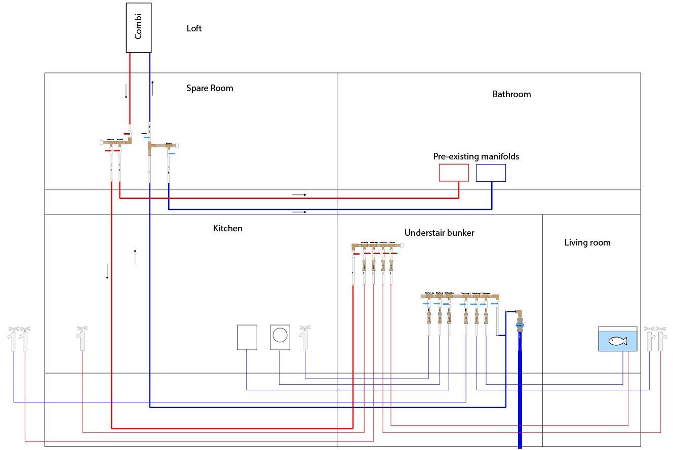

  3. ideally yeah, but sadly i cant get from the bathroom to the bunker "easily". The downstairs is all open plan and no matter how i jig it i cant get an easy route from bathroom to bunker, hence the long way round via the kitchen. Sorry that isnt clear from the diagram, its not as straightforward as it seems in terms of house layout. Essentially the bunker is only accessible from the kitchen lets say.

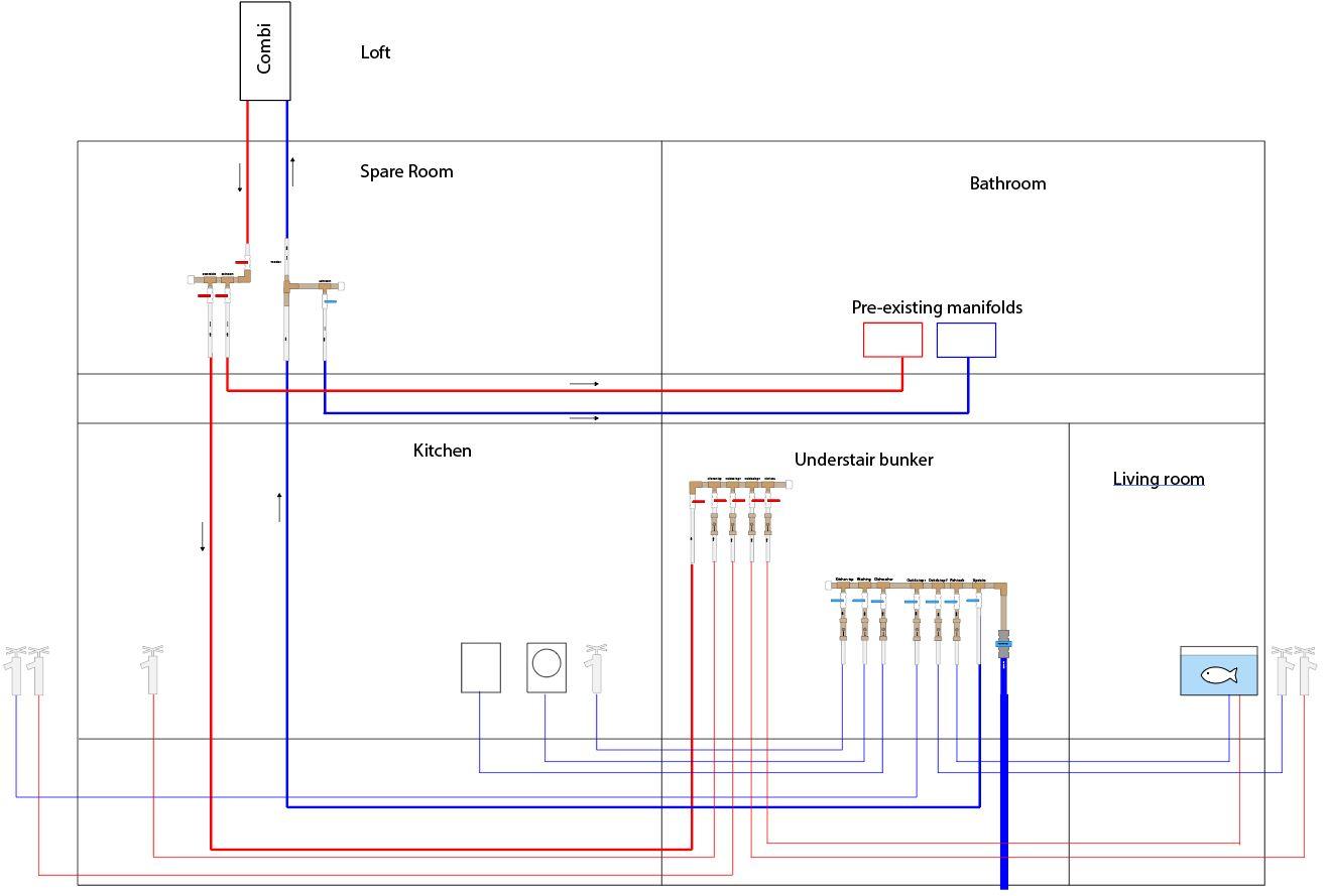

  4. i hear what youre saying, so like this. Would involve "an upstairs manifold" but that wouldnt be a huge burden in the scheme of things.

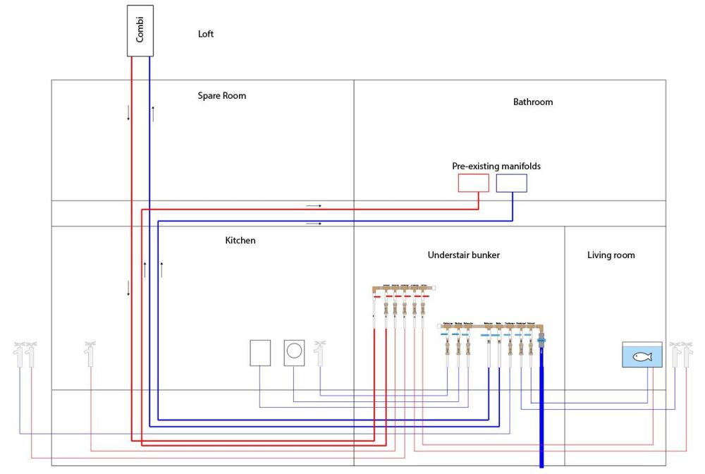

  5. hello gentlemen. Im in the middle of a full house reno. Well a big extension which has basically wrecked every room so may as well be. It seems a good opportunity to re-do all the plumbing and replace the decades of branches, dead legs, all types of fittings etc and go for something straightforward with minimal joins from A to B and manifolds seem to fit the bill. Not a lot online really and almost all searches end up here so i thought id join in. By manifold i mean copper tees with full bore lever valves and double checks. The situation is "Boiler in loft - Mains downstairs." I really wanted a central point of isolation for everything, or most things at least so keeping joints to a bare minimum but it has created a few issues. Under the stairs is a bunker that is ideal to house it all but the problem is that the DHW will have to come down from the loft (via the spare room, straight down the outside of the defunct chimney breast) bypassing the bathroom (next room along), straight past the kitchen to the manifold location and then back again to the kitchen and back up again to the bathroom. Common sense suggests this is silly, with a distance around 20/25m in total before hot water gets to the tap which is in reality nearest the boiler. So begs the question do i have a manifold upstairs to split the DWH to the bathroom and kitchen. And if im doing that then i may as well but a manifold in the kitchen as well. And if thats the case then i may as well sack off the manifold in the bunker altogether which was the entire point of it... Before this post gets too long, should i just abandon the whole idea, its been working fine as a branch system for decades... Attached image, fish is not to scale. Nothing is off the table, the house is in a almost complete reno mode.
