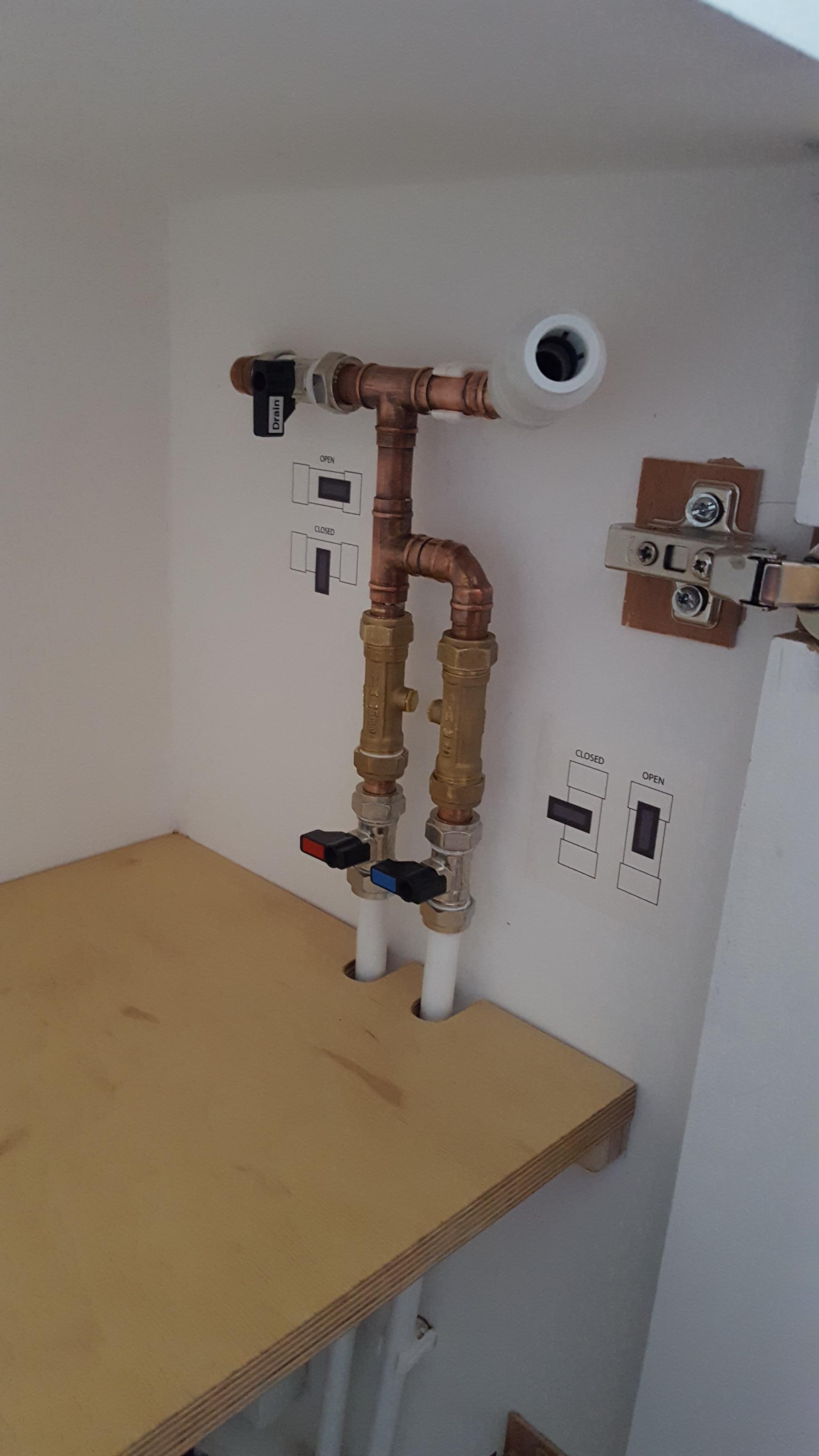

gentlemen. im looking to feed a external taps for the garden etc, with the feeds coming from my domestic manifolds. But it poses a few questions... Id need to chase the block to get the pipework up to where it exits the house, so id be using a copper wallplate/tube with the half inch thread for the tap. It would mean i would lose my "one, continuous feed" from manifold to outlet in my plastic layflat as obviously it will need to transition from plastic to copper under the floor, which is indeed a shame. But additionally where would i put the double check valve? The taps i want to use are Peglar levers so have no built in valve, should i just add that at the manifold end as it would end up under the floor or chased in which surely isnt the best way to do it. As the pipes will be exiting essentially in the middle of the lounge its not like it can all be concealed in a kitchen unit so it will have to be chased. Either that or come out at under-floor level and then up the wall externally which im not keen on. Any genius thoughts welcome, i cant really think of any other way to go abouts this but just thought id throw the question out there. Image attached

Bit of a dilemma... Do I leave these tails copper (new cut, all the same length, obviously) and use an elbow under floor level to attach the plastic runs or do I take the plastic all the way up to the manifold. I was wanting to have zero joins but the copper is proper sexy to look at and it's shiny. Or am I just losing the plot here with visual over function. -

Almost seems a crime to put this in a cupboard... My plan is to change the copper tails to layflat, copper was just to keep my clips in alignment, so that it's just a continuous pipe with no joins to each appliance. Dedicated 22mm feed to the boiler. 1 spare on each, but room to add another 2 port to the ends if needed in the future. Any suggestions of changes before I solder this up? (Feeds close to the main due to space limitations under the floor so I had to bunch them up to fit between joists and through the gaps in brick.) As it's in the bunker with the ufh manifold I assume I'm going to have to lag up these colds to stop condensation @Nickfromwales? -

thanks a lot @Nickfromwales, for your time and advice. Thats exactly why i joined the forum to get help from decent blokes like yourself. Im with you, the 2 additional manifolds in hindsight are pointless, i was just looking for a way to pull the plug on both at the same time which seems ludicrous thinking back as they both have their own isolation anyways... I can run a dedicated 22mm feed to the boiler no problem at all, as i say the whole house is fair game in its current state. This makes more sense? -

anyone available for a sanity check on this setup? I ran a test on the time it took water to get down from the loft to the bunker and then back over to the kitchen and it wasnt a problem worth worrying about. This setup will have a secondary manifold at the kitchen side for cold otherwise the bunker just gets crazy crowded with pipes and it means i can bring each appliance online as and when its positioned, i dont know their final locations just yet so it just makes sense. Drain-offs so i can drain the system down from any of the lines by opening closing the manifold valves. Run to the kitchen tap from manifold is 7m so worth bringing down to 10mm? Without applying favouritism, @Nickfromwales seems the go-to man for manifolds but id love to hear any responses on this from anyone who has experience. -
