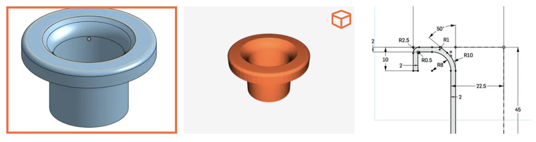

Love my Creality Ender 5-S1. When the plumbers fitted the shower tray traps it was a godsend to be able to design and print some custom parts for the air/water trap that I am damn sure they just chucked out because they didn't fit! Am sure it's ancient now though!

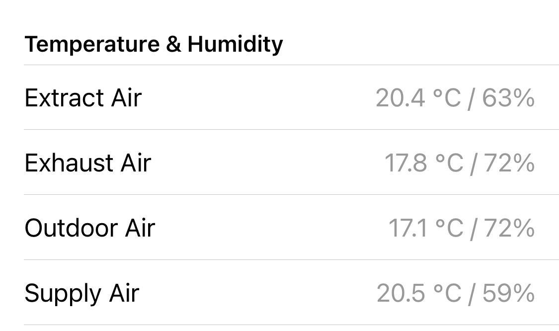

Haven't been on the forum for a while, been living the dream! 😆 Anyway, we were not convinced by having MVHR, but did put it in in the end. Yes ours is a new build so thermally better than older property but I did it mainly for the air quality and because It irked me to install trickle vents in otherwise perfectly good and 'sealed' windows. I changed the filters for the first time last week (6months) and it was a revalation what we are avoiding breathing in. It's good for common dust allergies. No heating on and MVHR running on Cool, air in and out at about 20.5 degrees.

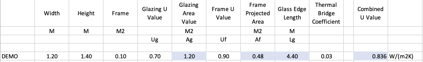

Yup get that, I just wanted to understand how it works and it gives me some peace of mind to feel it's not just a load of smoke. I will be requesting a full calcs sheet in any event.
I'm sure they can, but thanks.
Hi, further to recent post on window combined U values, I've investigated the maths to make my own calculations and it's reasonably comprehensible. I followed a short YouTube video and now have an easy to complete spreadsheet that will do the heavy lifting. The only hole I have is an understanding of how to calculate the Thermal Bridge Coefficient for the final multiplication for which they used a 0.3 value... If anyone has a guide or can tell me if 0.3 is a usable figure it would be most helpful. I'm sure the window manufacturers/suppliers can and have done all this but the fitter seems less knowledgable and as I need to be able to provide the evidence to the SAP guy in th end I thought a little knowledge would not be a bad thing. Many Thanks.

I've put the order on hold until I get some sense. It seems slightly incomprehensible how they can potentially manufacture and sell something that is not to the required legal spec. Projected EPC is a high level B, but that was with windows that only the Scandanavians can make as far as I can tell.
