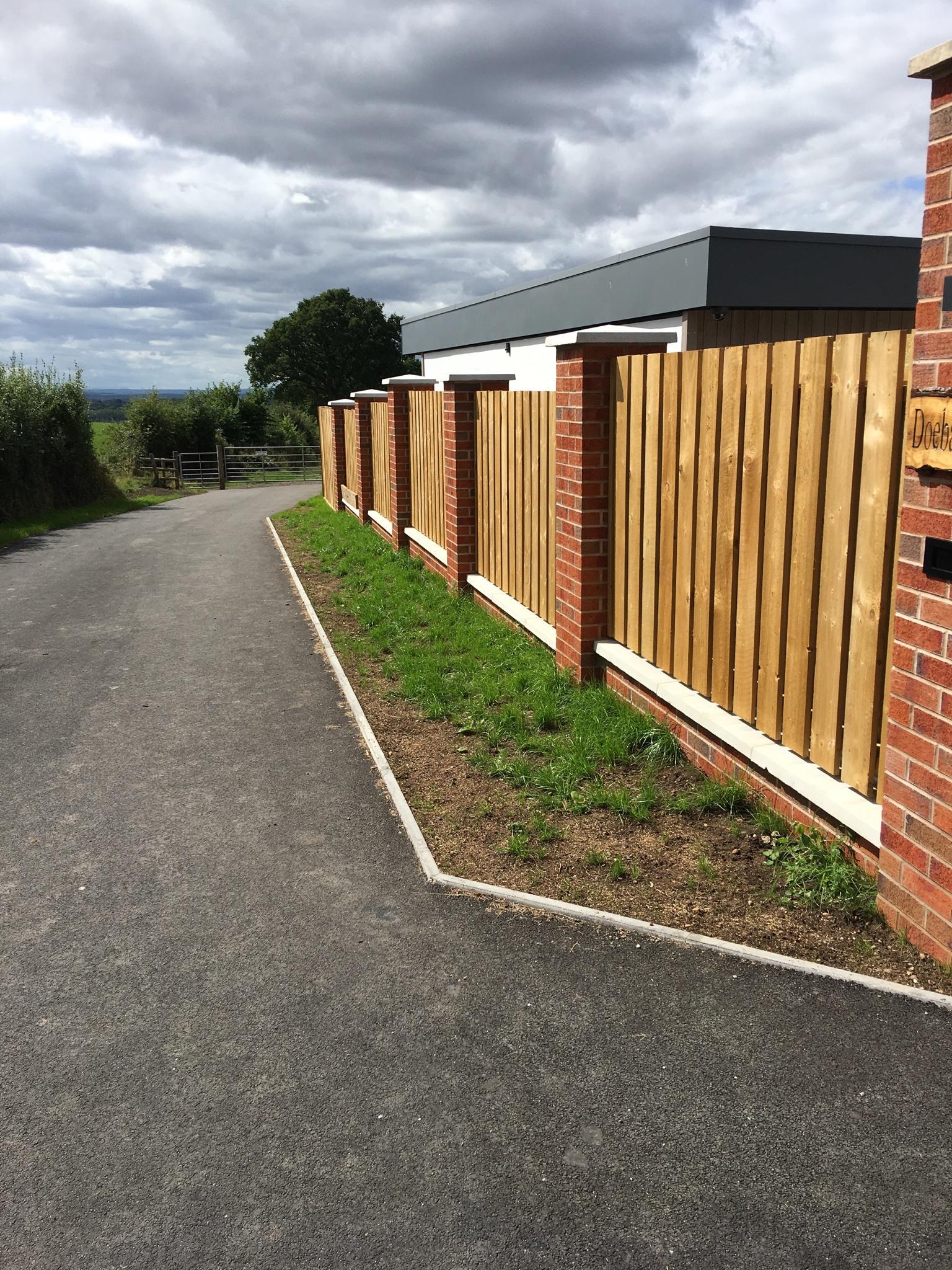

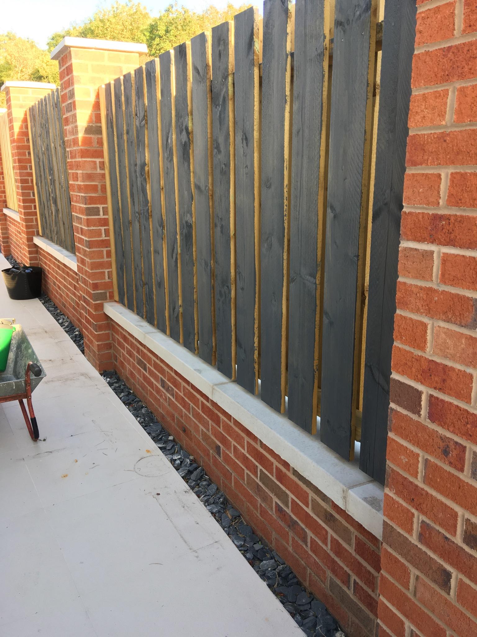

Timber fence on top of stone wall - construction method
lizzie replied to DaveH's topic in Landscaping, Decking & Patios
I'm in a very windy location high up on top of exposed ridge thats why we went for pillars and metal brackets for the cross timbers and used hit and miss for fencing so wind could go through otherwise it would be blown down regularly. -
I have mine between pillars...we filled the cavity with concrete. Didnt use posts in the end used brackets on the pillars, no good if you dont have pillars though. -
