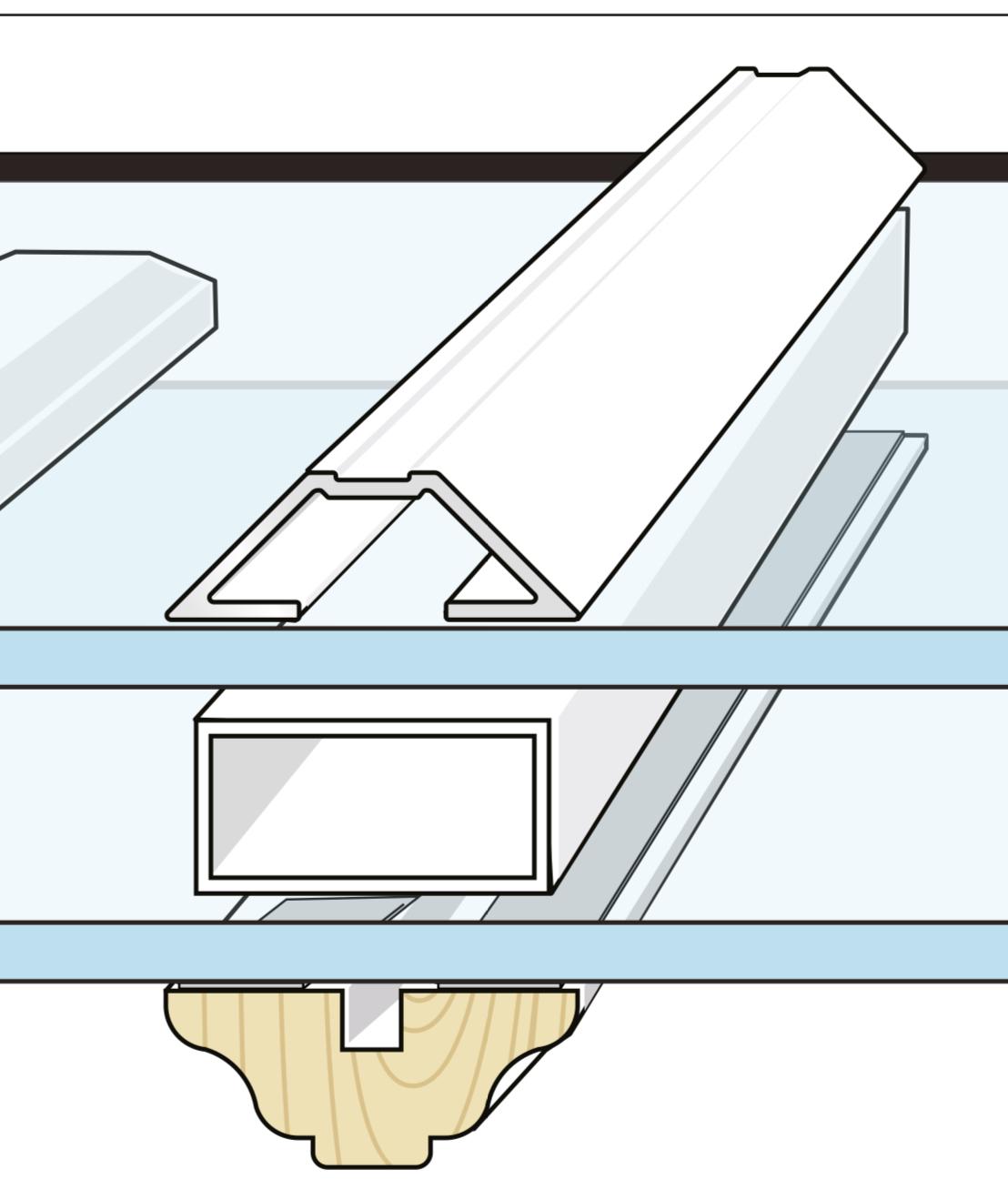

Does anyone have and windows with glazing bar inserts like this (ideally with triple glaze): How do they look? Can you tell it’s a single pane of glass?
