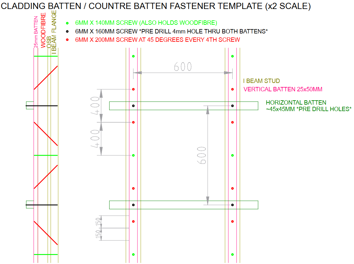

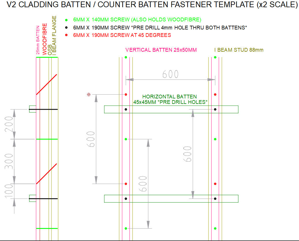

Screws at 45 Deg will be behind the external closing so will not see them. Screws at 45 Deg take the weight of the woodfibre from sagging/bending the horizontal fasteners. I could change the 45deg ss flat head screw to a ss normal counter sink head instead.
Having searched - Fastener Types will be: GREEN 8.0 x 140mm T40 Spax Extra Long Washer Head Wood Screw, Stainless Steel RED / BLACK 8.0 x 180mm T40 Spax Extra Long Washer Head Wood Screw, Stainless Steel A2
Studs are 88mm wide. We have all the dims for stud location - so hoping that is sufficient to find them!
Hello all, my SE has washed their hands of the woodfibre and cladding fixing details. So I've come up with some myself, and would like a critique - or explain what you did for a similar build please? Reading around, it looks like 45 degree fixings help to ensure there isn't any "sag" in the woodfibre/cladding due to the weight? Stainless steel Screws for corrosion resistance? Buildup: 300mm IBEAM (on 600mm centers) 18mm OSB 60mm Woodfibre House Wrap/membrane 25x50mm vertical batten 45x45mm horizontal batten Vertical thermowood cladding Prelim Woodfibre Fixing Schedule: Advice greatly appreciated!

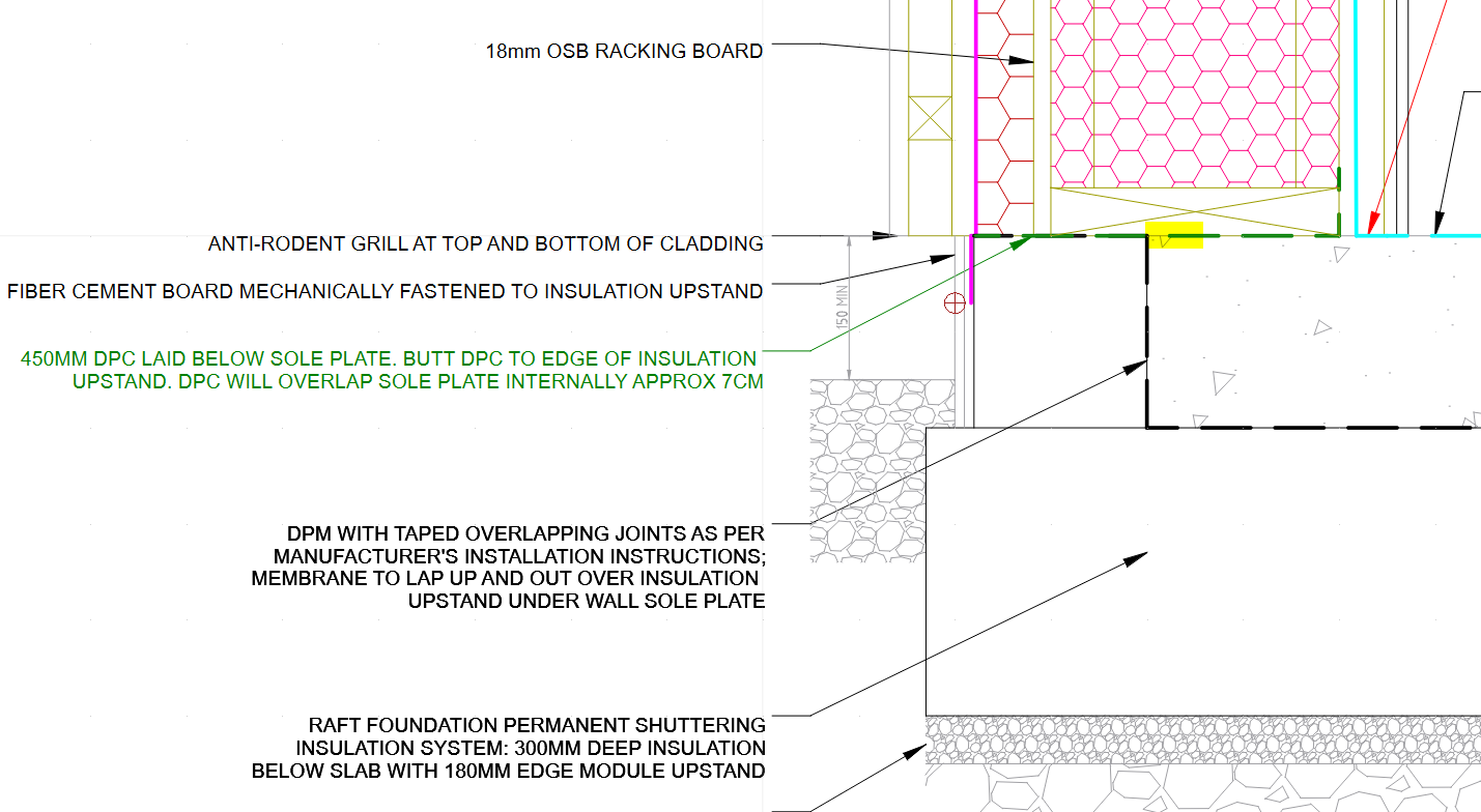

Am I overthinking it please? Some advice on the detail of the sole plate please BH. Our detail is as below. I wonder if I need to add a strip of butyl tape (yellow highlight) around the perimeter of the house under the DCP, around the edge of the concrete? (to stop any water that does make its way under, from entering the house) some photos below of a MBC build doesn't seem to include it.

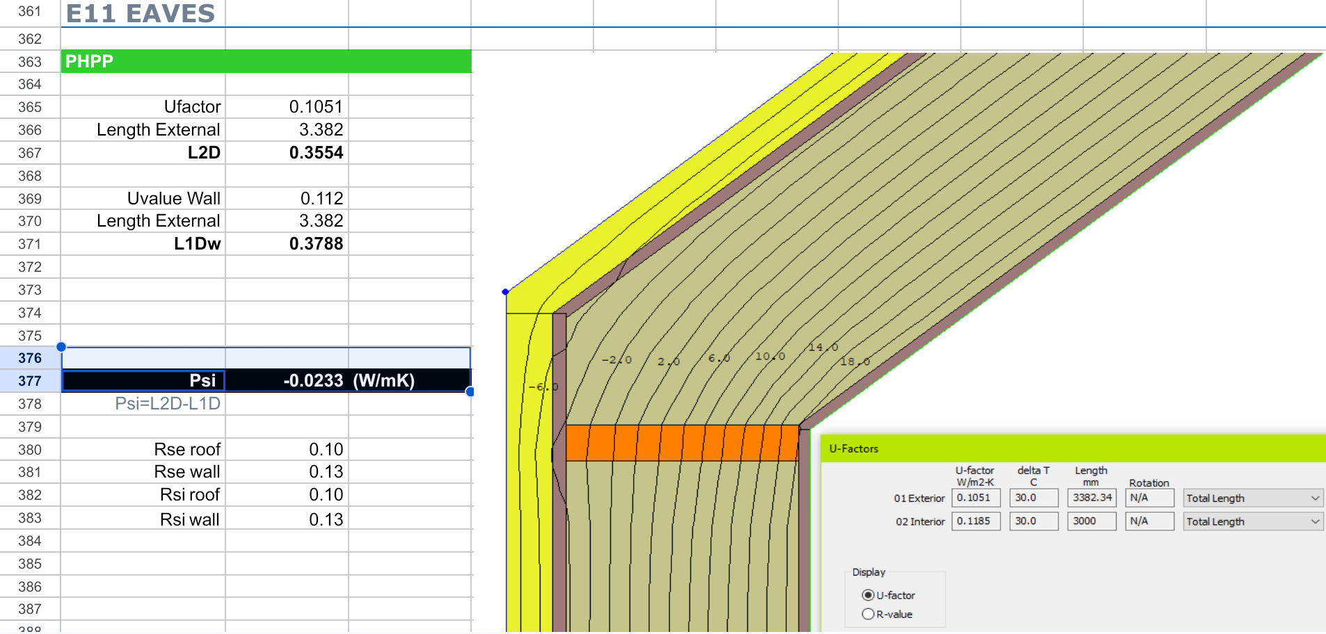

Yes this is correct. For example the corner detail: PHPP uses the external wall length. SAP uses the shorter internal dimension. Boundary conditions and Rse values differ. From memory the external conditions are 0degrees and 0.04Rse. i.e. there is no allowance given for ventilated facades. This is from memory so if anyone has a reference, please share. -

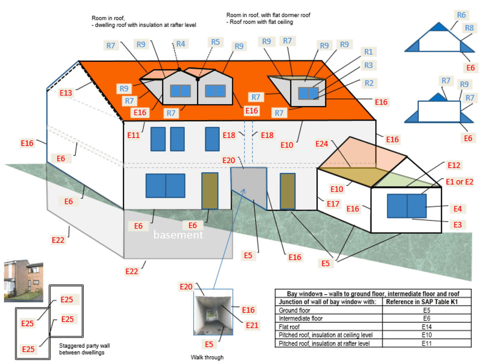

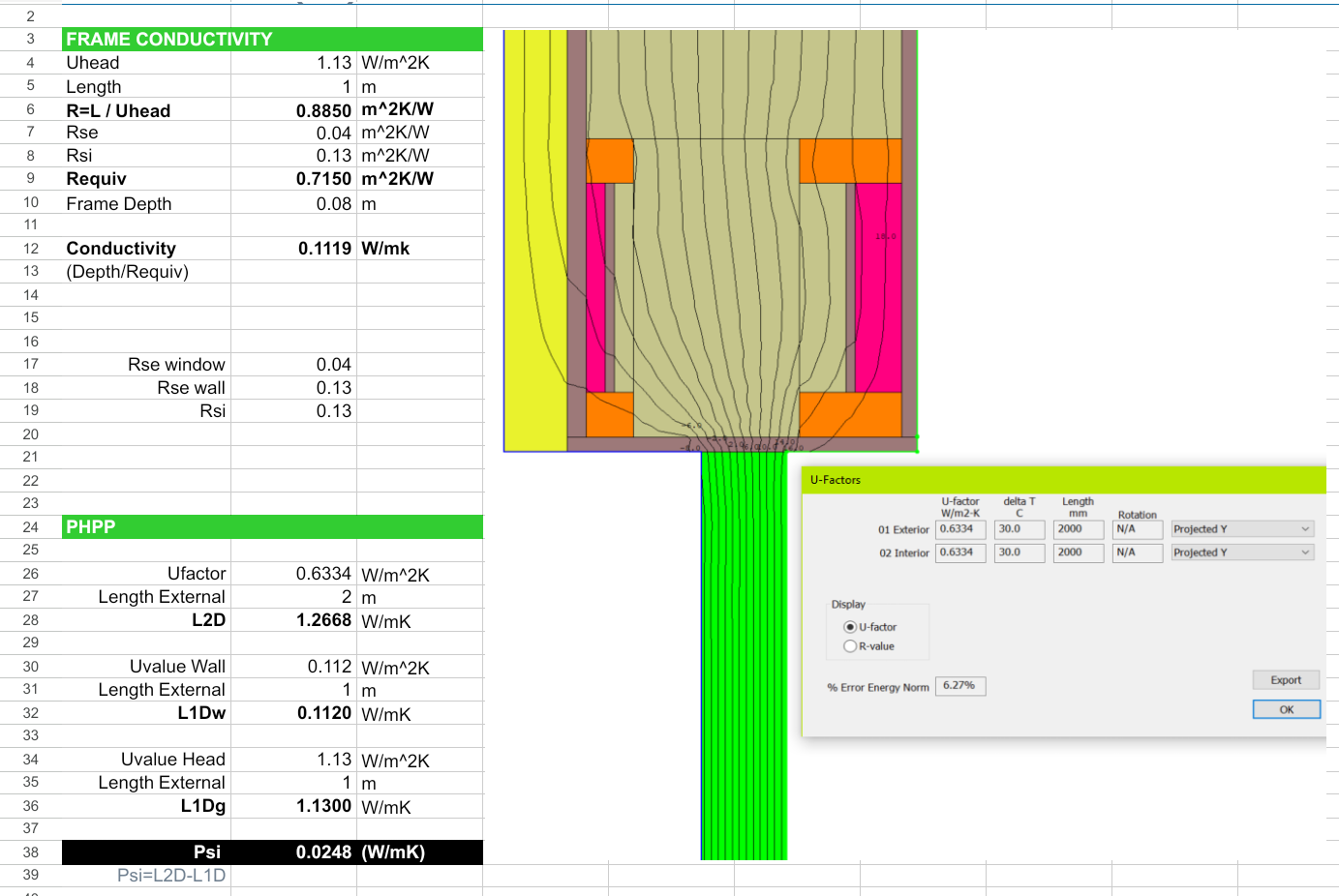

Junctions picture showing all the TBs that need consideration: Appendix B had a list of all the TBs required: S10TP-05 - Treatment of thermal bridges - V1_2.pdf Corners are quite straight forward: Windows are more involved. The frame conductivity needs to be calculated and input as a custom material for the frame in the materials library. If the head/jamb/sill have different UValues then you'll need to drop it for each. Ground slab calculations are a two step process. I think they are explained in the previous ThermInstructions.pdf I uploaded above. -
