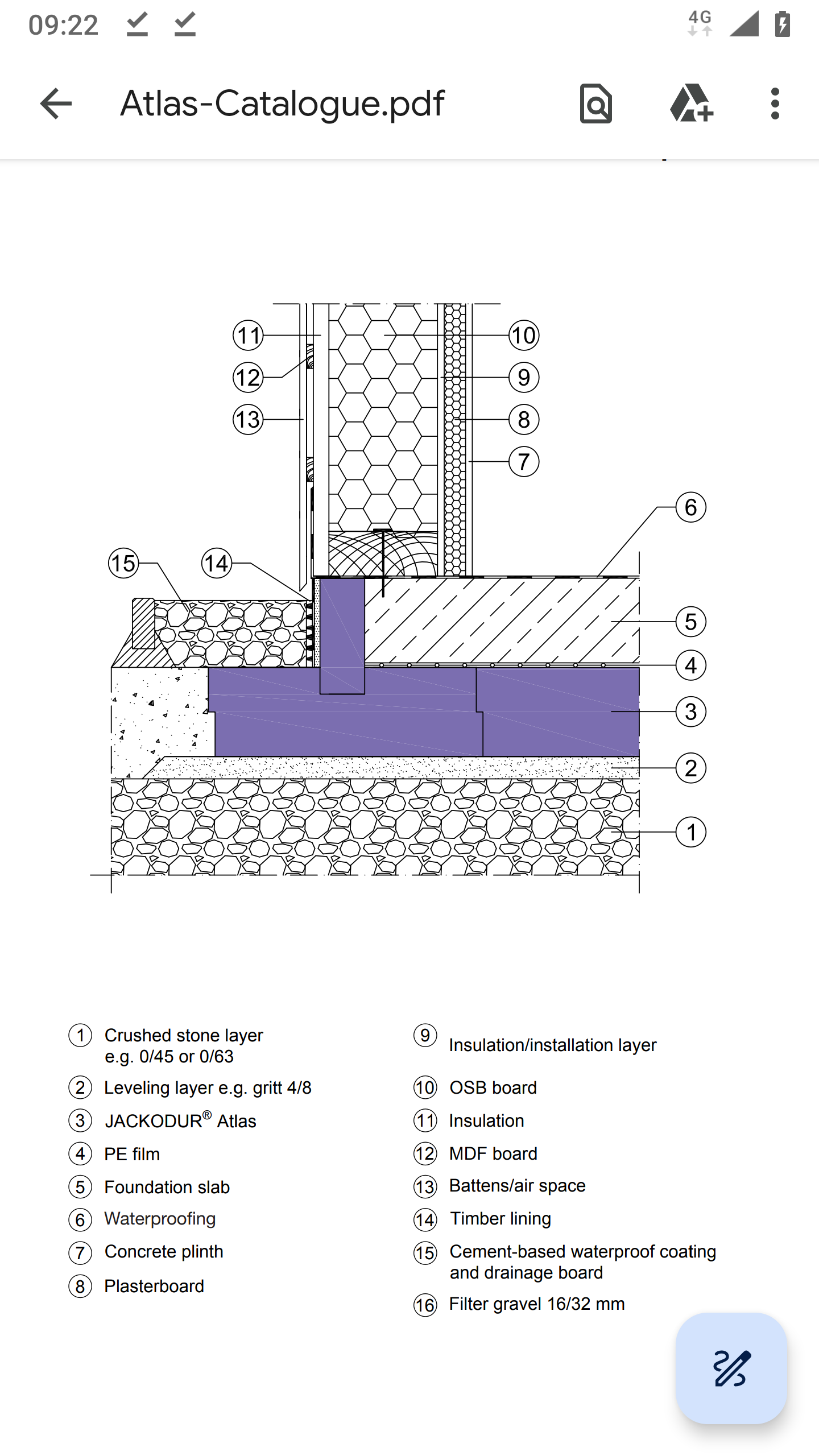

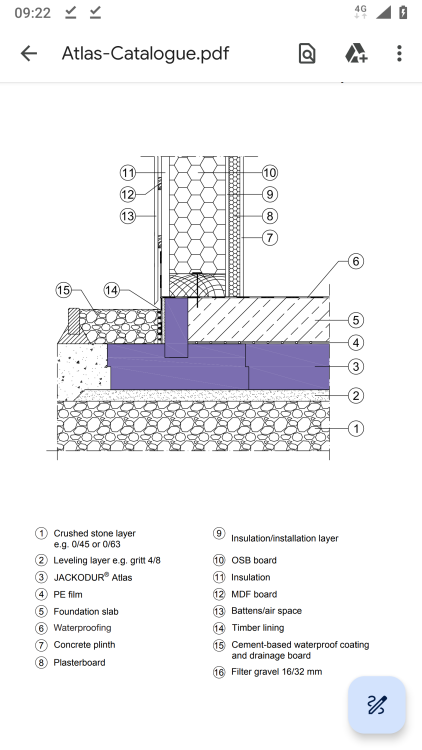

Neither. In our case the insulation forms the formwork with an upstand. Pic below. Our upstand is 200mm high and 200mm think, unlike the pic below.
Why is it more susceptible to blow outs? Will this affect us? we only have a 200mm slab with (Jackon) insulation making the form work. Thank you, in our case it's the ground work team we may use, suggesting it.
Any one had any experience with Self Compacting Concrete (SCC)? https://en.m.wikipedia.org/wiki/Self-consolidating_concrete https://www.breedongroup.com/products-and-services/gb/our-products/ready-mixed-concrete/self-compacting-concrete We have an insulated raft, with half the rebar in currently and are looking at options for the pour. Slab is ~100m2 at 200mm thick. One Suggestion is for SCC. It can be made to the correct strength spec, in our case C35. Apparently, it is likely to give a more level finish than traditional + power floating. It will also fill underneath our threshold insulation without voids at the edge, hopefully.

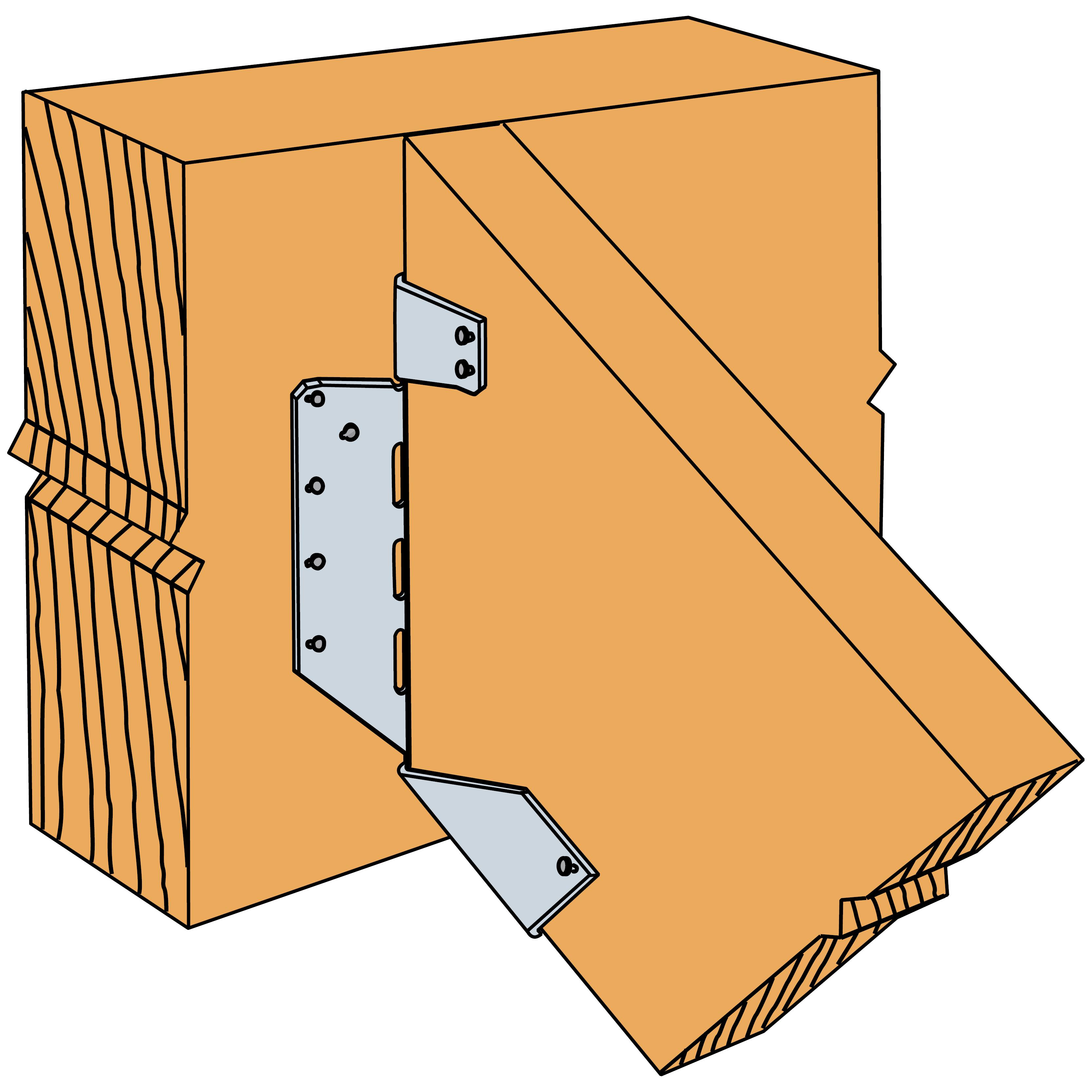

A connection made of wood will form far less of a thermal bridge than a metal one, whatever thickness wood is used. The concern is in the direction: inside the building to the outside of the building. You can hold onto the other end of even a small bit of wood in a fire. You cannot hold onto a small bit of metal in a fire. The heat transfers. Very efficiently.
Insulation: blown cellulose/woodfibre The problem is that the metal hanger will span the I-Beam from inside the thermal envelope towards outside = thermal bridge. (THERM analysis would show as much) Hanger as below but inverted in my case. Also, as we're hanging an I-Beam the hanger would indeed span the whole section, not partially as shown on this solid rafter.
QUOTE: "that wouldn't provide a sufficient connection as we'd be relying on nails through a plywood web of the beam and also the fixings would be running parallel to the grain/laminate of the packer which could lead to the packer splitting. The rafter must be vertically supported and laterally restrained to effectively prevent the roof from dropping or spreading."
Could you please help me try to find a Thermal Bridge Free (TBF) connection detail? It's for roof rafters as they connect to a lintel above windows in both cases. I want to avoid metal hangers as these are a tremendous Thermal Bridge. I suggested packing out both sides of the I-Beam (red line) with wood and fastening together, then fastening to the lintel (black lines). SE said no. I'm more of a yes man.
