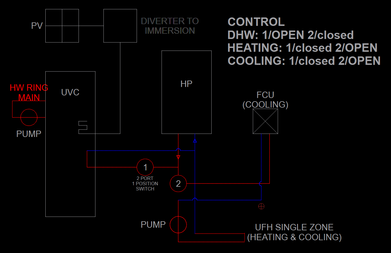

Thank you @JohnMo that is a great insight. I think I'm in over my head a bit with this, but I am doing my best to learn (have been reading here for years now) My reason for adding automation in the mix is because I'm not sure I could get the FCU controller to play with the DHW/UFH controller and HP. Thus I need to call for Heat/Cooling separately, adjust the valve/switch position separately, and run the fan on/off + UFH pump separately. The fan control, UFH pump control and switch control are straight forward. Calling for heating/cooling is what I'm unsure about as the HP manufacturers do not make it easy to see if this can be controlled by something other than their proprietary controllers. Are the 3 port switches spring loaded to return to a default, without power? I'm in first fix now, so I'm trying to finalize what I need, as the electrician is getting a bit prickly. What is the minimum viable solution?

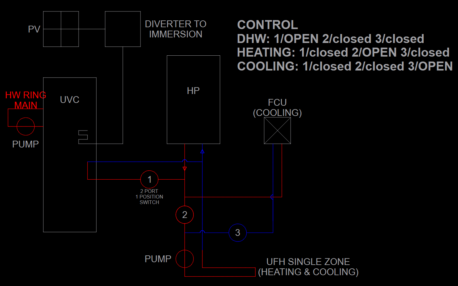

Ok, i'll check with the manufacture. Great news if so - Would eliminate another switch/valve. UPDATE BELOW. Heating: Hot water is sent though FCU in winter, no fan, returns through UFH to do its job heating the slab. Cooling: Cold water is sent though FCU, fan on, and returns through UFH loop to cool the slab too. Therefore: I can interlock 2x 2 port valves so that when one opens the other closes - thus only needing to send out 1 signal to control both. Anyone know how which HeatPumps have a simple contact closure connection for Heat Demand and Heat Satisfied on their internal control boxes - so that I can control that from the automation too?
Thanks so much, Ans 1: I've over complicated it, cleaner is below, with 3 valves, to control direction of water flow for the three scenarios. (DHW, Heat,Cool) Ans 2: can I get away with only having the HeatPump pump for 300m UFH loops? Ans 3: I cant use a 3 port valve as the home automation cant handle that, so would need 2x 2 port to do the same job. Ans 4: Regards fan coil - is it ok to send hot water though it? usually they have separate circuits for hot water (maybe due corrosion?) - so sensible to avoid sending hot water into FCU if not needed? (hence additional valve) Ans 5: The system sketch I have so far is above - UPDATE BELOW - thank you for suggesting some simplification. So I can interlock 2x 2 port valves so that when one opens the other closes - thus only needing to send out 1 signal. 3 valves - 1 open for each type of operation respectively, DHW, Heating, Cooling - Other two respective valves closed.
I'm at the crunch point for getting a Heat pump and associated controller - and am wondering how everyone else has done this? System: DHW = UVC directly fed from Heatpump / Immersion fed from Inverter from PV. UFH = 1 Zone fed from Heatpump with 1 extra UFH pump FanCoil = (cooling only) 1 zone fed from heatpump, flow goes to fancoil first then into UFH and back to Heatpump (to add volume to avoid buffer) 4 x 2 way valves (could simplify by ditching valve3 and associated return) 1 x UFH pump Currently I plan to control the valves and pumps via home automation (velbus in this case) - so the controller does not need to do that. Will I need a heat pump that has a contact closure for Heat Demand or Heat Satisfied (Maybe a second for Cooling Demand / Cooling Satisfied)? The samsumg Gen 7 i'm looking at: It seems the wired controller is what calls for heat from the control box, with no option for an external signal to call for heat? controlkitmim-e03cn.mim-e03eninstallationmanual.pdf

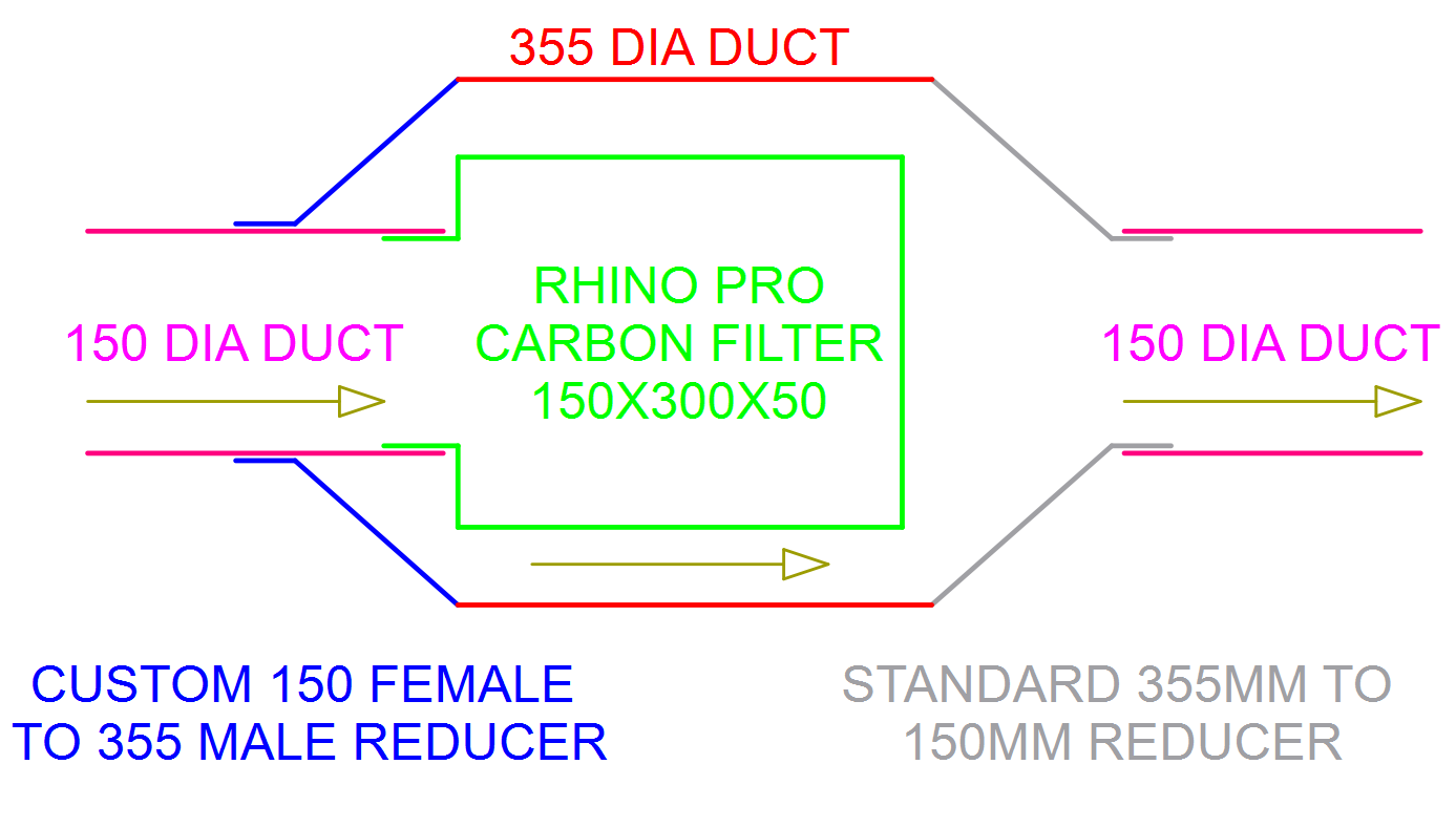

Man that is cheap. Did you use one? Thanks you for the suggestion. Never used Ali. Any idea on pressure loss? Another reason for DIY is because carbon filters for "plant growing" will never be discontinued, how would you get replacement filters in this case? I guess you could buy another whole unit if it is discontinued, bit of a faff tho. -

How's this idea for a DIY inline carbon filter? Will be placed on the supply side of the MVHR. The reason to DIY is to double the carbon bed size at a slightly reduced cost when compared to Blauberg Clean box 150. The Blauberg Clean box 150 has carbon filter: 220 x 400 x 45 = 4,000,000 cubic mm DIY Rhino Pro Carbon Filter: Pi 150 x 300 x 50 = 7,000,000 cubic mm Lifespan: Rhino pro states 2 years at 600m3/h. So at 150m3/h (my case) expecting an 8 year life span. Part List: 150 duct. £15 / 3m 150 coupler. £3 Rhino Pro Carbon Filter: 150x300. £100 Custom 150 F to 355 M Reducer. £45 355 Duct. £90/3m Standard 355 to 150 Reducer. £20 Totals About £270 Blauberg £400 -
