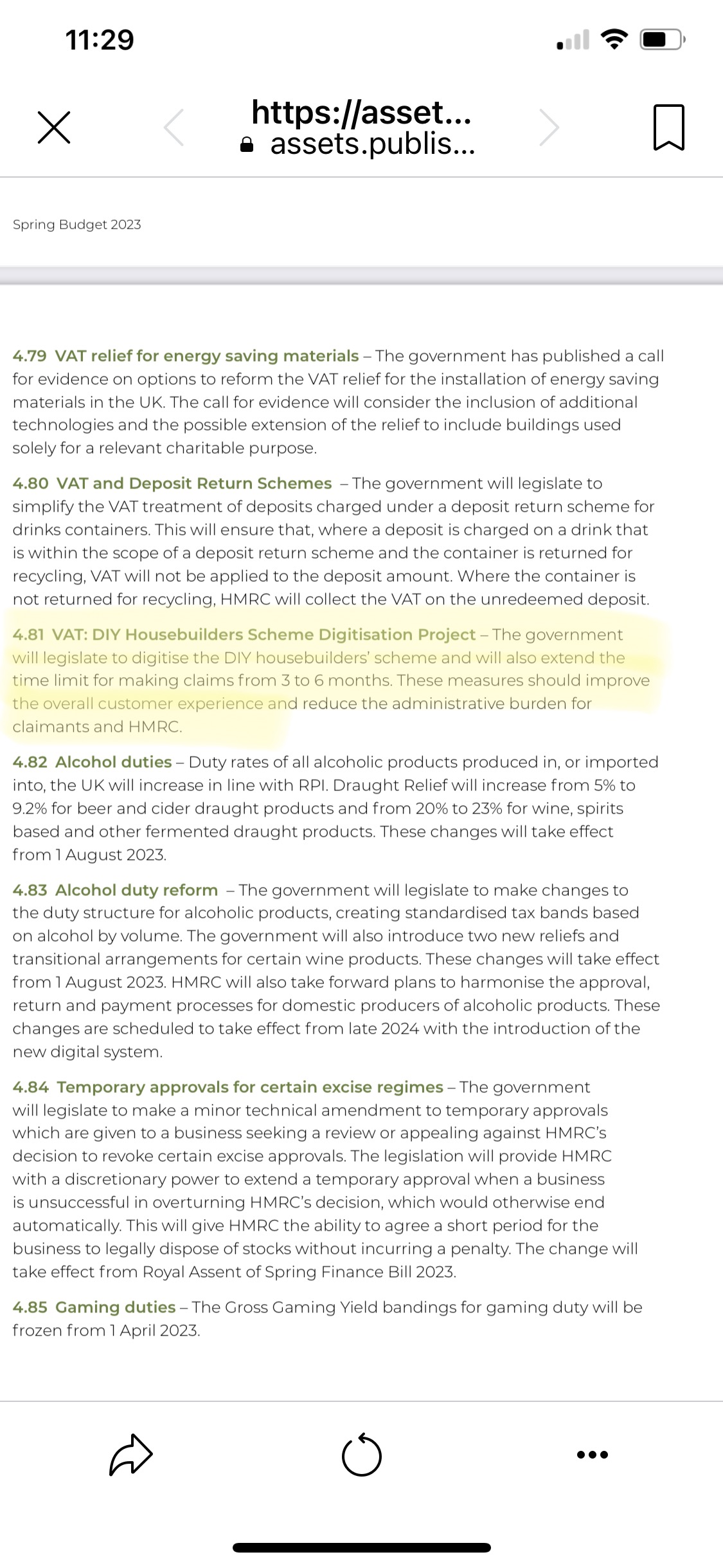

  23. No timeline unfortunately but at least it’s a step in the right direction. Whether it eventually improves the customer experience in terms of time from submission to payment remains to be seen. “4.81 VAT: DIY Housebuilders Scheme Digitisation Project – The government will legislate to digitise the DIY housebuilders’ scheme and will also extend the time limit for making claims from 3 to 6 months. These measures should improve the overall customer experience and reduce the administrative burden for claimants and HMRC.” See link to full document Budget Spring Briefing 2023
      • 2
      • Like
  24. Strictly speaking it will be rejected but as @Temp says you may get lucky, you may not. Humans check the claims and can make errors.
