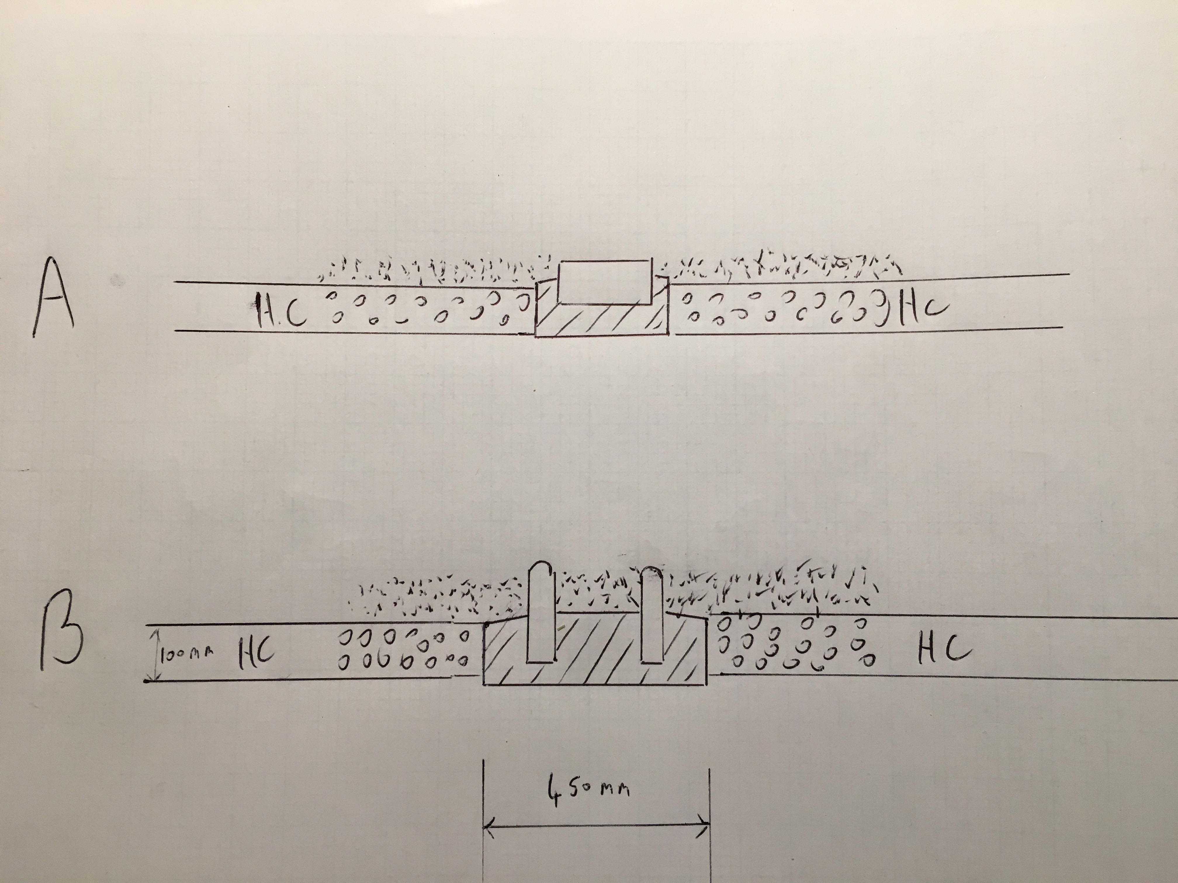

  10. Thanks both, I was about to head off to the BM at 4pm to buy 14 path edging sections for £90 then said to Swmbo "if this idea fails it will be a right pain to remove, I will postpone for a day and see what they think on BuildHub". Ok I will shop for something more substantial than path edging kerbs particularly as the BM lorry can save me much labouring effort if it enters the site and swings deliveries further in. In addition to the flood barrier I need something that looks rustic and as a bonus will keep the chippings separated because my drive will have light "Cotswold Chippings" (actually the non porous type of the same name from Derby) but the site road has dark grey chippings to resemble tarmac.
  11. I have dug a shallow trench 5.4m long across the entrance of my drive which leads to a gravel private road. My intention is to build up something resembling a speed bump to prevent water running onto my plot. Background: Last winter I suffered repeated flooding episodes in my open foundation footings during heavy rain e.g. 1" overnight or 2" in a week. This autumn matters have improved because the uphill boundary of my plot now features a 40m long soil bund about 600mm high, this will become a hedge base which is a requirement of my planning approval. My lawn is much dryer this year compared to last winters boggy state because surface water is deflected around the plot. However much the same volume of water now enters the site via the drive entrance which is a 5m gap in the hedge bund. Planned Solution Having watched the inward flow of water during heavy rain I reckon a shallow ramp at the drive entrance will dissuade water from entering the plot i.e. think speedbump. The problem is my final drive will have a stone chippings surface which leads to a private drive which is also finished in stone chippings, this means I need to form a solid ridge to prevent water wriggling through the hardcore and gavel of the private road and then into my plot. My Question. Would a double row of concrete path edging kerbs deteriorate as domestic traffic passes over or should I buy something more solid such as the Melton kerbs shown here https://www.brettpaving.co.uk/commercial/kerbs-channels/meltone-kerb/ I was going to use these https://www.travisperkins.co.uk/Marshalls-Concrete-Round-Top-Path-Edging-50mm-x-150mm-x-915mm-1615/p/924013
