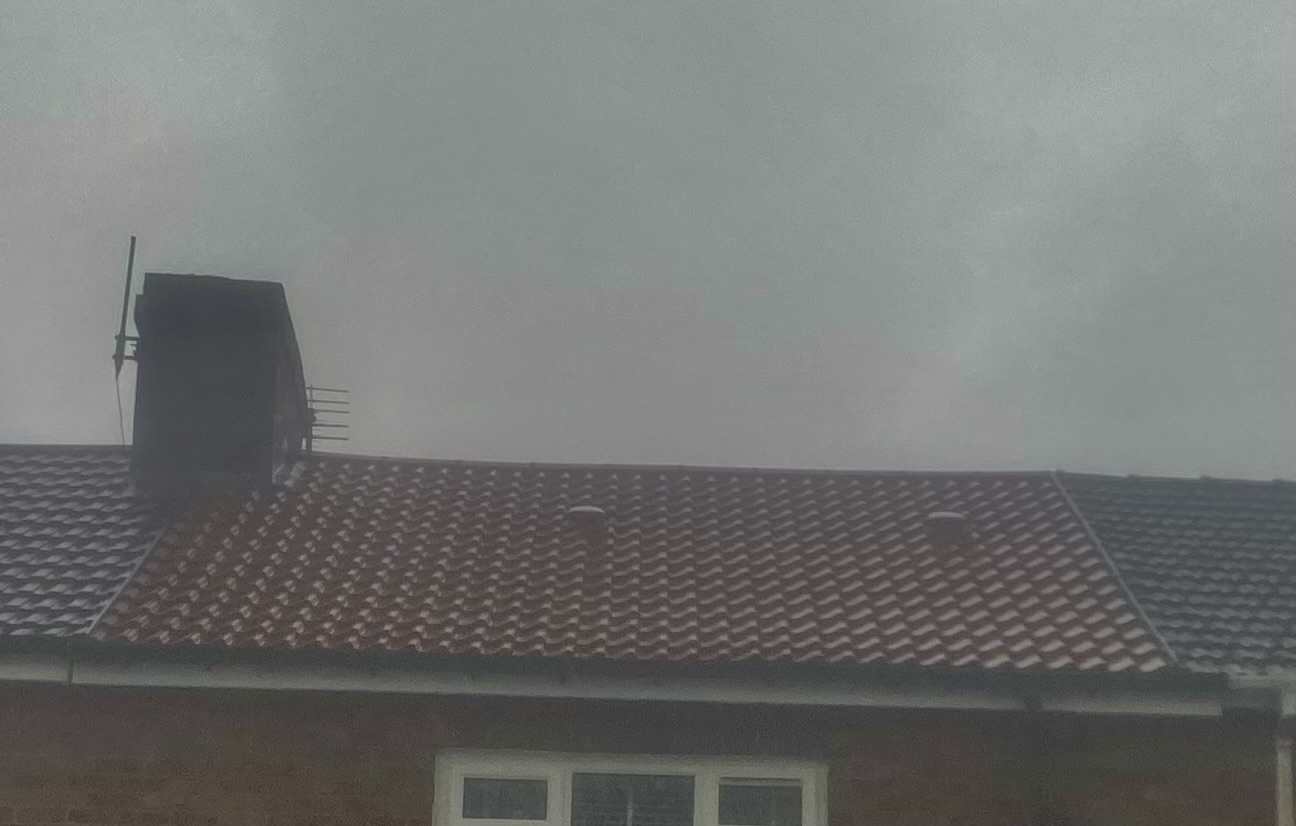

MVHR & Wood Stove
Marko replied to Marko's topic in Mechanical Ventilation with Heat Recovery (MVHR)
That window is north facing. No none else in the street seems to use their chimney. What do you reckon? -
MVHR & Wood Stove
Thanks for info both. The intake, on the left is fairly close to the chimney so unsure what to do. Might be that smoke blows over and past. -
I live in a standard terraced house, and my MVHR intake and extract terminals are located about four tile courses below the ridge on the side opposite the chimney. I am considering recommissioning the existing chimney for a wood-burning stove, and I am concerned about whether smoke might be drawn back into the house through the MVHR system. If anyone has dealt with a similar setup, I would appreciate any insights into whether its worth the hassle or not.
Am I right in thinking that going of Approved Document F, you go with the higher flow rate value of either paragraph 1.24 (A minimum rate of 0.3 litres per second per m2 of internal floor area)....or table 1.3 (Minimum ventilation rate by number of bedrooms (l/s)). In my case: Paragraph 1.24 requires meeting both 0.3 l/s/m² and the bedroom-based flow. For my area of 58.4 m², 17.52 l/s is needed by floor area, and 25 l/s by bedroom count (two bedrooms). So, I must use the higher value: 25 l/s. For boost, I was planning on upping these by 20%. How does all of this sound?
