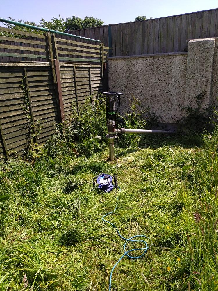

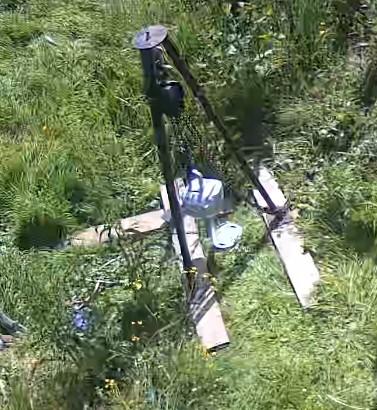

So - Attempt #1 of trying to build my house failed - Made Ground (Poor soil bearing), a buyer who wouldn't grant me legal permission to access the mains water after I sold and changed their mind after I'd let go all the builders, and my planning permission extension was refused.
Attempt #2:
  • Re-Applied for Planning permission from scratch - preliminary decision due July, final decision August 2023.
  • Place my house back on the market in the meantime somewhere between those two dates.
  • Finally I need to find a solution for the poor soil / made ground. Today was that day!
The Structural Engineer got the Ground Screw company to come onsite and put a 1.5 meter screw into the ground in 5 different places and do a pull test against each one. They each held over 4 tonnes of pull pressure which is good and the results will inform the Raft Design so I can get it priced. It was all done with hand tools with a motor assisting the Screw insertion / extraction running on 240v via an Extension lead. Then they put a tripod above the screw and a measurement device to determine the force trying to pull it out.
Probably looking at 30 or so Ground Screws and a number of Screw Piles for point loads & using a laser level. Had a good chat with the team and they have 5 years of experience and have been to Holland where they source their system from. Due to the coastal conditions there they typically use 6 meter screws! Some soil conditions eat away at screws over time 30-40 microns per year which gives you 50 years guarantee on a 3mm thick screw to allow up to 1500 microns to be eroded. They had heard about some cheaper Chinese screws that were pulled after 3-4 months for a different reason and they had started to rust as their galvanisation was not thick enough. Very bad if that happens! The team do a lot of extensions, shipping containers and garden rooms but houses too. If the screw is exposed more than 500mm you need bracing - this can happen if the ground is sloped.
The system should save on soil muck away and concrete costs hopefully. Cost wise I'm looking at @ 5K for the ground screws vs digging 2.2 meter strip foundations and muck away costs / concrete as the alternative.
You can sit a foundation on top of the screws and this may mean you don't need a Radon barrier as there is airflow underneath? I'll go with whatever the Structural Engineer recommends though.
Anyway, thought I'd have a big JCB onsite but this took about 4 hours with powered hand tools and gave me confidence in the system and the team behind it which helps.
Educational Day all in all!!

Hi Mike,
That was a very interesting post. Is their an intuitive way to think about how the pull force measurement relates to a downwards load requirement? Or am I missing something?
Alan

19 hours ago, Alan Ambrose said:
Hi Mike,
Alan
They did try to explain the load factor to me but it didn't quite penetrate my cerebrum! I may still need screw piles for some point loads. There is a lot of contingency built into the calculations for worse soil conditions than mine, higher loadings etc. It's a whole new area to me!
Link to comment

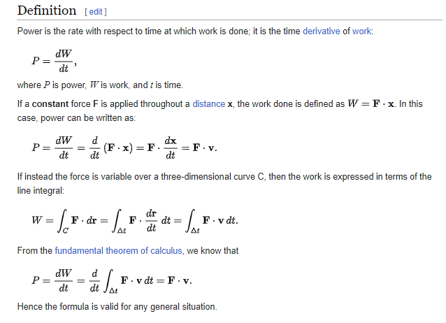

Forces and Motion.
All things being equal, which they are not, the force to push something will be the same as to pull something.
Because of gravity, the force to pull a screw pile upward will be greater than the force to push it downwards.  This difference can be subtracted from the pushing load.
As @saveasteading said, there may be a situation where the end of the screw goes into a void or softer soil.  This would show up as a reduction in power to drive the screw into the ground, the reverse is that the screw hits rock/solid obstruction, the power goes up.
So if you know how much work (J) is done , in how much time (s), how far the screw as been driven (m) you can calculate the force (F) in a simple case. Power = Force x Distance.
I all boils down to the units of kg, m and s.
Wikipedia has this to say on it.
Link to comment

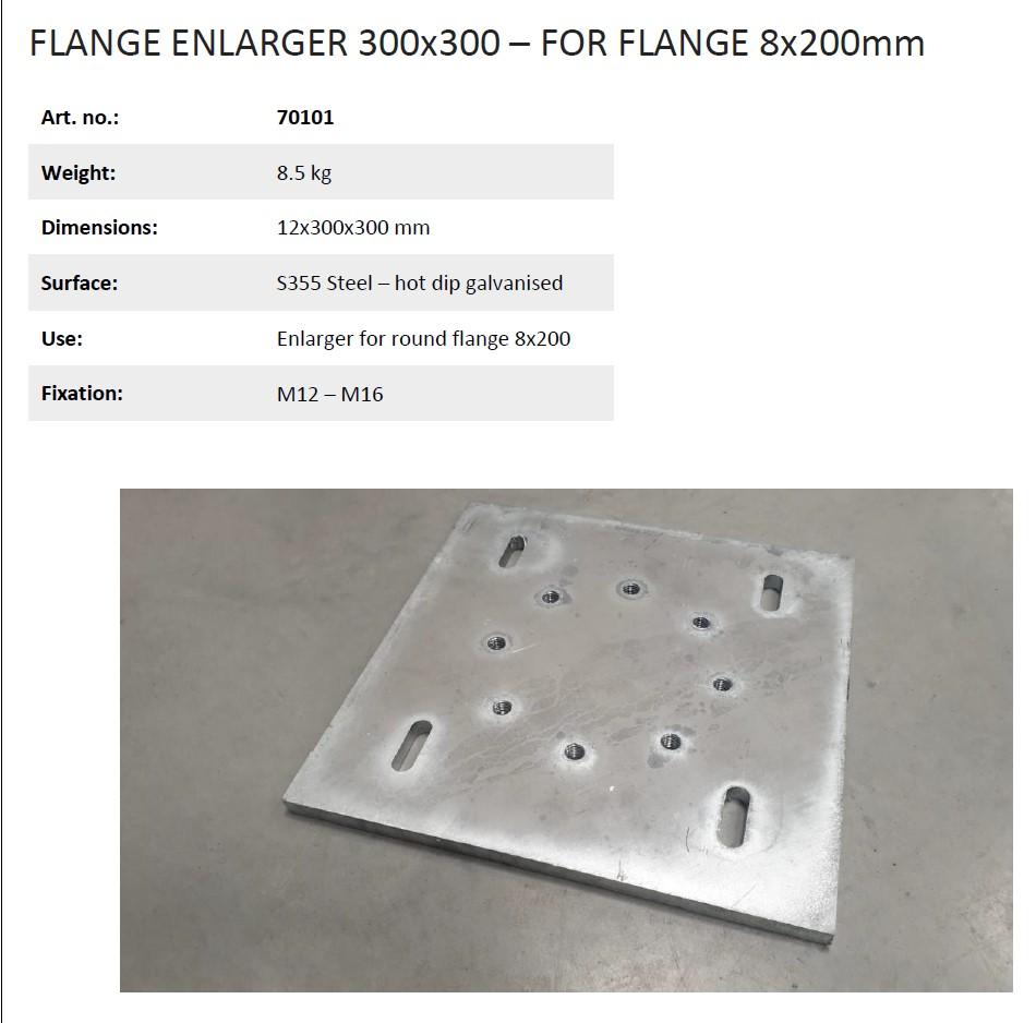

Looking at 80-90 ground screws for my design, a few more than I expected! They need a minimum distance from each other or they don't work as well. The minimum spacing is 10 x the screw shaft diameter (76mm in my case) so min 760mm spacing. Expecting spacing to be 0.75m and 1.75m centers. Build up (top to bottom): 450mm Insulated Raft Foundation, 300mm type 2, groundscrews. Will be interesting to see the final Design. Estimating it might be up to 15K for the groundscrew element alone though! Still to get official pricing though. Hopefully it's affordable....!
Added: There will be 400mm x 400mm plates on the screw heads. I had thought the concrete raft would sit directly on these but there is 300mm type 2 between them. Maybe I'm reading things wrong - geogrid ground reinforcement was also mentioned in this layer. Lots to get my head around!
Edited by mike2016

I first assumed that the pir and stone are penetrated by the piles so that the concrete loads them directly.
But then the stone does nothing.
Drawings should make this clear. It's good that they are not withholding this info  because the  operative cost must include all the effects on other materials.
For example if it needs a heavily reinforced raft.450mm is already massive, and £50/m2 for concrete purchase alone....that is bridge construction.
Edited by saveasteading
Link to comment
