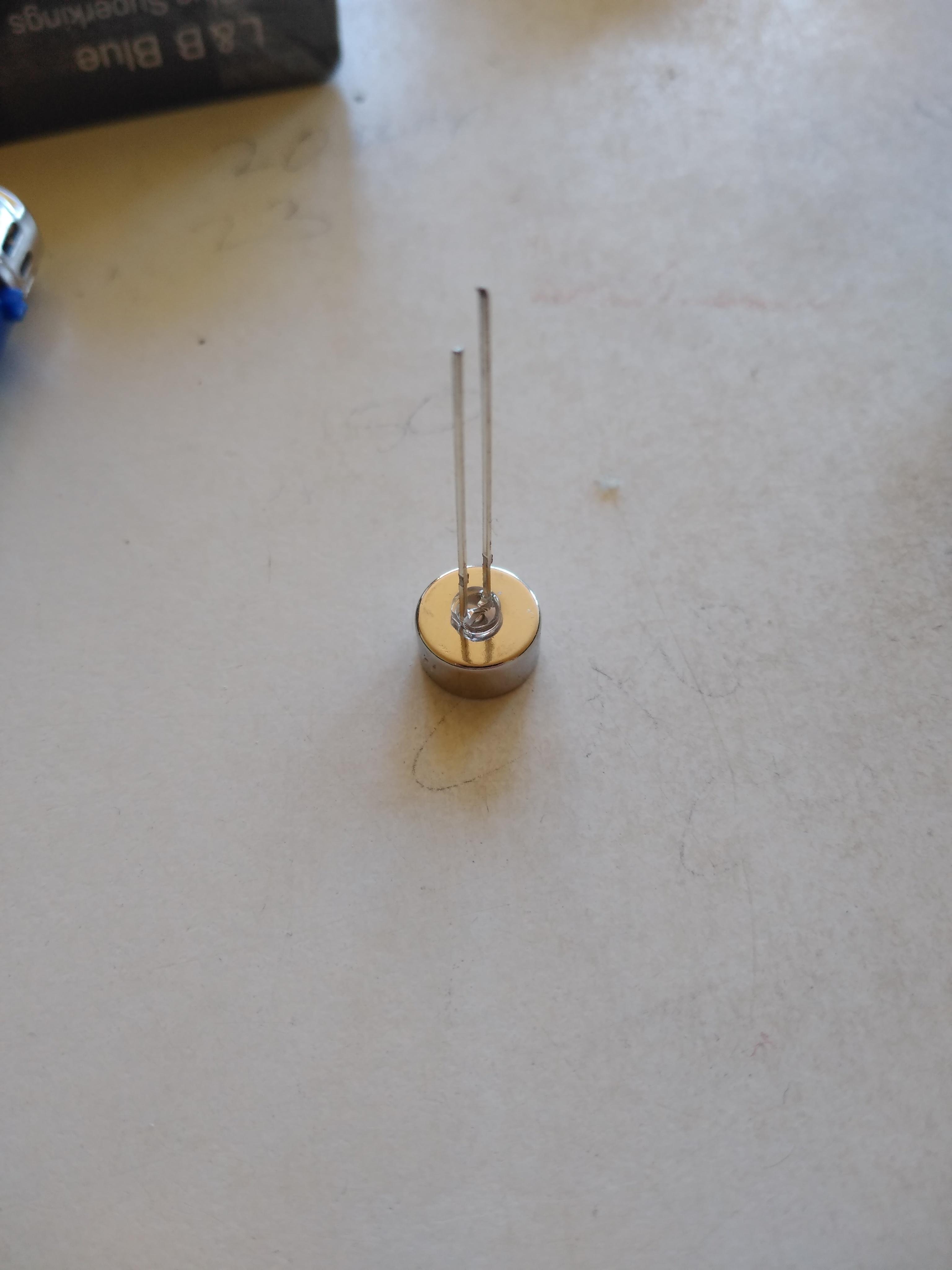

These are to hold the light dependant LED onto the meter.  A suitably sized metal washer was super glued in place.
Some photodiodes to sense the red flashing light on the meter.
https://www.ebay.co.uk/itm/232690475106
This is the real magic, just wired in between a GPIO pin, 22 in my case and ground.  The important thing is to wire it in the ‘wrong way around’.  So the anode, the longer leg on the diode, is wired to ground, and the cathode, the short leg, is wired to pin 22.

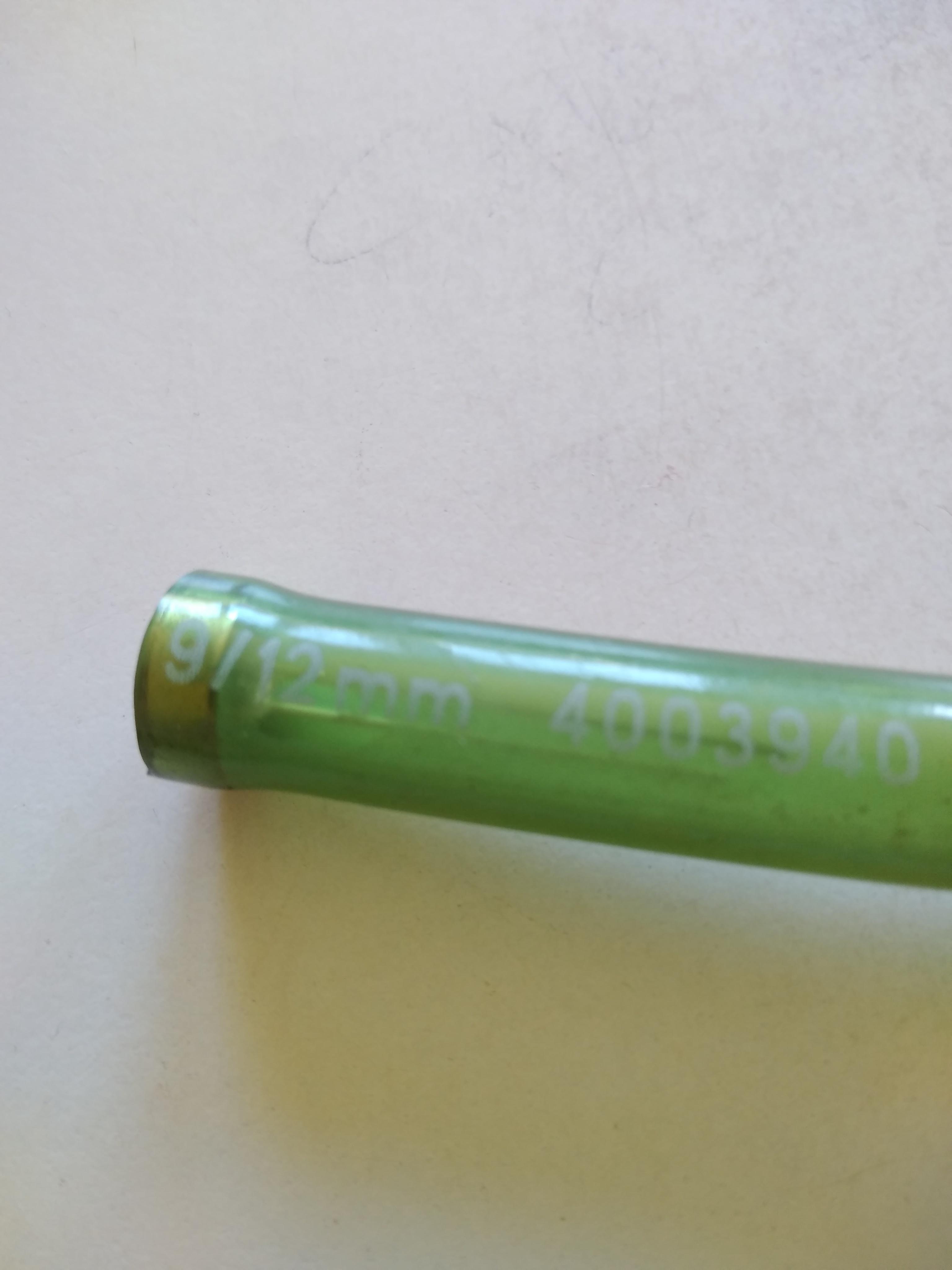

I used a bit of rubber pipe and some epoxy. after super gluing the LED into place.
Picture to follow in a few minutes.

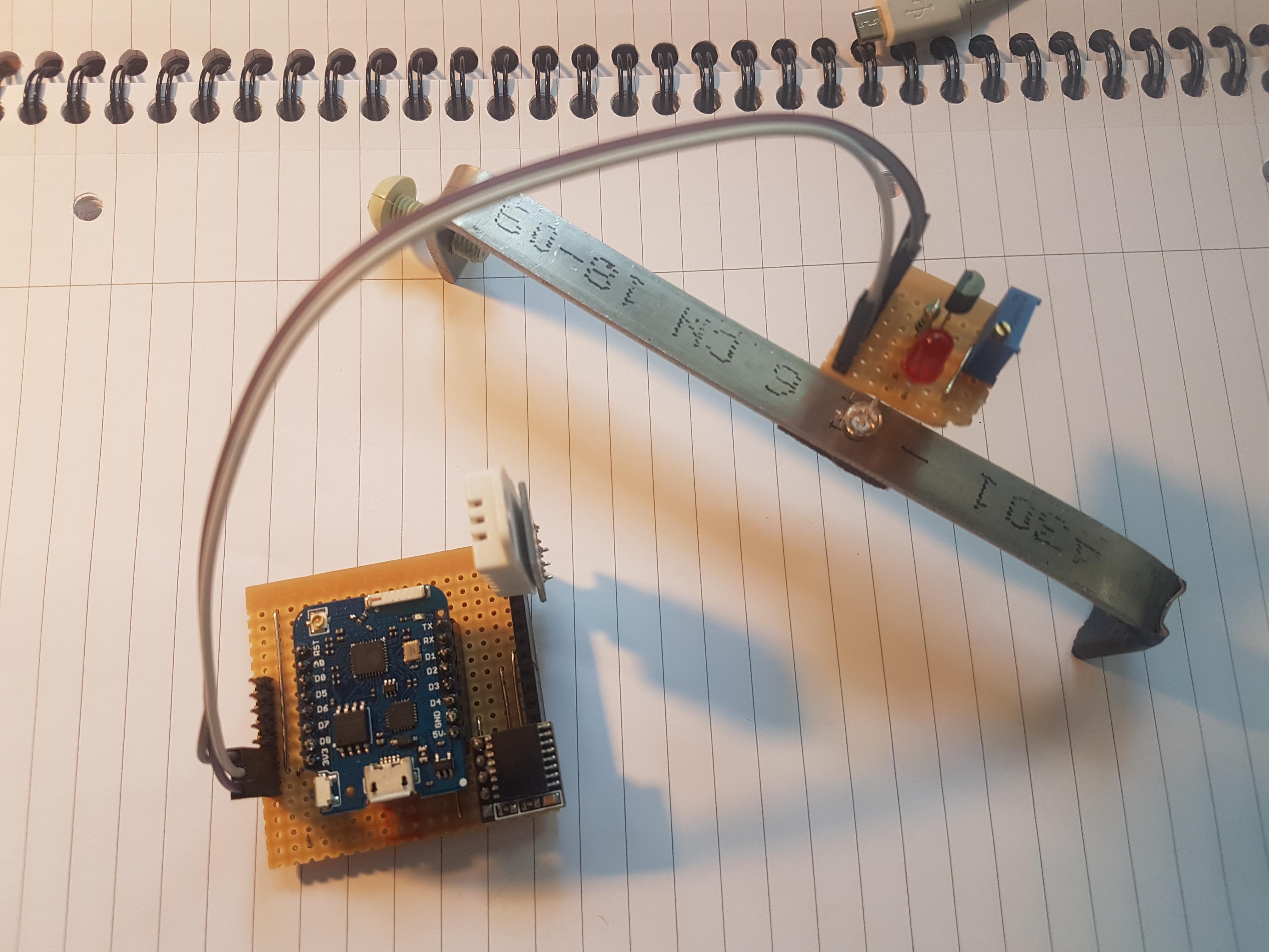

Ok so I have been working up a ESP8266 based equivalent of the Steamy counter. Although it broadly works I am having a real struggle getting the RTC to work reliably. Technically I don't need it as the receiver end could do all that, I could use the millis() functions to create quite good timing and I need that anyway to measure the interval and get a rough idea of instantaneous KWh. Could do this better with the 32KHz pulse train from the RTC if it was enabled on the boards I have - same as Steamy's. I have tried a slew of libraries but I still regularly get a bus conflict error on all three of my RTC chips and they all behave perfectly on an Arduino nano. As the RTC is currently managing the sensor timings - I put a DHT22 on the board as well for fun, I guess I need to fish out my logic analyser and look at the timing on the I2C to see whats going on although the scope would show me if the edges are fuzzy / noisy. I decided to echo the flashing LED on my sensor and made a bracket I can just tighten on the meter so nothing is actually fixed to it. So work still in progress I guess.
Link to comment
Going to be interesting to see your code. Never thought of adding an RTC to one.
