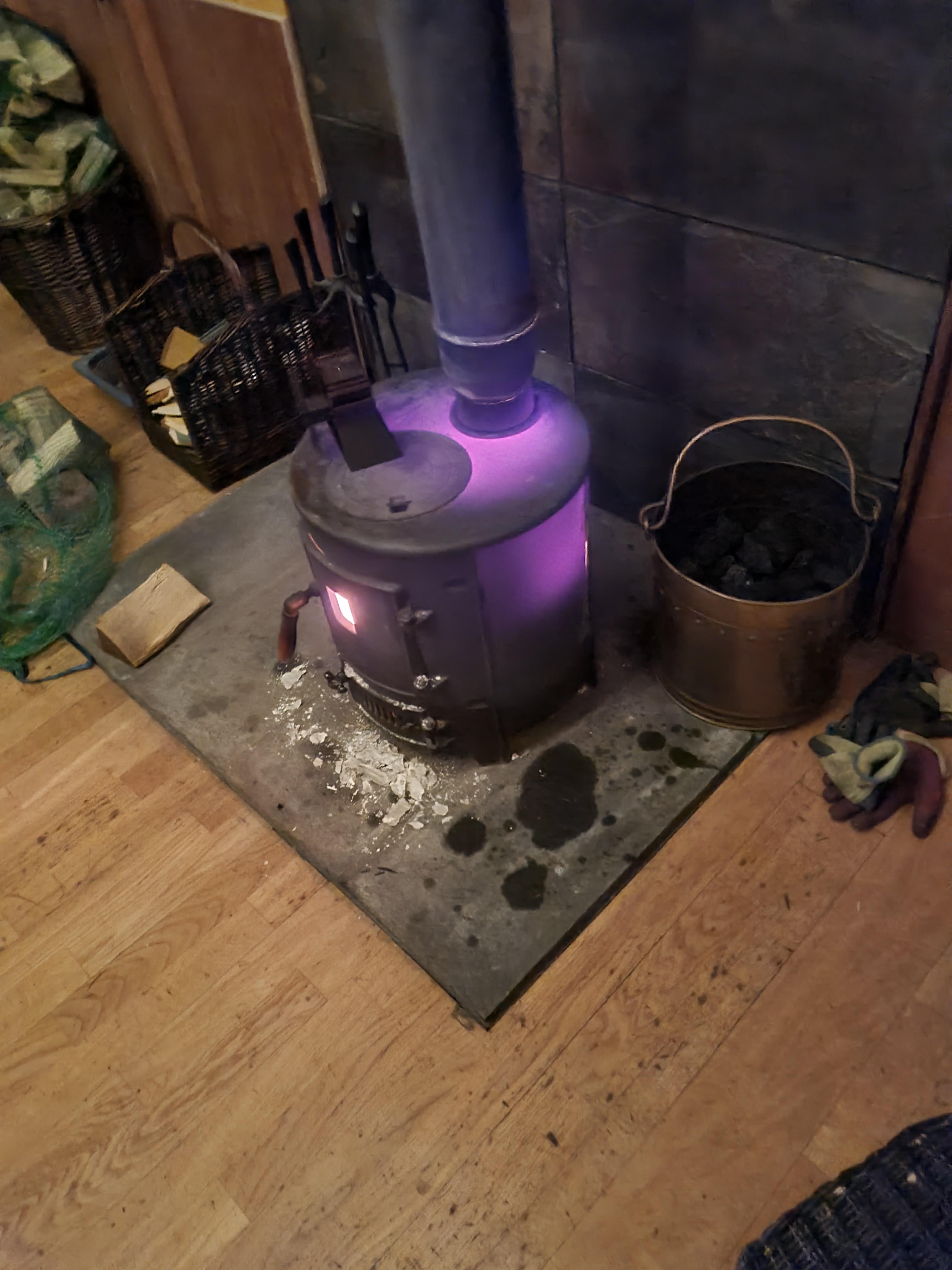

This is where our centrally placed stove surrounded by dense concrete block is used.
Stoves in the self build community are loved by some and loathed by others.
I feel if they are used in the right setting they can be a perfect addition to a self build project. For us it was a best choice as having access to wood, space to store and being willing to provide a little bit of hard work results in the heating bills being zero. When we designed the house having a centrally place stove was one of the first items on our list.

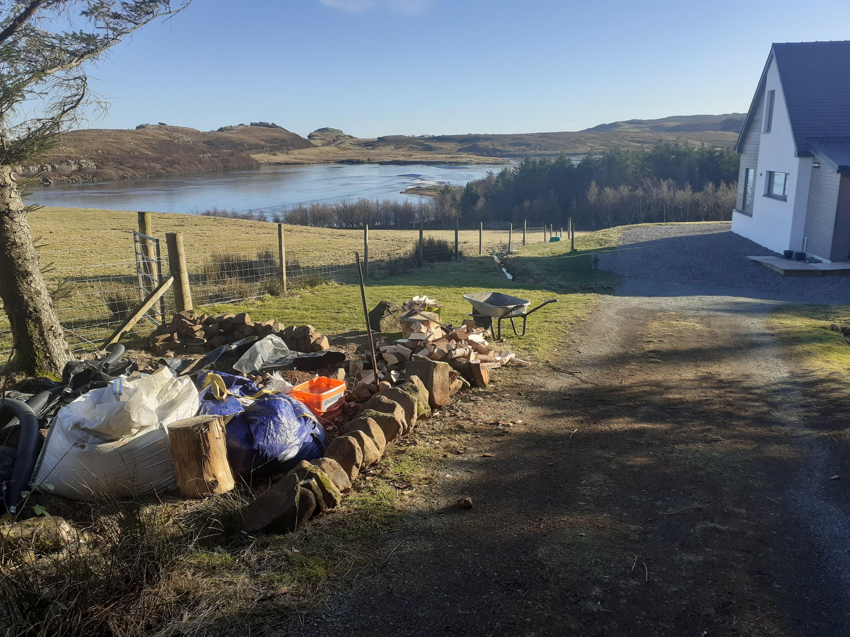

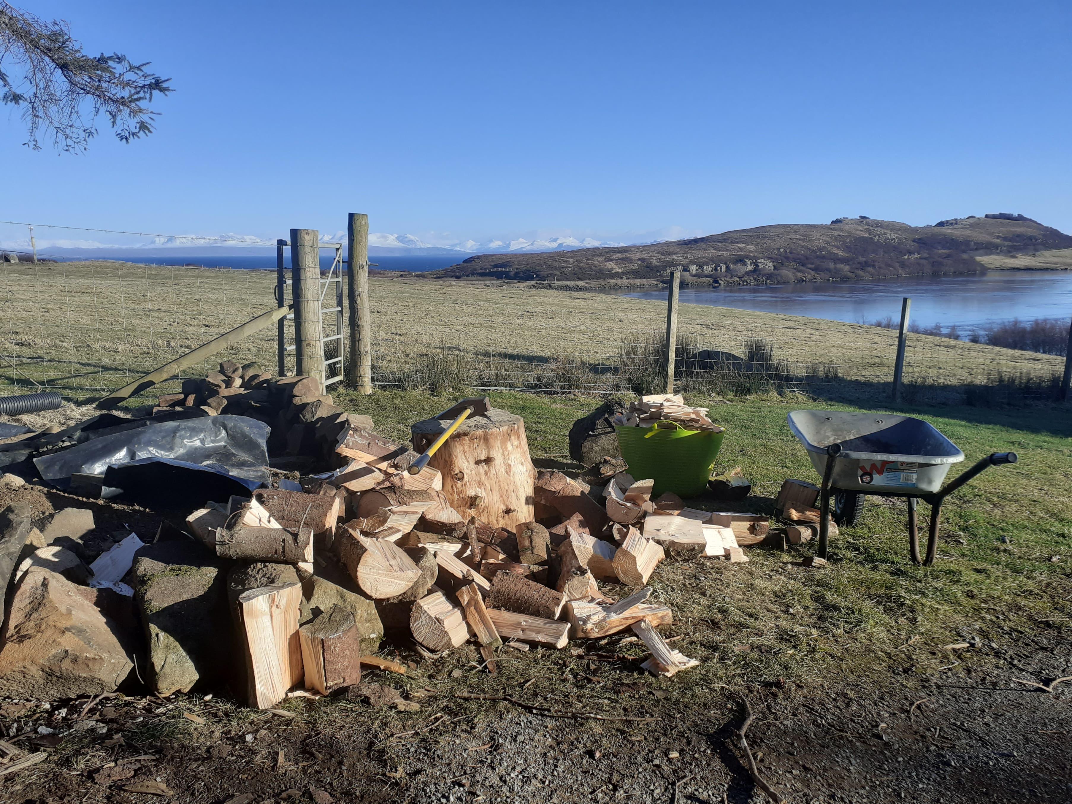

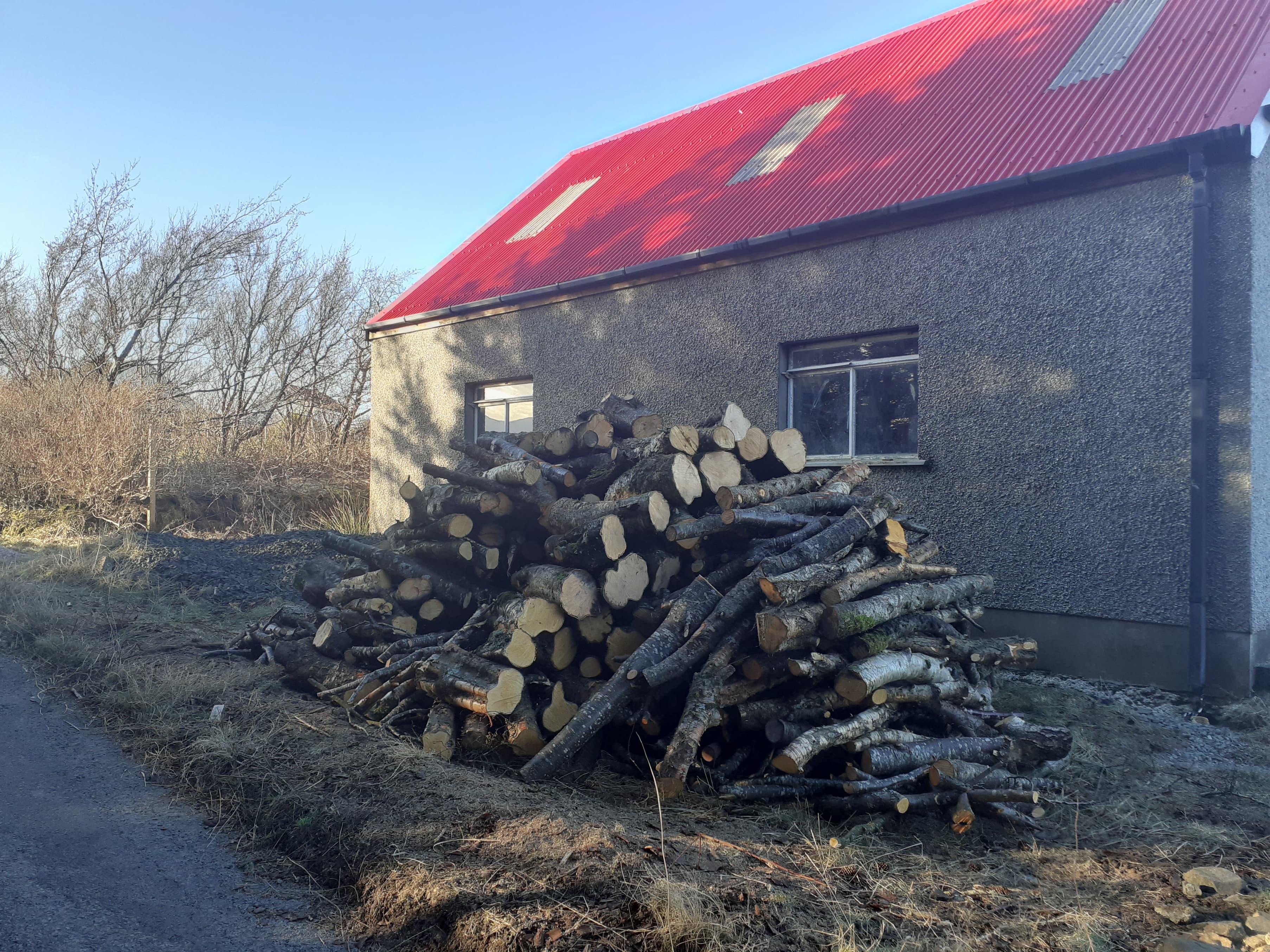

For our stove we burn a trug load of home grown logs each evening in the winter.
I would never have imagined how satisfying it can be to spend an hour on a Saturday morning splitting wood to keep my family warm. It's a great way to keep fit and can be an enjoyable hobby.
Recently we cut back some alder and birch trees which will be left to season and will form next year's winter wood.
Using coppicing as a woodland management will allow the trees with their established roots to regenerate quickly in the spring and perhaps be cut back again in ten years.

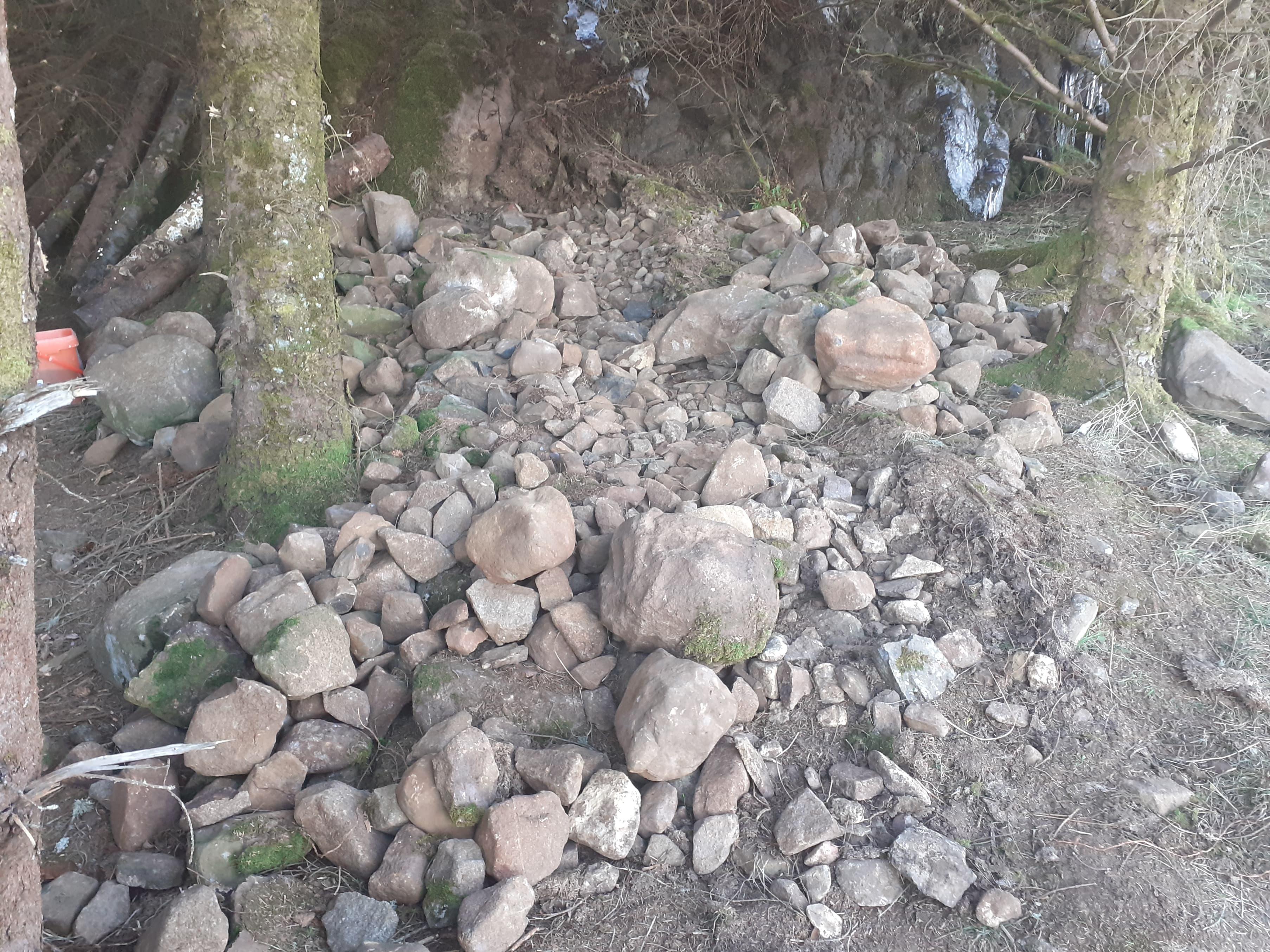

One job that I am working on at the moment is sorting a load of old stone to build a dry stone wall.
It's hard work but a perfect remedy after a long week of crunching numbers at a computer.
I've been warned by several people that a stove in a well insulated house is an expensive ornament. You've clearly done it and made it work. Do you think that surrounding in dense concrete block helps dampen the heat release to the house?
It can be an expensive ornament.
I think if self building, only consider a stove if you
are in rural location to allow your neighbours not to be affected by your smoke
you should really be splitting and storing wood
should not have it in a room, should be in a large open plan space to allow the heat to spread
If you can't tick these three boxes, alternative heating methods would be a better way to go.
I know the term 'thermal mass' has been debated here over the years.
My feeling it does the job as a storage heater. The block are still warm in the morning and having it in the middle of house no heat is loss to an external wall.

Another one here that can confirm a properly positioned stove that is able to circulate air to the whole house, works well in a well insulated house.  It is when you design a stove that is shut in one room with nowhere else for the heat to go, that you get overheating problems.
Top tip.  Get all your firewood split in plenty of time.  I need to go out with the snow shovel today just to find my chopping block somewhere under the snow,  then clear a path through the snow for the wheelbarrow.
I'm OCD about the firewood store. Always have three weeks ready to burn in the store, three days in the house.
Various logs are in different states of being seasoned all over the place. A moisture meter is a useful tool.
I guess some people could view it as being hassle, but for me it's  a hobby and an opportunity to do a bit of exercise.
It's a good plan, I have 3 piles, one woodshed for burning now, when that is empty I move to woodshed 2 which is seasoning and finishing drying, then there is the random big pile waiting to be cut & split, which gets more in the area each time we get more.
As of yet this has all be dead wood / trees around or nuisance weed trees, but we do need to start planting more as I think we only have about 5-8 years supply.
