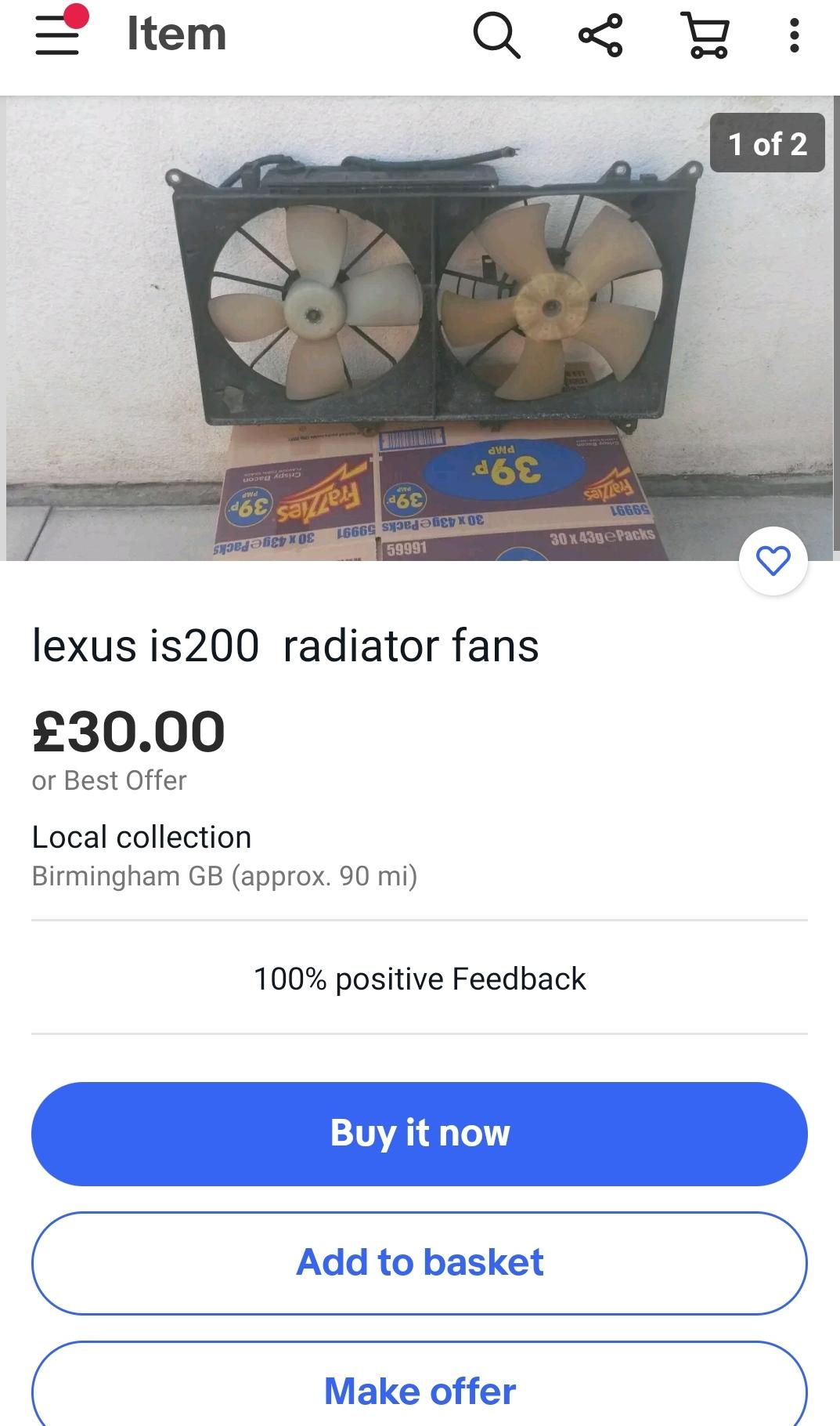

As documented before cheap radiator fan inserted into a sheet of OSB covering a window will more than exceed any blower door fan pressure.
Use the back of your hand for the big holes and a candle inserted in a length of  electrical conduit to nail any small leaks.
A diligent sweep of the house will get you above or beyond passive levels.
For awkward spaces airtight sealant
 and/or airtight paint will remedy most things.
I'd be surprised if the OSB is causing the issues assuming the cellulose is dense packed behind it.
