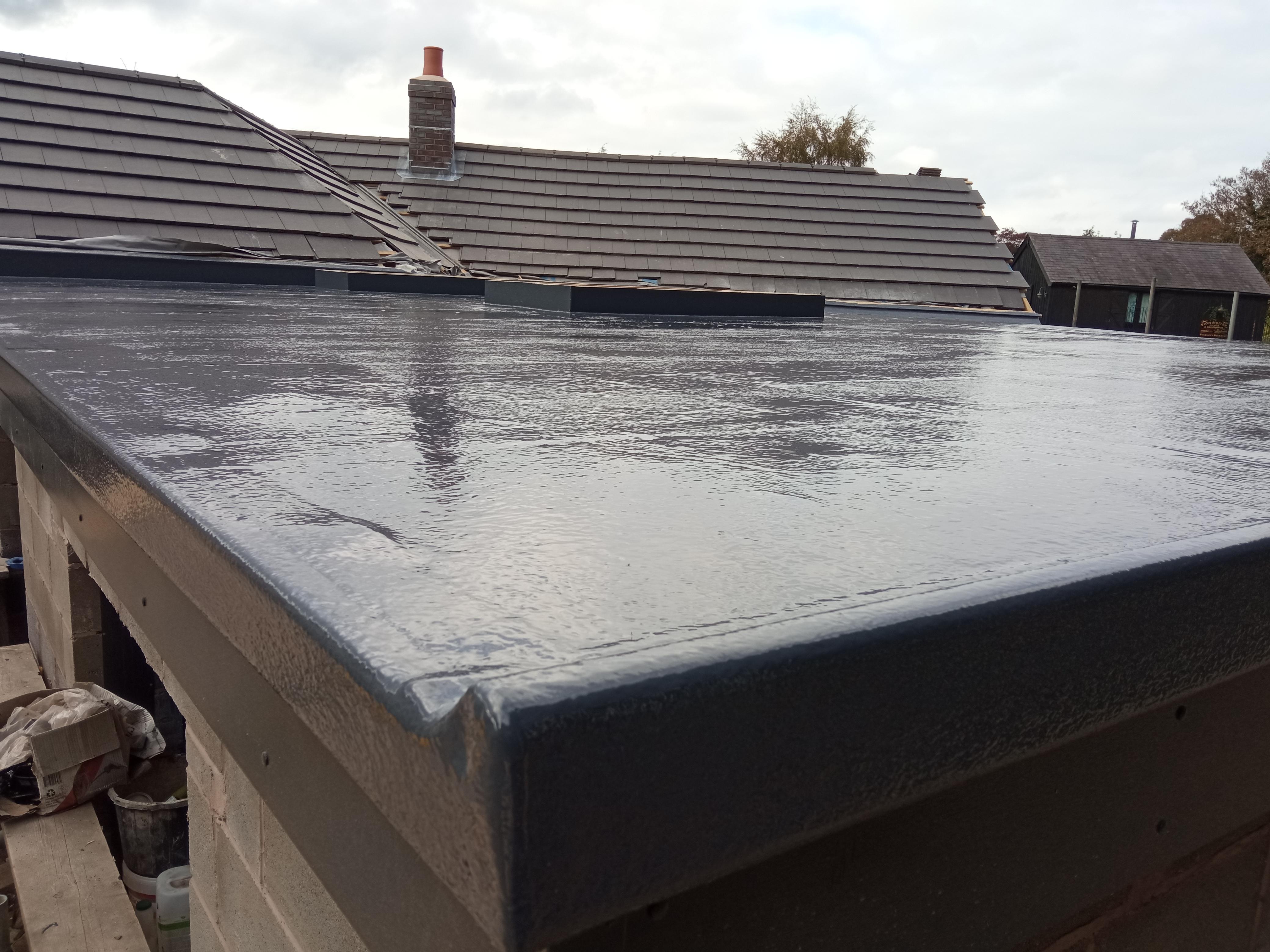

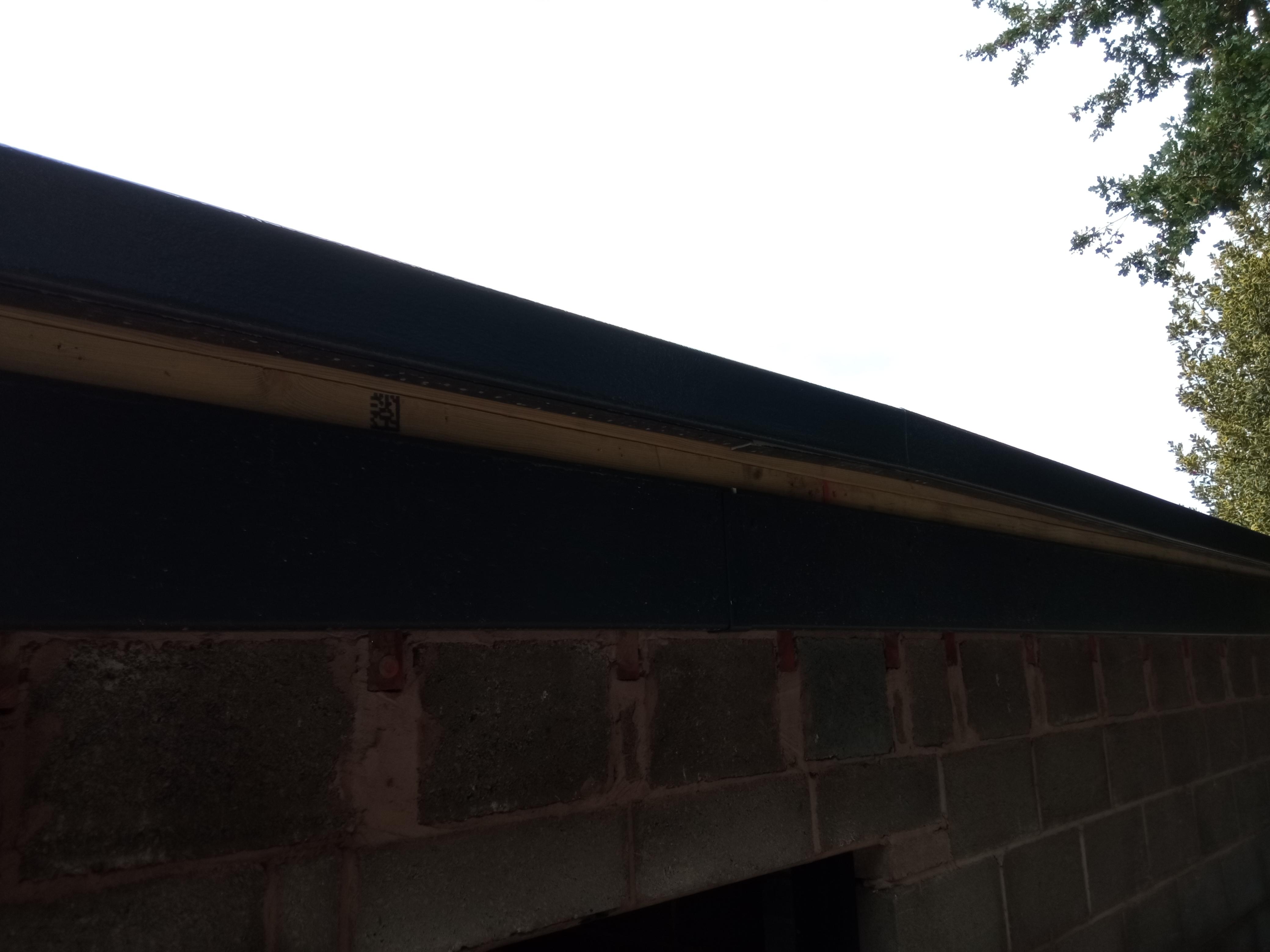

So.... Old roof off this week, firings sorted so our roof has a fall on it and the professionals arrived today for the GRPing, thank god it's dry. On site at the moment and just had a sneak peak.
We are so pleased with this compared to previous.
This is the fall, not sure how the builders are going to deal with the exposed wood yet.
Credit to the guys who were on site before 8am.

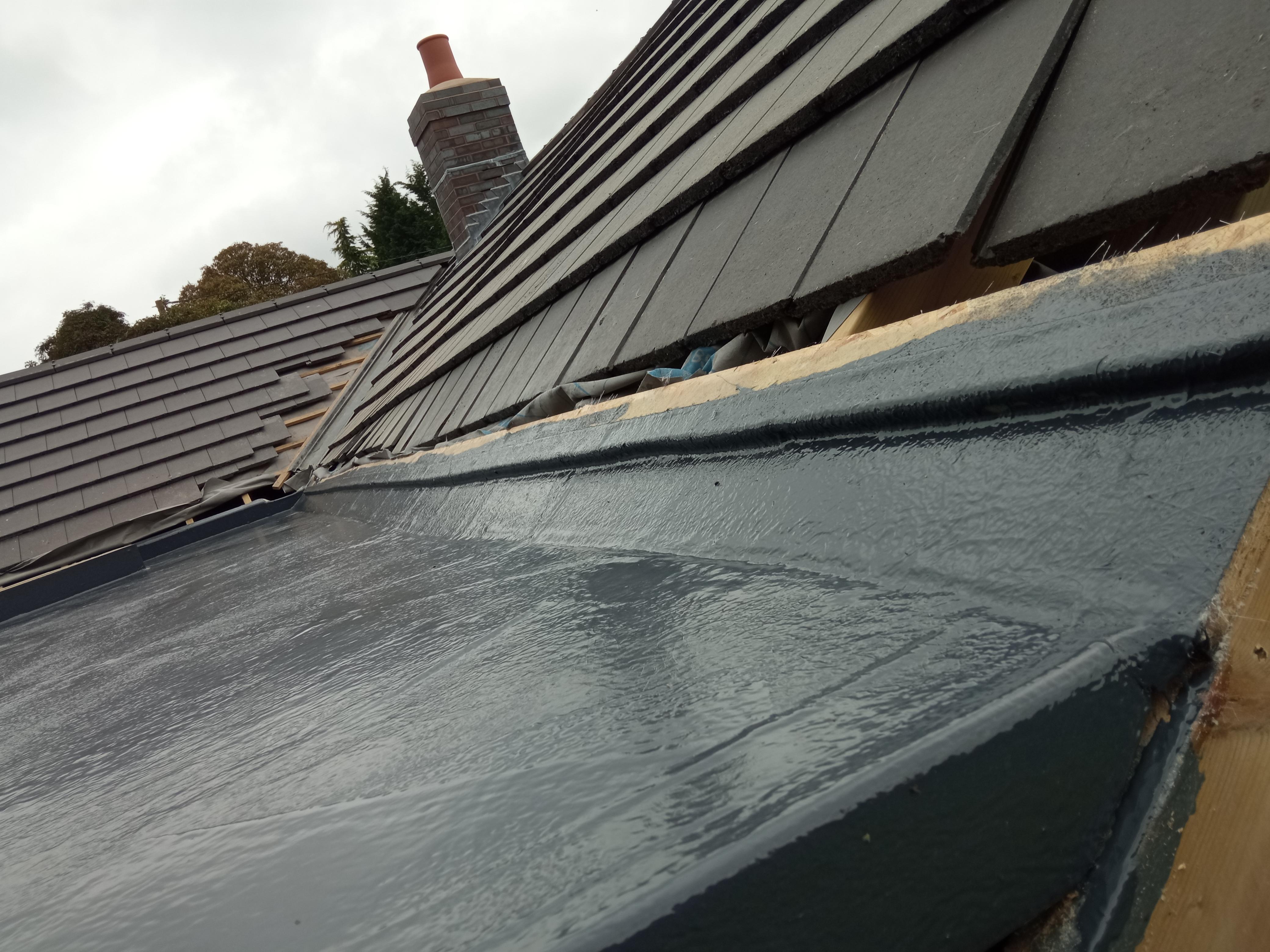

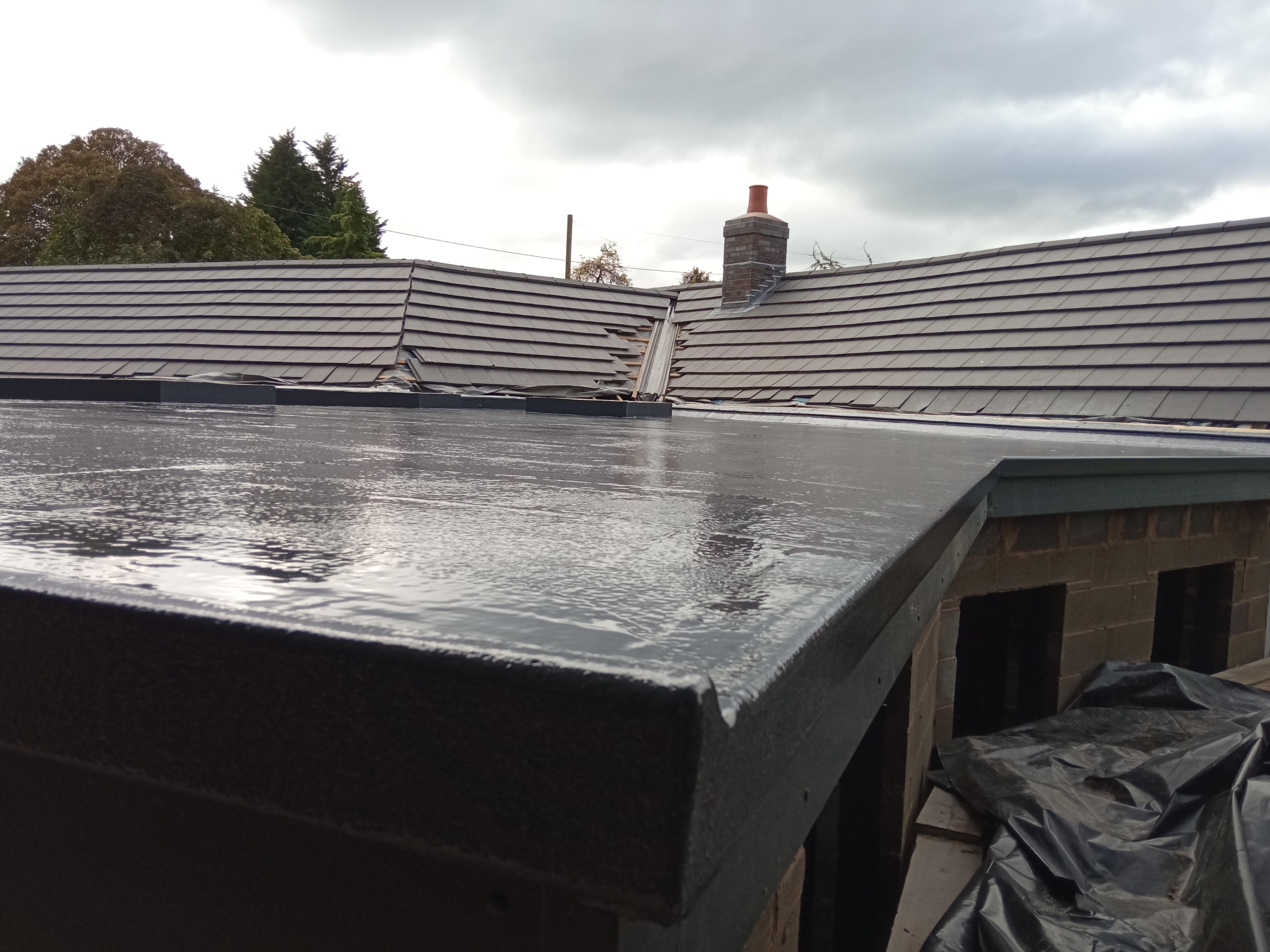

You might recall I questioned how they could introduce the gradient given the original minimal drop from the tiled roof to the flat roof. Looking at the photos they seem to have cut back the lower row of tiles to accommodate the new gradient.
Hopefully someone who knows more about roofs can comment on any extra flashing detail now required at the new tightly coupled pitched/flat roof junction.

So glad you got this sorted out, it must be such a weight off your mind, well done. Regarding @epsilonGreedy comment on flashing the GRP would be run up the slope under the tiles an amount so roofing felt and tiles rest on it. No need for further flashing IMO.

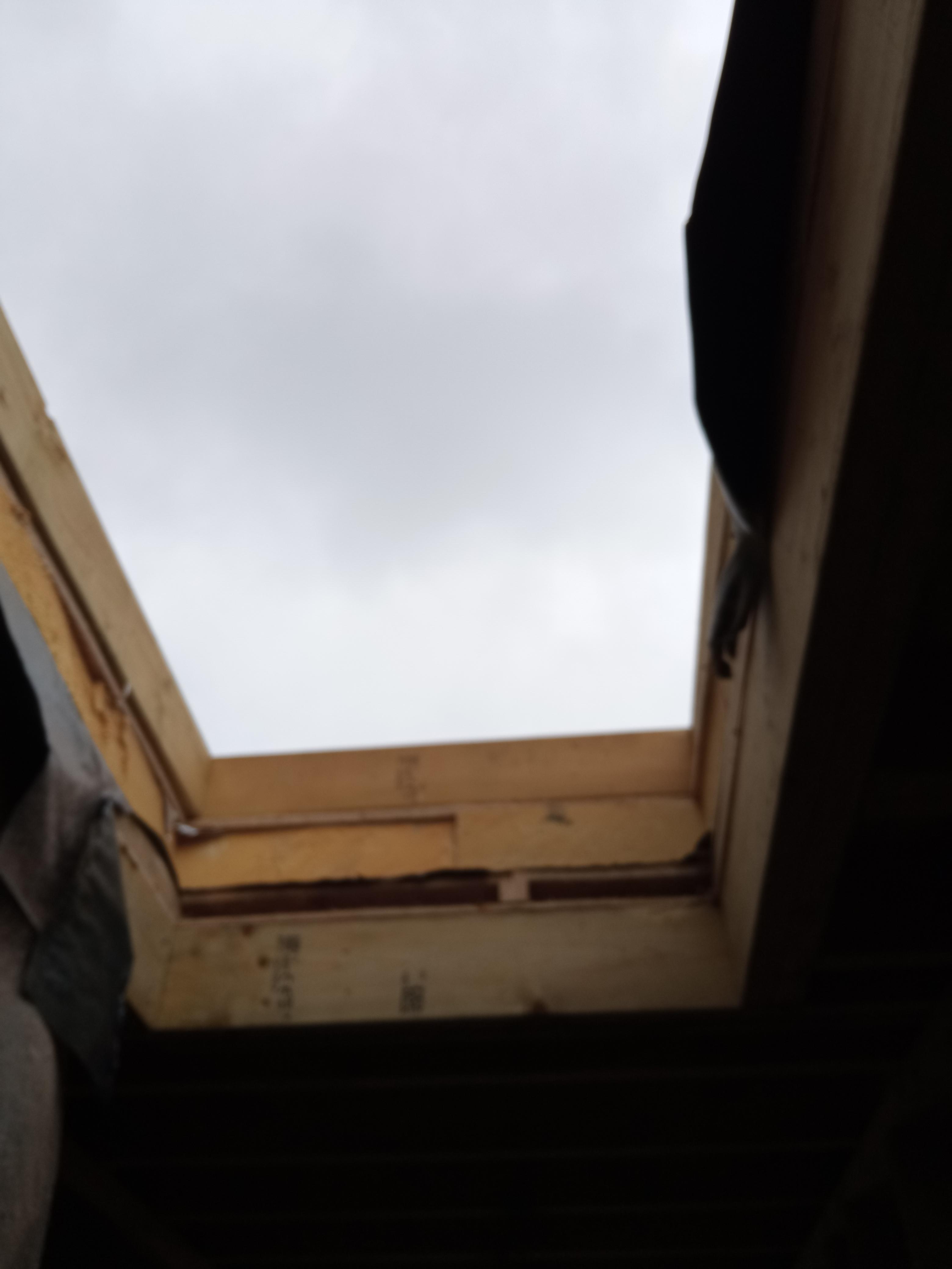

I think so, also the firrings are either side of the rooflight for the drop. Bl@@dy acorns are dropping on it now and I'm literally monitoring it like a hawk picking them off as they fall.

One more question for the roofing connoisseurs here. Looking at the latest photo detail from @canalsiderenovation, is there any concern about thermal movement at that flat/pitched roof junction?
I know the OP does not need any negativity at this point but now would be the right time to consider this issue before everything is closed up.

Glad to see they put a water stop above the slope that goes under the tiles. As far as I know thermal movement is not a problem with GRP it’s very forgiving and can flex. If I had to have a flat roof I still would do it in GRP despite other materials being available.

Here's a couple of better pictures before we leave the site for the day. It's touch dry too (with some flies stuck on it) and thank god it hasn't rained.
IMG_20201017_163403.thumb.jpg.48b9ba98b2c0741a714e5721dc925742.jpgIMG_20201017_163417.thumb.jpg.eccb4888de1d25e568af7eca432f4653.jpg
IMG_20201017_143538.thumb.jpg.1793d599bb475e28dd5b70acc781ae5a.jpgIMG_20201017_142600.thumb.jpg.9d99a1a5b0f2205ca48c47ae9dc52669.jpg
That last photo looks like the way dad used to detail the side of the 6 (!) mainly inaccessible valleys he sealed on t)e roof of the listed house they restored, as a full and final answer to snow backing up and leaks coming in.
He would put ply under the tiles up to 0.8m both sides, then GRP over the top and across the valley.
Looks good.
