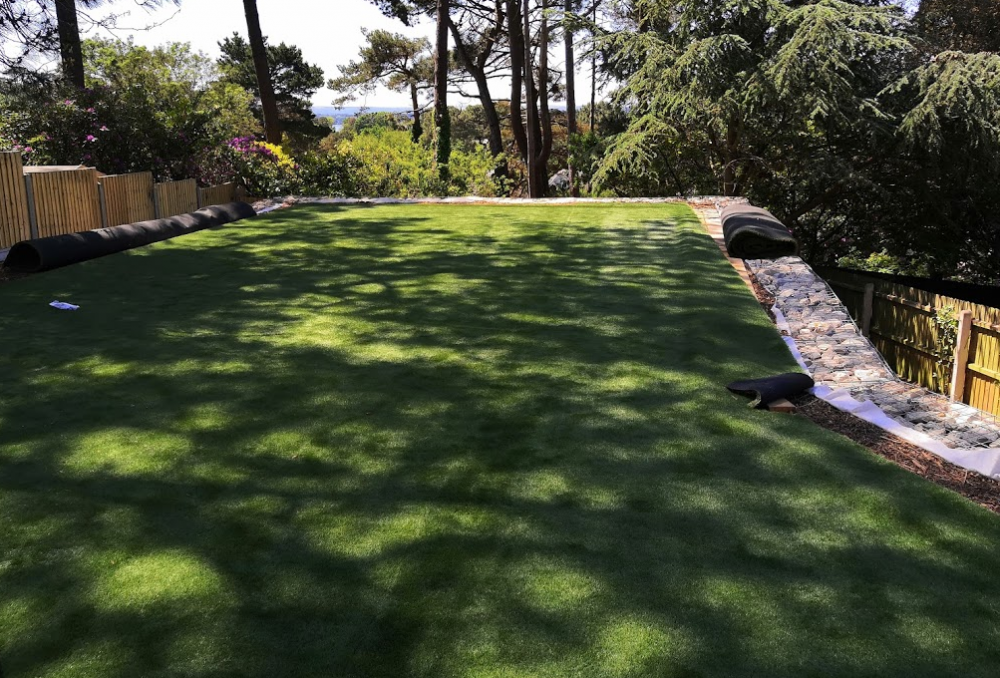

Seeing as we were going to be using the whole plot width and the overgrown garden would then be impossible to access (sensibly) with machinery we bit the bullet on a big clear-out. Getting our soakaway in also meant this was a good thing to tackle before the house so we've spent a few months of stripping things out so we could create the soakaway area, building a lot of gabion walls and laying artificial grass. Oh and we built a shed - a very fine shed indeed ?
The soakaway is deep under the ground in the foreground - which helped to elevate this end of the garden to create quite a nice level area with space to the side for us to run drainage down and to plant some trees & other screening plants.

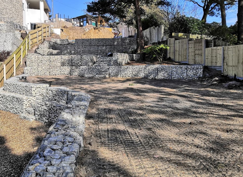

The gabions are part filled with rubble and faced with local gabion stone. Gabion steps are a great idea but they aren't very durable left unfinished so we'll be designing a top surface for them later.
We managed to redistribute a lot of the very sandy ground from the main plot area to level up the ground down here.

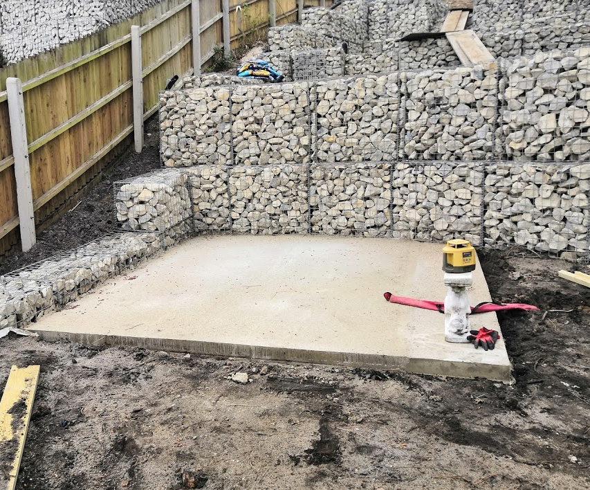

Everyone needs a shed and every shed needs a base. Unfortunately there was a misunderstanding somewhere and the orientation of the slab didn't match the shed footprint hence the add-on on the right!

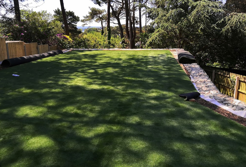

we have some large over-hanging maritime pines which endlessly drop needles - grass would not last so after much research decided on artificial grass. This is mid-way through installation over a bed of 50mm compacted sand on top of the mainly sand base.

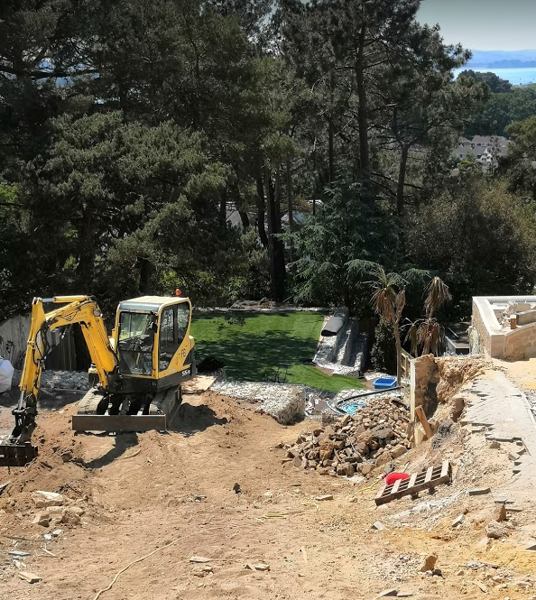

From the top looking down

I am curious. If you think pine needles are a problem for grass, what makes you think they will not be a problem for artificial grass?  are you going to hoover it regularly?

We found that a blower does a good job - if you blow in the direction the grass naturally (ironic) falls then the needles go past without too much bother. My neighbour has tried grass for 4 years and it's clearly not working - the needles are very acidic apparently so we'll need to factor that in to planting decisions.
