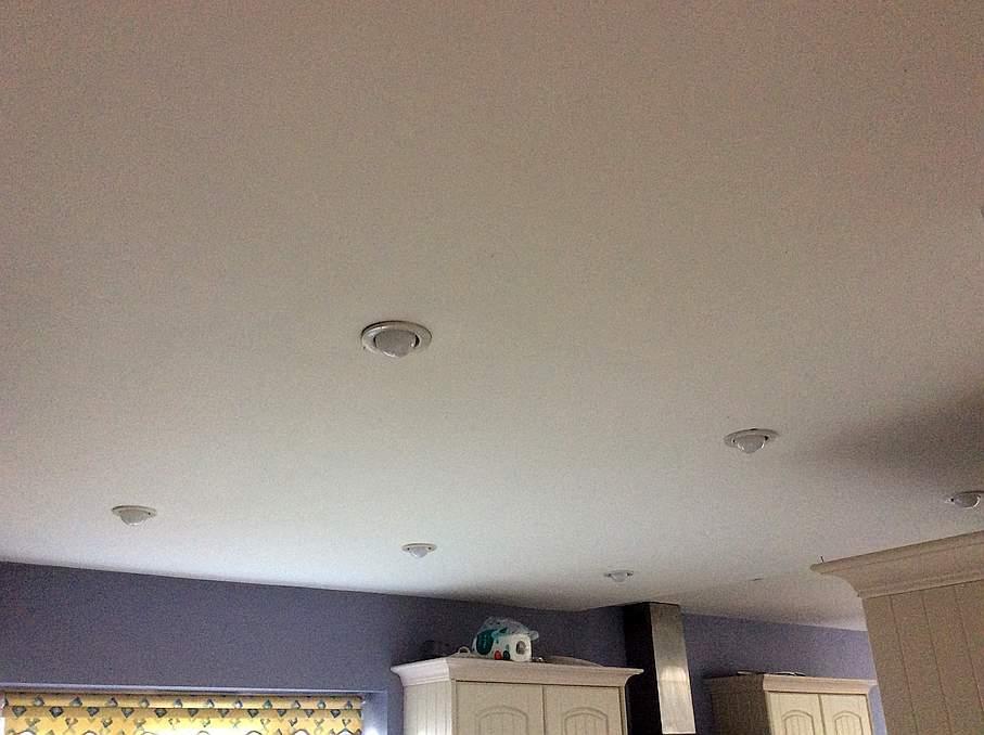

Get rid of those awful downlighters...
(0 reviews)
Bored of your downlighters? Why not replace them with bulbs to give a different appearance to your ceiling?
Just an idea that I happened to see in a house in Kent a couple of weeks ago.
GU10 bulbs are available in shape other than downlighters, for example  candle bulbs:
It is far netter not to have done it in the first place, but at least there are ways to mitigate the damage.
(No, GU10 downlighers are not my favourite. form of lighting.)

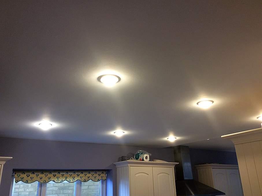

It seems to me that flat panels are the “natural” form factor for LEDs as they can emit both their light and heat in all directions easily. Also, they avoid big holes in the ceiling. They seem to still be a bit of a niche product, I'm not sure why.
We have flat panel LEDs in the kitchen/dining room and in the hall.  They seem to have a very even spread of light, with none of the glare often associated with downlights.  We originally fitted MR16 downlights in the kitchen/dining room, with 12V LED lamps, and still have a fair few of these around the house, in the bathrooms, WC utility room and my study.
Replacing the downlights with panel lights was pretty easy, and didn't require any redecoration.  I'll probably replace more of the downlights with panels at some future point, just to get better light quality.

Easy to sort out, as I run ours of a single power supply.  I did this for two reasons, the first was that I'd already got 12V running to the downlighter positions, the second was that I found there was a fair bit of radio interference from the small constant current power supply units; enough to make a portable radio unusable, but then we do live in an area where radio reception is pretty poor to start with.
I ended up adding another 24 V power supply anyway, as we decided to increase the size of some of the units and they needed a higher voltage.  The mod I did sounds crude and inefficient, but when I worked out the additional losses I found they were small enough to live with, in return for the simplicity of the approach.  I made up connecting leads for each panel light that had a 2.1mm free socket on the end (so that the lights would plug straight in to the new wiring loom), and added a 68 Ohm, 1 Watt resistor, in series with the positive supply to each lamp.
These resistors limited the current to each lamp to the rated 300mA, and only introduced a small efficiency loss, barely any greater than than of the rather crude constant current driver units that they are supplied with.  By a happy coincidence, the same resistor value works for the 3 W, 0.3 A lamps and the 6 W 0.3 A lamps, although the latter need a 24 VDC supply and the former a 12 VDC supply.
Anybody got a pic of these flat panel lights your all talking about.
Ok cool, I was envisaging a more office type thing, 600 x600 fitted into a false ceiling affair.
There are plenty of those about too, but the smaller round panels are pretty similar to flush-faced downlighters, but without the projection behind.  The 3 W ones are pretty much the same, in terms of light output, as a downlighter fitted with an LED, but with a wider and more even light distribution.  The ones we have fitted into a 65mm diameter hole, so were a straight replacement for the downlights we used to have in the kitchen and dining room.  I opted to replace four of them (two over the island, two over the sink) with the larger 6 W panels, which meant opening the holes out a bit, but this wasn't that hard, and the mix of 3 W and 6 W units in the same ceiling seems to work well.
We have cool white ones in the kitchen area and warm white ones in the dining area, and TBH I prefer the look of the warm white ones, and may change the cool white ones over one day, as the warm white ones seem just as bright.
