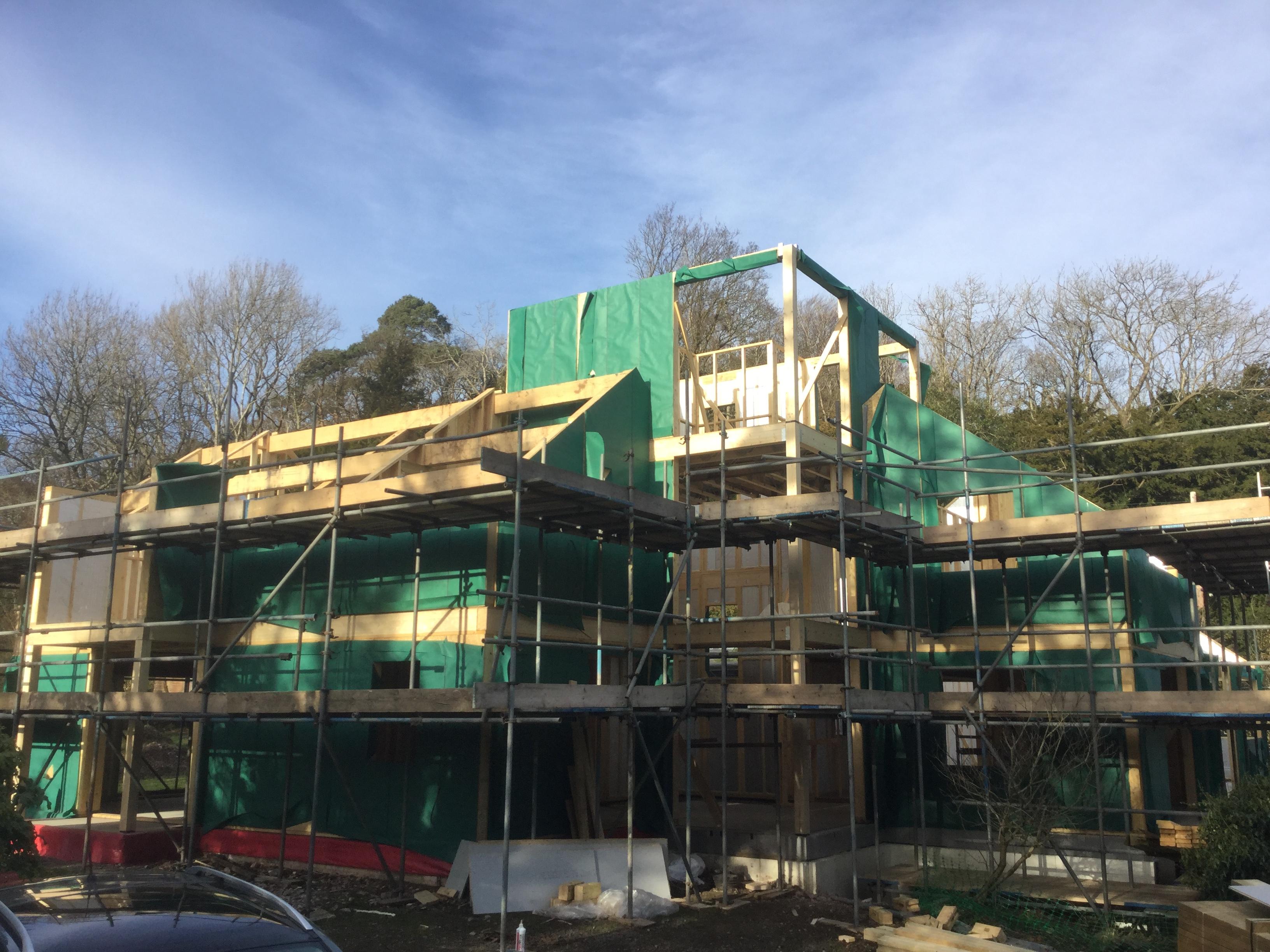

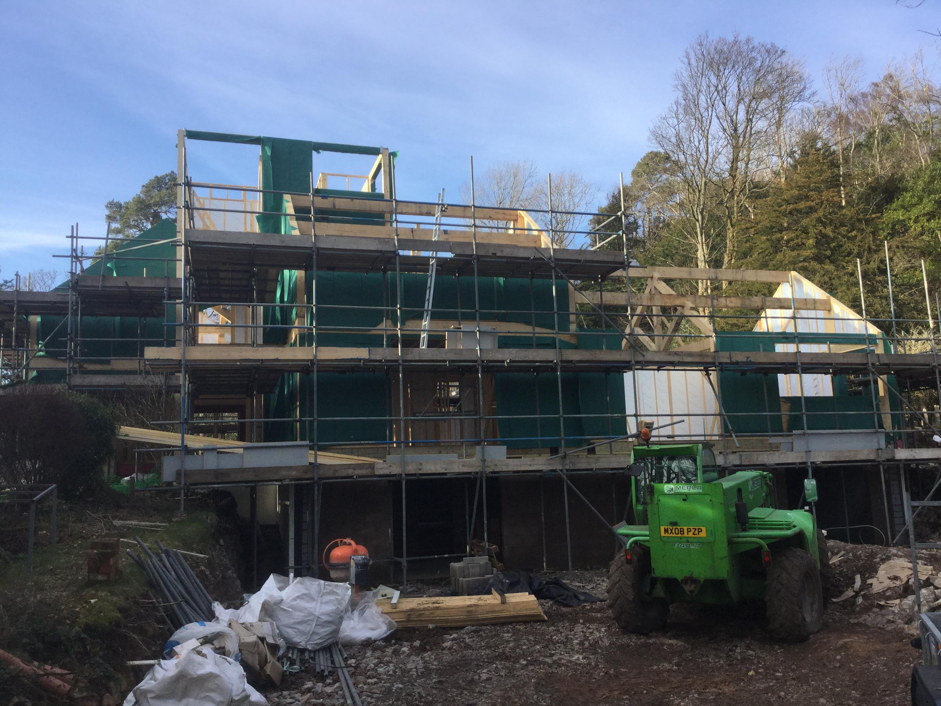

The Timber Frame company arrived on site on a very wet mid-January morning. Very quickly wagon loads of components started to arrive and before long every space around the slab and up the drive was dotted with Ikea style flat packs, assorted timber and steelwork.

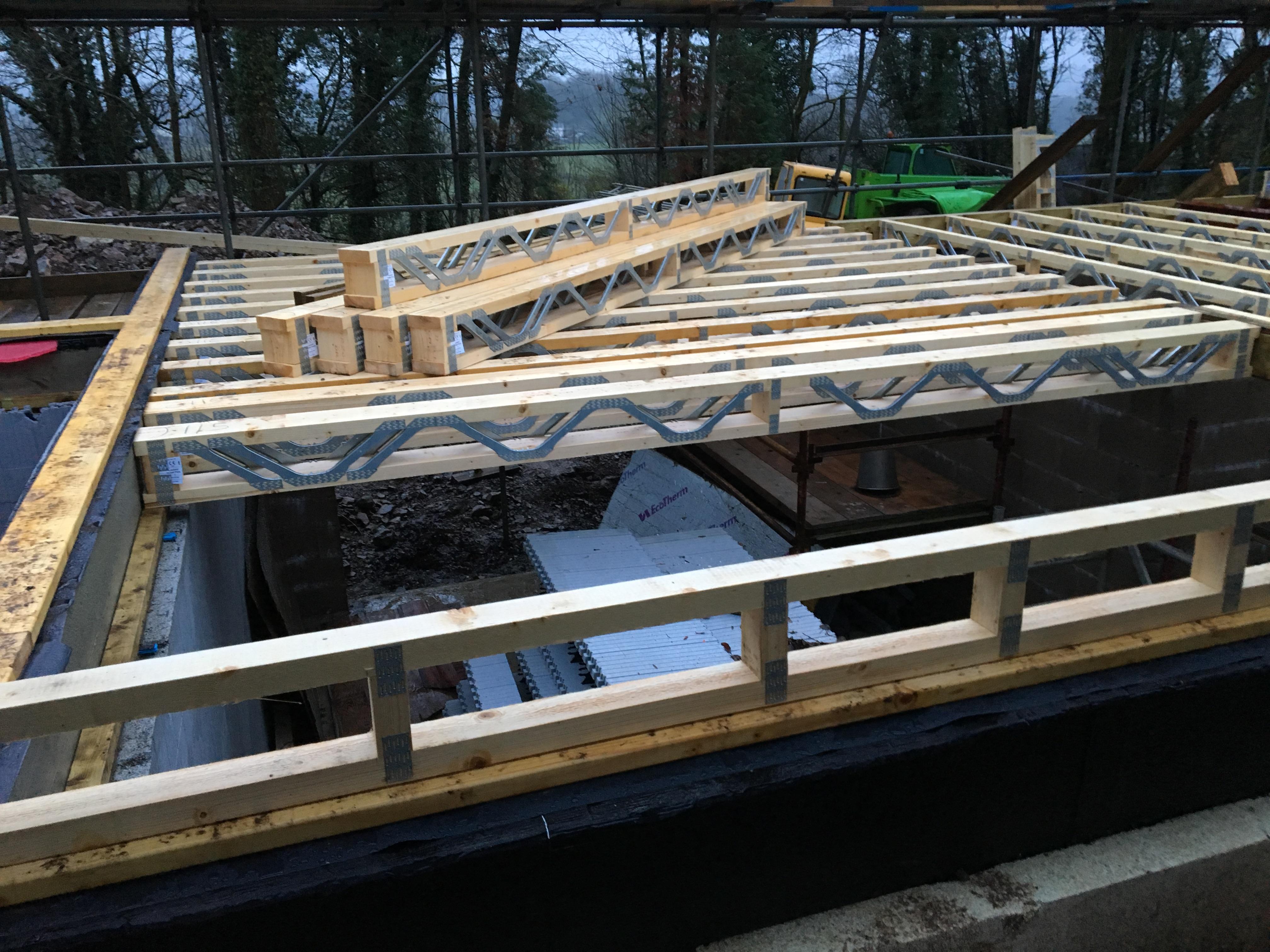

The first job was to floor out over the basement to form a flat working platform for the main house erection. The original specification called for pre-stressed concrete floor panels, these were changed to Posi-joist, as this gave us space within the joist to locate services, ducting, electrics and waste etc.

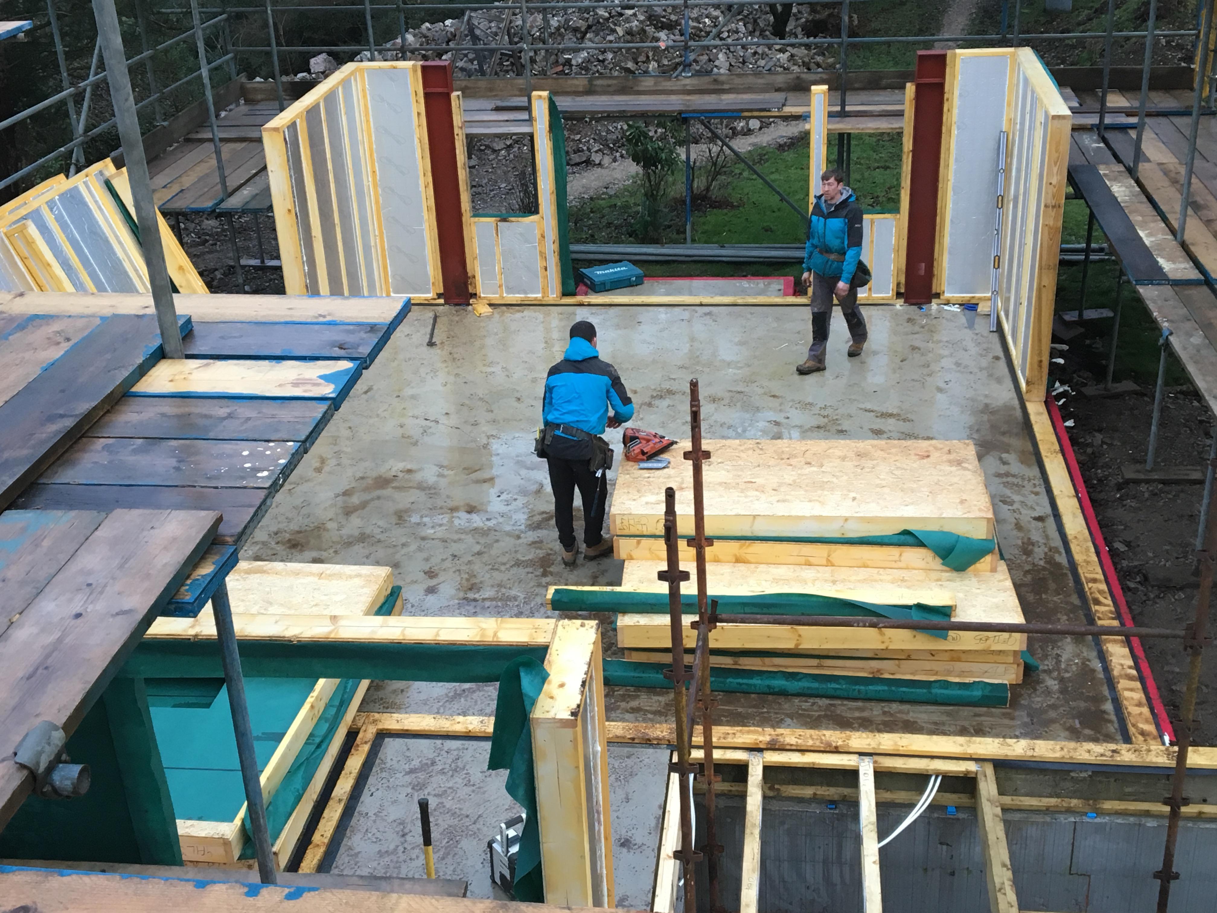

With the basement floor in place, the sole plate was positioned, levelled and fixed ready to attach the wall panels. With every panel, piece of timber, beam and noggin precut in the factory and numbered and with a full set of drawings, the house started to take shape quickly.
Four weeks later and the roof timbers were in place and the next job is to fit the roof.
