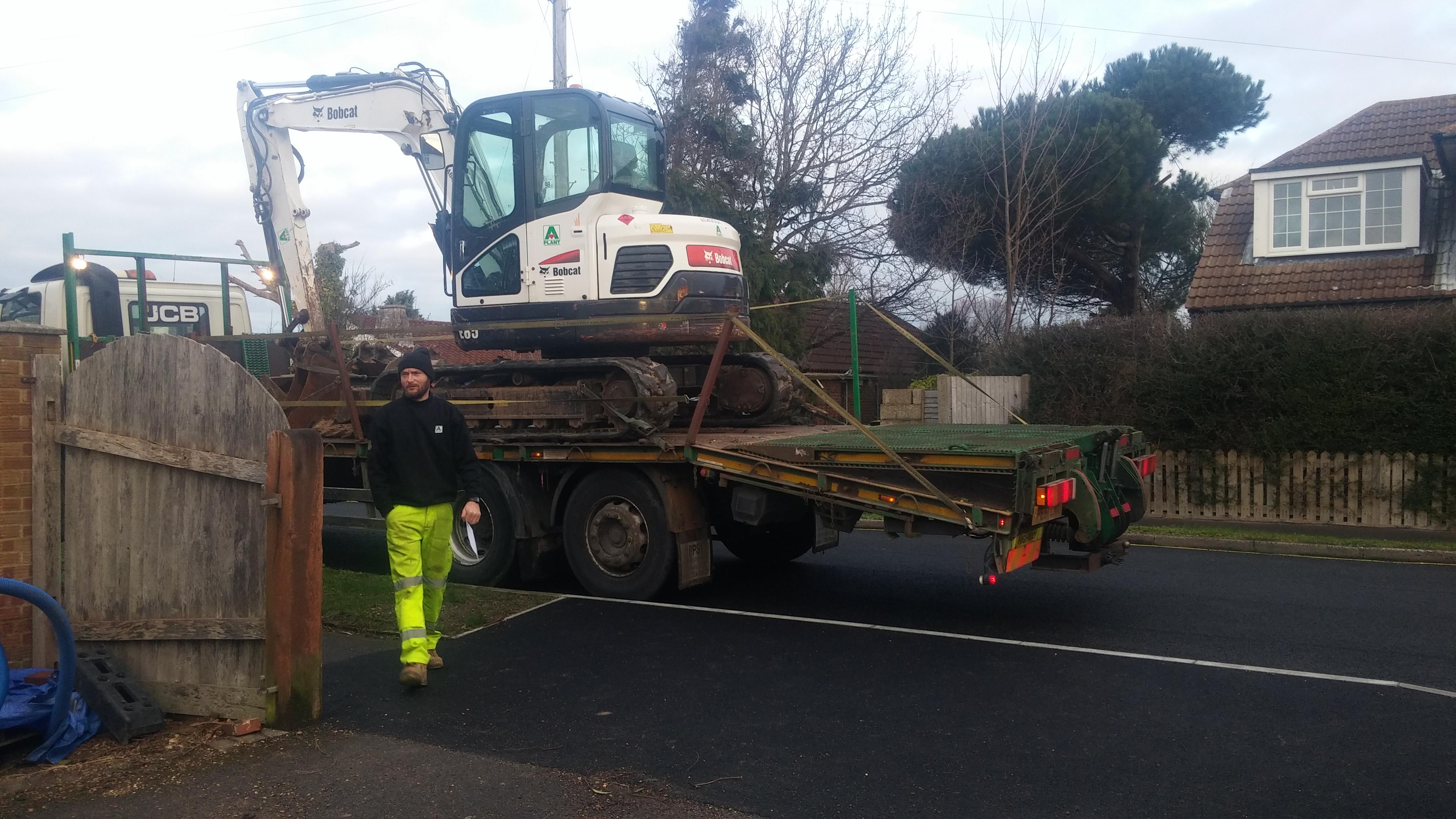

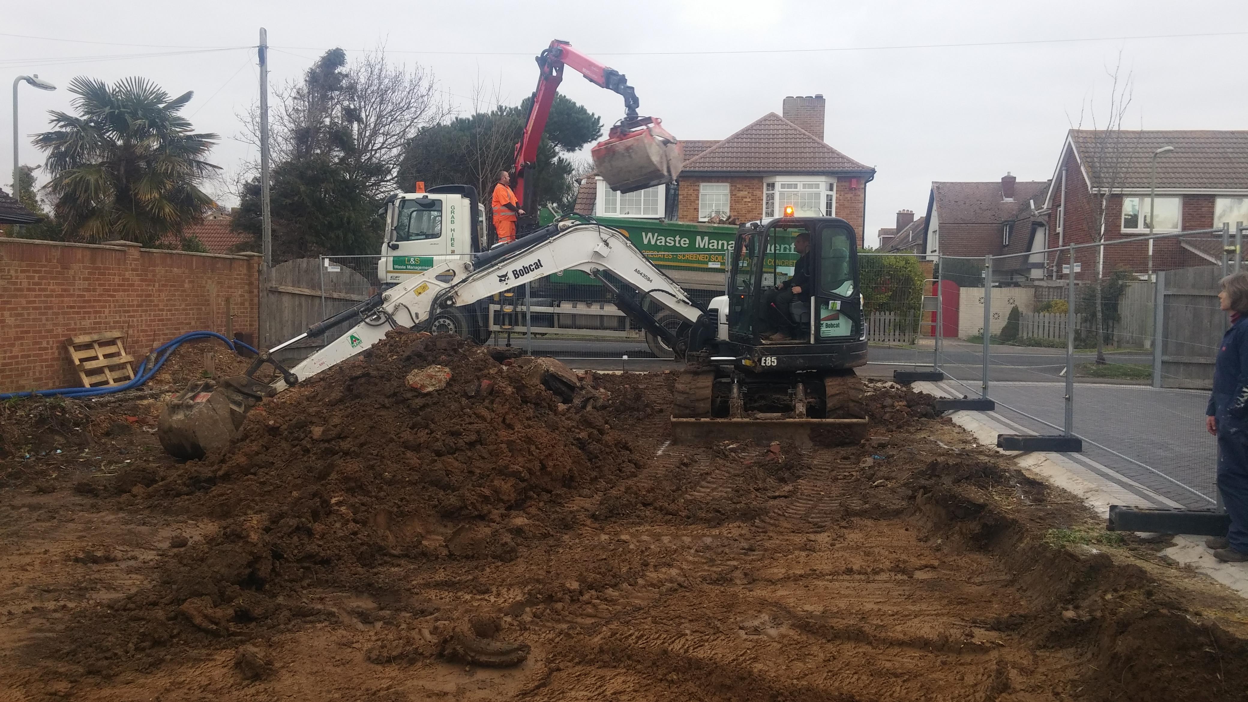

The digger arrived to dig out the raft area at 8am as requested and work got under way. We had muck lorries scheduled for Tuesday and it quickly became apparent that we did not have enough space on site to build a significant spoil heap. After a bit of phoning around found a local company who could supply vehicles. Our builder had asked us to take care of paying for the muck lorries which was fine by us, getting the lorry company to accept that it should be a zero rated VAT service was more difficult. Contacted HMRC and had a discussion and they were adamant that it should be zero rated and that if VAT was charged I could not reclaim it as it would have been at the wrong rate... Managed to resolve the problem in the end. Now we had lorries arriving and clearing the soil we were able to make real progress.

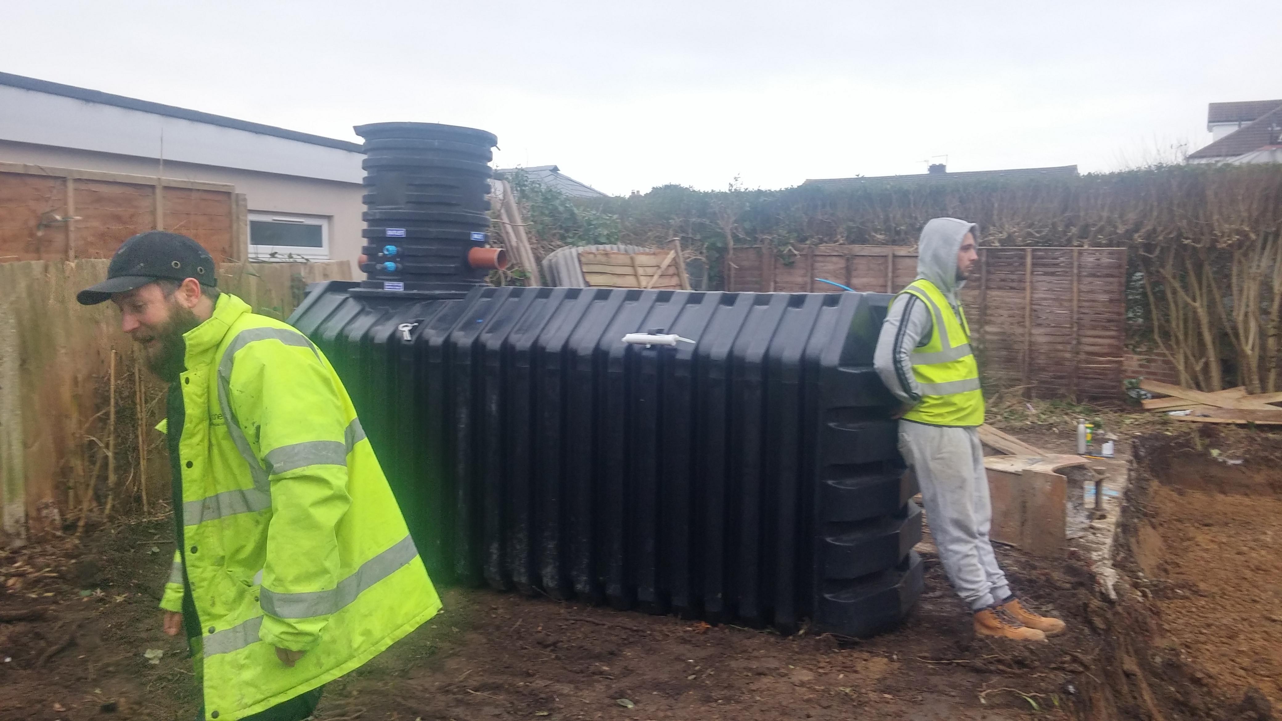

Tuesday the rainwater harvesting tank arrived, we knew it was big and boy was it big! The tank needed to get dug in just 2.5M deep and 4M long, a very big hole. Fortunately the ground conditions were good and a nice clean hole was achieved without the need to grade the sides.

More and more lorries to take muck away, the tally now sits at twelve loads and we are mostly done thank goodness as at £240 a 12 ton load for the clay it was making a bit of a whole in the budget, a quick calculation of the volumes validated the figures, so it really should not have been a surprise. In hindsight I'm surprised our builder didn't ask me to organise in more lories in the first place. If I do this again I'll order the lorries in advance rather than madly phoning round for spare capacity so that work can continue.
