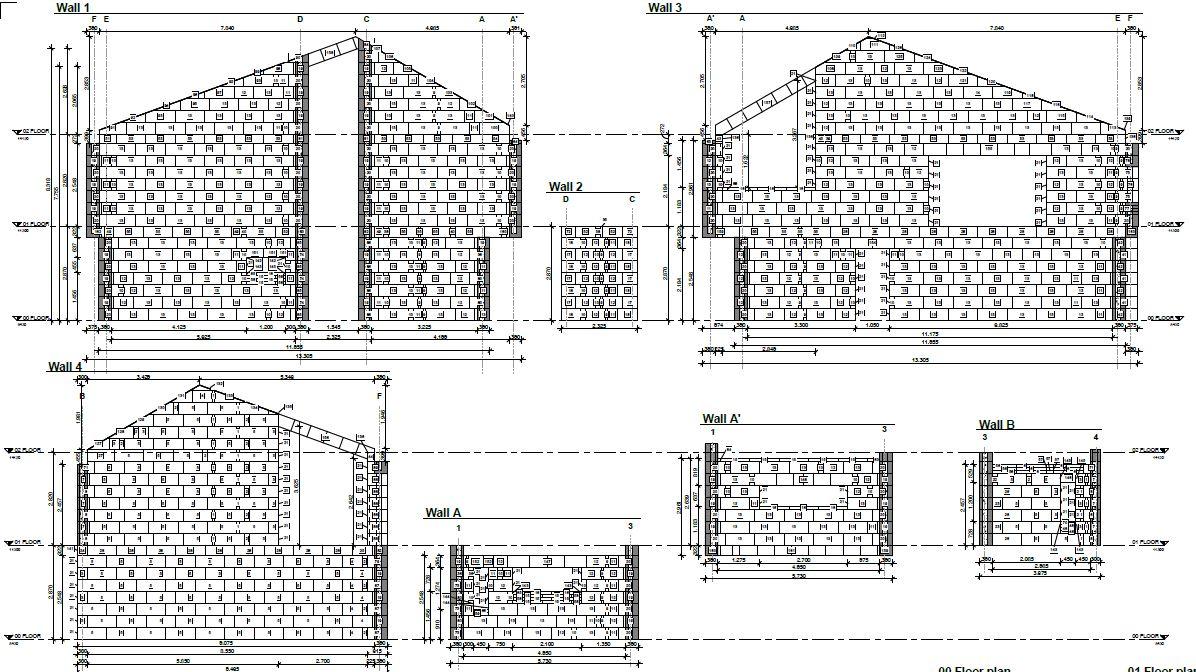

Well with just days before we start we have our house block plan. All the bricks have ID's so all we have to do its put them in the right places.lego.thumb.JPG.739458a6e36b46ab396d246e2612fc45.JPG
The blocks are coming loaded on pallets, each with it's own manifest. The scale of the kit is a bit daunting and having done my bit of Lego with the kids in the past I can't help remembering the fun of looking for that special brick that seems so illusive. Fingers crossed we don't end up with one left over after the last concrete poor.
With site works just about to commence some of the details we thought were sorted are coming unravelled. Our rain water harvesting tank (RWH) which was nicely located on the edge of the property has had to be moved as the builder is concerned over the size of the hole next to the public highway. At 2.5M deep and 3.2M long. I can only agree, just a pity it didn't get mentioned until the week before we start digging. The tank is being moved to the rear garden along with all the associated changes to surface water collection drainage. While sorting this out it was spotted that the  tank overflow was connected to the sewer, the sewer company takes a dim view of the idea of connecting surface water the sewer system. The fact that the tank capacity is very over specified and the overflow will probably never see any water is irrelevant.  One of the main reasons we are an RWH was to take care of surface water as our plot is small and we could not get the 5 metre separation required by the building regs.  There is a surface water drain in the road outside the plot but it's very deep which will make connecting to it prohibitively expensive. Just another detail to sort out that we would rather have handled before we started. Still no ones hurt so it's not serious...
An 8 ton digger is scheduled for delivery first thing Monday and site setting out scheduled for Tuesday faternoon. Lots of lorries for waste and MOT.  With the raft components being delivered the following Monday it's going to be a busy week. Hopefully we'll find no bodies on the site...

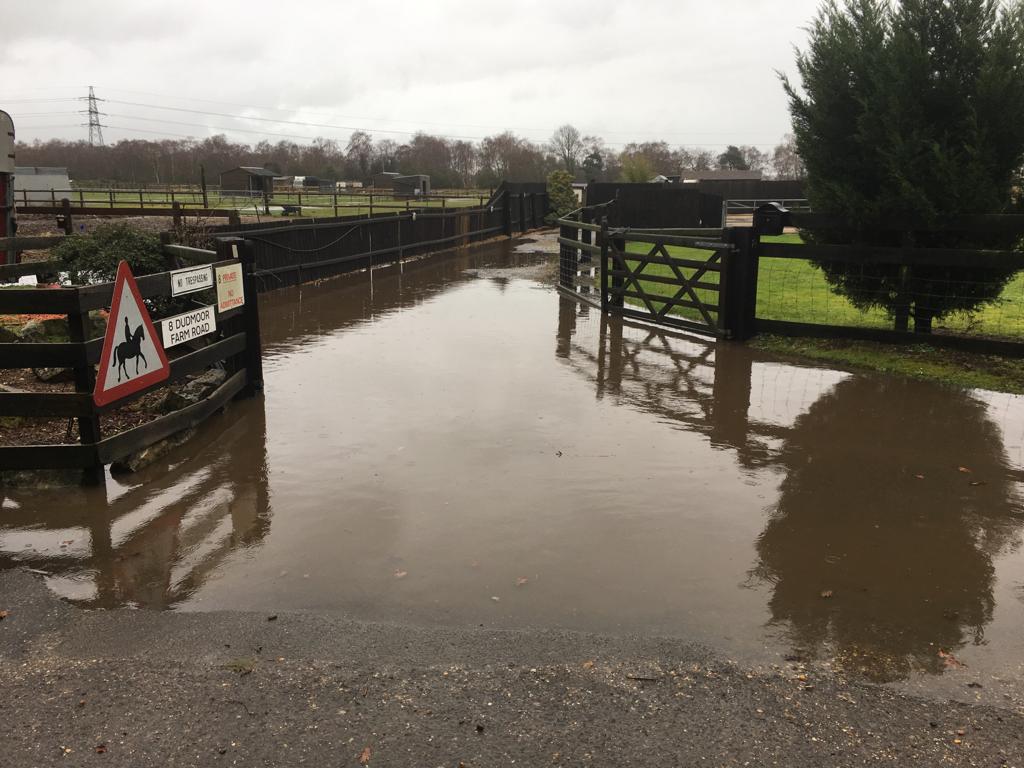

@JSHarris - have you got details of your surge system please?
Yesterday my little Smart car nearly floated home as our drive was a little submerged.

I just used Aquacell drainage crates (see here: http://aquacell.wavin.co.uk/ ).  I used 20 of the blue Aquacell Core crates, tied together with the Aquacell connector tubes and clips into a big rectangular block, with the block being wrapped in terram and buried in a big hole under the drive.  Runs of 110mm soil pipe connect from the top of this surge tank to the house and garage drain pipes.  The top of the crates was covered with compacted Type 3, so that water run-off from the drive can permeate down into them.
The only snag with this system is the cost of the crates, they are not cheap.  I was lucky, in that I found a load for sale on eBay, and it's worth keeping an eye on there, as when I was looking I found quite a few surplus crates being offered for sale.  Mine came from a ground works chap who had them "left over" from a motorway job (they use these for motorway soakaways).  Funny thing is the the seller's name was Dell, and he delivered them to us, for cash...
