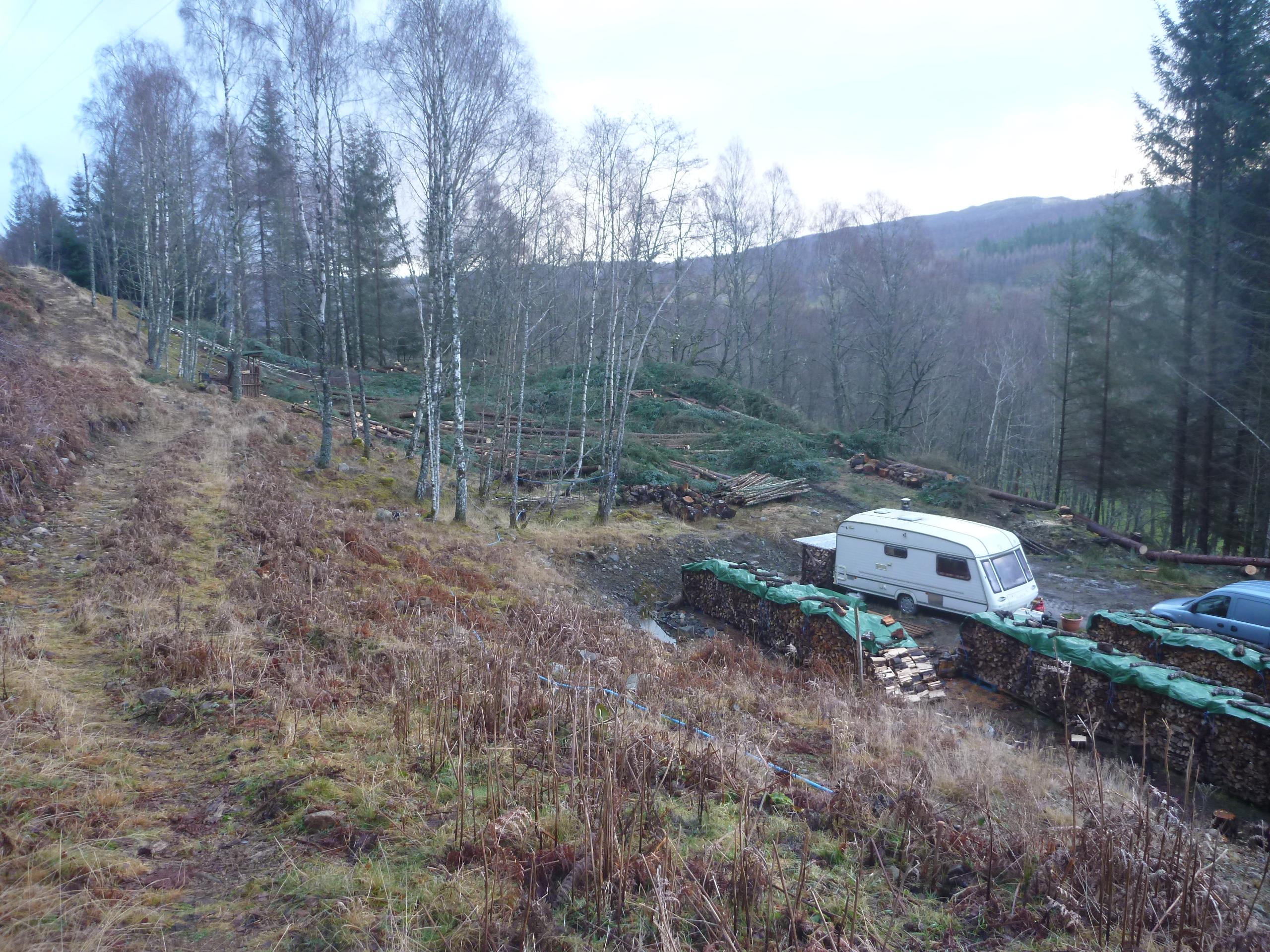

Since the last blog entry we've been working away at co-coordinating the paperwork for the building warrant . But progress is slowly being made. Last week we heard we've been lucky enough to get a 50% grant towards our grid connection costs, which is a big help. Anyone else who's thinking of applying, feel free to get in touch if you want to know more about it. I think you need to sit within SSE's (North Scotland) area.

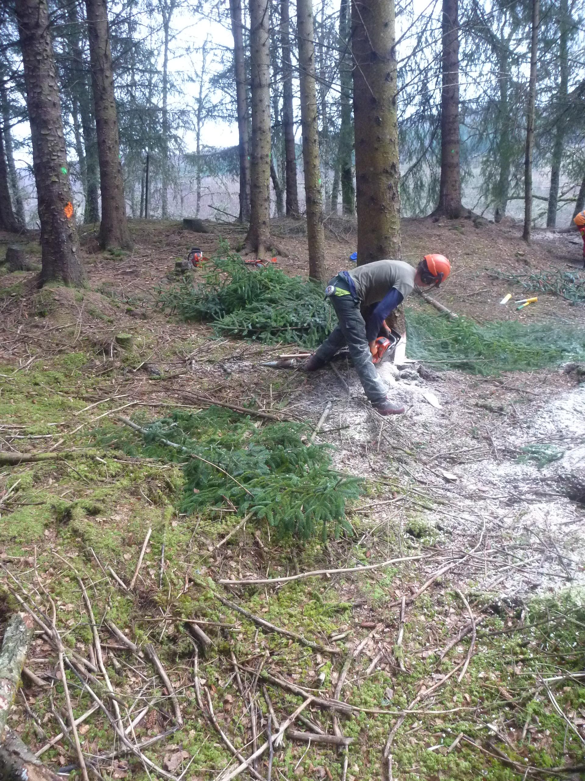

As part of our build we're removing quite a few conifers, the condition being that we replant with a load of native trees. One of the constraints on this is that the conifers sit quite close to a HV line, in particular within what the DNO call the red zone (where if the tree went the wrong way it would hit the line). For a while it was a bit difficult trying to figure out how we'd get these down, but in the end we were lucky enough to take advantage of a line shutdown by the DNO a couple of weeks ago. So now most of the conifers are down (only a few remaining), we just need to get them extracted.

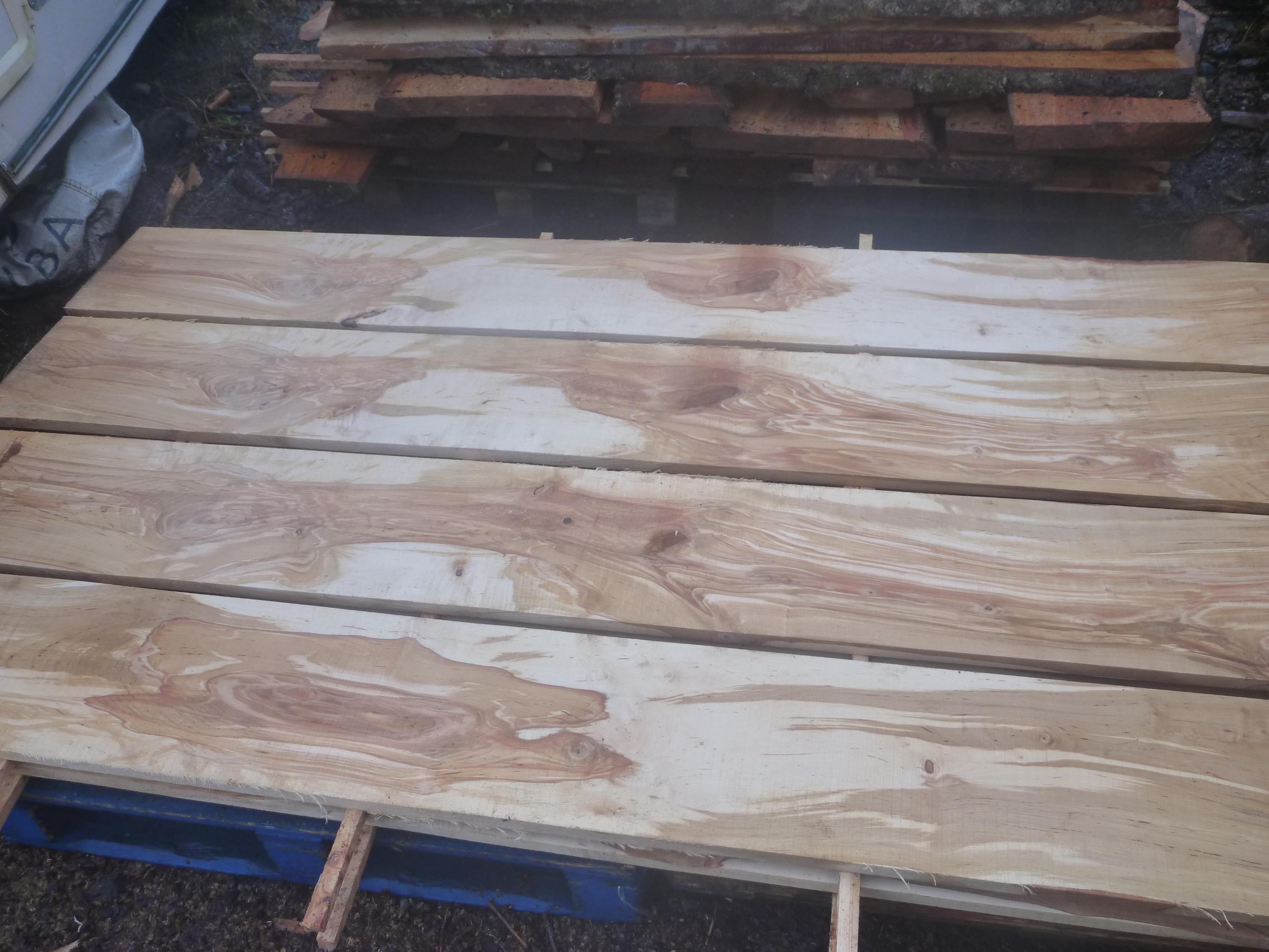

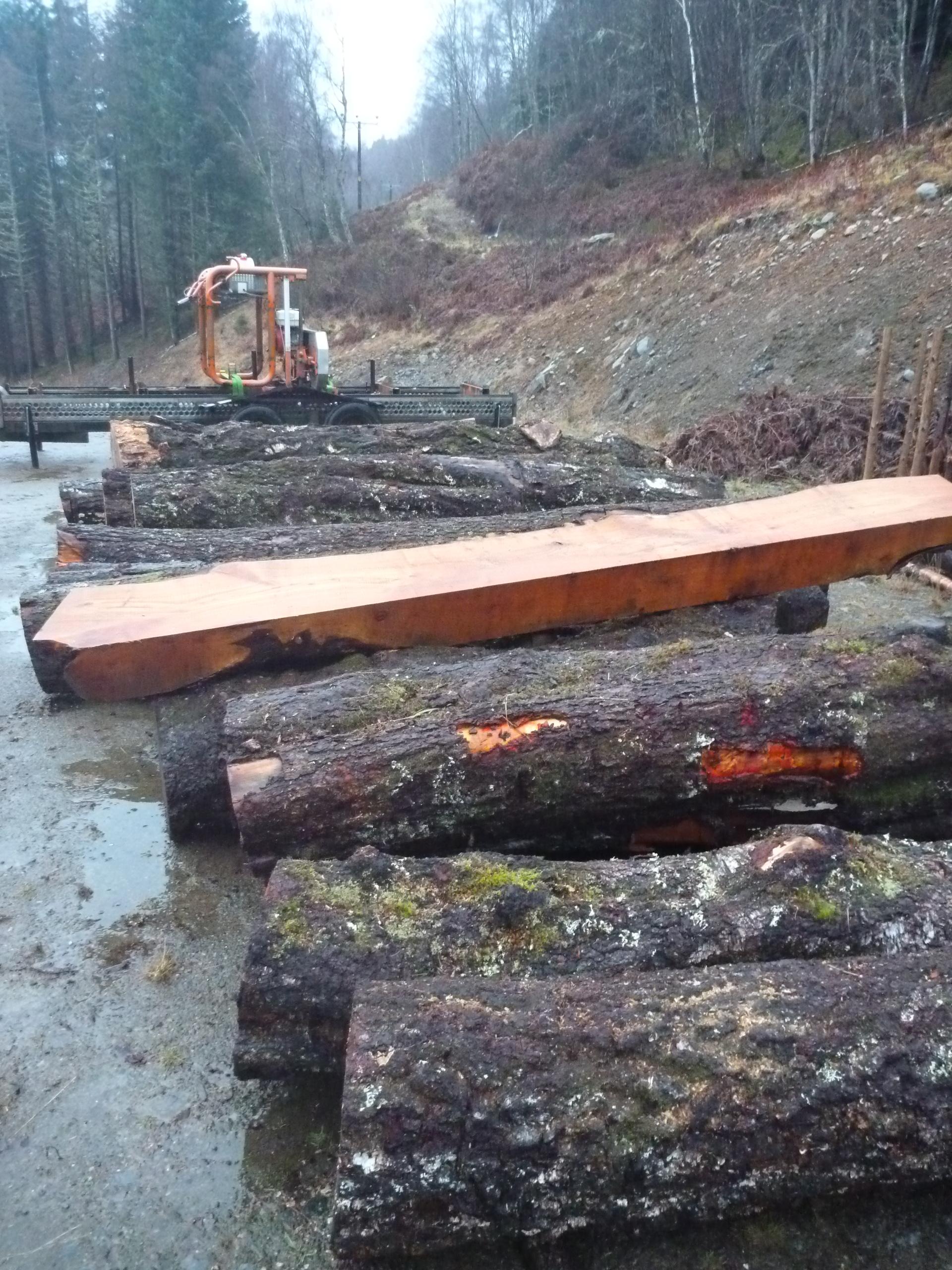

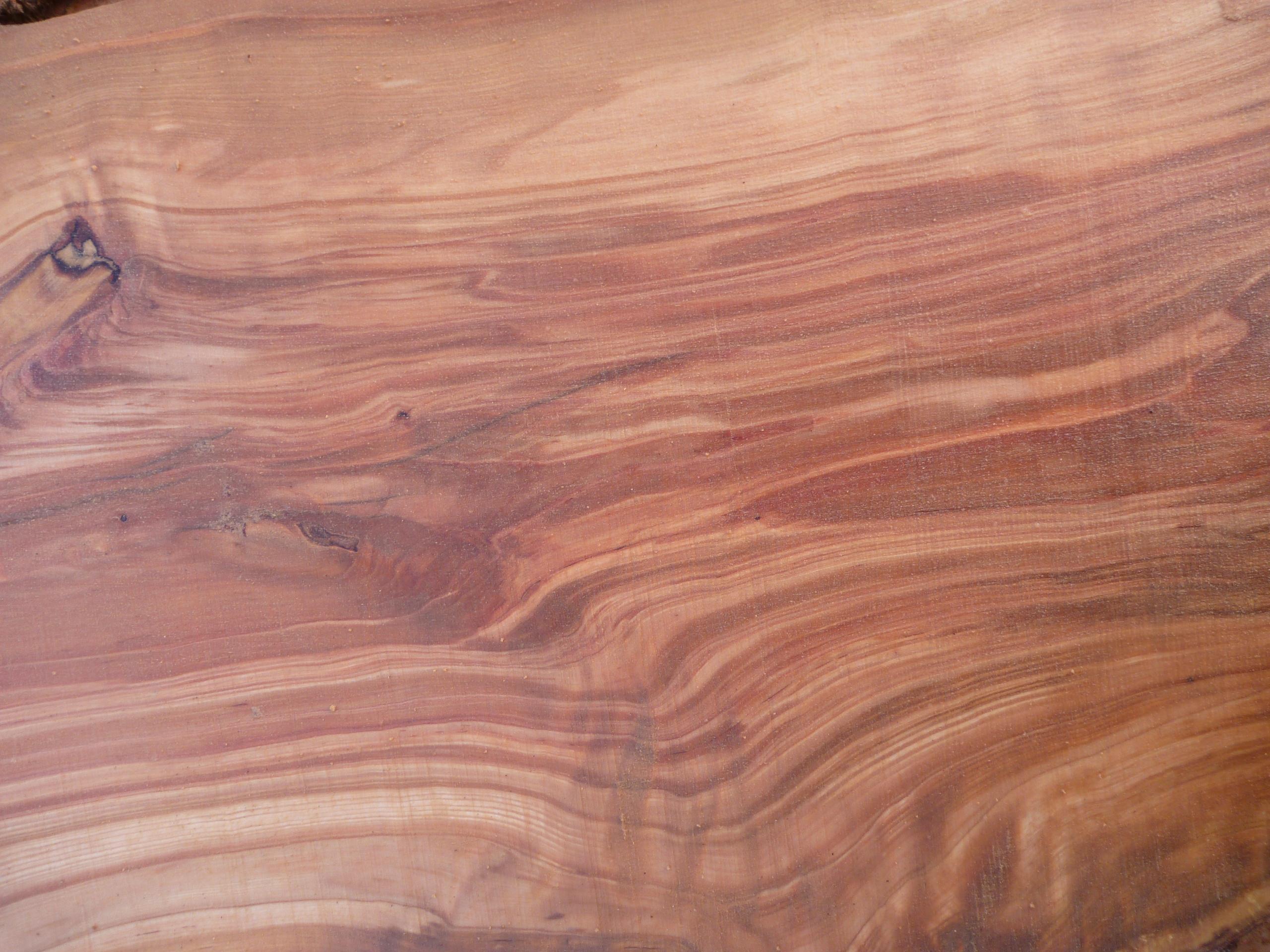

In other tree related news, we also arranged to mill a few of the hardwoods that were felled a year or so ago. Pretty pleased with the results, these will now air-dry and then probably need putting in a kiln just before we use them.
Action shot of SWMBO taking it out on a tree:

Logs ready to mill:
And some of the results:

the milled lumber --I would just keep it under cover but plenty of ventilation ,its the way all wood was seasoned once upon a time ,slowly-is best
Link to comment

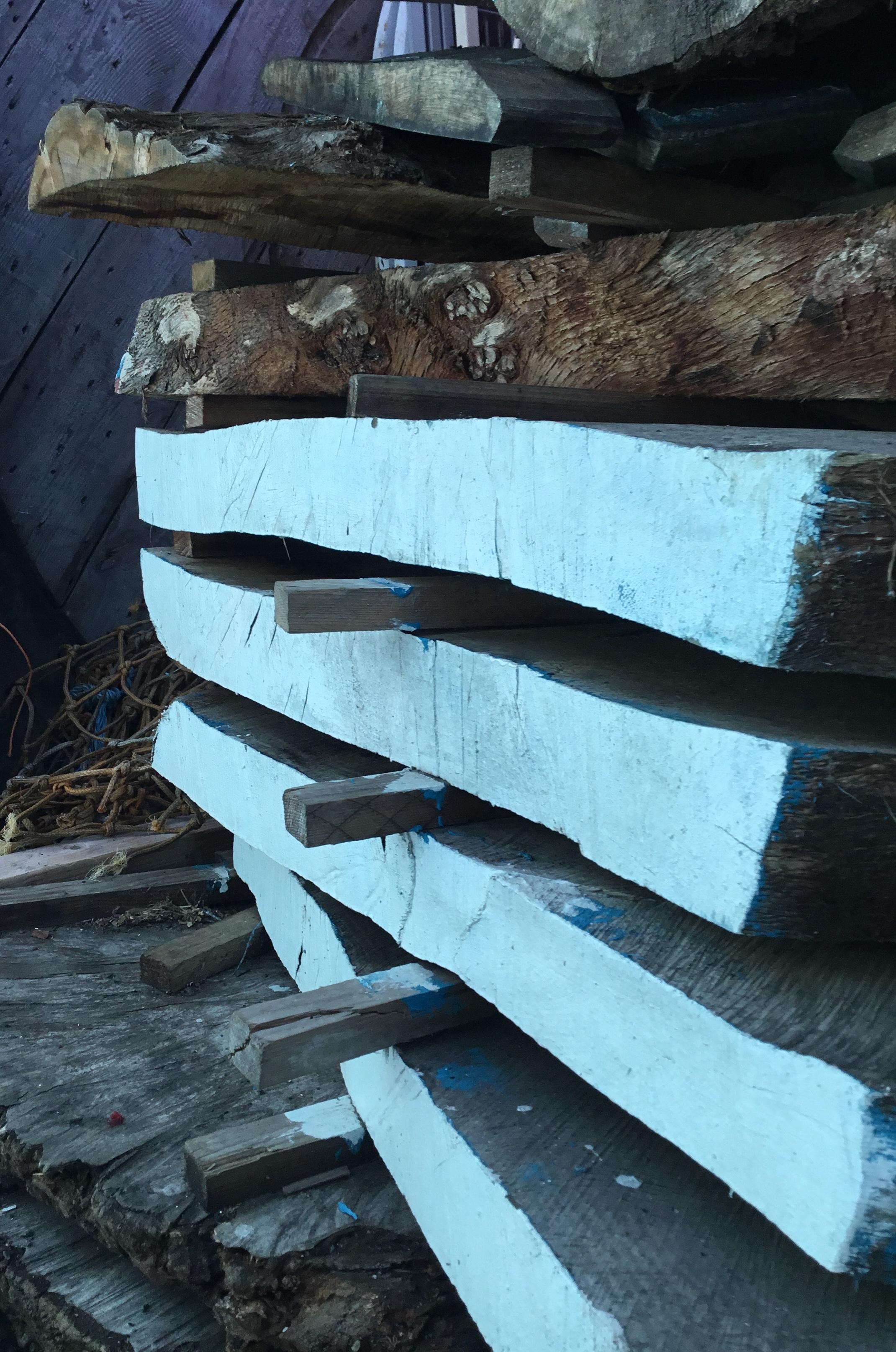

Paint the ends of the boards with cheap gloss paint.
Couple of scaffold boards across the top, tarp over it but make sure the ends are covered from the top but still exposed.
  • Thanks 1
Link to comment
What does that do? Stop drying out through the ends so that it dries more evenly along the length?
Link to comment
That’s correct, it’s been done like this for a very long time, I think they used to use some sort of lanolin mixture..... I just use whatever I can find but floor paint is great !
  • Thanks 1
Link to comment
Yep - stops ends cracking open as they dry faster.
The other issue is airflow - I’ve seen people build virtually airtight covers for wood stacks and wondered why they rot as the moisture can’t get out and the beasties find nice moist areas between the boards. The quickest and cheapest fingers are offcuts from the sides of boards as you trim them once you’ve cut them to thickness.
Polytunnels make great drying sheds as you can open them up at the ends to get airflow but can also increase the heat by either the sun or even use heaters. Just don’t use gas heaters as they create more moisture than the remove unless you have them externally vented !!
  • Thanks 1
Link to comment
