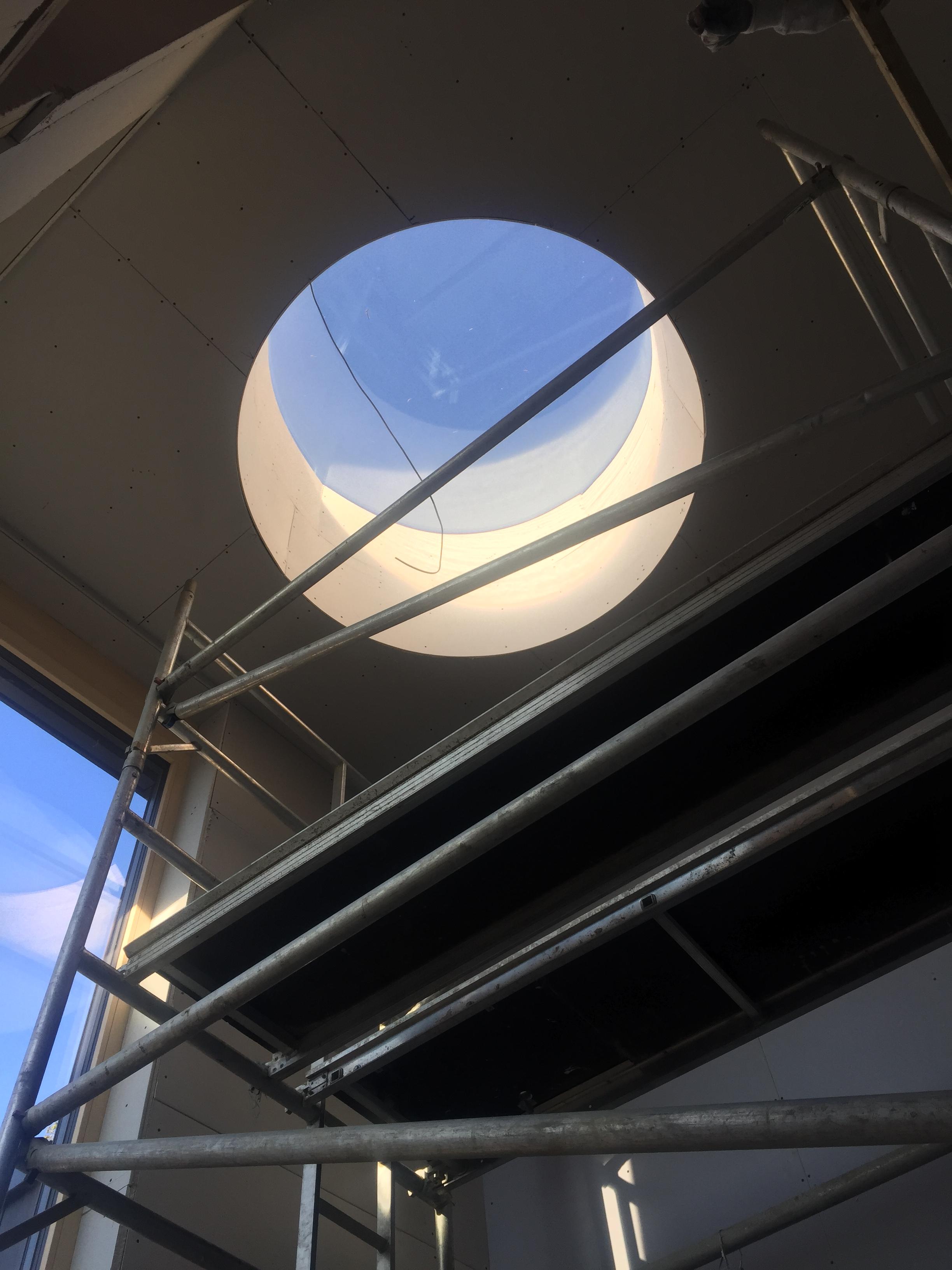

Any thoughts on how to get the internals finished on this octagonal light?  I was wanting to make it circular (and the window company advises this so that we don't get any issues with condensation on the visible frame (which would be covered by the insulation if we did make it circular).

Are you fussed what it looks like from above? Looking through the roof light from above you'll see all the timber supports that are supporting the tube. What you want is a nice, neat, octagonal board to infill the hole! :)
How deep is it btw, roughly?

@OnoffRoughly 600mm deep we think though can’t get up there now. Scaffold tower will be the access up there.
dont want to see too much from above so was intending to make the support for the tube as thin as poss.

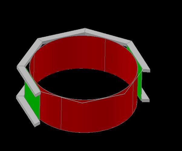

4"x2" for the hex bits, some ply sheets to space nom 600 apart, then whatever bends around the inside. Screw sheet material to (green) boards:
I don't like the gap between the red of the boards and grey of the hex frame. You'd only see it from above....paint the frame black?

Firstly, there was a slight thermal bridging issue with the metal frame for the roof light being inside the thermal envelope.  Got some drips earlier in the year when plaster was drying out and condensing up there.  Not a huge amount we could do easily but I have at least stuck some aerogel (left over and lying around) on those areas.  Those are the silver triangle pieces.  Hopefully there will be less moisture (than plaster drying out) when we are living in it.
n2cnb0p4MtCh7IHo3_XXRIqCLIDt3rJipjcb81HfTwrFdedRe7Y5gS1XNxVvEegLCXiw4E8CsphgWY2DMrBpy_UxQFp39pyIqUpz80VkLDMRR5-L97ylhP8w0LaUmRwWcnUURO5UvQKJXDFY5cD_TE5ajzsDcCRmDc0mcUhTLxKzhav1OcDBBe_ydAqHL2knUwJD6WNDwEQdHZ3FLaFGYh5AbFvzEi2EPoKLQ7VQVBIPpmOkM8qcwUodyTpO1LU8-6XlrYSv77UBRGLrJ9ybUVgLPkgqX6z2NXYOs5n8nd4unwarqrLgCXR8TOg0YCOe4nq32TgZT5rb-_S98EYbUnd7ZQCtE_itZaTQLf3tfKwKvvb9VbRFVn8HGZJGChFC2EQI7xIHiZ2mLvLybVA4DkPC3XIGR-mcUJOcHNX-IJ8zvpdhkXWKlSq2Fc46hWpgDpE9f8e5ZEOx2PYqANvY4u7-QdOnJ2FmBsJe5qjN1PaOt-CjinB45vdXObUspxzlQYphpycMCtUvvO25RBc6mXe47eIXfcI3RCD1dua8WkE-H75hMft6lYu4t7yivuKbd03evQ27eeppZ_kw4yerFIbPpetJKMwQDFGyJxkGZBoudIuX9fzVFrqhiQT1hZ5CQ4f-s0rqSvDmfsj_pfUEHve8g33ELDCV=w1250-h937-no
Back in Jan the tackers said they would have no problem with that rooflight meaning that HWMBO was left with stud wall construction only.  And this week was the week for them to do it.

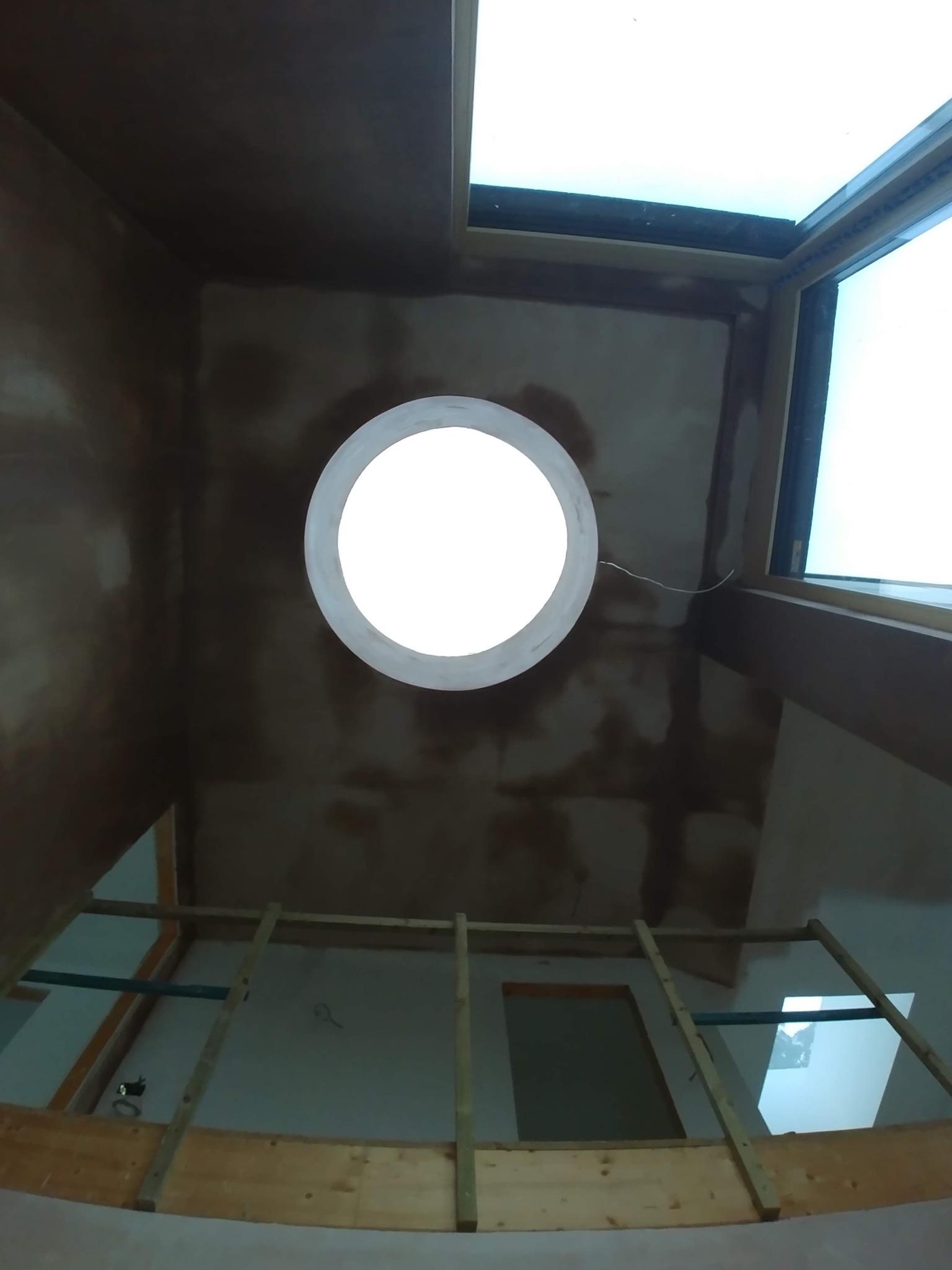

They turned up with a flexi 6mm board (that they also said was moisture resistant).  They used some plasterboard to batten out slightly from the square bits of the hexagon, some 25mm battens a little bit further out and then some creative battening across the corners and then they bent the 6mm board into shape and fixed it.
yqChz-yRBQIAqNz8tpj1FKoBt0pcs-G914Ai5xc1oNRZMO3jdlIQpugDe9YIobSWNHo3Xn2g0W2Ut_ACS4Cdk5X9-maVH_Wxv7eeGcaCUg56Un5kSHmVKgpWWZVjpwovWvUGS4VY85z6trPk4Bm0agugQQwDLD5gz6ySxC0gH_9B781Jb1p55rCj0700sC4P3Vf9w054bDi-17ieS37JS4iDtYc0UbQpr38kicQXeYf7CEo4E-20EpZ3wW-VnQlYKotDpcsmqYMdEPiO1p23dNzbw8jdTuJ5PRI05cWSsKK2mnt7IUe9Fybuy_ae-oUyUwgnUzg1G1AaEXdvxQfOhjtLbdCHdeE_t8d194eTjep-JaC245ZkUB7V8mNR9glT9lJWIlN-cR_qQOF2CoZLbN_R2GZPud3IJzXp-AoqxpjqNwYrnPWnj5RUUOzui_gcQ9d2KNT5h3j7AfaayECif0D002bRH2qI42Vb1kPjgBwbBMw96l9CLWyYN04HI-BHf-HGyLNIPOSSpoR31GXXKiC_GgW3Y0GEb_HdzoixNMWNJozyVkgBbB6oFHsz97-SRn8Gxg3zLTw528OfhgPtYdgbQn5YckzTadXh0UWLbT7stnJ9A71FzSm56z2Dq6cyHEPviNqm1zjAztR0Q1cO9sipp-k9UAt6=w1250-h937-no
Today they did the top bit (no photo, too dark when I got home).  But they have left the plasterboard about half an inch short of the glass and made sure that the black edge is covered (in case the finished skim isn't quite circular - otherwise the absolutely circular black edging would show it).  I'll post again after the plasterer has been in on Monday - hopefully he'll have no issue with it.  But so far so good.
Did have to hire a huge tower scaffold though.  Ours only goes up about 3m and they needed the platform for this work at over 5m.  Its still pretty hairy standing on a step ladder on top of the platform but even I can reach the roof light from the top.  Bodes well for painting. :)

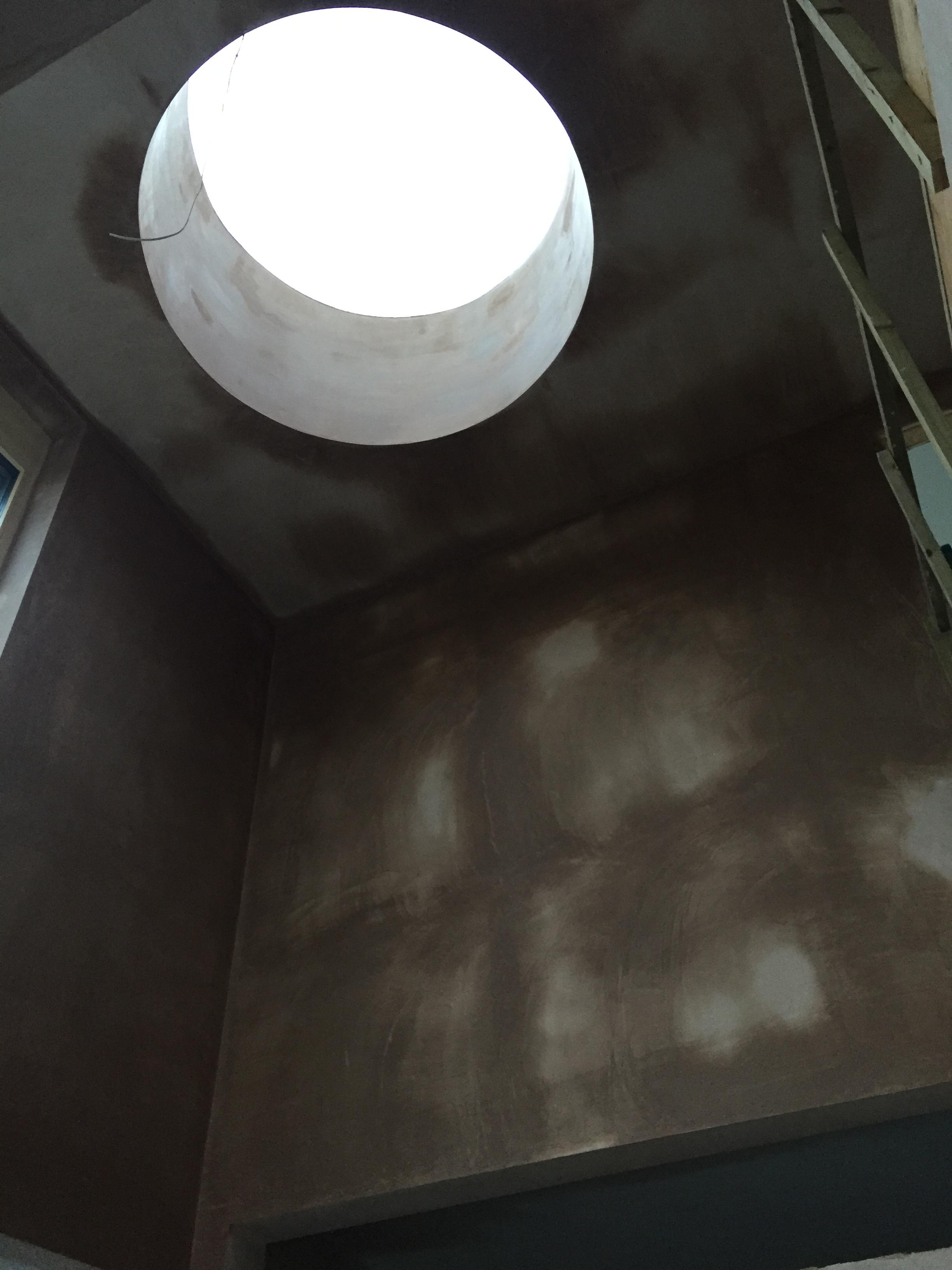

And here it is fully boarded. Plastering of it starts Monday. So far so good.....

Suspiciously like my CAD drawing...glad I could help ;)

All plastered now. It’s not bad at all. The eagle eyed (like HWMBO) might say it’s not quite circular. But it’s good enough for me. Going to take a while before we paint. The 6mm Flexi plasterboard needs PVA prior to plaster so will take longer to dry out.
Off hired the tower scaffold. Will get it back for painting. Will get a higher platform to avoid the step ladder issue ?
Meanwhile back to mist coating with my Aldi sprayer. Bring on the long weekend......
